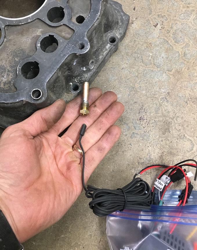

PostPosted: Mon Dec 03, 2018 12:22 am    Post subject: Re: Temperature Control (electric) - Manual Transaxle gearoil cooler Reply with quote
From a few posts above.....^^
Sodo wrote:
I'd place a sensor on left side wall, appx location of the word "4th idler" in this pic. Nobody to my knowledge, has done this yet.
I've been using 'average" transaxle oil temperature from the bottom of the sump to control the cooler,
but Wizardry has occurred on TheSamba and dutifully shared by 87VanWes p13)
Below was written on his thread on P15 (way back in Jan 2017).
87vanwes wrote:
I did go a little outside of the box on my trans cooler setup. The sensor is positioned not in the sump oil, but where the oil comes directly off fourth gear. I saw shocking temps on my short trips. Over 220F at 65mph on a 70 degree day without the cooling running.
This method of reading the temperature of oil thrown from the hottest gear, (4th gear idler) is a great development.
I saw it awhile back but it didn't occur to me how to incorporate the idea since my trans was in-car already. Then I kinda forgot about it. Embarassed
But now its winter again ..... project time.
I'll change my pump/cooler control to turn on as soon as the 4th gear idler starts to get hot.
...not wait until the whole sump (and 110lbs of transaxle) warms up.
I'll use an A/B switch between the two, to understand the difference and behavior better.
"X" marks the spot for the temperature sensor.
You can see where the oil is thrown off the 4th gear idler, where the oil blast passes between the shift rods. Uopper rod is 3/4th, middle rod is reverse(+granny on Syncro).
The metal bits in the oil (from this trashed transaxle) have sand-blasted the wall of this transaxle gear carrier case, even pock-marked it. (see closeup pic?)
I drilled a horizontal test-hole in this housing, and then started planning how to drill it with the transaxle "in-car".
So before drilling, I called Syncroshop to powwow, and we batted the idea around for awhile of drilling it "on-car".
And then arrived on angling the sensor sideways for a quicker response from the hot oil blast from 4th gear.
Which yielded the second benefit!
The "X" location is pretty far up on the side of the trans, where theres no access to drill it "on-car".
Exclamation But angling the hole 45deg on the cylindrical boss you can drill it from below the van. Exclamation
Exclamation Wink Like "tomorrow". Wink Exclamation
So I made a special "drill jig" that bolts to the trans, using this trashed gear carrier (a trans case part). With the jig I can replicate the hole location on my working trans "in-car". I'll pressurize the transaxle with compressed air to drive most of the magnesium bits OUT. I'm no longer concerned about magnesium flakes in the oil. Magnesium is a soft metal thats almost a 'lubricant' to steel. And the way magnesium drills, the chips are very thin. I have a wicked filtration system that exchanges the entire lubricant contents twice per minute - the swarf will be captured quickly.
Another way to think about it is this.......while (many!) other fellers are driving around with STEEL in their lubricant for 20,000 (30, 40, 90k) miles, Shocked
a few soft metal flakes are nothing to steel gears/bearings, even if you didn't have a pump/filtration system. They will roll out to little tinfoil flakes that incidentally have gear oil's EP additives adhered to them, slippery like wet leaves on the ground. Not a worry, but might as well remove them if you can.
(...cue the drumbeat to change your transaxle lubricant often, keep it clean like your engine oil ! )
21/64" hole - tapped for the 1/8-27 NPT thread temperature well.
The brass temperature well .... and a temp sender.... that will be epoxied into the well.
Anyway, thanks 87VanWes for thinking out of the box!
....KTMs, GasGas, SPOT mtb

PostPosted: Mon Dec 03, 2018 12:39 pm    Post subject: Re: Temperature Control (electric) - Manual Transaxle gearoil cooler Reply with quote
ALIKA T3 wrote:
What sensor part number are you using?
The "temperature well" is part# SODO-X Laughing Laughing
Sensor is from the inkbird electronic controller, I don't know the specs or part#.

I did see the well was brazed at home Wink
Do you know at what temperature it turns on and off at least?

OK you guys I know it's been a long time Laughing
I'm using the electronic temperature controller from this post on p1. Which appears to be the same unit SteveMC's suggested 4 posts above that.
The controller is fully programmable. I can set the on/off temperatures anywhere between 50F and 210F. And it serves as a digital gauge. So you can use it for your transaxle temp gauge and then sometime later, employ the controller features. In the meantime you can use the controller feature to activate a dash warning light at any temperature you wanna be alerted to. Its a 10amp relay; iDoug could use it to turn on a loud buzzer and all his perineum lighting! Shocked
The controller, and stainless mounting bracket and Weddle-sized (3/4-16) temperature well from the above link is for sale in the samba classifieds item #11. It hasn't sold probably because it's not a complete kit (missing the LED override button and key-cancel device item #9). It's an ideal kit for anyone who already has a Weddle-thermo-switch-sized hole in their trans. I'll get it together as a complete plug-and-play system and re-list it soon.
Steve MC you are right you could use a goop like JBweld. But note it's more than "just above oil level". The goop must be strong enough to withstand an oil blast at temperatures of 220F (per 87VanWes). And hopefully not a steel-particles bead-blast (under those conditions). Shocked
