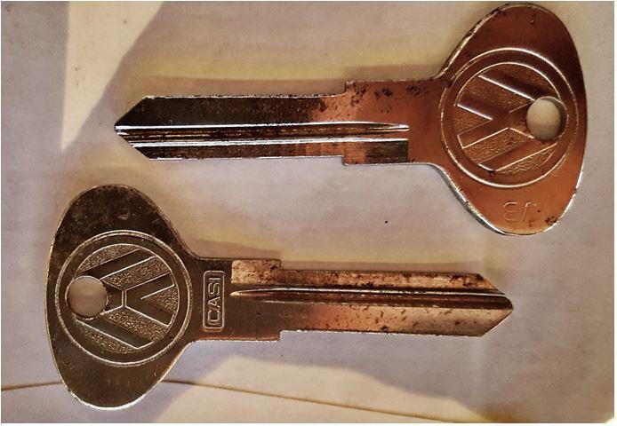

So why is this important right now? Because my keys are worn out...and I stumbled across a pair of NOS Steel blanks for a decent price. Very Happy ...get it done!
Here is the condition of my keys. The one on the top...the original lock set key...which I have complete....was always a problematic key set. I drove my car 50k miles a year. I went through about 2-3 of this odd skinny little key a year. They are just so narrow that they wore fast and occasionally got bent if caught sideways in a pocket.
So I took a lock set from another car I had...complete...numbered ignition and door handles. Its what is in there now but its keys are pocket worn to death.
I am going to cut a steel "master key" for each of these two door handle and ignition lock sets and put the original back in my car....because.....
Very Happy These two original Key steel blanks arrived from a gentleman in Poland today! They have a small amount of surface rust specs...but looking good actually!
As the guys who work on ACVW locks say.....blanks and punch codes may not always be available...so its ideal to get the best quality key blank you can and have a key punched as your reference key and store it.
You can have many keys cheap ground from that reference.....but its good not to use the reference key for daily. Store it someplace safe...and even take a close up picture of it...because in a pinch they can make you a key from that.
So why is an original quality "steel" key a good idea? On one hand the owner of a highly used daily driver car should use the standard aftermarket chrome plated brass keys....because they do not wear out the brass tumblers of the locks and ignition so much.
But the keys themselves wear out. When they start to get sticky....replace them. But over the years ...recutting a new key from a worn out brass key makes the locks work worse and worse.
Using a steel key daily...it does not wear much but the locks do. So keep the steel key safe and dry as the "factory accurate" pattern...and every other year...spend $2 and have a fresh brass key cut.

VW 411 and 412 key blanks types:
I will probably also have one each of these replacement steel blanks cut....for each lock set ...if I can afford it...simply because they are still available.
Do not wait to find actual NOS like I did. The ones GabVWkey sells that are dealer replacement are good enough. But....if you still have a fully together lock set...ignition, door handles and.or back hatch lock....as soon as possible I would make sure they are functional and buy a decent pattern key punched from code.....and look online and buy a handful of good quality brass blanks....you can get them for under a $1 each...and put them in your glove box.
