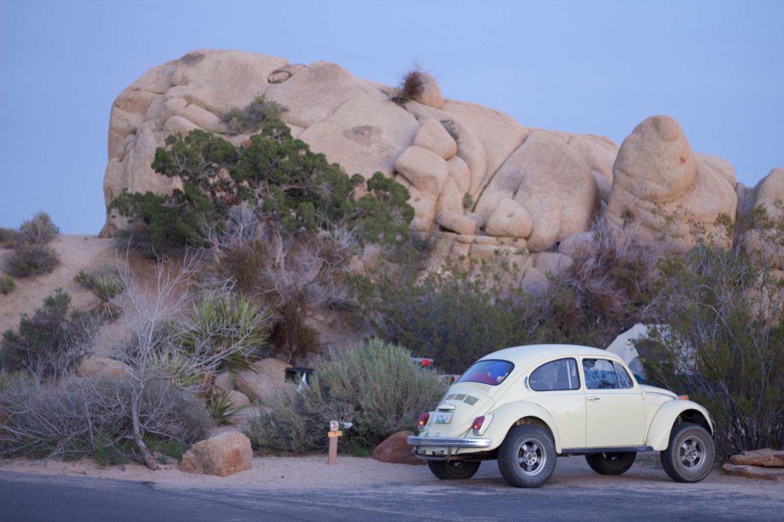

This is my Subaru powered Baja Bug.
I did get a little carried away sort of but it has a 3" body lift and is all coilover and has heat and ac. It is a pretty low dollar build as I built all the parts like the arms for the suspension, the roll cage and the body lift myself. Also in this pic it is riding on 4 BFG 30x9.5x15 tires.
I like the idea of a 911 Baja though a lot Smile

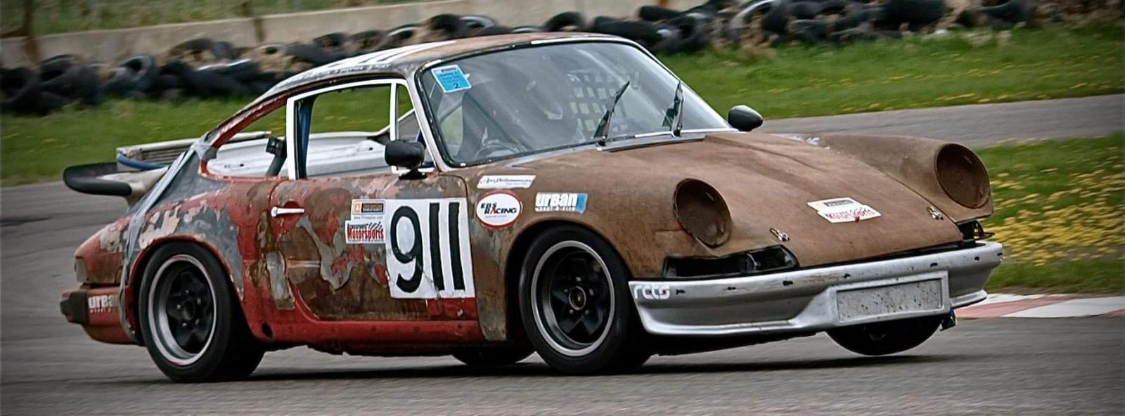

Well I did build this back in 2011. It’s a 73 911T with a 2.7 on modified zeniths with distributorless ignition. The suspension was all SC suspension.
I built it with a friend for the Chumpcar series. Once we got it sorted it was FAST! I sold it to a guy in the UK and it has been on the red carpet at the Autosport International show.
I plan to build another early 911 with a 2.7 (and have most of the parts needed) but that’s another project.

PostPosted: Thu Jan 10, 2019 3:09 am    Post subject: Re: Want to build a BAJA - clean slate - what would you do? Reply with quote
In that condition or after it was restored?
Pretty much. It has to look like a $500 car.
Safety equipment, wheels, tires were not included in the $500. This car was in a garage fire (actually caused it). We bought it for $175 and used a core 2.7 I had in a shed with an old 901 dog leg trans. The suspension came from a 78-83 parts car. We ran initially ran CIS injection but it gave us troubl so I custom built some Zeniths that looked stock.
The car had been previously restored by a local guy and there were what seemed like 100 credit card sized pieces of sheet metal welded into the front suspension, the front pan was replaced but they did it wrong so I spent a fair amount of time cutting out the junk and redoing it. The metal on it was so thin. That we stopped sandblasting the underside of the hood when I could see daylight. In the in car footage you could see the chassis flex in corners.
It was a ton of fun because I was less adverse to taking risks with it I would never do in my other track cars.
