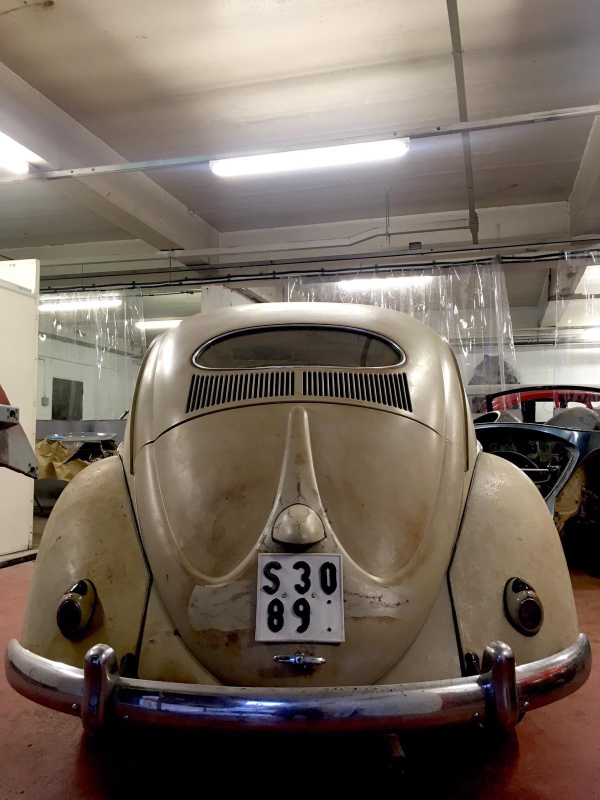

I have an OG paint 55 Beetle that came from Sweden. There is rust underneath the paint.
Id like to remove some of the staining if possible. Id considered using a rotory polisher to go over it but I dont want it to look too shiny.
How would you best approach this?

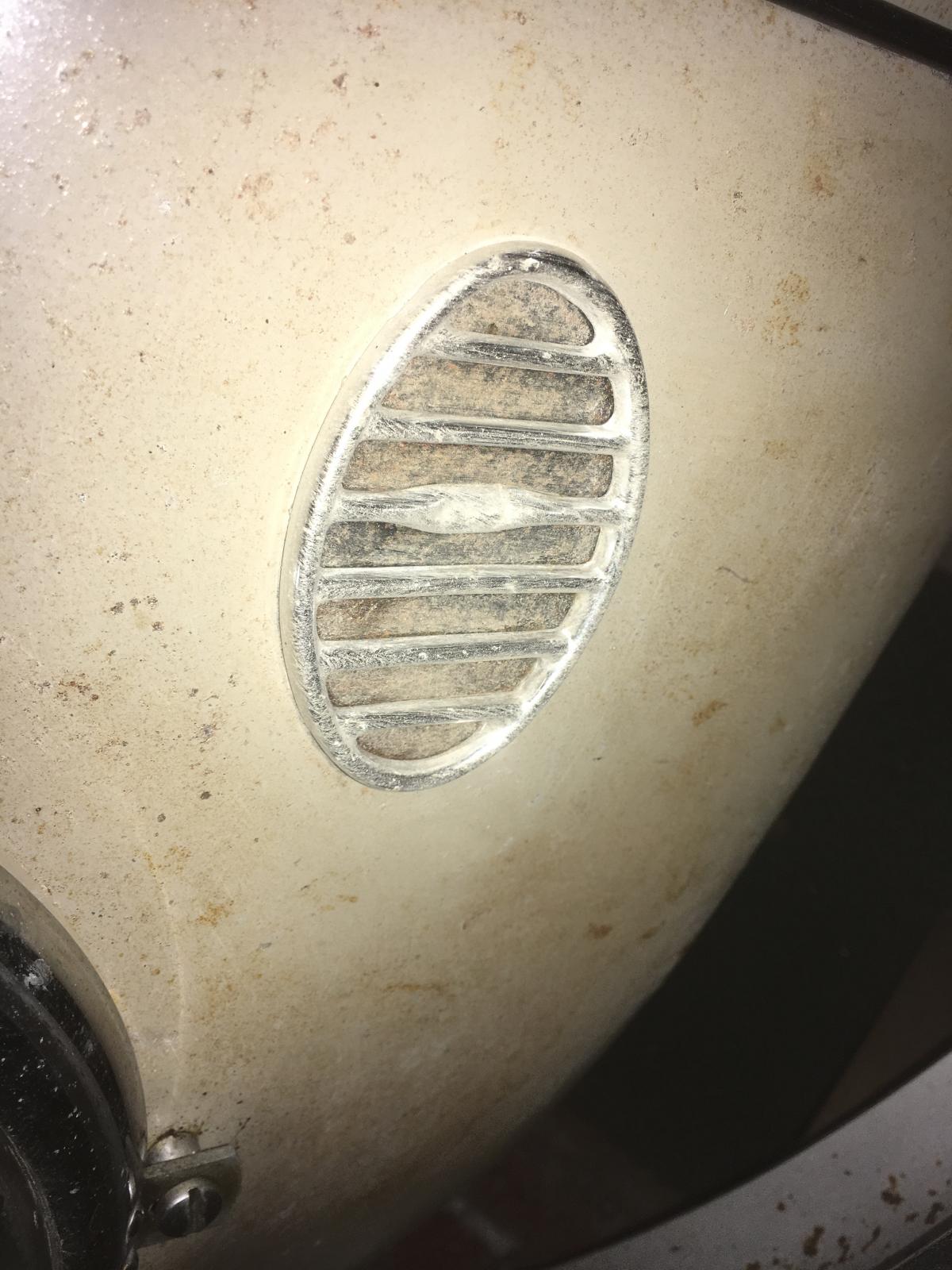

Close up:
I have heard of people using Anchor wax which I believe leaves a greasy surface which I wouldnt want, and Collinite 476 but have no idea as have never used either.... This is my first 'patina' car - my others have all been sanded and polished to death.

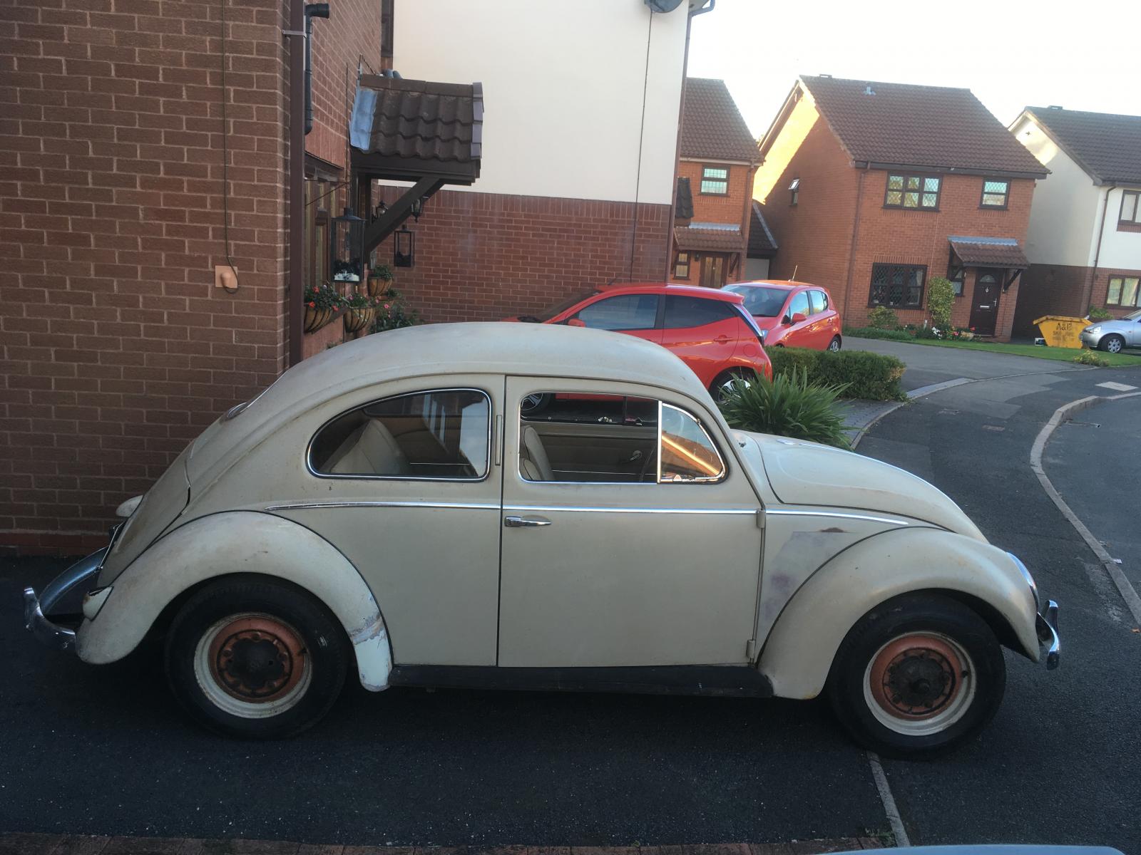

I dont fancy colour sanding and mopping it to be honest... the paint has loads of raised rusty bits - i tried a clay bar on it and it took the paint off the highs and left black marks... you can see the raised bits here:
I tried the CLR on a small patch with a grey scotch pad. This is the only product I could find - https://www.amazon.co.uk/gp/product/B0731HLFD4/ref...&psc=1
I tried it on a small area of my rear valance, and it just took the OG paint off right back to primer, so Im a bit cautious about using it, but the results do look great on here.
Iv got a bit of paint to get off the front quarter too, not sure the best way to approach this either:
Cheers
