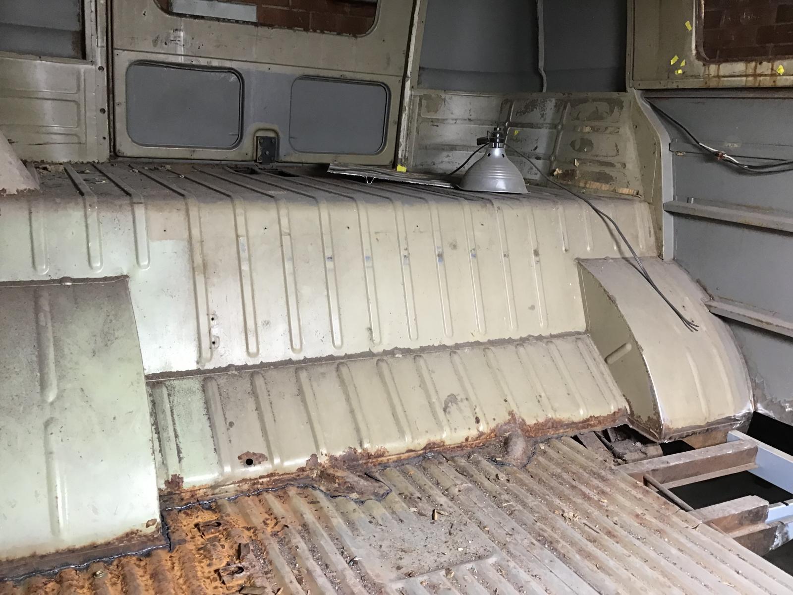

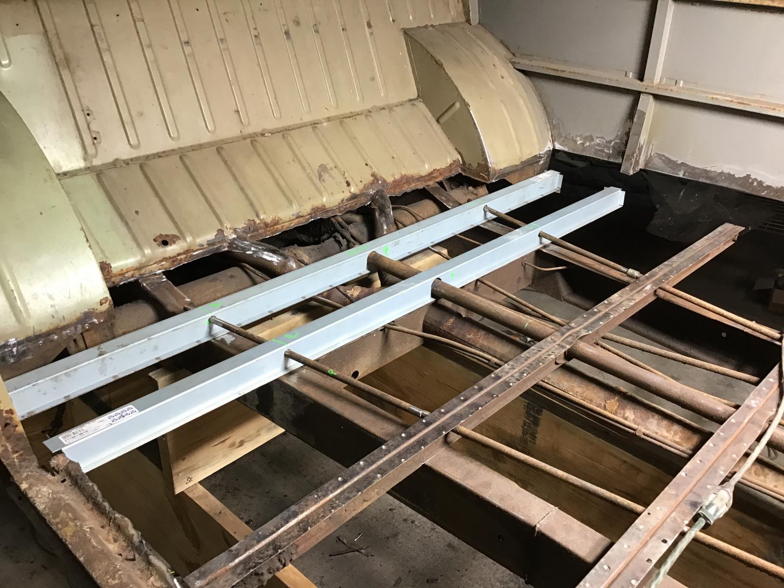

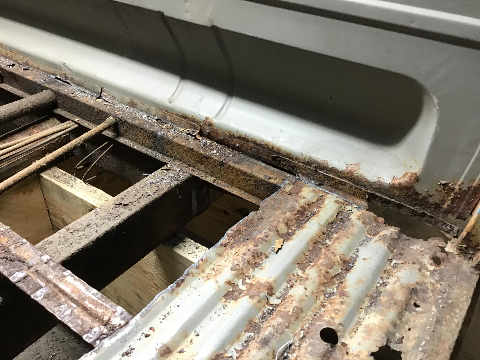

And now we are moving to the cargo area.
Sadly, we found that the front edge and rear edge of the cargo floor was riddled with pinholes, so we opted to replace the whole floor, which also gave us unfettered access to the top hats etc.
It is good to see some fresh metal in there, even if it is just to get a visual for the plan of attack.

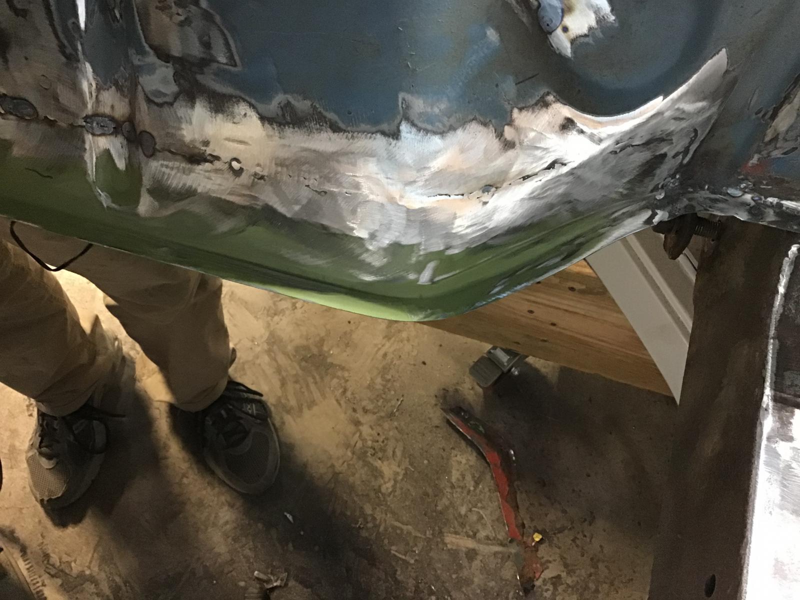

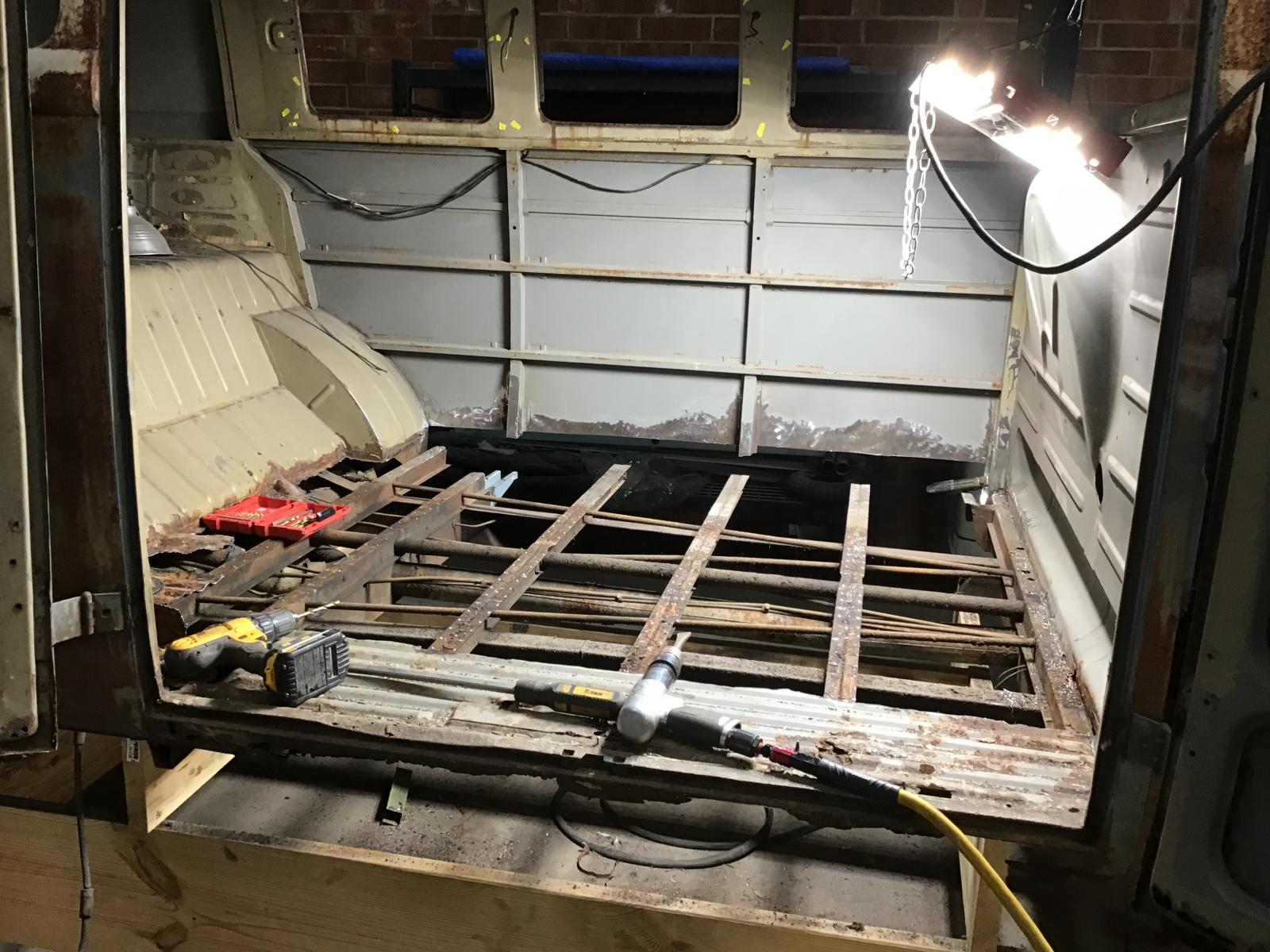

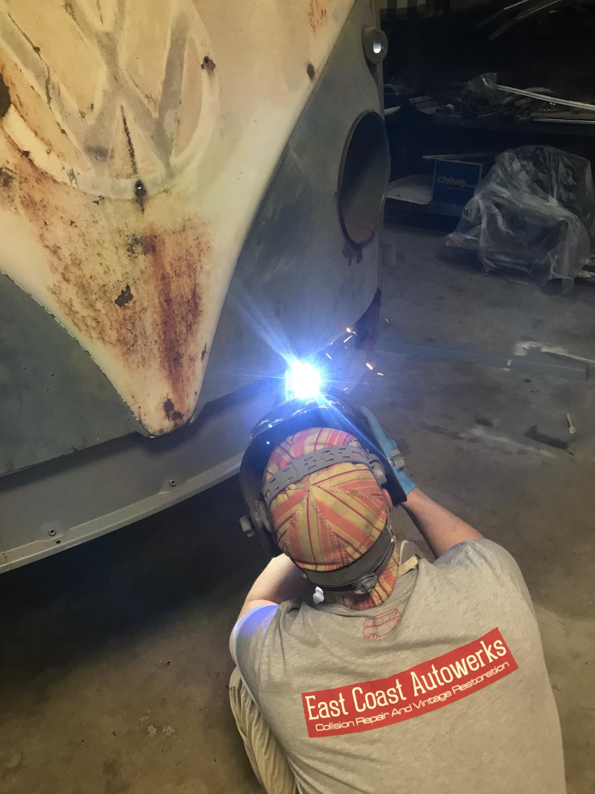

We made some serious progress today, and cut out almost all the rust and started welding some new metal back in its place.

Another big day of progress, but this time with less rust flasks in my hair.
We started welding in the panels and started fitting the front floor.
Sadly, I had to jump in the car and make a 5 hour drive back home while Oliver continued to fit and weld.

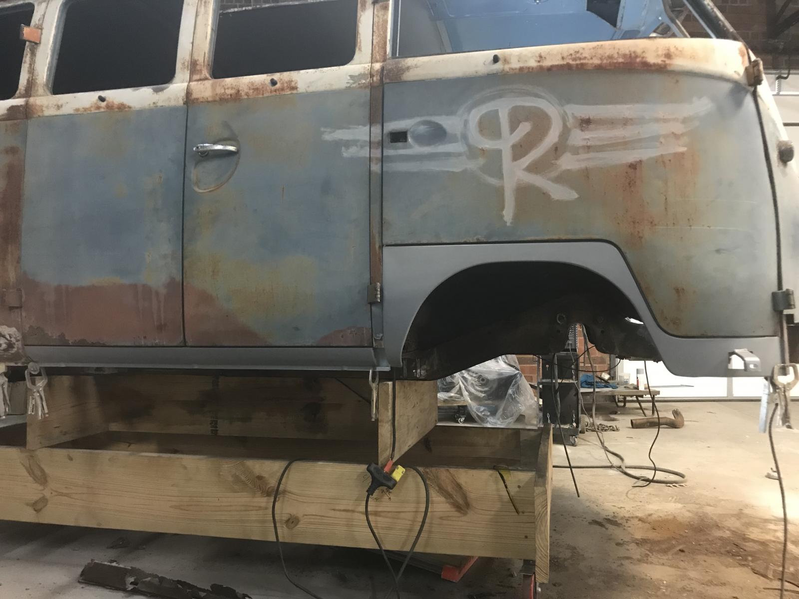

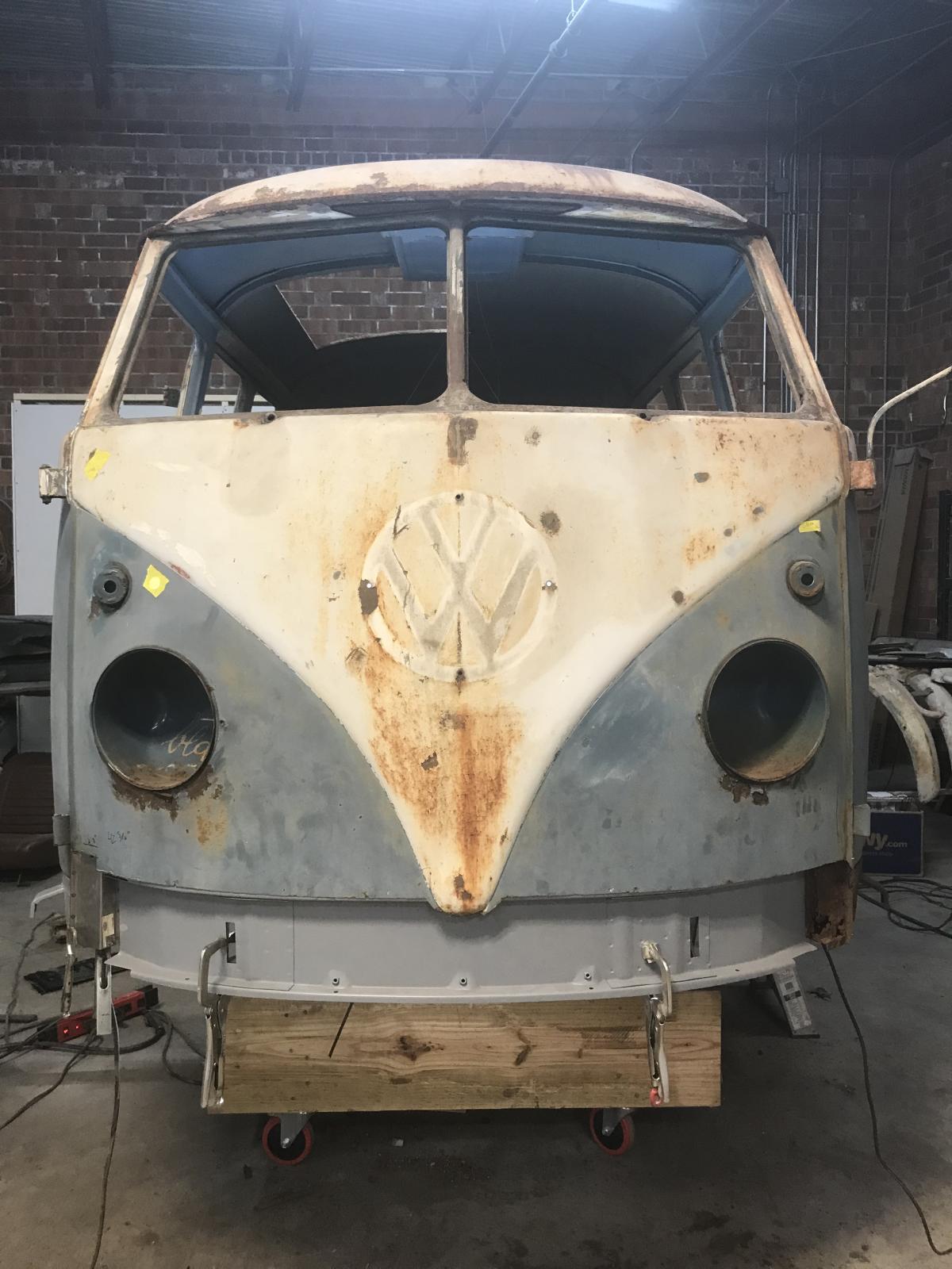

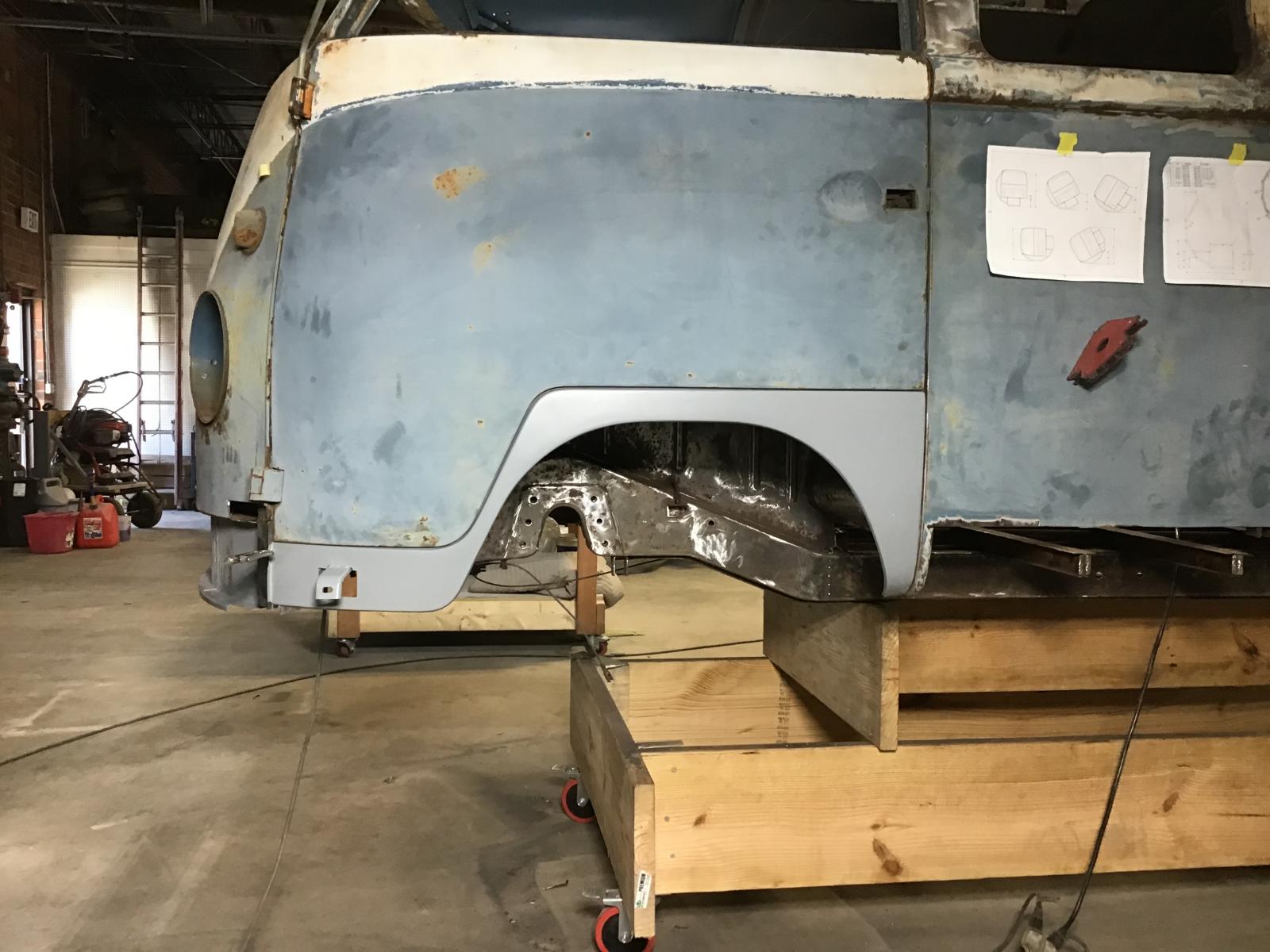

Don't worry about the wood, it is strong enough to hold the empty bus shell.
Despite that the wood looks thin, the planks measure about 45mm x 30cm and it is constructed like the base of a home.
Shortly, the bus will be transfered to a rotisserie, but we wanted to shore it up with new metal to prevent twisting when it is rotated.

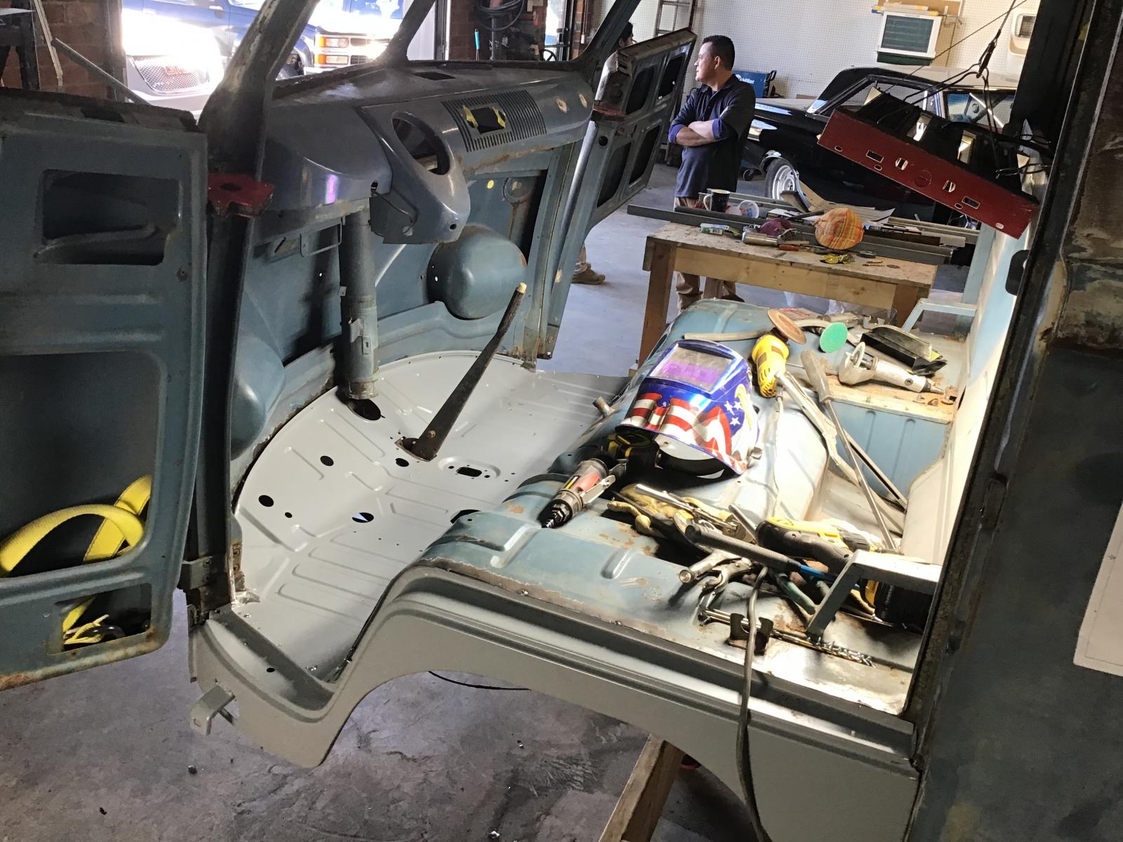

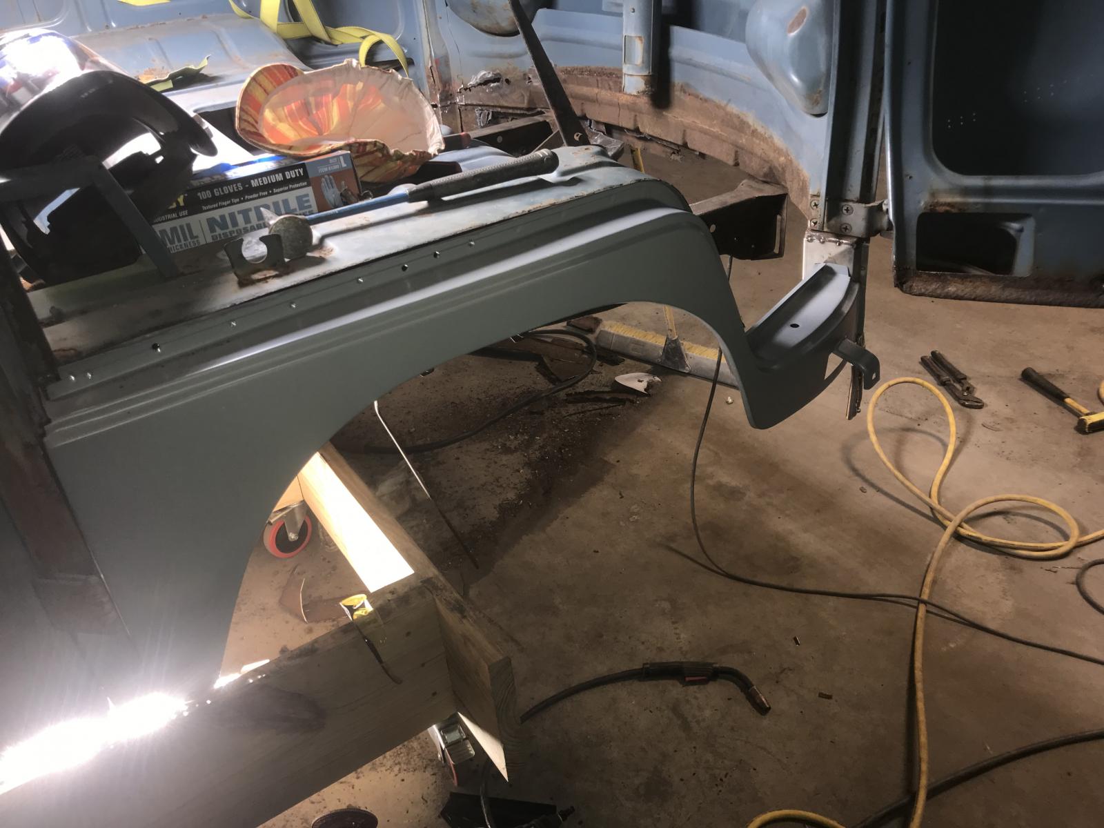

Big day of fitting and welding in the front.
The passenger dog leg is in, and the lower seat stand has been repaired.
This bus is tightening up nicely!

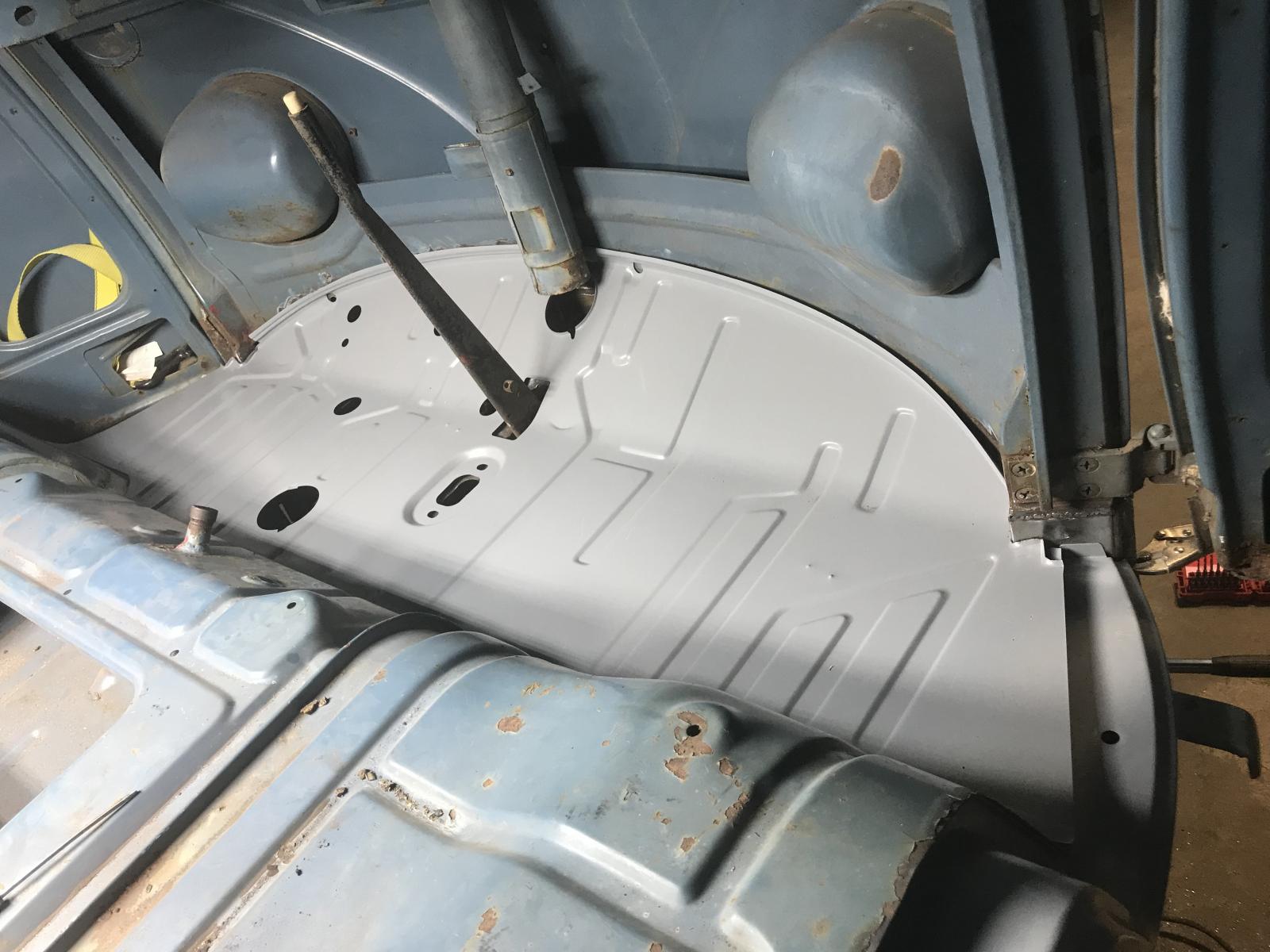

Oliver jammed on the drivers side dog leg today, and prepped the front floor to be welded in next weekend.
We have been well pleased with the fit and finish off all the Wolfsburg West panels, and the dog legs are especially nice.
Ok, enough talk, onto the pix.
The front floor is fitted, but will not be welded yet.
More to come next weekend, thanks for watching the progress.

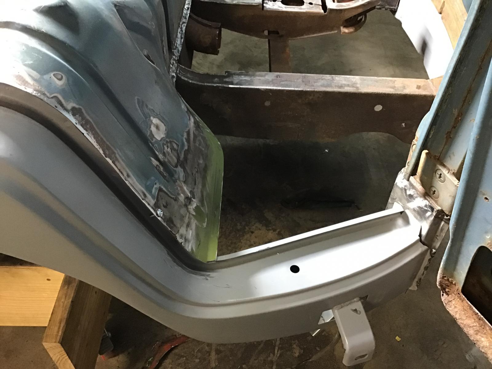

How are you guys welding the dogleg @ B pillar with the Wolfsburg West doglegs since they come with the inner spot welded to the outer? There is a inaccessible area where no welding can be done without cutting something.
npbusguy
Joined: February 08, 2006
Posts: 1665
Location: Budapest, Hungary
npbusguy is offline
PostPosted: Mon Feb 25, 2019 3:06 pm    Post subject: Re: 1960 SO23 Westy - New project Reply with quote
Good question, but one that we also had to address when we put the inner nose structure in, because we needed to make sure it was fully secured to the headlight support panel. We ended up using panel bond, which is a fancy 2 part epoxy that is used in the construction and repair of modern cars.
In this picture, you can see that we had to jack the panel in place a bit to create a tight bond all the way across. The goal was to cut as little of the solid original metal away, and that also made welding the inner structure difficult.
So, the doglegs are welded as you would expect, but also have a bead of panel bond where we couldn't access the 5 or so inches behind the inner box.
I'll be putting a dual circuit master cylinder in soon enough, because it is necessary for the disc brakes that we are fitting.
Thanks for the comments and following along.
