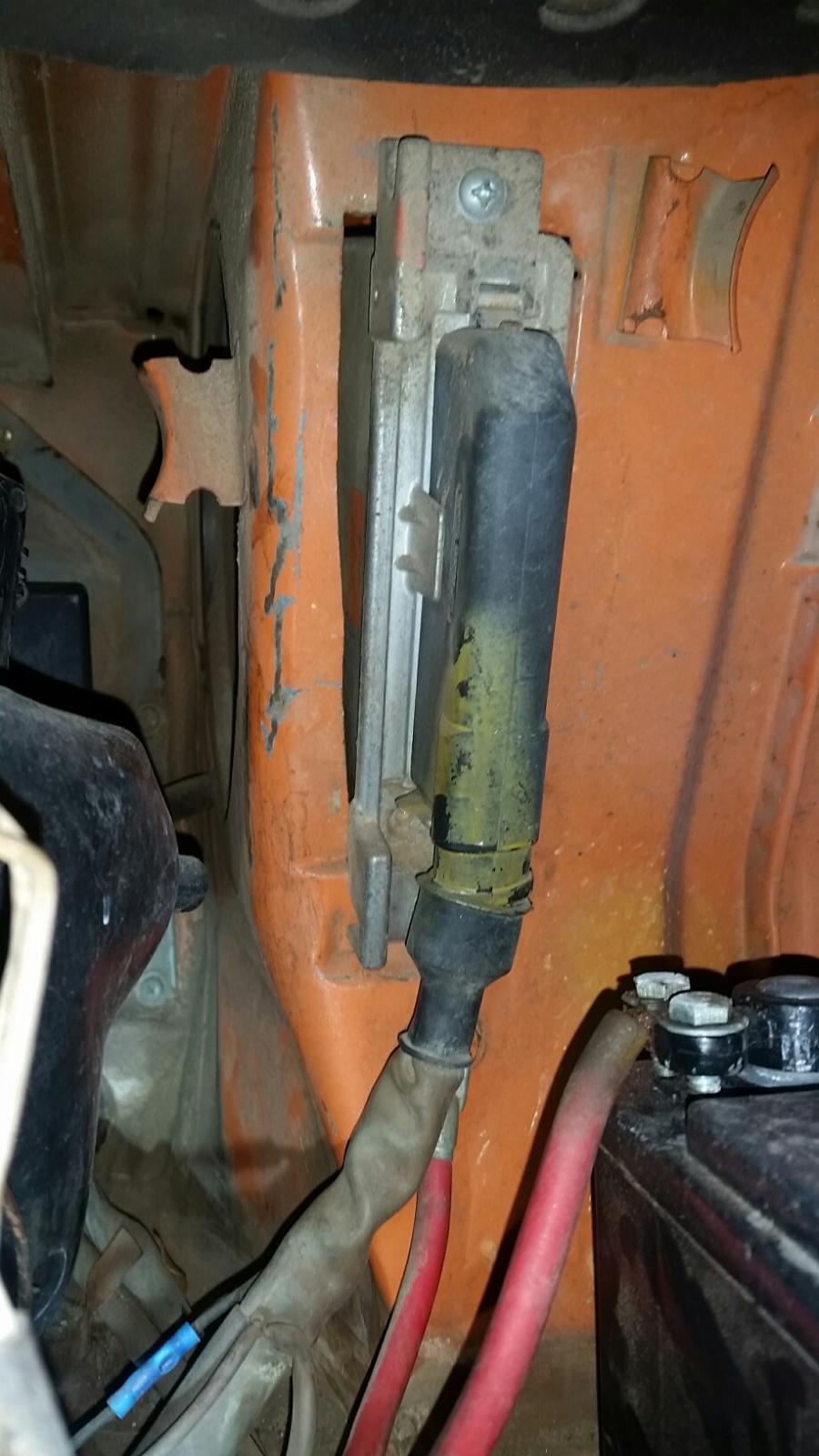

Hey Guys. I hope someone can help me out with a question. I have a 1973 bus with a single carbed 1.7L that was taken from from a 914. I recently bought a complete 2.0(GE code) with harness and computer to swap out with the 1.7 this winter. Looking ahead, I am trying to make heads or tails of what is left in my bus FI-wise. Whoever swapped the engine before I owned it, cut some wires and god knows what else.
I have the Bentley Book, but it only covers FI from 75 and up. I know i'm missing the ballast resistor. I was wondering if someone can tell me what this plug is? Nothing on the harness from the 79 fits it. From it, there's a large gauge wire that has been cut.
Any info is appreciated.
Chadd[/img]

that is a vw diagnostic plug that has nothing to do with FI. I doubt your 73 had it. it was an option that early
edit-do you have the rectangular hole for the big electronics box in the right rear of the engine compartment? that would be a tell if your bus had FI.
here is where I stole the pic. a cali 73 with FI? the hole is not factory I think.

I don't see a hole in the background of the test network plug shot.
FI was not available on a 73, it started in 75 (mid 74 on Cali automatics). That doesn't mean you can't cut a hole for the ECU and add a return line to your fuel tank, as long as you have all the FI components with the donor engine.
