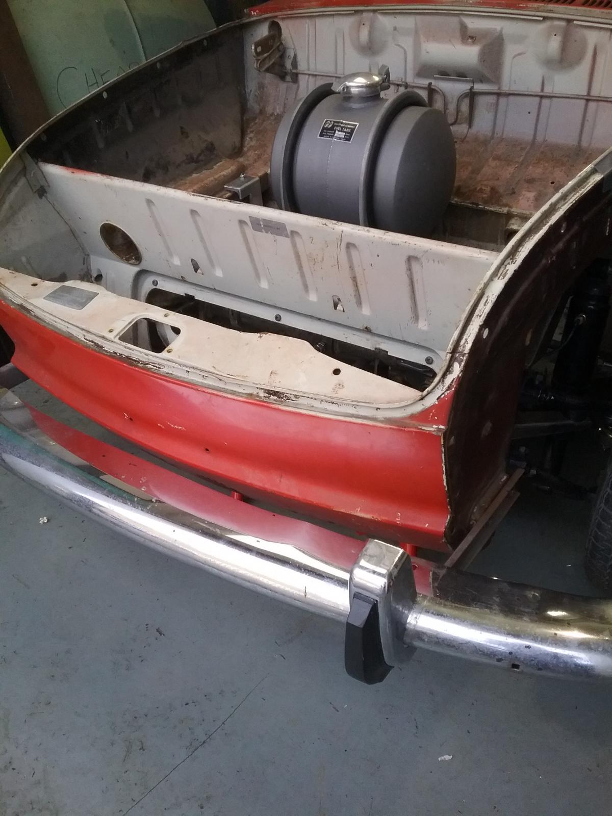

Here we are setting the height of the Moon tank support. The check is to make sure the tank is below the height of the front hood.

The checking is on my '61 Notch which is the same as the Squareback in terms of the inner wings.

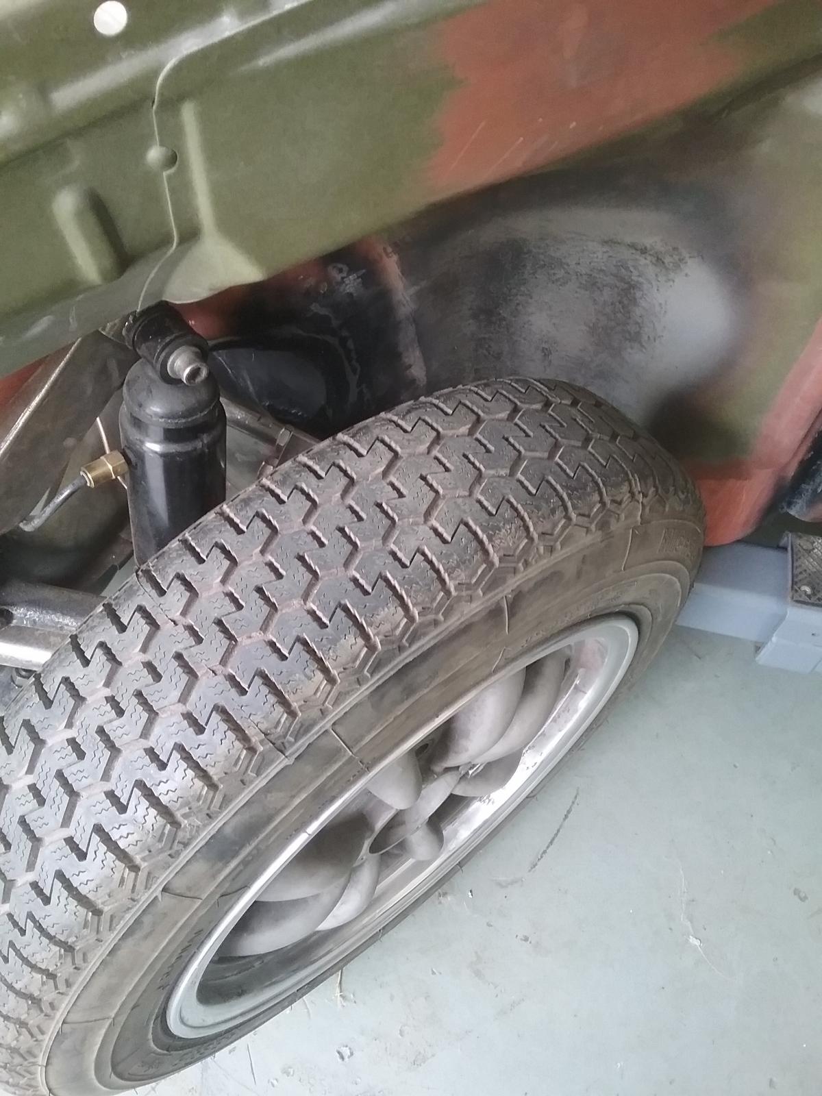

A lot of t3''s have a reduced turning circle with a narrowed beam. The tyres can scrub the inner wings. To overcome the problem we have heated the inner wings and carfully hammered them back keeping a curve. It takes about 3 hours per side.
It's not everyday day you see a Michelin XZX's. Did you cycle the front end thru it's full range of motion while adjusting the inner fender? Just asking, as it's easier to do now, than it is after it's painted. Don't forget to add some weight when you do, as it'll have a driver in it at some point. Wink

The picture show the removal of the bump stops from the swing arm..
We carefuly cut out the bump stops and welded up the area. This allows the use of the EMPI 8 spokes and large tyres. The tyres will be Firestone wide ovals.. They have released radial versions of the tyre. Previously they were only available in bias, which would make them illegal in England if you used Michelin radials on the front.

PostPosted: Mon Feb 18, 2019 2:44 pm    Post subject: Re: Uno Momento (Vintage Squareback show car) Reply with quote
The sway away spring plates are a nice touch.
The t-3 pan in the background looks good. Very Happy

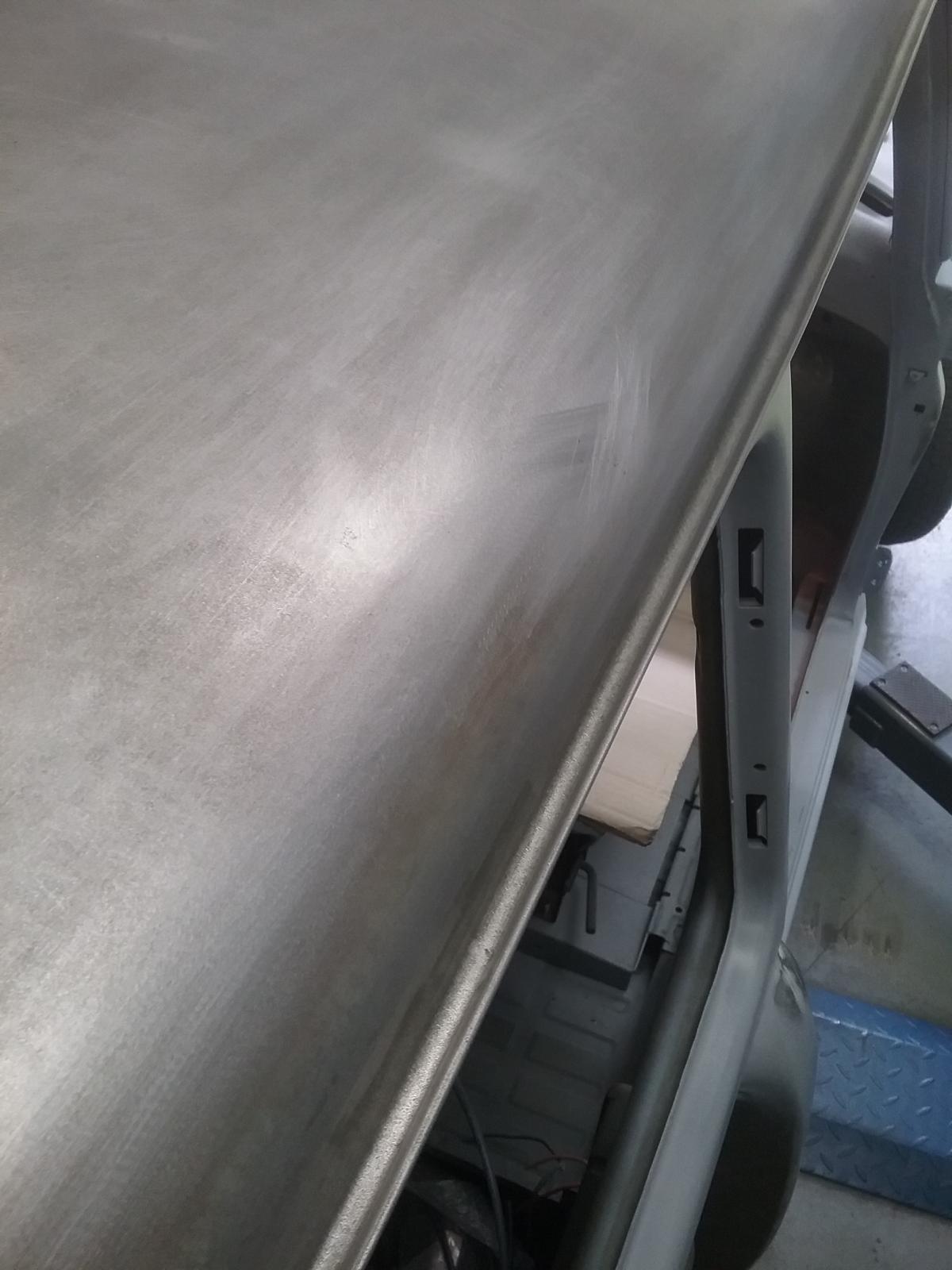

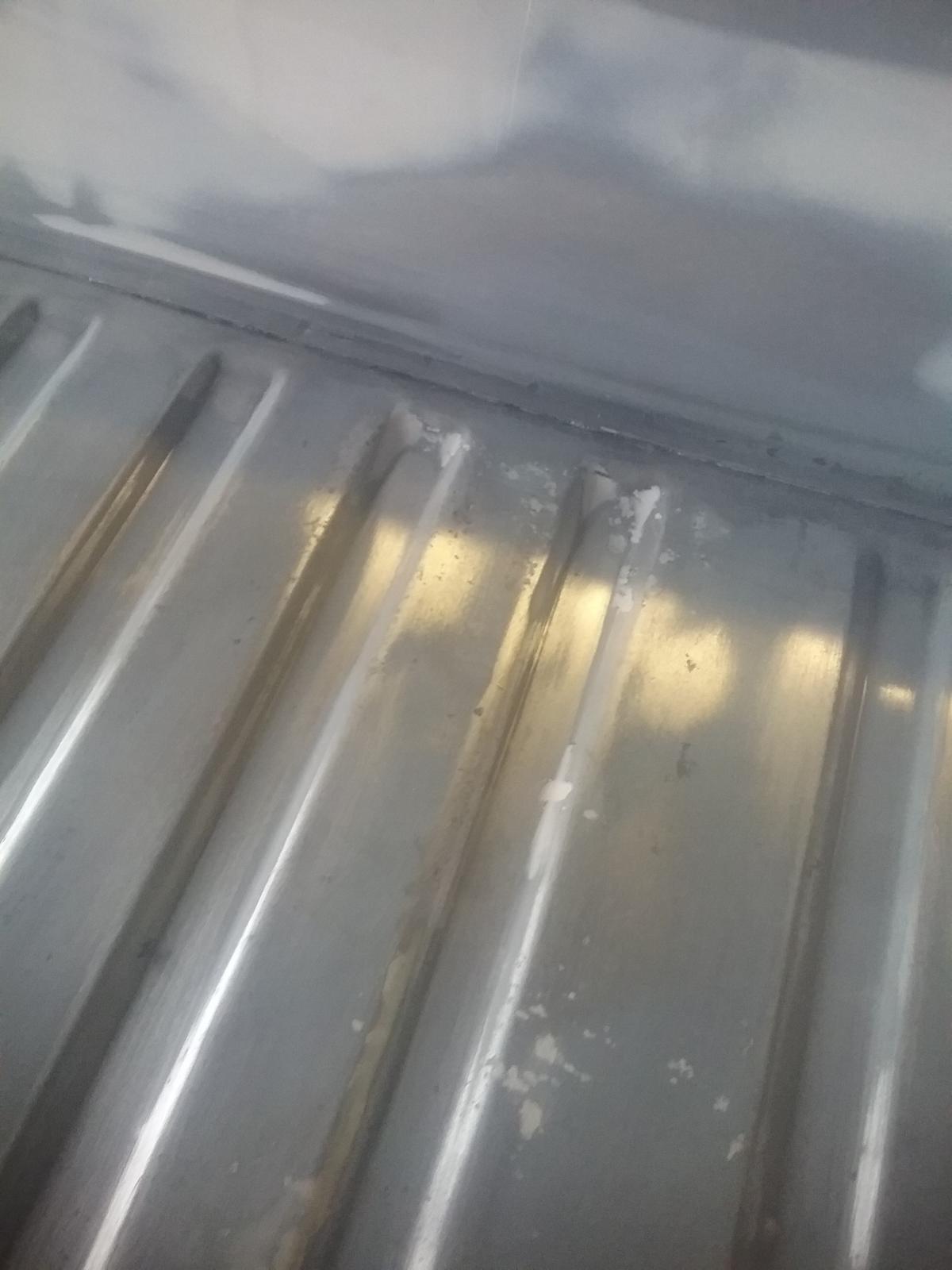

Preparing the floorpan has been a massive task.
We used a special 'light' filler. Using a tougher filler causes problems. It breaks out when you are sanding less than 0.5 mm and are trying to get a smooth edge.
Gareth spent say 30hrs roughing out, and they recon I spent over 300 hour's !!!!!
Both sides were prepared because the car will not have carpet in.. The pressings in the floorpan mean it would be near impossible to flat it after paint without going through on say corners. It meant it had to be 'Straight out of the gun', so it had to be as perfect in primer as is possible.

PostPosted: Sat Feb 23, 2019 12:59 pm    Post subject: Re: Uno Momento (Vintage Squareback show car) Reply with quote
The floorpan is a main feature of the car.
There will be no carpets in it so it has to be as good as we can get it. I have around 300 hours in it to do the both sides. Alan and Gareth Wooton have also put in hours.
The tiny corners in the ribs are the worst, Here we used the foam backed rubbing pads.

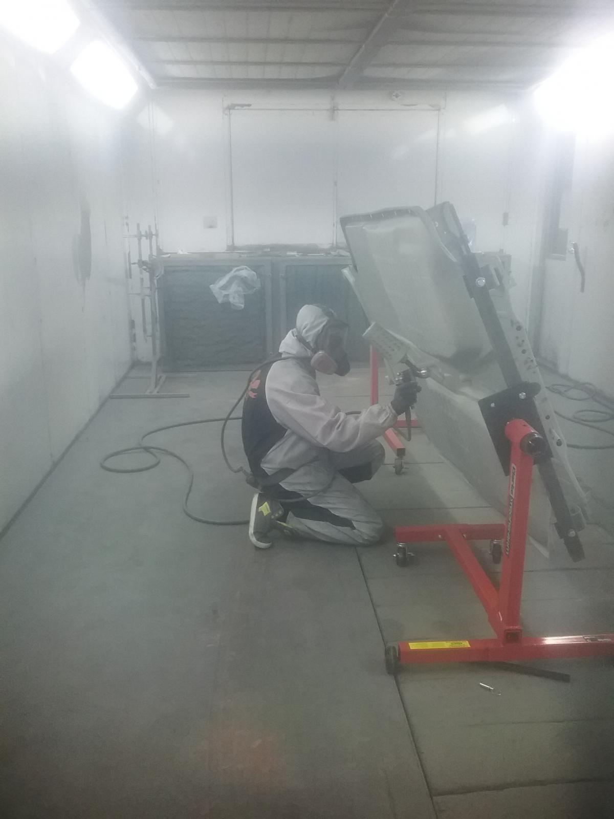

Alan Wootton spraying the first coats of etch primer onto the floorpan. The modified engine stands allow it to be rotated. Air blown to remove any dust, prep wiped, tack ragged and sprayed.

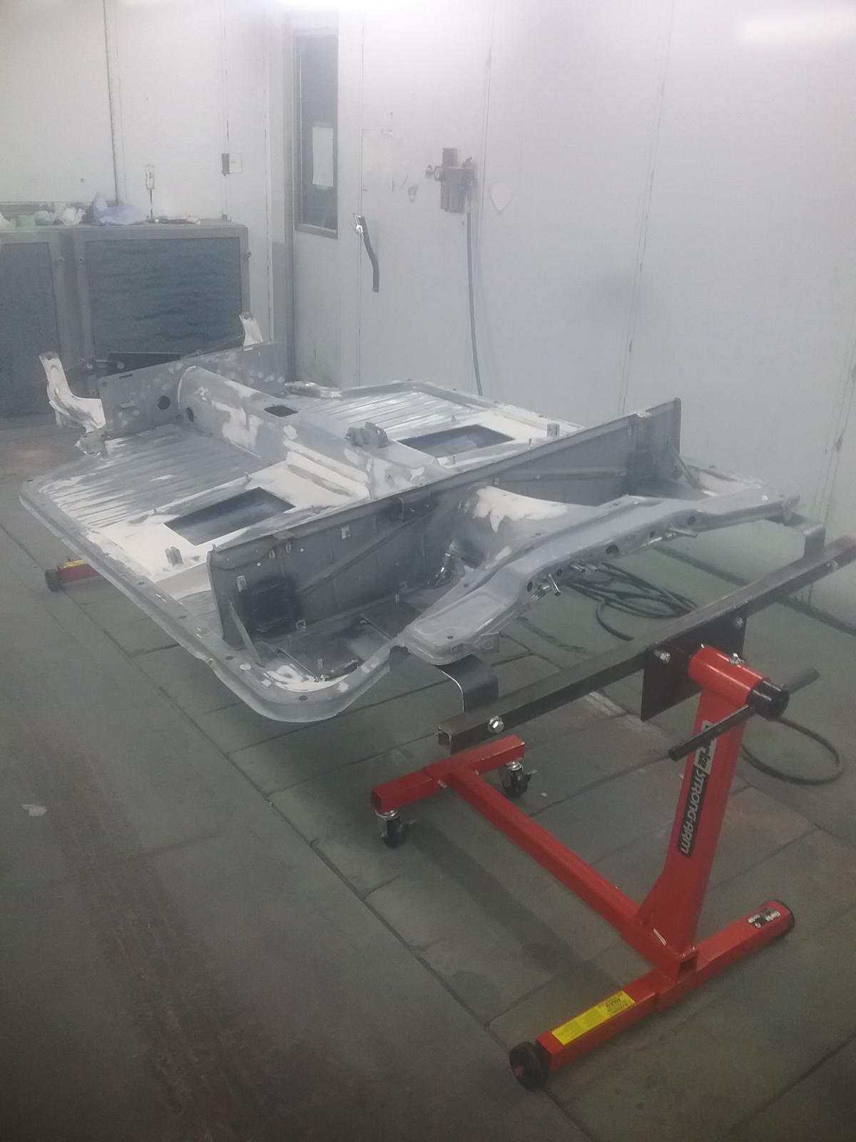

Final painting of the floorpan by Alan Wootton...
The picture also shows the seat bases welded in, and the heater ducts removed from the rear panel.
To show the floorpan the car will have no carpets, just mats for when it is driven.
