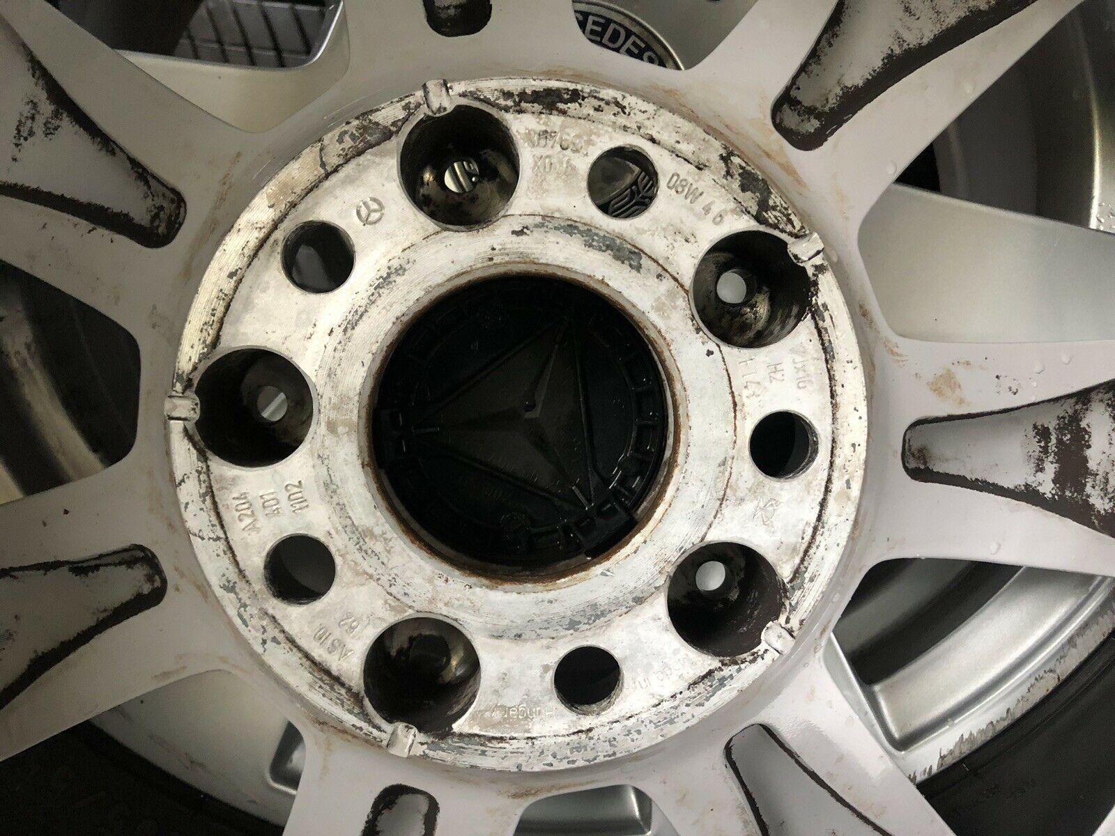

Has anyone tried these Mercedes wheels? From what I have seen the dimensions should work.

PostPosted: Tue May 14, 2019 3:51 pm    Post subject: Re: "What wheels fit?" The ultimate wheel post. Reply with quote
You mean like this? I think were covered in this thread a few pages back. Those are on my van. Pretty straight forward fitting and a good offset.

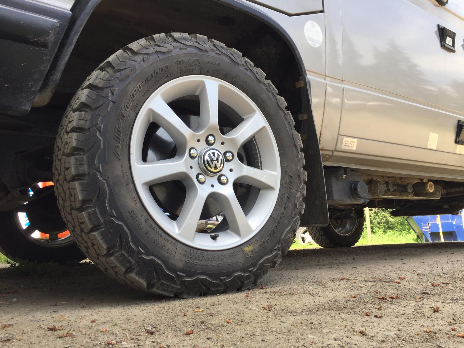

Awesome thanks for the quick response! You don't happen to have a complete side view of your van do you?
Thanks again!
jordauto
Joined: August 12, 2011
Posts: 218
Location: Sorrento,BC
jordauto is offline
PostPosted: Tue May 14, 2019 4:06 pm    Post subject: Re: "What wheels fit?" The ultimate wheel post. Reply with quote
Sure. Here you go.

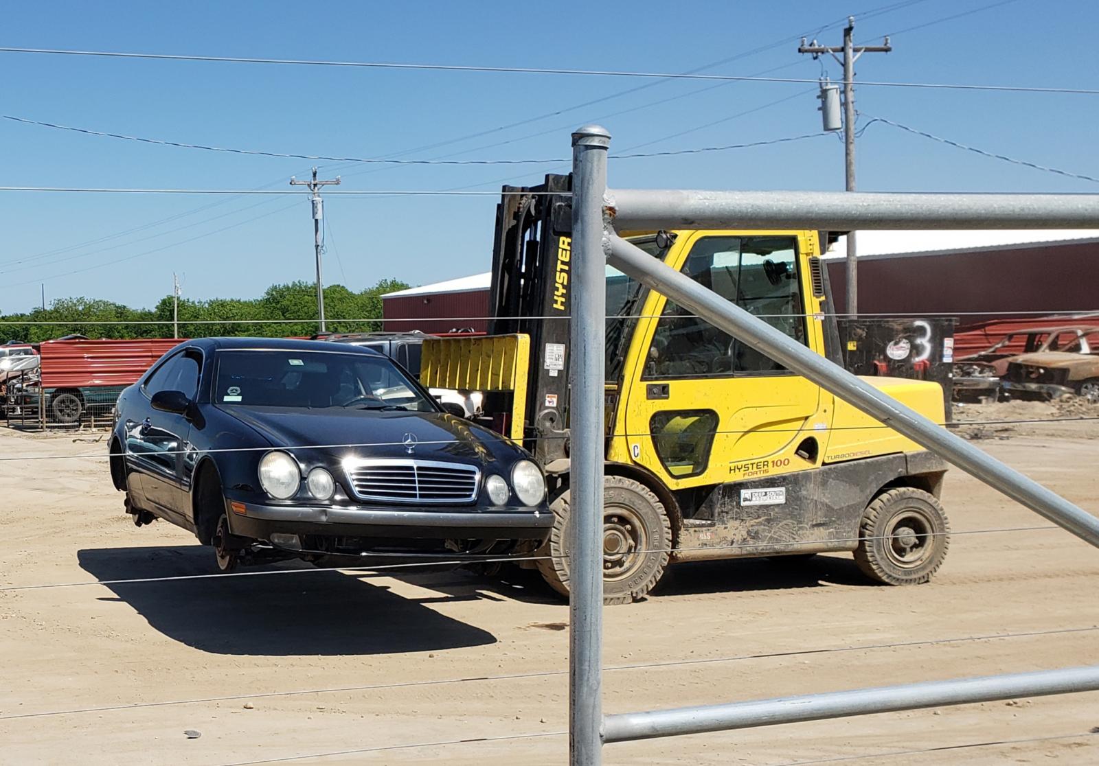

Thanks for the info. I ended up buying a 1998 CLK320 with the correct wheels. It had some kind of ARS code and with 164k wasn't worth trying to fix for me. They seemed the way to go with the info I received here and from Christopher at t3. Thanks for the help! Pulled the wheels and took the rest to the salvage yard. Made out better than buying them anywhere I have seen them priced with almost new tires.
