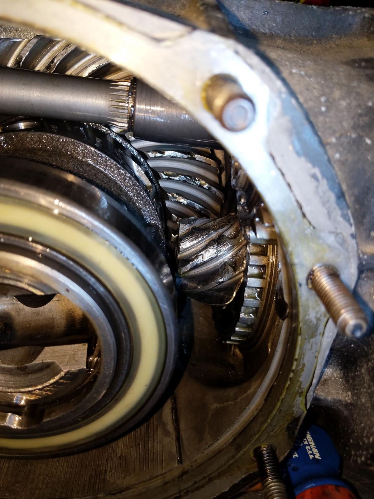

Trans is out and axles are on the floor. Axles and fulcrum looks just fine. I guess I need to open the gear box...I'm going to need help with this one as I've never done any transaxle work deeper than this. I'm going to pull the side plates and inspect, from there I'm not sure what else to look for other than the ring gear.

You got photos of axle spade ends, fulcrums and side gears? I'm assuming it's got a superdiff?

Do you know who built the trans? If it's a Pro Street, most places would be willing to discuss it with you even if you aren't the one who actually purchased it.. They might prefer talking about it with you before you take it apart..

Yep, super diff pro street transaxle. It was built 7 years ago by a somewhat well known shop. I wanted to learn from the experience, but now that I know it's a ring and pinion issue I'll probably call the shop and get their take on some replacement parts.
I pulled the side plates and the bottom of the case is full of metal chunks and most of the ring and pinion is destroyed!
I'm going to call the shop as this was about a 1700 trans a few years back. Worst case I'm going to learn something new.

I called that one! About 700 -750 to rebuild. With a g4.12 ring and pinion.

Either the r&p wasn’t set up right to begin with, or someone really flogged the shit out of that car. It’s been a long time since I’ve seen someone trash a 3.88 r&p on the street with street tires.

......For what it's worth it's a 180 how 2387 with a 3.88 ring and pinion and super diff pro street box......
We both know 99% of everyone’s “prostreet” box has a 3.80 1st. If it’s got a 3.80 1st with VW swingaxles, I would of thought they would have broken LONG before the r&p.
scottf1887 wrote:
Who knows, I'd like to think it was improperly set up but who knows. It is a 3.88, or it was...
A 2387 isn’t built to go get groceries, but you would at least hope it was used, instead of abused. Your otherwise innocent push on the pedal may simply have been the knock on the Devil’s door he decided to answer.

Well, I have the gearbox here. It seems some one built a drag box and found 4t was useless. So someone swapped in a .89 fourth,,,,,,,, with the shittyest weld job I have ever seen, also it appears the same "mechanic" must have changed the diff, as it was as far off as I have ever seen! Had to add 7.95mm just to get .006 bearing preload!!!!!!
Shocked
Well, at least that answers that question. Surprised it lived as long as it did. Was it on the ring side cover? I was helping a buddy install a “built” swing axle that didn’t appear to have the diff bearing seated fully in the hd side cover. I was able to get .040 worth of feeler gauges in beside the bearing, so we took it apart, and made it right. Luckily it had not been run in a vehicle yet.
