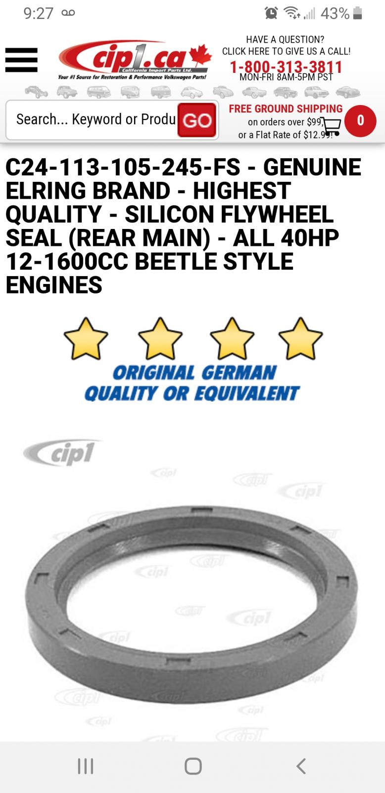

I will look into getting a seal puller tool.
This is the rear main seal i ordered.

Polish the flywheel surface where the seal rides with 400-1000 grit paper.
Lube the seal lip and FW surface with oil before you put the FW back on.
I drill an extra drain hole in the case as FWs these days are usually not perfect and this helps the oil drain better, and does not let 1oz sit against the seal when parked like the Germans designed. If everything is not perfect this 1oz ends up on your driveway. The OEG drain hole is at 8 o'clock and I drill one at the bottom, this can be done with the engine assembled or disassembled.

Polish the area were the seal sits, as mentioned lube the seal or it can burn up on your first start up.
ALSO--- ONLY PUSH the seal in til it is flush with the case, No more.
