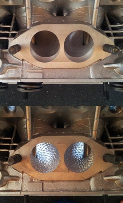

Why do you want to waste your time and money experimenting with polishing chambers when it has been proven by hundreds of engine builders of all types of engines that a rough finish produces more power.

Because I just made more power and torque then explainable.
My dyno pulls are modest, careful, and getting 162 ft lbs of torque/165hp with only .491 lift and the belt on is better then most. Not only that, after more tuning in the car, it performs much better then those numbers suggest.
I think 12's are possible with this combo on street tires. I don't know about those 100's of builders, but if I can get 12's out of a N/A VW engine with only .491 lift,IDF's, full weight street car Its worth the experiment.

I used to polish all of my chambers and exhaust ports up to 250gr. Certainly not mirrors like yours, but I did spend hours on them and made lots of dust. I did that for the first 5-10 engines. I got tired of that and started leaving them at 80gr cartridge roll finish, and they seemed to run better. I did this for a long time. Then I started researching rough finishes and went that way. Every engine I have done it on tunes easy, has super quick throttle reaponse, and seems to use less jetting. Even less on the accelerator pump shots. Not real scientific, but it's all I have based on quiet a few engines, and getting to test/tune most all of them in my own test car.
The 2332cc in my baywindow has super rough ports very similar to the picture I posted. The final jetting on it is 47.5 idles, 140 mains, 210 airs, and the pump rod nuts are less then 1/8" on the rod. 36mm vents in 44idfs. On our 2000mile road trip we got 22mpg at 70mph across Nebraska in a loaded baywindow. That was 12.0-13.5 across the board on the wideband and a NON-vac dist. Not sure what other people with similar setups are getting, but this is quite a bit less jet then I have used in previous large engines I built.
The 2332cc in my baywindow has super rough ports very similar to the picture I posted. . .
Brian
I have a theory that might explain that:
Perhaps stopping at 250 grit is not sufficiently smooth to get the benefit of a mirror finish, which is north of 3000-4000 grit, nor is it sufficiently rough to promote the rapid carbon build-up that an 80 grit surface would. Carbon is a fairly good thermal barrier, and a good, thick layer of it might give you similar results to a mirror-finished surface. It's just a theory.
My ports are super rough as well, and I have also noticed a sharp reduction in the size of jets my engine calls for, especially the accelerator pump.
Here's another wacko experiment for you try, Jeff!

horizontally gas porting and .030"rings will make more power.and seal better too. there are all kinds of stuff that can help power and reliability too. you could possiably take all the tension out of a set of rings and gass port it, but I dont know how that will work.
Just like everyone else here, I wish I had a dyno and more time to experiment and post the results. Then we would all be learning more.
Brian
Hey don't be to proud of ending up with smaller jets in that big engine, especially with that rich of a A/F cause that means your making less power too lol. Even your accelerator pumps are doing less! Laughing You shouldn't admit that! For realz, if you can only burn that much gas, it means your combustion chamber is not getting hot enough. Its not helping that the inside of your chamber is acting like a big internal heat sink because its so rough.
Like FloatingVW said, to achieve what we are wanting, keeping more of the heat inside the chamber, we wanted the effect of a sealed off room and smoothing it to a mirror was the goal. Zero porosity and the least amount of surface area. In the chamber, heat makes power. Everywhere else we want to shed heat.
I will say that it makes total sense that rough gets better mixing of air/fuel. So the value of mixing vs the value of heat, that is the question.
At this point, by theory alone, I should have the most horrible mixing vw engine alive. It should be "horrible to tune" by most everyones standards. Not only the polished chambers, but the intake valves are polished top and bottom so fuel beads off like a freshly waxed car(not a good trait for mixing). The intake ports are completely smooth. Not mirror, but they are smooth. The only thing that does not have a smooth surface are the complete length of the inside of the intake manifolds.
However, that being said, with the complete internal pathways of the 48 idf's polished, intakes ports contoured for airspeed, intake valves polished, combustion chambers polished, I bet the airspeed is pretty damn fast, which in itself will help atomization. If we were neighbors I would wheel my dyno over to your shop for you to use, then I would be borrowing your air probe equipment to test airspeed.
These ancient air cooled vw's were behind there times even when they were produced. Its all just fun stuff to play with. Yes, only so many hours in the day, one man can only do so much.
If you get a dyno going, and play with some heads both ways, I bet you find the polished chamber heads on the identical engine tune properly with larger jets, and make more power, and the rough heat sink chamber heads tune properly with smaller jets and make less power. But just my guess.......
#Stirringitupmore

Ohhh, dimpelled intake surfaces. That´s another one of those cans of worms. The first time (that I know of) this was up was in the late 60íes when BMW was working with the 2002 Tii. The exersize was of course to gain power, but what they found, with the porting techiniques and knowledge they had the time, was that it did not improve hp., but it helped the engine to improve fuel mix and torque in the lower to mid rpms. As injectors and injector position became better the need for this costly surface treat became not nessessary to get the same end result. In recent years this has surfaced again. I think it was Edelweis tuning that brought it up again in an effort to stand out from the crowd in the BMW and motorcycle world, also claiming 5% improved flow over smooth surface ports. Some Honda tuners claim the same. https://www.youtube.com/watch?v=U6v2wpk4mjo But do they make more power (?)
Now, in a carburetted engine some of it begins to make a little sense, because "we" have the issue of a fuel mix that is not especially good atomized in the lower rpms. If you want to take advantage of that you should keep the port rough in the low speed areas and smooth in the high speed areas. That requires a little knowledge about how the mix behaves in an intake port, but this is actually beneficial. In fact when I build my Std plus engines I leave the surfaces raw almost all over to get a better mix and power in the lower rpms.
Raw or smooth surfaces in the combustion chamber. I for one really don´t know. There can be pro´s and con´s to both. On a freshly built engine I can see that there may be differences. On an engine that has seen some miles I doubt you will be able to measure much of a difference due to carbon build up. I think it is more beneficial to both power, temperature and fuel consumption to get the combo right and to have a good chamber shape to get a good mix and a burn that does not require a lot of ignition timing. That reduces the need for fuel due to simple efficiency and reduced pumping losses.
Here is a couple of articles discussing why they left it out in Formula1 years back.
http://www.formula1-dictionary.net/dimpled_surface_finish.html
http://speed.academy/10-myths-of-cylinder-head-porting/

I didn't have any reason to think my 2332cc was down on power. I have seen what quite a few different engines will do on the long hill behind my house, and this one is one of the more impressive of the 15 or so big strokers and 15-20 smaller engines I have driven up the hill.
I feel if the engine can make more power while requiring less fuel, it is obviously more efficient.
I agree with Torben's comment on rough port texture helping low and midrange torque the most. I have been building my engines different for the last few years now. I focus on highest average torque across the board, and I don't even care what the peak HP number is. I have found engines that make a pile of torque before 4000rpm are usually quicker up the hill, more fun to drive around town, much more pleasant to drive on twisty mountain roads, etc. This is the area I am focused on, and the increased fuel mix far outweighs high RPM heat retention in my mind.
Remember everyone...torque pulls trailers, climbs mountains and wins races....HP sells cars to those who don't know any better. Laughing
Here is a really good article from a very very experienced engine builder who has been building engines longer then most here have been alive. Myself included. The port texture stuff is down toward the bottom, but the whole thing is a good read. He has done real life A-B-A dyno testing more then once on this topic.
https://hotrodenginetech.com/pipemax-creator-larry-meaux-on-race-engine-head-porting/
Jeff, while your heads are off can you measure a few things for me? I would like to compare a few things on your heads with others I have bought or built myself, and run on different engines.
-Intake port centerline. I use a piece of solder with the valve installed. On the long side wall, go from the back of the valve to the intake flange. bend the solder so it conforms nicely to the port wall. Make a mark on the solder. Next do the same thing on the short side port wall. Flatten the solder back out and add the two marked lengths of solder together and divide by 2. This will be the "average" intake port centerline length. You can also do this with pinstripe tape.
-Intake port volume. I like to use washer fluid, and I have a small piece of plexi with a hole to cover the port flange. Just like measuring chambers.
-Intake flow from .250"-.550" @ 28" with the intake on and a radius at the top of the manifold.
