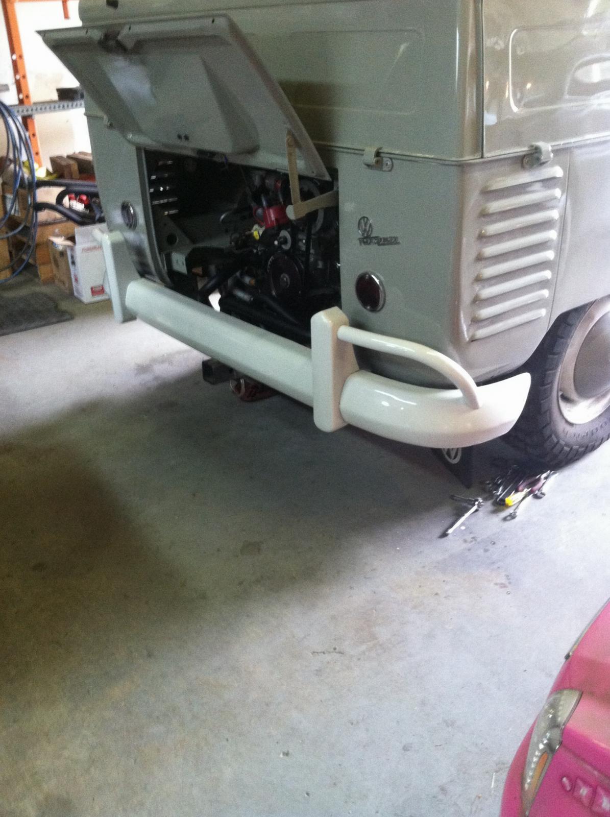

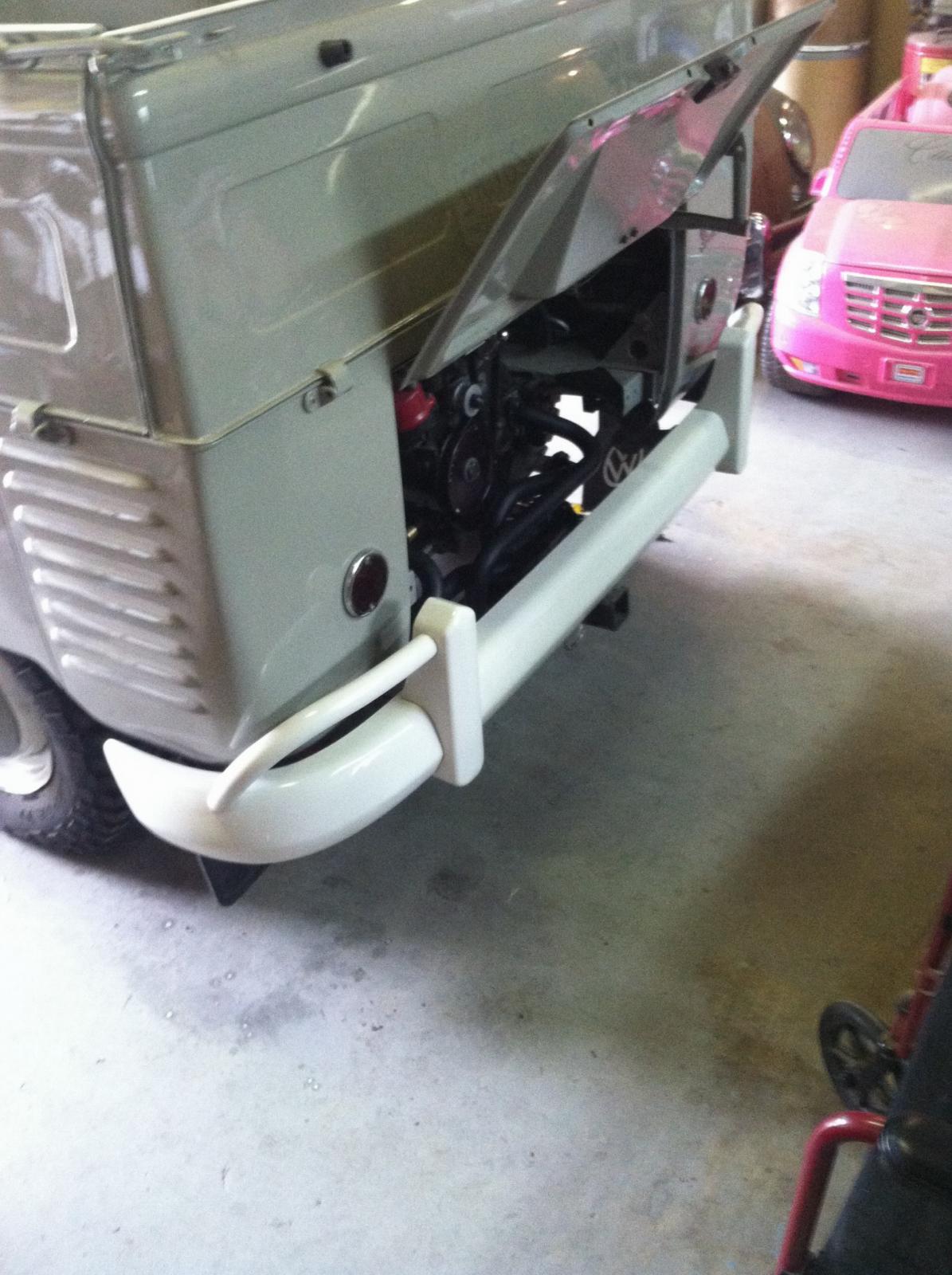

I fixed some minor issues with my rear bumper and hidden tow hitch and mounted it, just in case my muffler install interferes. Good thing too, because there is an obvious fit issue with where I thought I might hang it.

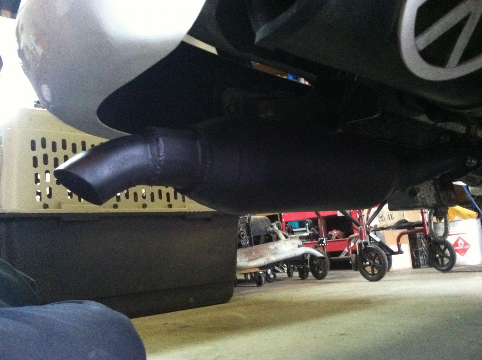

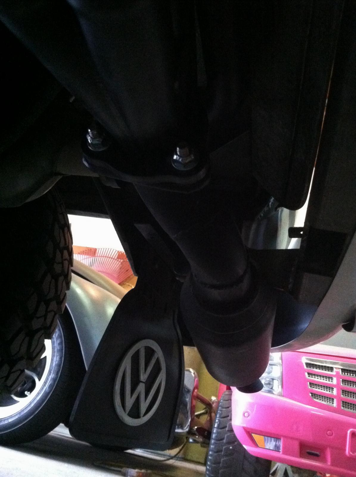

One thing I really didn't want was a huge muffler, or anything sticking out behind the bumper. If possible, I also didn't want to move anything to get at my valve covers, so I made my own setup.
This is a small flange to a 2" pipe leading to a 2.5" Moroso Spiral Flow muffler. Both ends were cut off and tapered down to 2", since they only come in 2.5" and 3" sizes. I couldn't find anyone running this an an ACVW, so I decided to try it out. At only 4" diameter and no packing to blow out with interesting internal design, it was worth a shot for $65 at Summit.
I would describe it as sounding like a slightly throatier sounding quiet pack and only slightly louder. It's really hard to tell a volume difference over road noise, but that might be because the cab is so far separated from the engine bay in a truck. Zero drone at all compared to the quiet pack and sounds nothing like a rice rocket coffee can exhaust. Once I added a 1 3/4" tailpipe, it stopped looking like one too. Super happy with it. It really just sounds like a slightly less raspy quiet pack. If you like the sound of a quiet pack, this is a great option.

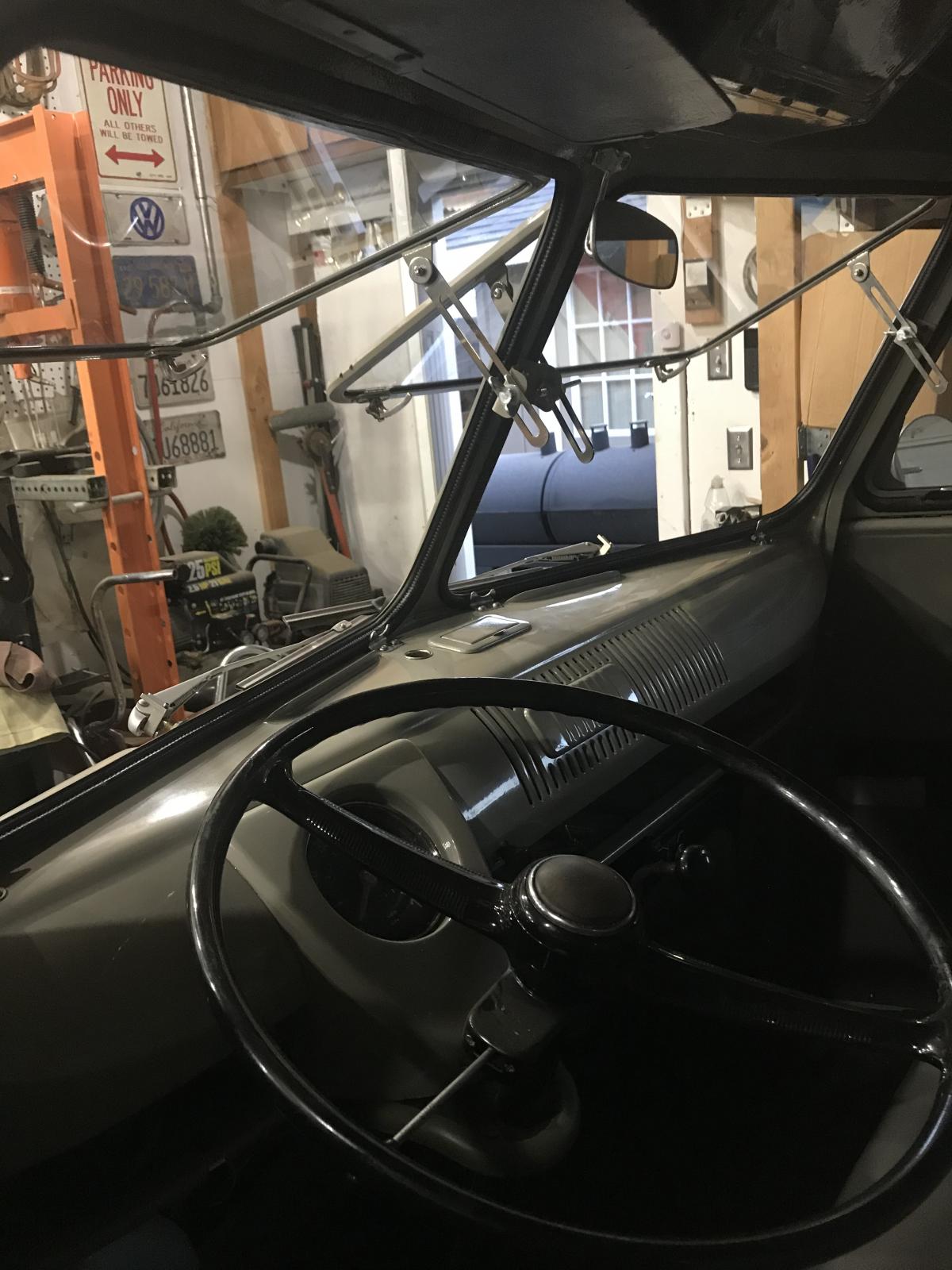

a little update. After 10 years, I finally put in safari windows. It was getting old being so sweaty every time I take a drive. I use rivnuts to install the body brackets.

Got any up close shots of the rivnuts? I was thinking of doing that to my truck as well rather than welding the tabs.

I ran out of black screws for the center bracket. They are 10-32 size. You can see the outer brackets are longer than they come from Creative. I just welded short plates to extend them, and drilled the holes in the extended part. If you don’t extend the brackets, you’ll have to drill right through the body seam where the door jamb meets the window frame. They just don’t give you enough meat to mount screws
