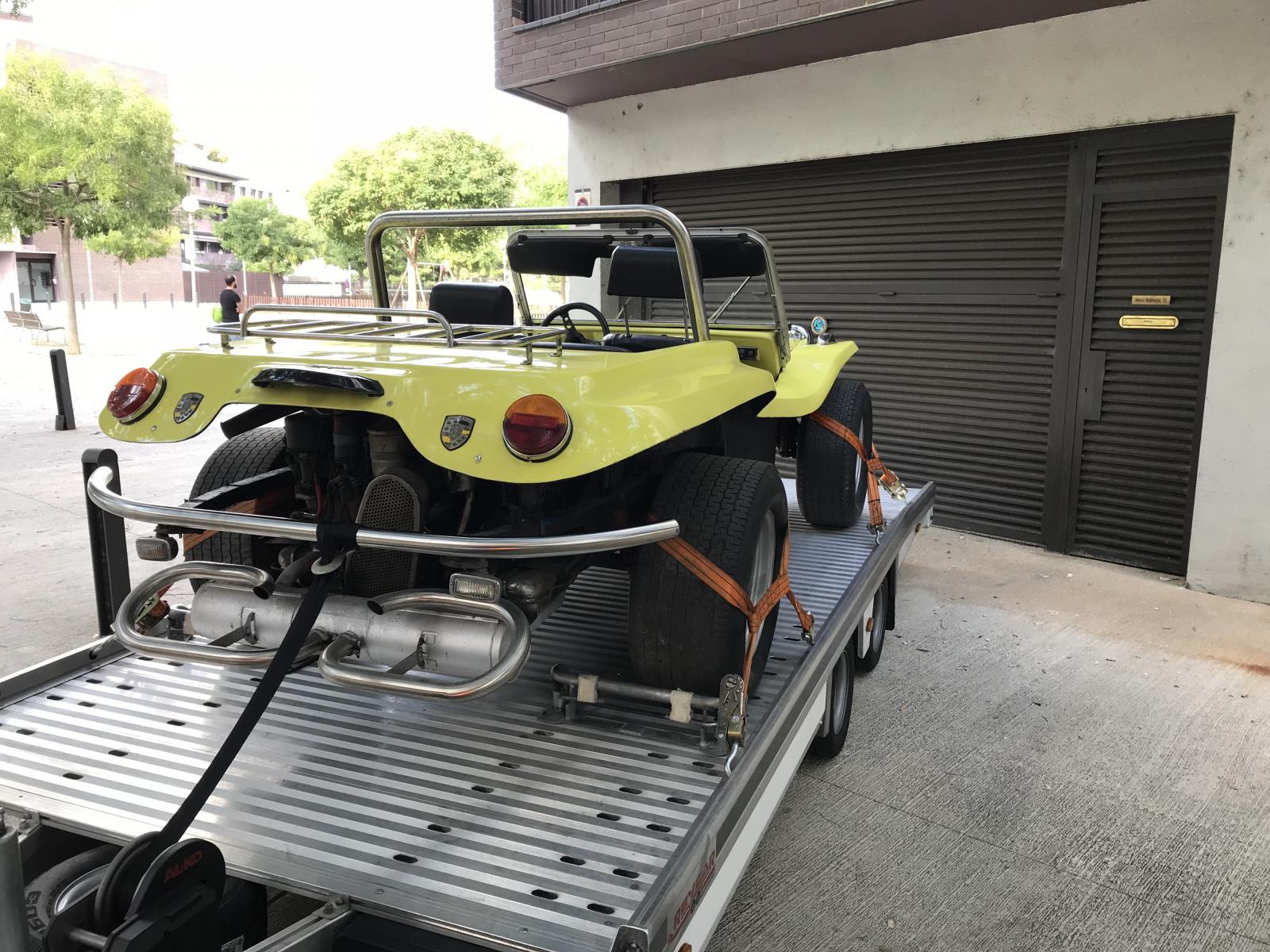

Below some pics of the car as I bought it:

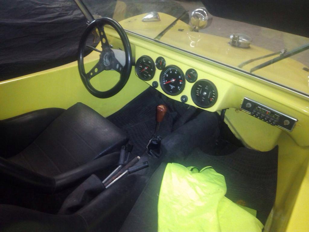

Ruvwen!!!!! What a buggy! Wow. That is exactly how I'd build one if I could. Until I read your description I could've swore it was a Manx body with the Aleman badge on it.
I can't wait to see what you end up doing with it. If it were mine, I'd have it detailed and then just enjoy it. It looks perfectly preserved. Please Please don't recover those Recaro seats. The original upholstery adds so much history and provenance to the car and they still look great. One of the things that you may not have noted but the steering wheel appears to be a Momo Prototipo which would've been the choice of Porsche racers as well.
As for the gauges, I would venture to guess that if you look at the part numbers on them you'll see a 914.xxx.xxx number along the rings. The tachometer is definitely for a 914/912e. It was the only Porsche tach that redlined at 5800rpm and it was also for a 4cylinder as opposed to the 6 cylinder of a 911 tach. The date should be on the back of those gauges and if I had to venture a guess, I'm going to guess they have a 70 or 71 date on them. Smile I'm not sure what the other two guages are from but if you post closer pictures I can probably id them.
Looking at the radio... is that a Blaupunkt frankfurt? It appears to be missing knobs which isn't a huge deal as there are thousands of them for sale around the $20-$30/pair range.
All in all a huge score! I'm really interested to see that Momo steering wheel. That alone could be an easy $1000+ steering wheel. I'm also excited to see that motor. The exhaust alone looks really trick and I'm sure that motor has some goodies on it.
Please keep us updated and thanks for tagging me in the other thread. I love this kind of stuff.

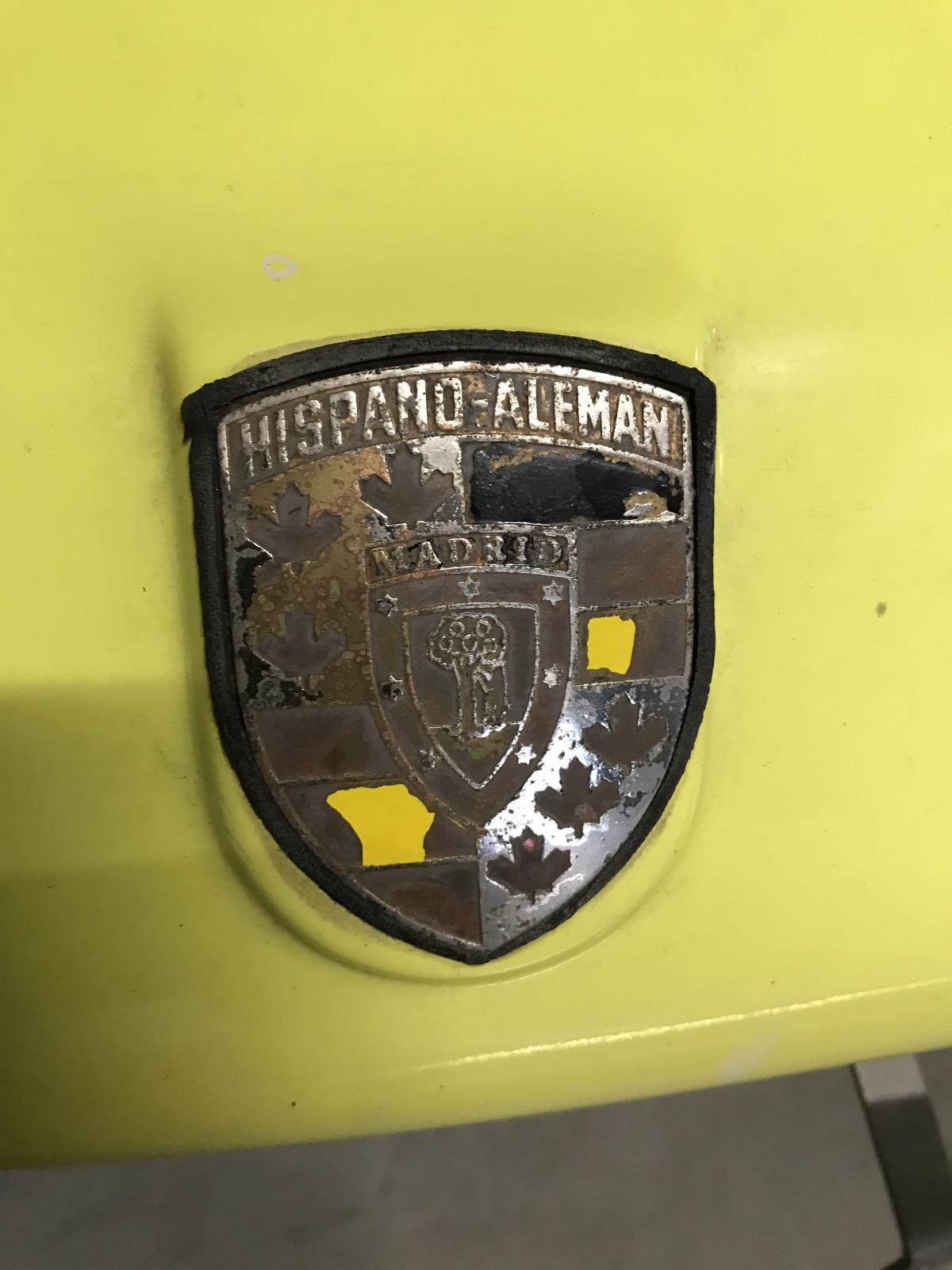

I am intrigued on the front hood, as mine seems to be different than the other Hispano Aleman buggies (front badge area), and identical to a Manx hood
Most of the work is already done today so we are too late to go for a different route Smile
Car looked ok although it was showing too many signs of 30 years of lack of use and neglect. The body had too many holes (not sure for what) and the engine, brakes etc needed a serious refresh. So we have conducted a full resto
The seats have been kept as found
Interesting comment on the steering wheel. Need to make some further pics for you
I will make further pics of the gauges

We know for sure at least one of the 12-15 buggies that were built by the Hispano Aleman company had an original Meyers Manx body (which is the one they had to buy in the USA to make the Hispano body moulds), so it could very well be that (being the very own car of the Hispano Aleman company owner) this body is the original Meyers one.
What shall I look for to confirm whether this body is an original Meyers or one of the copies they made?

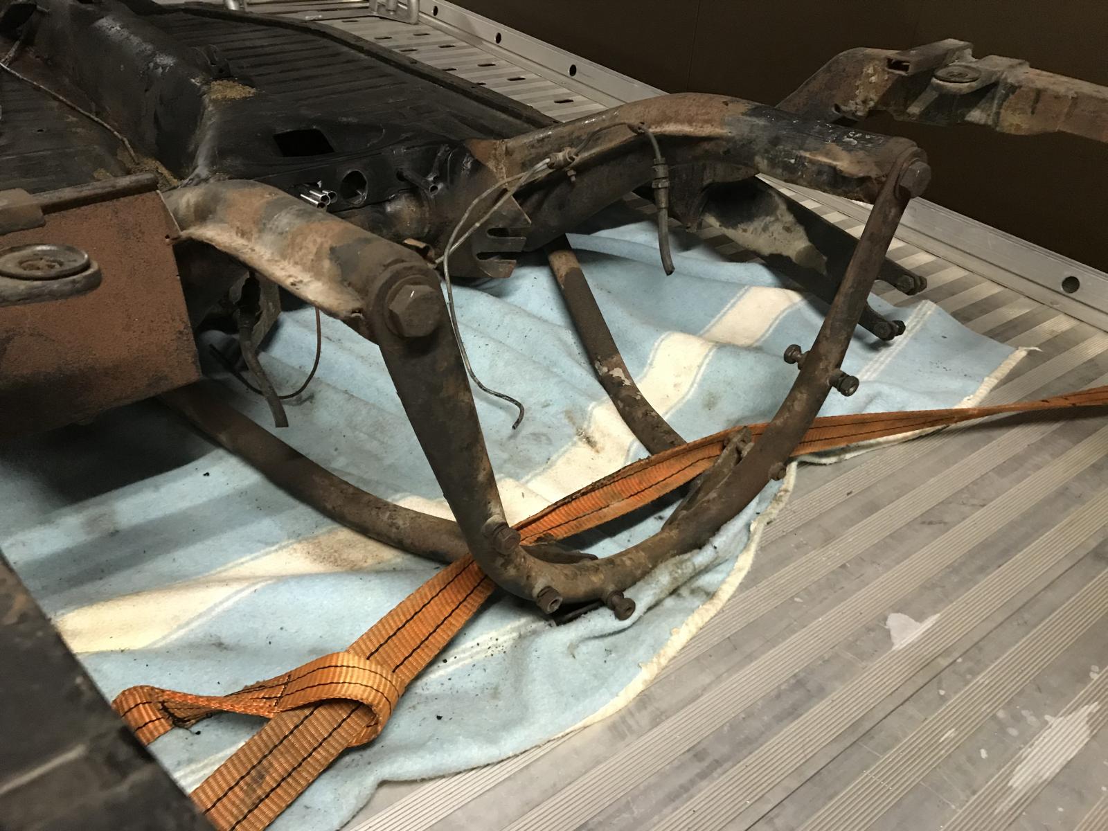

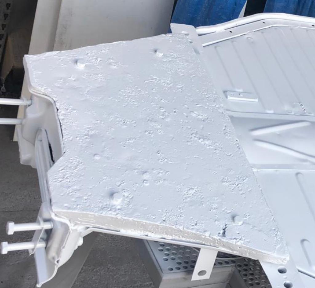

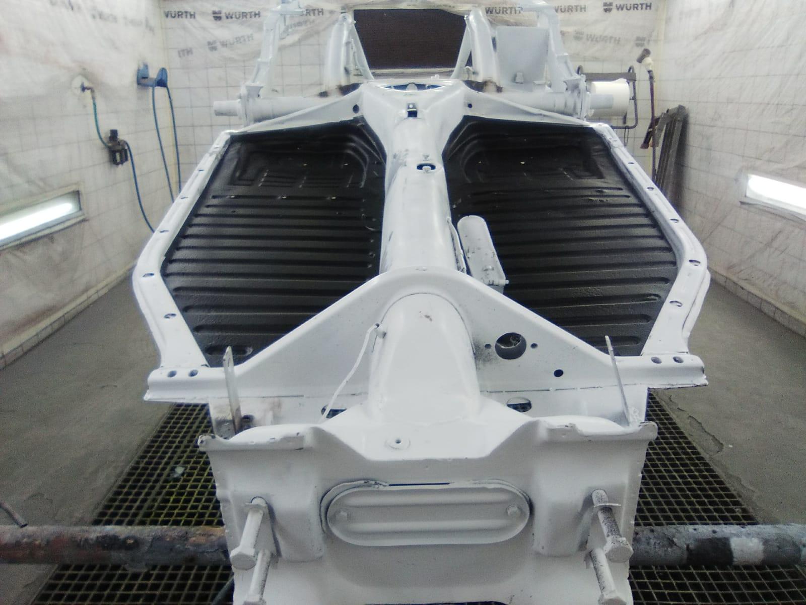

So going back to the resto work we have conducted, let me start with the chassis, which was highly modified back in the day to accept the Porsche 356 powertrain
We sandblasted it, made some repairs to some bad old welds and small rusted spots, and epoxy primered it for some more 50 years of protection
This is a detail picture of the 70-80 kilos heavy metal plaque which is bolted to the front of the chassis, as apparently the car had a tendency to pull the front wheels off the ground when accelerating heavily

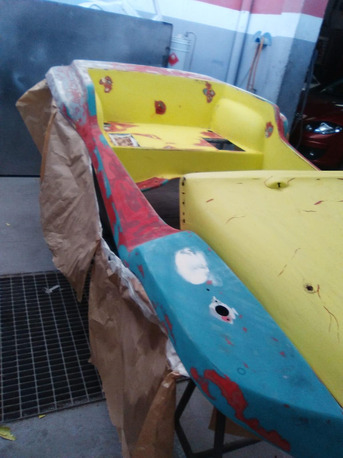

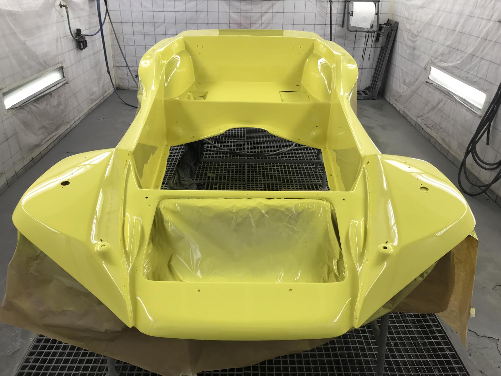

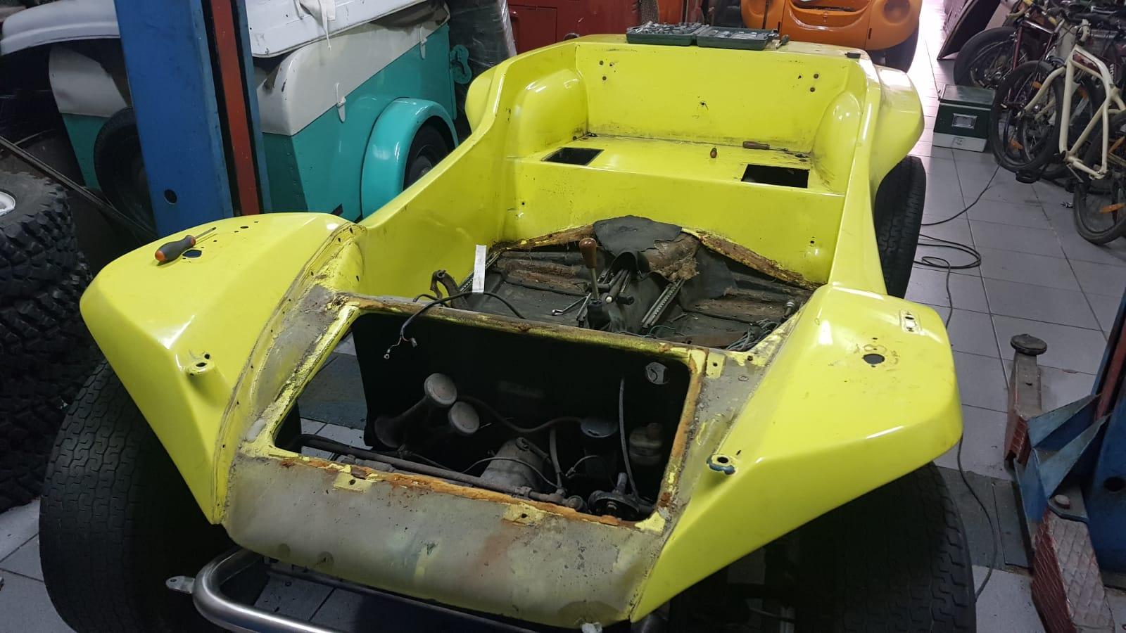

Continuing with the resto work, and moving to the body preparation and painting, this was a pretty straighforward exercise, as the body was very sound, so other than closing a few holes and fixing some small spots all the rest was a pretty easy job
There were 3 layers/colors underneath: yellow, red and the base gealcoat which was green. We sanded all the paint to get to the base green, and then we applied two coats of primer, before painting it yellow
At some point the rear part of the body was extended, to better cover the Porsche engine and exhaust
In this picture you can see the "bump" which according to the experts potentially identifies the body as an original Meyers Manx. Apparenly this was designed to be able to stack the bodies on top of each other to be able to transport them more easily. I still need to talk to the Meyers Manx registry experts to get 100% confirmation on this being an original Meyers Manx body
Here you can see the "bump" again

PostPosted: Mon Sep 23, 2019 6:25 pm    Post subject: Re: Porsche powered beach Buggy Reply with quote
The blocks were added to the unfinished side of the body(check if there is also one in back) to provide a point where a lever could be used without damaging the body, to help lift the new body from the mold

PostPosted: Mon Sep 23, 2019 10:59 pm    Post subject: Re: Porsche powered beach Buggy Reply with quote
BL3Manx wrote:
Thanks for correcting me.
And yes, there is also a block / bump in the rear. Will post pics as well

ruvwen wrote:
BL3Manx some close pics of the front and rear bump / lift block. So while I check with the Manx Registry experts, do you conclude this is an authentic Meyers Manx body? To me it makes sense that this is the original Manx body which Ben Heiderich imported from the USA to use it as a pattern to replicate the body for his Hispano Aleman buggies. Being his own buggy he probably opted for keeping the original one for himself
From everything else and the two lifting blocks I'm pretty confident that is an original Meyers Manx 2 body(with a modified rear end for more engine coverage).
Looking at your picture of the rear lifting block, just above it I believe I can see the four holes in the fiberglass where the pop-rivets were which held the original serial number tag to the body.
Its not uncommon for the rivets on the tags to be drilled out and the tag removed by people before they repaint a body. Its often lost
Here is a picture of where the serial number tag would have originally been on a Manx 2
