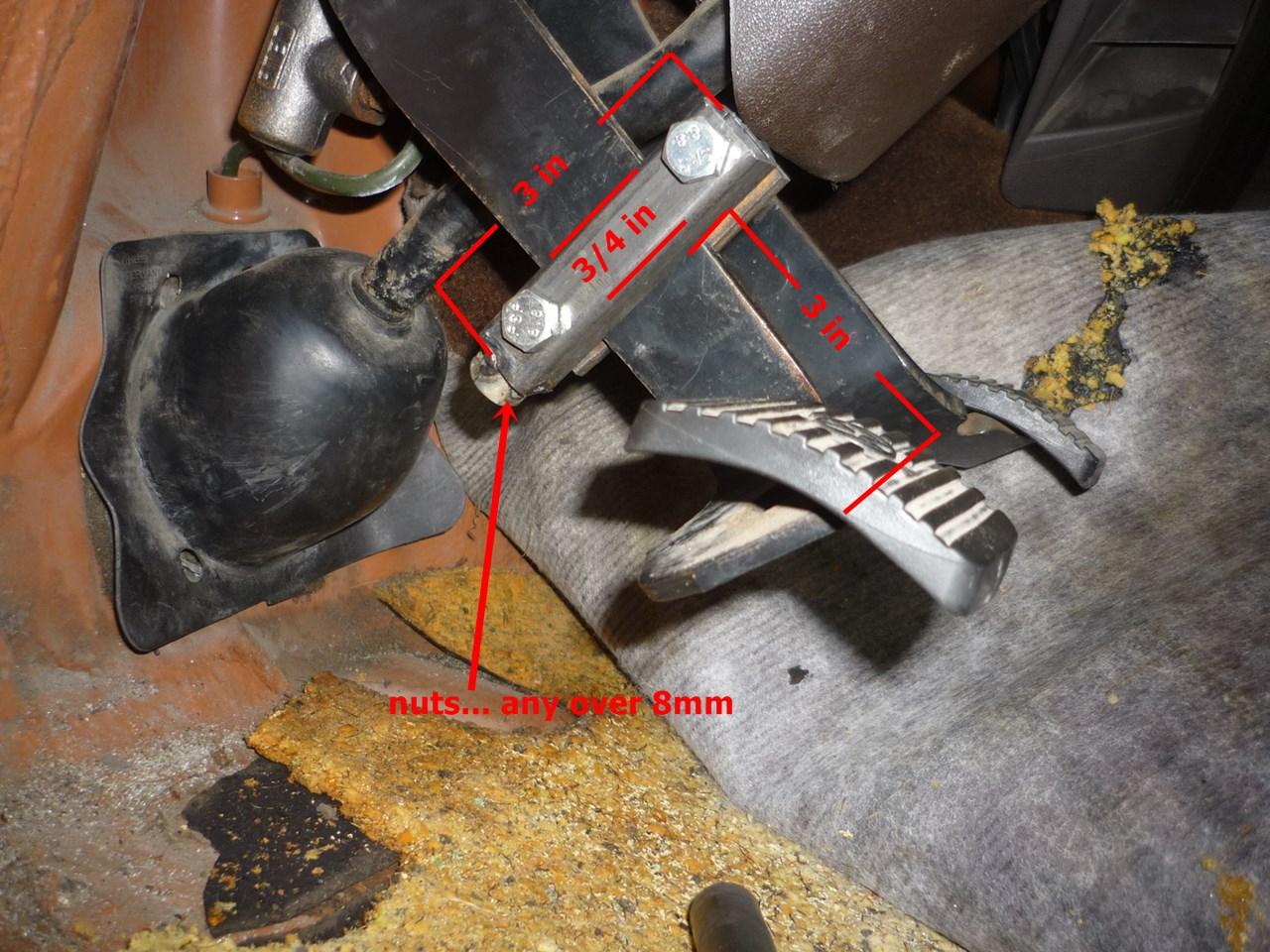

YOU NEED A PEDAL MOD!
The issue is that you MUST change the way the pedal works in order for it to:
a) Not ruin the cylinder
b) Allow for proper pedal action (feel.)
Just limiting the travel by external means only keeps you from blowing up the slave.
Your pedal action will still be basically crappy.

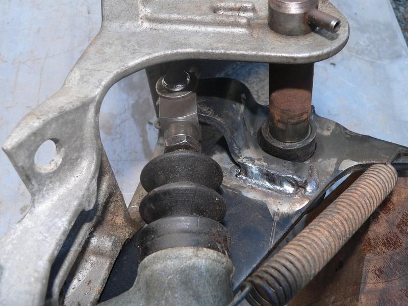

I don't have any photos of mine, but I simply cut the clutch pivot off and moved it up against the pivot sleeve and re-welded. Right at a 1/2" of motion ratio reduction. Worked like a charm, didn't blow up the slave. Sold the van, gonna keep it all VW clutch this time around.

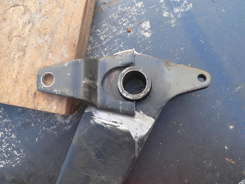

Working on this mod today.
NOTE image says 9mm. Nov 13, 2019 11mm is recomended
I can't see a reason why you can't just drill another hole 13mm 9mm 11mm inward.
It's getting close to the bend radius, but the inside corner of the clevis can be rounded.
This pic shows:
1) The new 8mm hole moved inward 13mm, 9mm
now 11mm

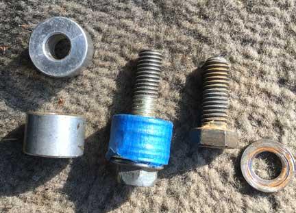

2) the two spacers (13mm9mm 11mm ) to reposition the master cylinder inline with the new hole
3) modified the clevis corners to relieve them from touching the end radius on the pedal. Ground both sides so it can be installed either way.
4) I cut off that un-used arm, much easier to reassemble in the van. Essential.
5) ground the arm to allow more swing on the clevis.
Drilling one hole, grinding the corners off the clevis.
How could r39o and Fred not see how easy this is?
I'm worried that I have missed a very important detail... Shocked
Like its impossible to re-assemble.....or something. Shocked
I'm struggling to get the pivot pin back in....
Would be great if one of those two fellers could weigh in.
Maybe my 1990 pedal is different from other years?
====== dang, no Fred, no r39o Sad ============
UPDATE ---- I finished this mod, and test drove it.
It was a huge fight.
Clutch modulation is butter-smooth---but the clutch is very soft (using 13mm)
drilling the hole 13mm closer---- seems too much.
I have to push the clutch too far to the floor, bending my ankle to do so.
Maybe I just have to get used to it ?
If Golf slaves "almost" survive with no mod, then it only needs a little, right?
13mm is like 20% less slave travel.
9mm is like 13% less slave travel.
If 0% can almost survive, 13% less has to be good enough, right?
9mm hole movement leaves 1mm between the two 8mm holes.
(Nov 13, 2019..... 11mm is recommended)

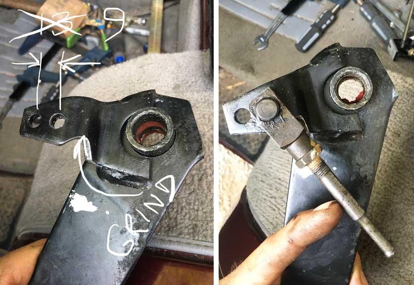

I worked on this some more today.
EDIT: Nov 13, 2019
13mm is tested and works well.
11mm is tested and works well.
9mm has not been tested. Nobody has yet provided the information we need to validate 9mm.
At this point, between 11mm - 13mm is GOOD.
This pic is PHOTOSHOPPED !! ( 13mm changed to 9mm )
EDIT: Nov 13, 2019
And note that cutting off that un-used ear makes pedal re-install MUCH easier.
I did my mod at "13mm" but I feel like 13mm is moving the hole too far.
I think 70% of 13, or 9mm would be better. Or try 10mm.
This is my recommendation based on 13mm being "real soft".
13mm works, but I feel like the clutch pedal has to be pushed too far down to the floor, to be able to shift smoothly, and would like to try 9 or 10mm.
And all you need is an 8mm (=5/16") drill bit and a grinder, and a hacksaw.
Heres a pic of my 13mm mod.
Notice you have to grind clearance for the clevis to swing.
I have no idea what angle it has to swing to, because I can't see it up in there.
But this angle worked.
If you choose 9mm (or 10mm) the grind clearance will be smaller.

Here's how I did it "solo" with this clutch bleeding assistant Wink .
I jammed the clutch to the floor with this board.
Then went under the van and loosened the bleeder, with a syringe piped to the bleeder.
The clutch pressurt pushes fluid out, and displaces the syringe on the graduated cylinder.
I did it 3 times, as you can see its 7cc.
So a "13mm offset hole" results in 7cc per clutch pump.
I wish I measured it before the re-drill.

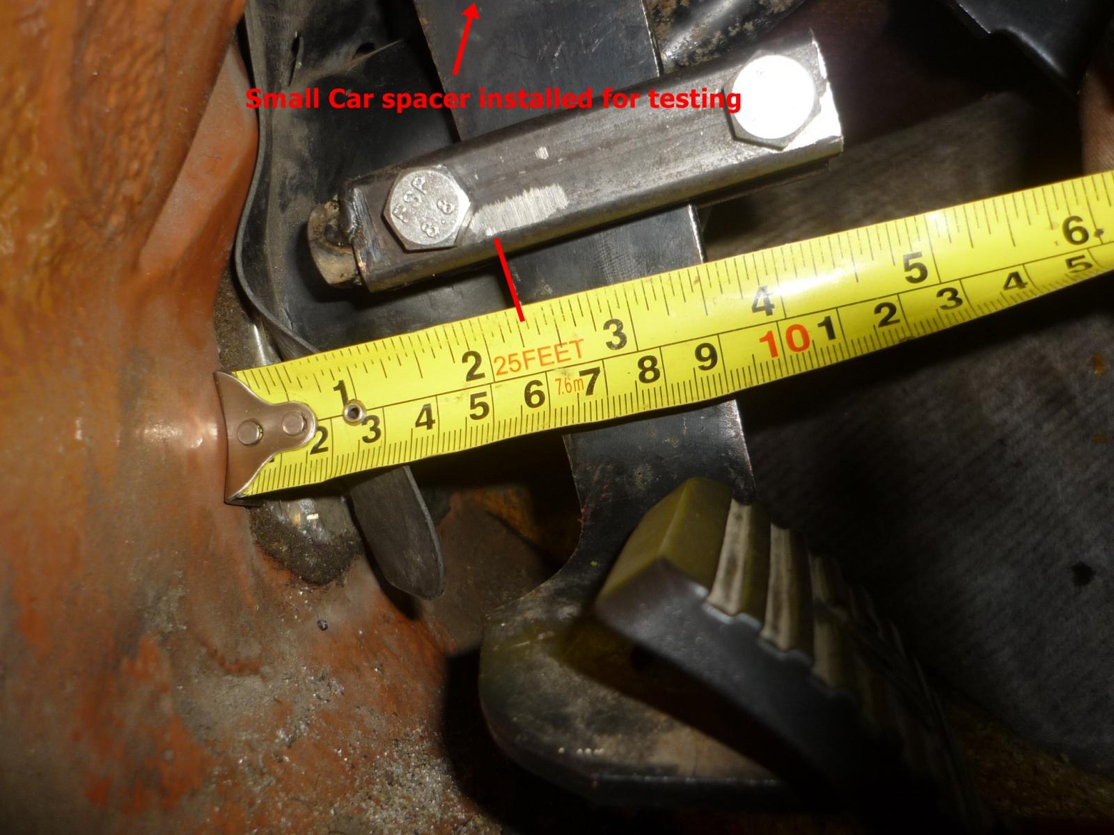

FWIW I'm still running "the original," Golf slave/throwout that was installed by Smallcar 10 years ago.
And my pedal clevis pin & hole was still greasy & perfect fit at 190,xxx miles.
It did burp once in the beginning, on its maiden voyage 1,000 miles from home, which was no fun at all.
Clutch fluid dripping from bellhousing, and no clutch at all, pedal to the floor 1000 miles from home.
Bricks were shat.
But the next day I just bled it and it worked again.
I drove home and dropped it off at Smallcar and they did "something" but didn't say what they did, I'm pretty sure they didn't know what the problem was.
(possibly they replaced the slave/throwout unit?)
But they're cagey like that....
I think this was before they developed that spacer 'solution'.
My van did NOT have "the spacer" and the pedal always went to the floor.
So my slave has been getting the full shot, for 7 years (but maybe there was air in the clutch line)
Then I made this pedal travel limiter as a stopgap while I researched the Fred Mod.
And even though my slave has been insulted in many ways it's been one of the more reliable components under my van.

Where the slave travel is limited, but clutch action is still too 'abrupt'.
The Syncro fellers (if they drive offroad etc) are the ones who notice this abrupt release modulation.
The clevis hole needs to be moved inward, closer to the pivot, to change the lever arm and thus the mechanical action.
The new hole added (9mm?) inward reduces the throw and ALSO restores the proper "feel" (clutch modulation).
Note you have to spacer the master cylinder the same amount (closer to the main pedal pivot).
Can use spacers ..... or just a stack of washers.
Washers taped together is good.
Whatever distance you move the hole, that's how thick your stack of washers is.
And your bolts have to be that much longer too.

kalispell365 wrote:
I can measure the spacers he supplied come spring and report back.
Good idea.
Maybe another member with a Fred mod can measure their spacers?
I wondered all along, why they decided they had to cut & weld & exchange, when it appeared to me that "drill & grind" was sufficient. I posted and gave it some time, but all that original work was years ago, and there was no response in the time alotted (while my clutch pedal was out).
So I decided to just try it, and it appears to work.
I would like to nail down the "optimum hole offset distance" though.
It's somewhere between "9mm and 13mm" I think. I say 9mm minimum as a minimum because you can drill it and leave a 1mm separation to the old 8mm hole.
If it was less than 9mm, you'd have to fill/weld then re-drill.
But I doubt it's less than 9mm.
And I doubt it's more than 13mm because I'm at 13mm now, & the clutch is super-soft and butter-smooth.
In any case folks can use 13mm, and can experiment with "down to 9mm".
I don't think you can go wrong with the middle, 11mm.
And it's like a clutch pedal rebuild too.
ALSO, there could be variations in clutch pedals.
Where my '90 can be drilled at 13mm, perhaps other year pedals cannot.
Bends are not always consistent (in manufacturing) especially if there is no requirement for consistent location.
I will try to get a pic of an '87 pedal for an example.

Sodo, you have hit the nail on the head on this problem. I totally get it now. I have a friend with a VW shop that I will talk to about seeing if he and I can measure the slave fluid quantity from the next Golf he gets in. Does anyone know if the slave was used in Jettas as well and the years would be helpful but my friend may know.
I am very interested in knowing if it comes in at 7 like on your test.
I too made a stop on my pedal which gave me peace of mind. I made this after Smallcar gave me that ridiculous piece of plastic spacer idea they came up with. My initial install that I did myself did not have a spacer and I drove it that way for a few years without trouble before trying the spacer from Smallcar.

I got some satisfaction from leaving my original clevis hole alone, the pedal can still be used with an OEM bellhousing or RJES.
Which is unlikely.....but still Wink
Top pic is my original pedal.
Bottom two are Mackaymanx.
So y'all can see what he did.
Mackaymanx, that's a top notch job.
A bit more than drilling/grinding, but satisfying 'cuz it looks OEM. Wink
