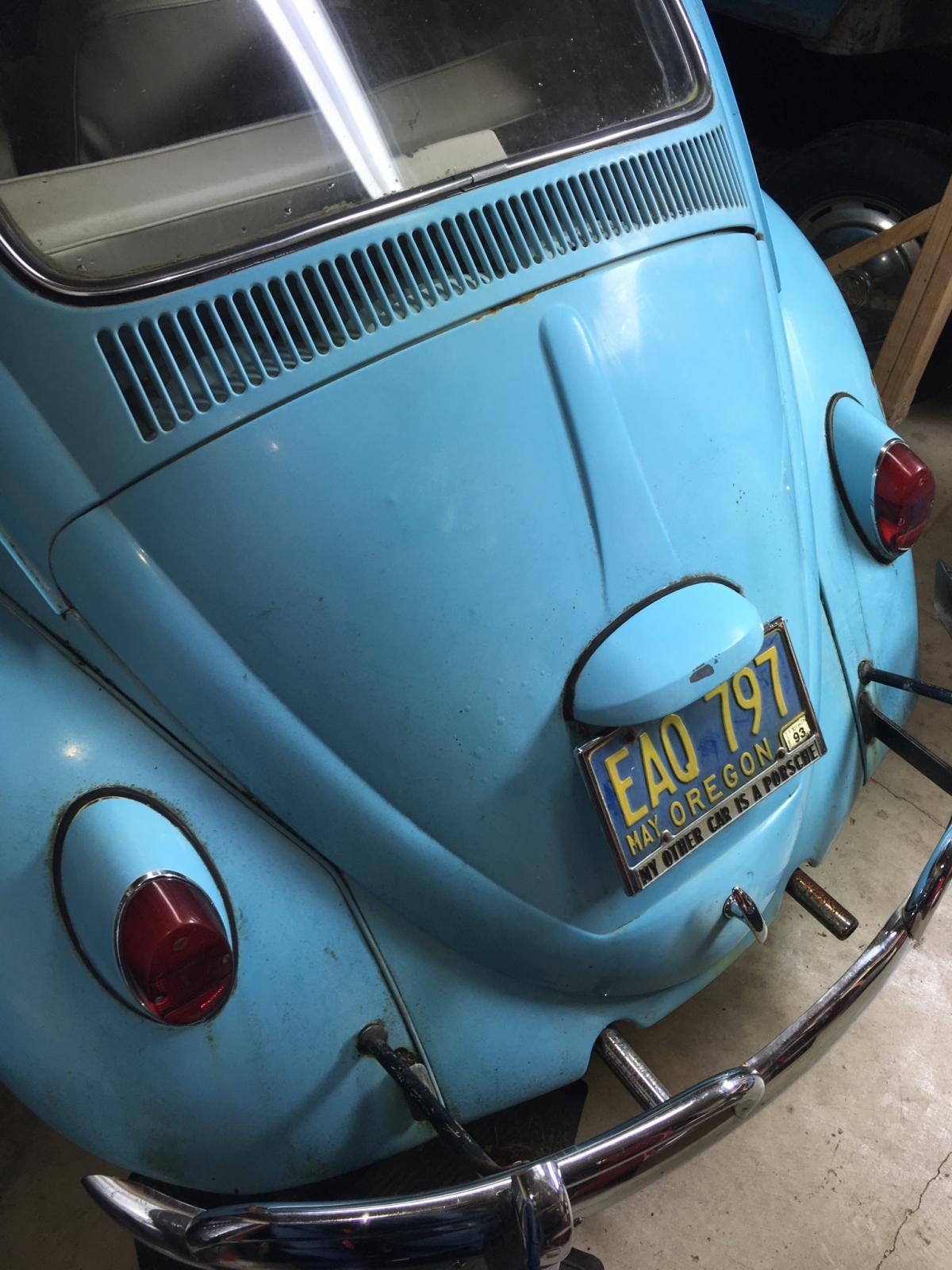

Lets chat a moment about 1964 and the changes that where seen. Below is a pic of my decklid. Is it an early or late 64 decklid? My VIN is March 64. What is OG for this year? I have seen cars that claim to be OG with both small and wide light covers, both some wings and none. Most always have T handle.
~ Cesar

PostPosted: Wed Dec 28, 2016 12:44 pm    Post subject: Re: Official "what year is my decklid" thread Reply with quote
In 64 there are two "one year only" deck lids used.
Straight stamp, small light, t handle from Aug 63 through Oct 63
Straight stamp, large light t handle from Nov 63 through July 64
Pics and bentley reference is on page 1 post 1

whitebrasilian
Joined: December 28, 2016
Posts: 10
Location: Portland, Oregon
whitebrasilian is offline
PostPosted: Wed Dec 28, 2016 12:48 pm    Post subject: Re: Official "what year is my decklid" thread Reply with quote
Straight stamp, small light, t handle from Aug through Oct
Straight stamp, large light t handle from Nov through July
Excellent info. Thanks! Would this mean that the only difference in decklids is the light cover? Are they interchangeable?

PostPosted: Wed Dec 28, 2016 3:00 pm    Post subject: Re: Official "what year is my decklid" thread Reply with quote
Decklids are interchangeable up through July 64, 65-66, 67 (one year only), 68 up.
The difference between Aug 58 - July 63 and Aug 63-July 64 is the center rib stamping.
Read the first post with pics to see differences, 1/2 W, strait rib.

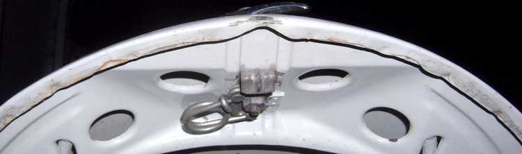

Found this one yesterday and did not see it in this topic yet. Previous owner said it was for a '67.
The bulb you see on the right looks like it has been welded in...

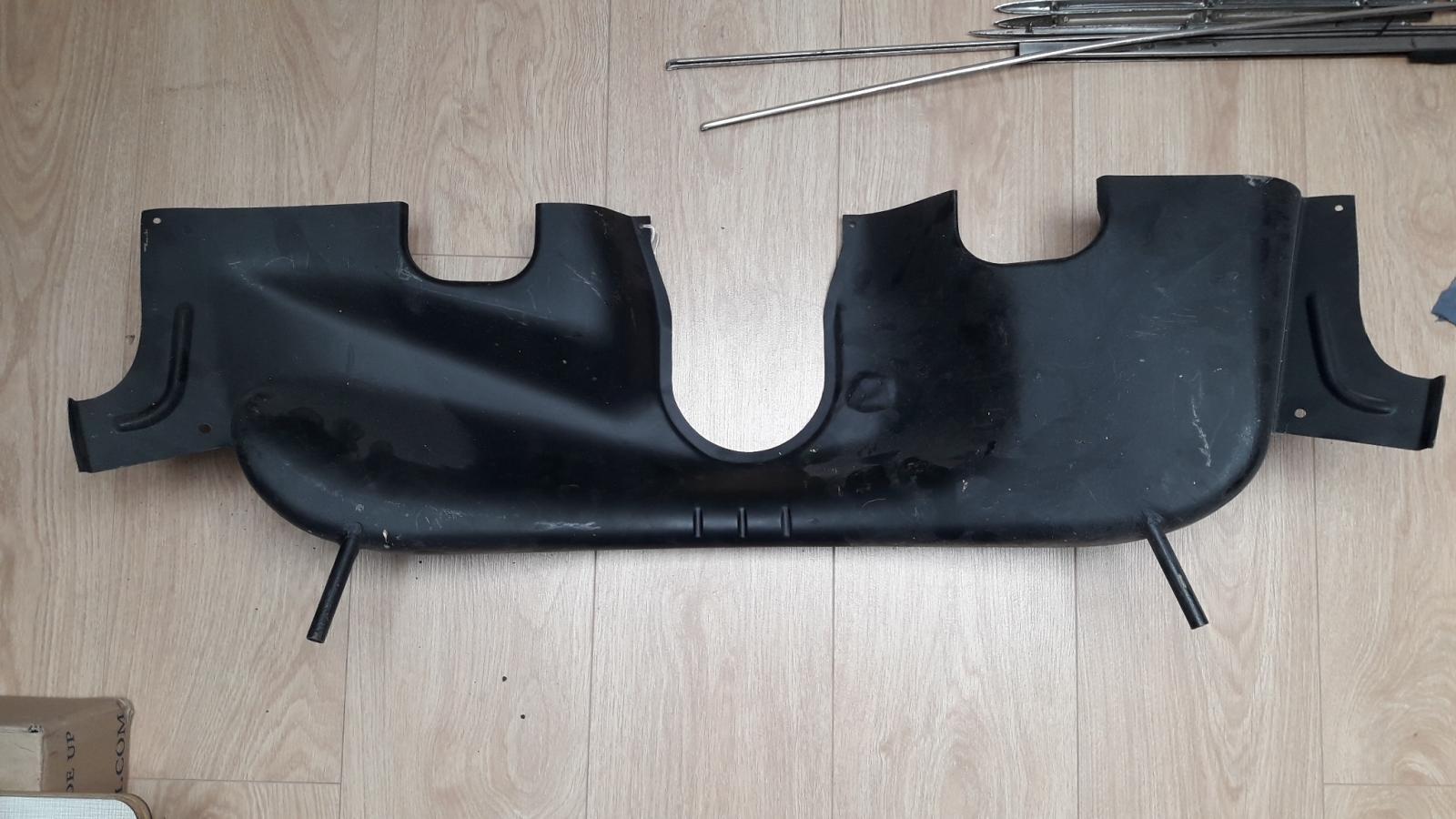

Does anyone know of a source for the rubber bumpers and buffers that keep the rain tray from vibrating?

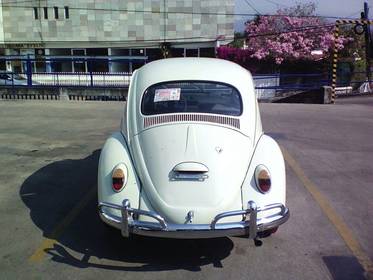

I'm trying to find out the correct emblem or script for my deck lid. The car is a Mexican origin beetle. The furthest 2 holes are about 8.5 inches apart. Looks like the "1300" script is not wide enough for the holes.
Any help?
Sharp64
Joined: August 27, 2015
Posts: 5304
Location: Central Florida
Sharp64 is offline
PostPosted: Tue Aug 08, 2017 5:59 pm    Post subject: Re: Official "what year is my decklid" thread Reply with quote
Any help?
Looks like a 65 or 66 decklid. I would think it's for the 1300 script. Maybe someone mounted a Volkswagen emblem at some point?
Technically the "correct" emblem would be "none".

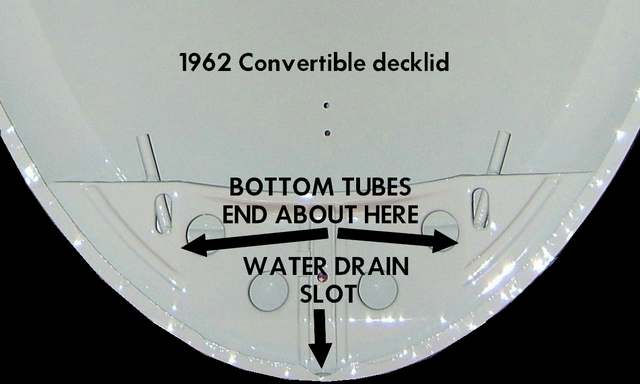

How are the steel pipes attached to the bottom reinforcement on a 61-62 convertible decklid and how ong are they? To the bottom or just a bit in under the reinforcement plate?
What does the drain holes at the bottom look like? Any pictures on that?
glutamodo Premium Member
The Android
Joined: July 13, 2004
Posts: 26607
Location: Douglas, WY
glutamodo is offline
PostPosted: Thu Jul 12, 2018 9:46 pm    Post subject: Re: Official "what year is my decklid" thread Reply with quote
No "outer holes" on such a convertible decklid. Just a slot and an "indentation" at the very bottom to let the water past the body seal. And the reinforcement plate is welded to the edges of the lid.
Andy T.
Metamatic
Joined: June 19, 2014
Posts: 54
Location: Limhamn, Sweden
Metamatic is offline
PostPosted: Thu Jul 12, 2018 9:51 pm    Post subject: Re: Official "what year is my decklid" thread Reply with quote
glutamodo wrote:
No "outer holes" on such a convertible decklid. Just a slot and an "indentation" at the very bottom to let the water through the body seal. And the reinforcement plate is welded to the edges of the lid.
Thank you so much for quick responce and excellent info and pictures.

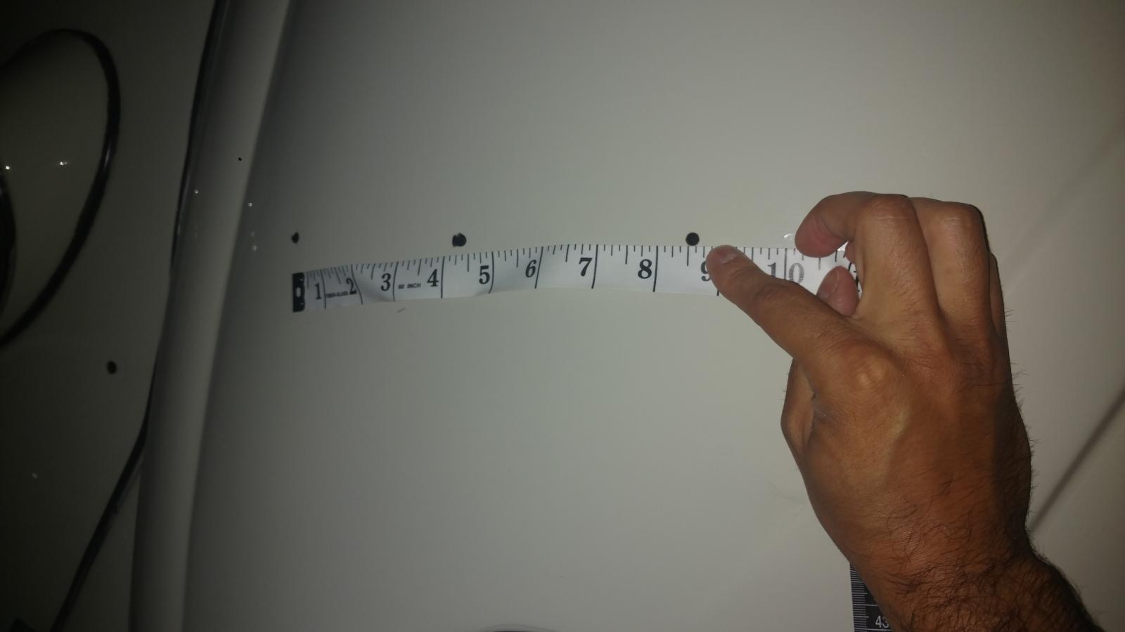

So I took measurements and I can post pictures but on the 64, there may be 3 different styles Shocked so my bug was rusty, and the bottom of the decklid was rusted out. It had the wide style license plate light. I found another 64 only decklid at a swap meet for $20 and was solid, score! So time goes by, and I got had taken the lights off and I go to put the old light on the new lid, it doesn’t fit! I was puzzled, both decklids had the original holes, light casting #s matched, but the new one was a few mm narrower than the old, around 5mm, enough where I’d have to redrill the holes. The new one in the new lid fits fine same for old and old. So I’m not sure why it’s like that but interesting that there was a slight difference and I don’t think it was just bent...
