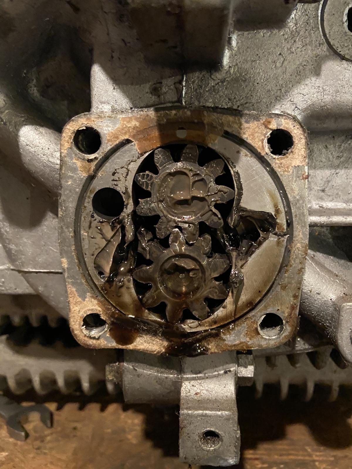

So, what do I have here and where to go?

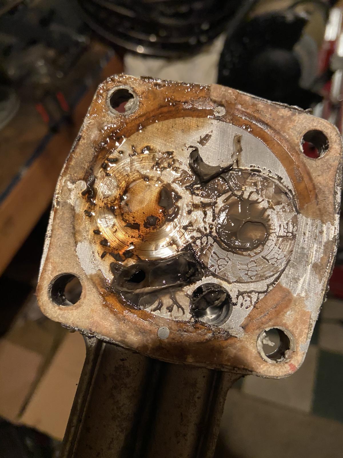

What is the cream in the oil pump?
Can I pull the oil pump and check cam without splitting the case?
Should I just split the case anyways?

Forgot pics of inside oil pump -

The oil pump is just filled with white lithium assembly grease. Thats what it looks like after so many years.

It looks to me like you have some usable parts there. The case is not the latest and best but for basically a stock engine it will work. Don't be so shy to open up the case, you need to know what shape the bearing saddles are in before proceeding. It's not rocket science. It likely could use a good clean up too. We put a 87 mm slip in piston and cylinder set in my sister's type 3 over 30 years ago and she put many miles on them. They are fine.
The grease in the oil pump could be Lubriplate engine assembly lube and is perfect for an engine in storage.
That’s good news, I wasn’t sure what all that crud was, makes sense that it is assembly lube. At least I know it wasn’t ran after pump was installed.

Im just going to open it up and take a look at what its got, I do not want to risk messing up the pump or mounting surface. I really want to know if it has a cam in it, and if not I would like something to help take advantage of the 36 DRLA dells I have for it.
Good to know I need a specific gasket for that style pump/filter, still not sure if it will work in a Thing with the Tri-Mil thing exhaust. Going to post that question in the Thing group.
