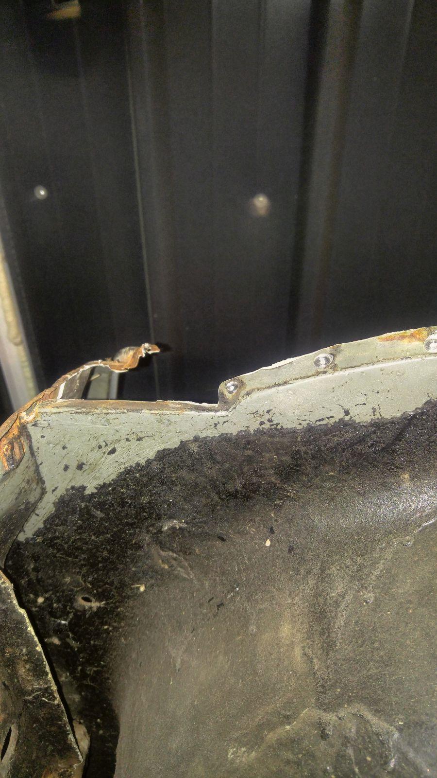

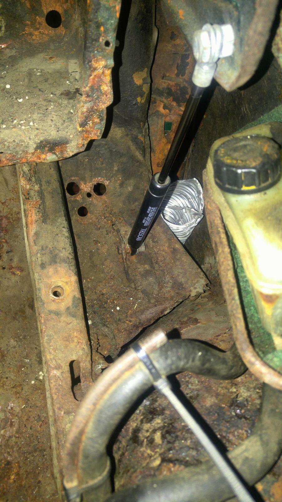

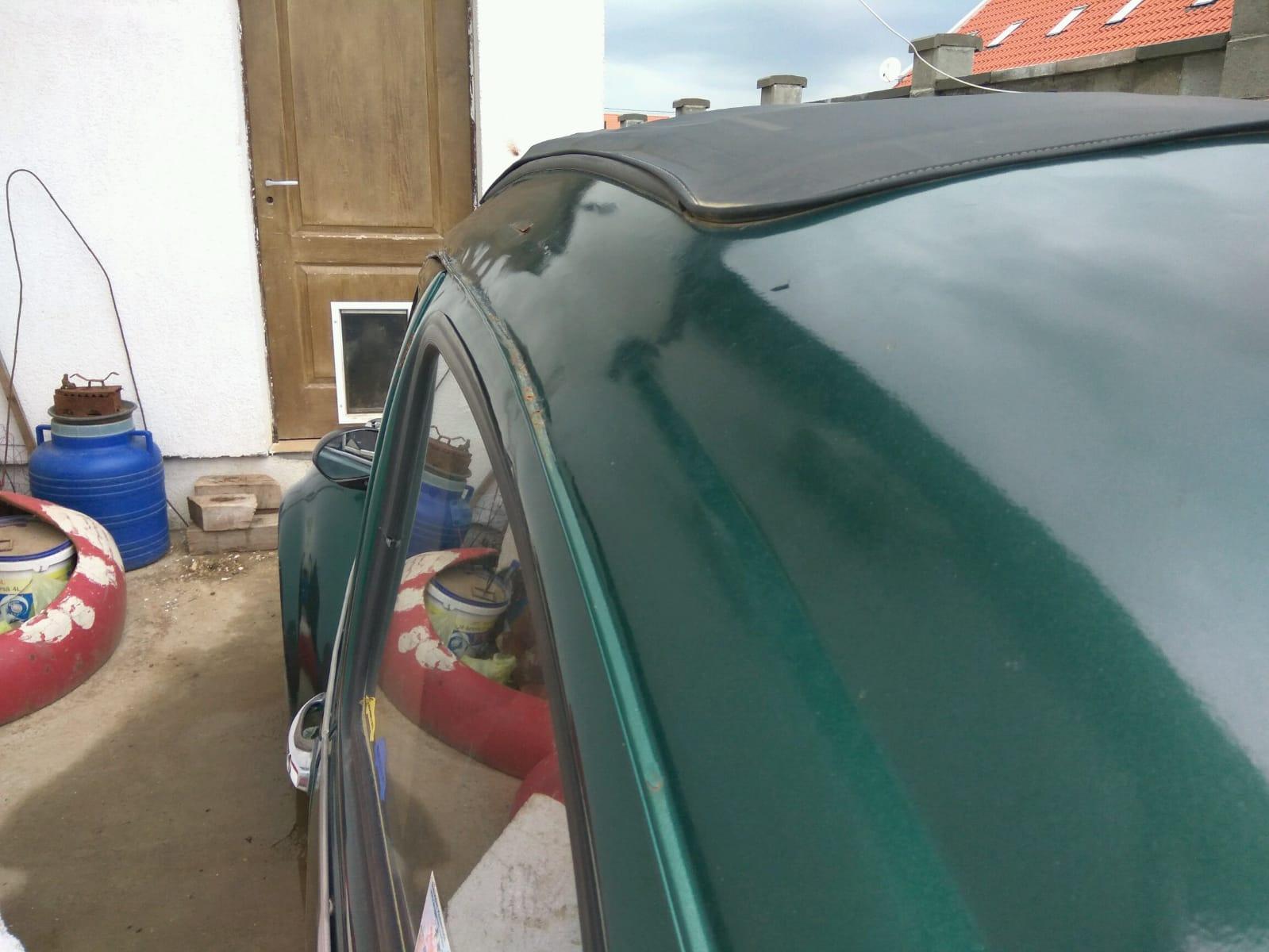

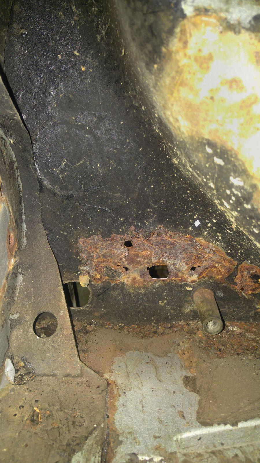

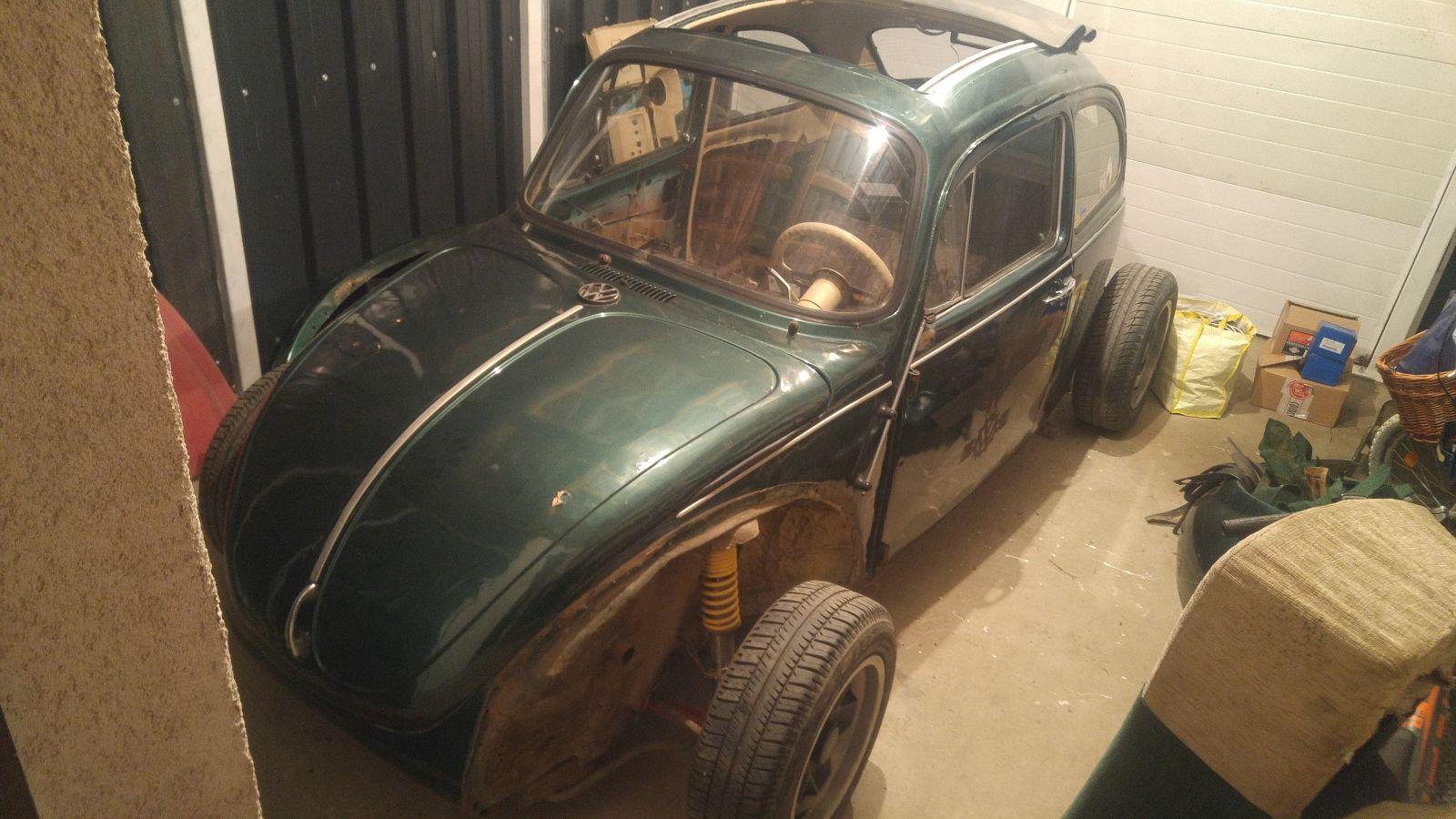

Thank you! Unfortunately it is nice only from a distance or in pics. Up close, problems appear. This is why I started the rebuild.
So, damage assessment. As I said, I already know what I'm dealing with because I did the previous rebuild more than 10 years ago. At least I can not complain I was tricked.
1. Left side rain gutter. I guess that the car was rolled sometime, because the whole left side is bad (front and above). I have a piece from another car in very good shape.
2. Ragtop graft. Last ime I welded it above a cutout in the shell. It does not look nice and required some bondo. Plan is to cut it down, make an accurate hole in the roof and butt-weld the graft to give a factory look.
3. complete front end to be replaced. It is bent, rusted, good for scrap. Well, not scrap, but it will make a nice BBQ setup.
4. Firewall. I am totally responsible for the swiss cheese. I put a lot of holes in with various modifications: fuse panel, ignition coil, Megajolt, etc. Time to cover them all and THINK when I put a new hole in.
5. Right side foam of death repair. I don't have pics now, but they will follow. I took out the foam on the left side on the previous rebuild, and it shows: all ok on the left, holes on the right.
6. Other areas: splash wall on the "new front end" needs some grafts from the one on the body (I changed it with a new one 10y ago), floors front half(s) have some rust because of the bent front end which allowed water inside. _________________ '74 1303S, L98B Viperngrun (extra glitter), German Look
'64 1200, Sea Blue, under restoration |

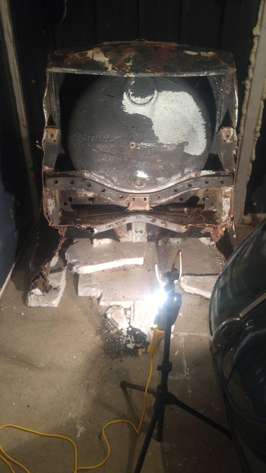

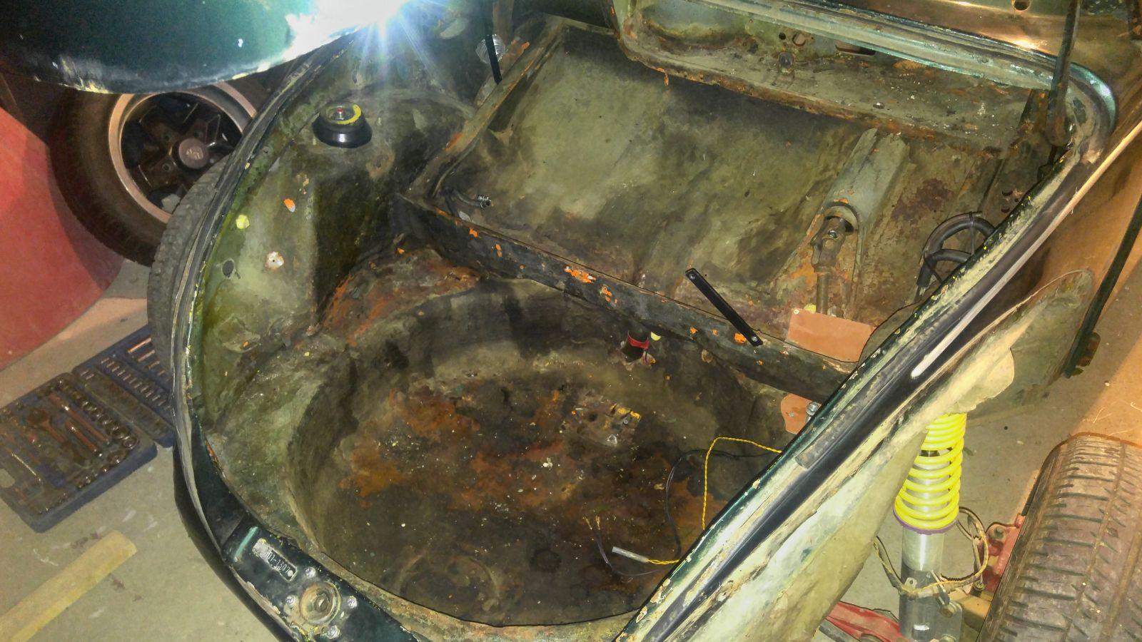

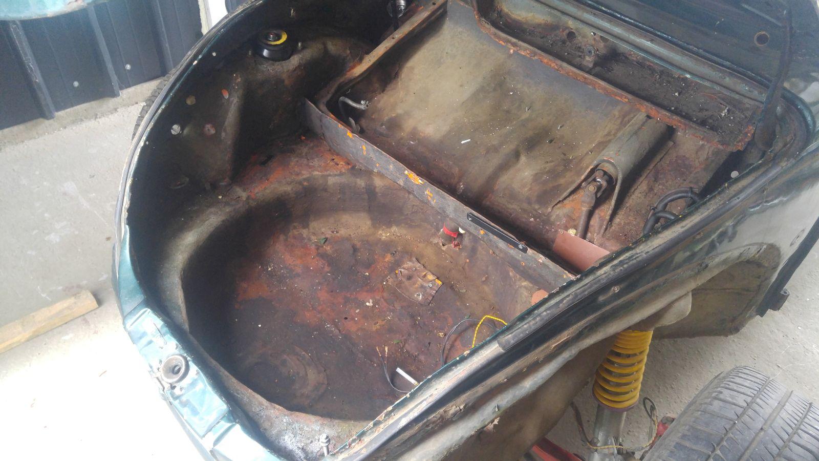

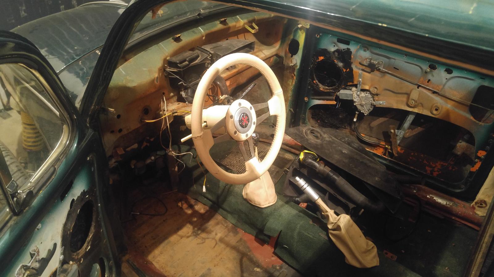

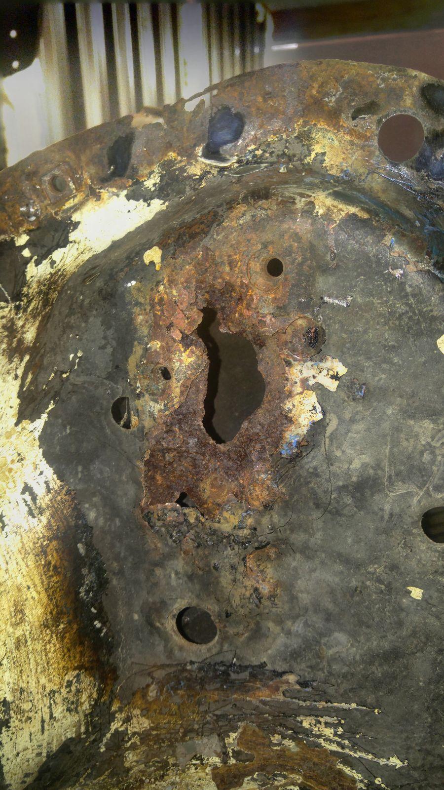

And some pics from the disassembly. I know I have to work a bit on the order I post things, but I address several topics in parallel, depending on the time I have and temperature in the garage.
So, October 30th 2019:
October 31st:
November 16th:
December 13th:

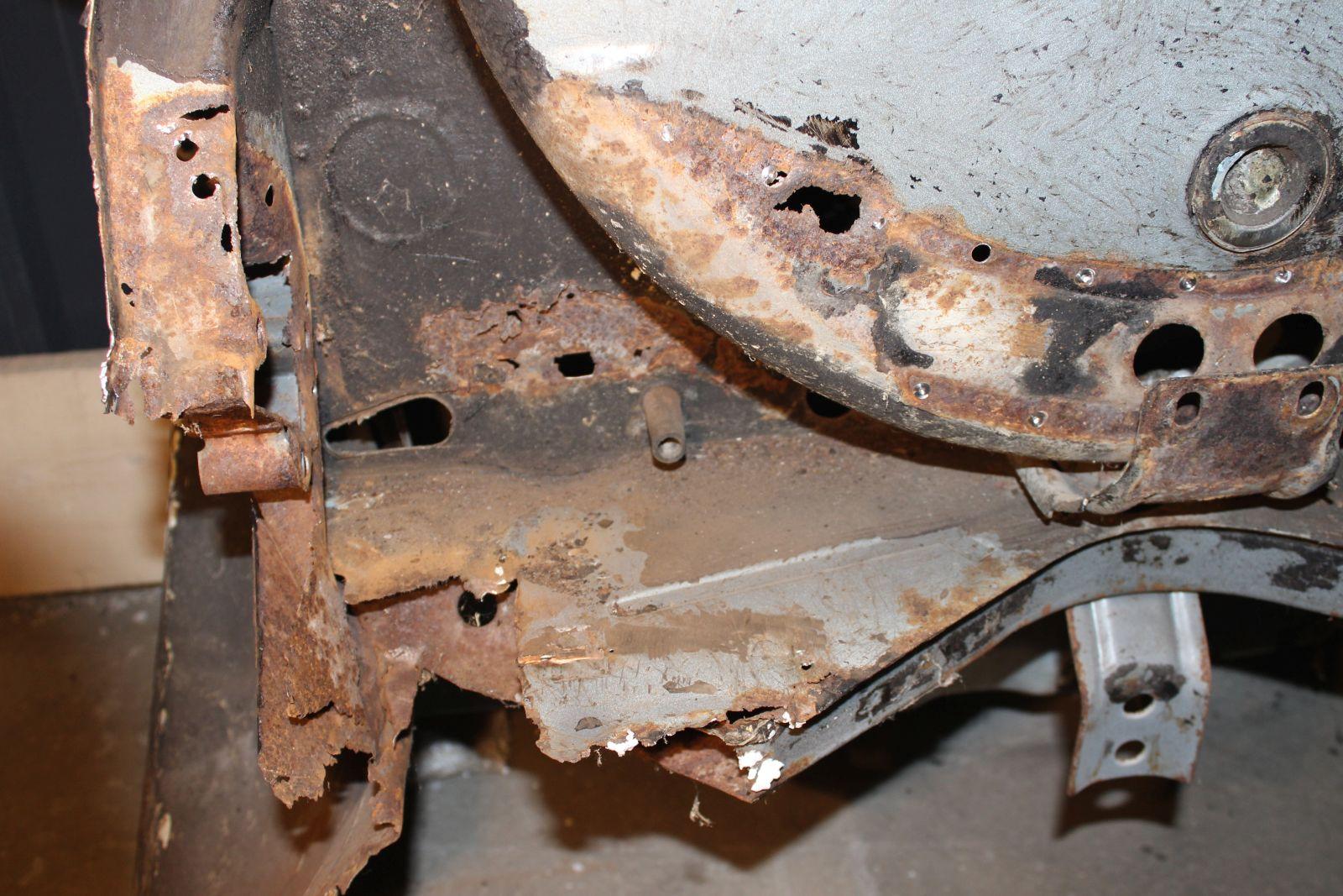

And start of "new" front end repair and modification for original 1303 rack and pinion.
Remove front valance and spare wheel well reinforcement.
Assess damage to be repaired:
Otherwise very good piece to work with.

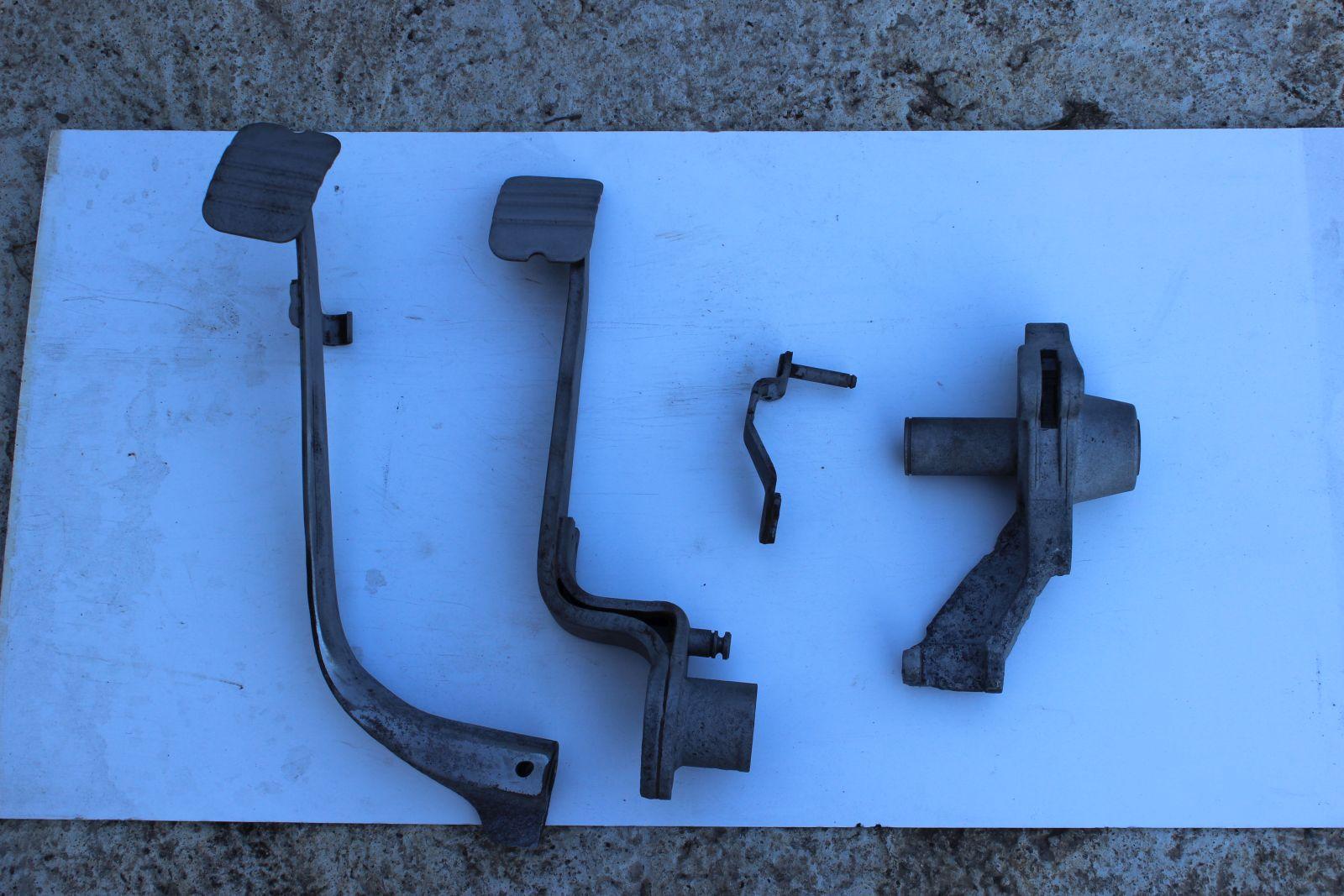

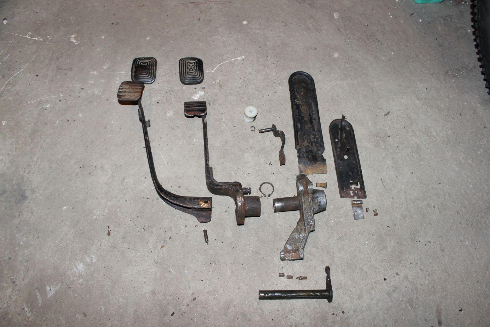

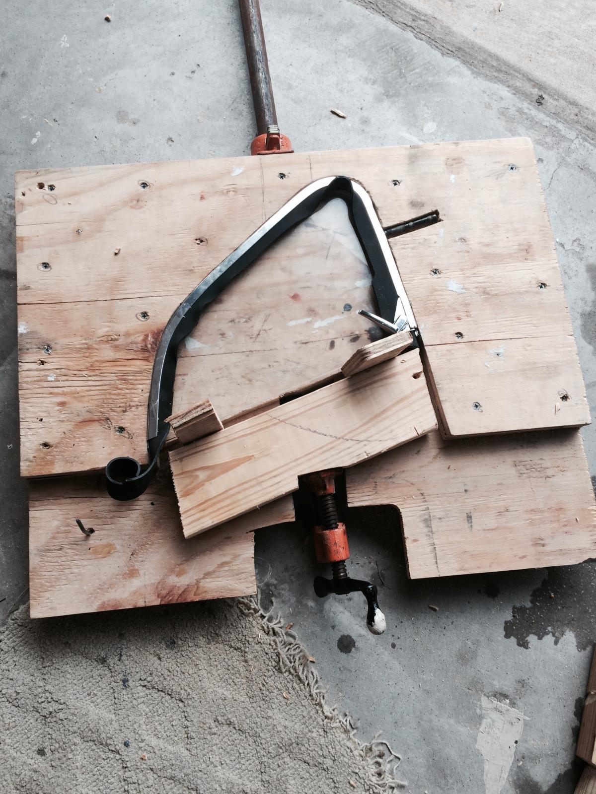

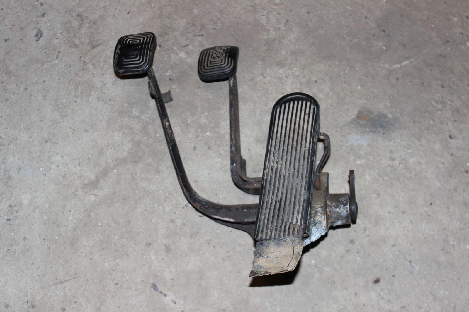

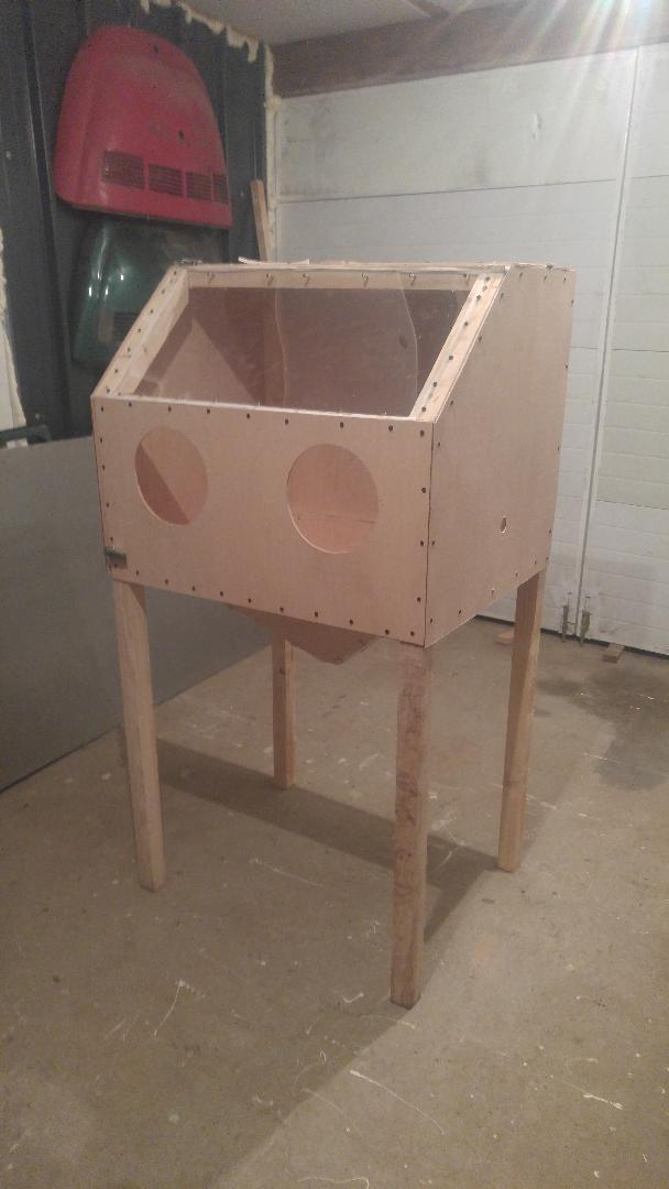

Time for an update. With pictures. I built a sandblasting cabinet and worked on the pedal cluster. Blasted, painted, new bushings. I still have to blast and paint the brake rod and somehow repair the clutch cable hook, I welded it but I am not happy with the result. I am considering making the "update" (bolt connection). I took a good look on Jeremy's work so I got some good hints.
I also started to rebuild the vent windows. The frame had some rust, some rivets were broken and the glass is scratched. Blasted, painted, now how on earth do I get the glass in frame with new rubber? I searched videos but I did not find too much info on VW vent window restore... How do I fix the rubber to the glass to keep it still until I force it in the frame? I do not like to put scotch tape (is this the name? like duct tape but thin and transparent) from one side to the other. I can not get it out after.

Vamram, I think we are speaking about different seals. I was referring to the last picture, how do I get the glass in the frame. I do not understand how a spatula would help me. For the other seals, yes it makes sense.

set the vent frame in that kind of jig, put the rubber on the glass and light duct tape the edges to the glass, where they won't slide into the frame so that the rubber does not move sideways. apply some lubricant .. love gel you know it will not enter if it's dry.. then whack the glass with a big steel hammer till it's in pieces! or... push it inside with the help of some ratchet straps... your choice.
AH! then send me the jig, i need it also for a pair of 65 66 vent wings... _________________ 1960 1200 model 117 deluxe ragtop
