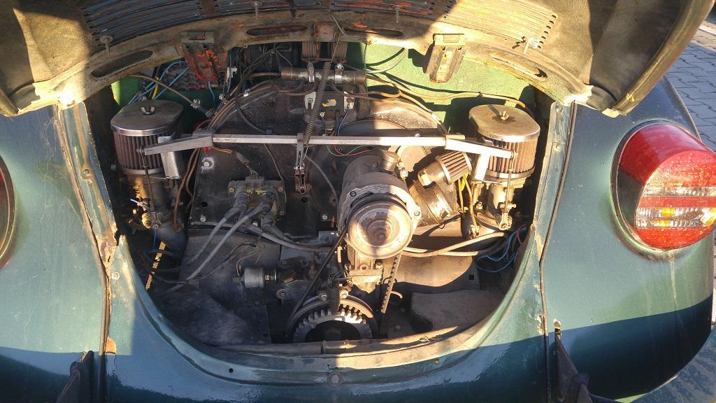

Here is mine. Trigger wheel from a Ford Escort, combined with EDIS4 and Megajolt. Ugly install, but I will replace it with a set from Mario @thebubshop. On the type4 I have another set from Mario, great design, nicely hidden.

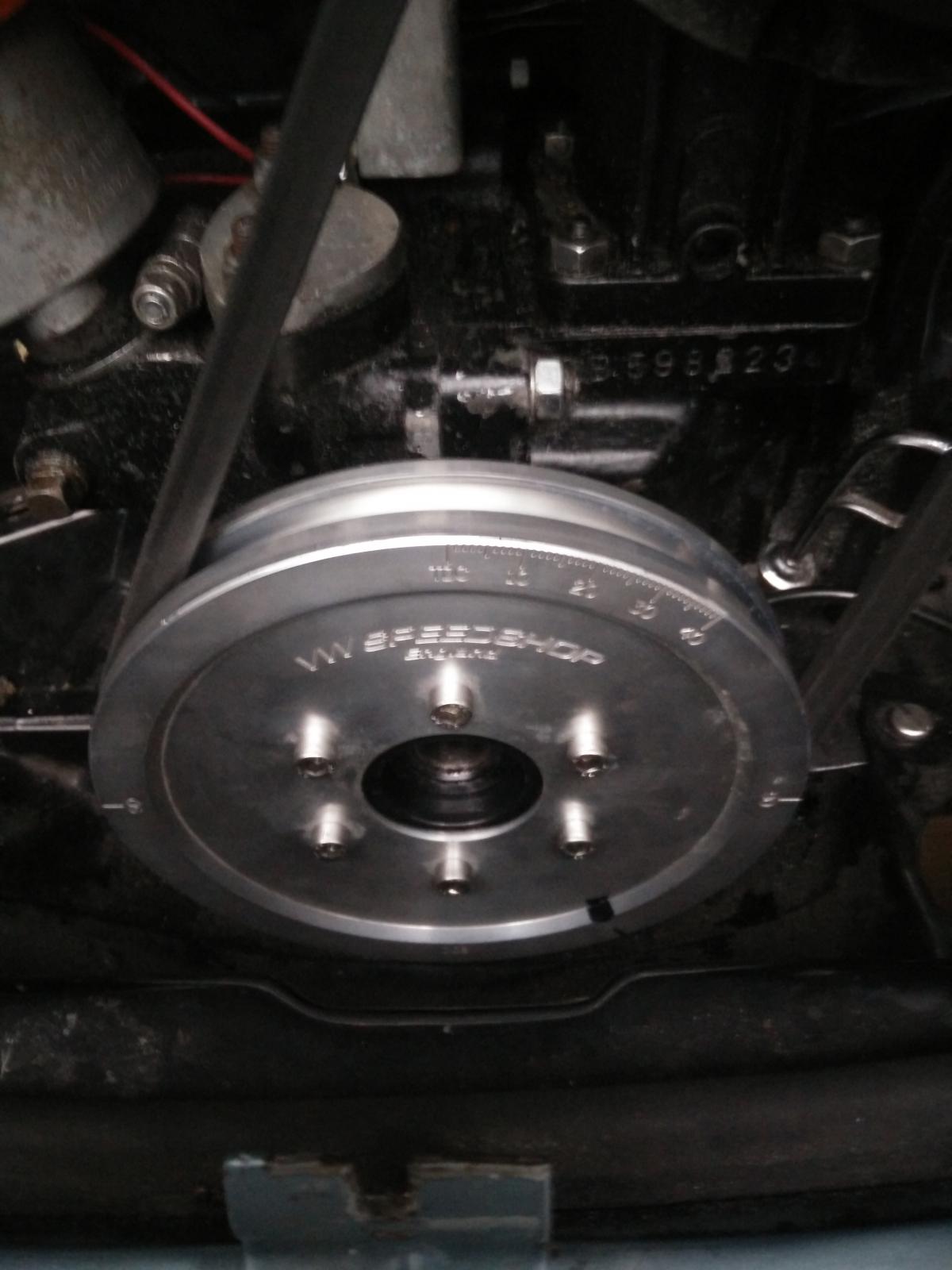

I think this is about the best solution I've found from VW Speedshop in the UK.
https://vwspeedshop.com/product.php?productid=16774&cat=507&page=1
The pulley can be changed from std vee, to power pulley or serpentine belt pulley leaving the trigger wheel and hub untouched.
HA, its not that your install wasn’t clean, its that your poor little vdub is dirty as hell! Very Happy
tzepesh
Joined: May 28, 2003
Posts: 881
Location: Romania
tzepesh is offline
PostPosted: Thu Jan 16, 2020 6:01 am    Post subject: Re: Show off your Crank Triggers!! Reply with quote
Very Happy Guilty as charged. That will change in the next iteration, because the Bug is now under re-construction. I say ugly install because I complicated things too much: initially I had TPS (although the bracket was not too nice, at least not visible), then I changed to MAP and this involved adding pipes from each manifold to the vacuum chamber on top of the shroud, then going to the MJ. I first tried urethane pipes but they were not good for heat and vacuum, so I changed to copper pipes as a quick and dirty fix.
But as I am building my type4 with MS2 Extra, I can transplant everything to this 1.6 engine if needed, and I will keep it nice and clean. I also tidied the wiring.
