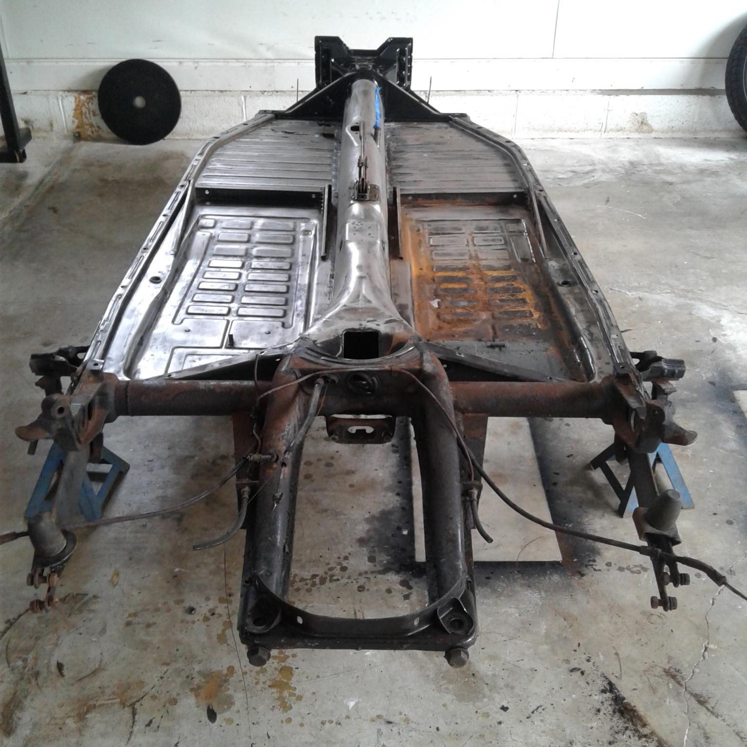

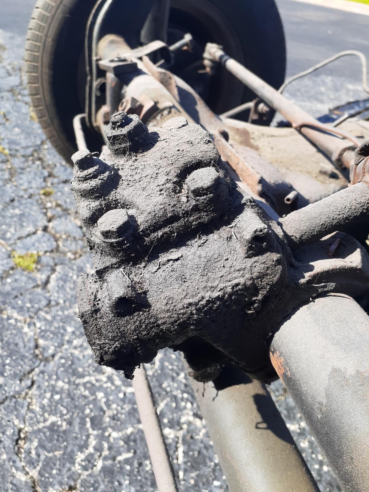

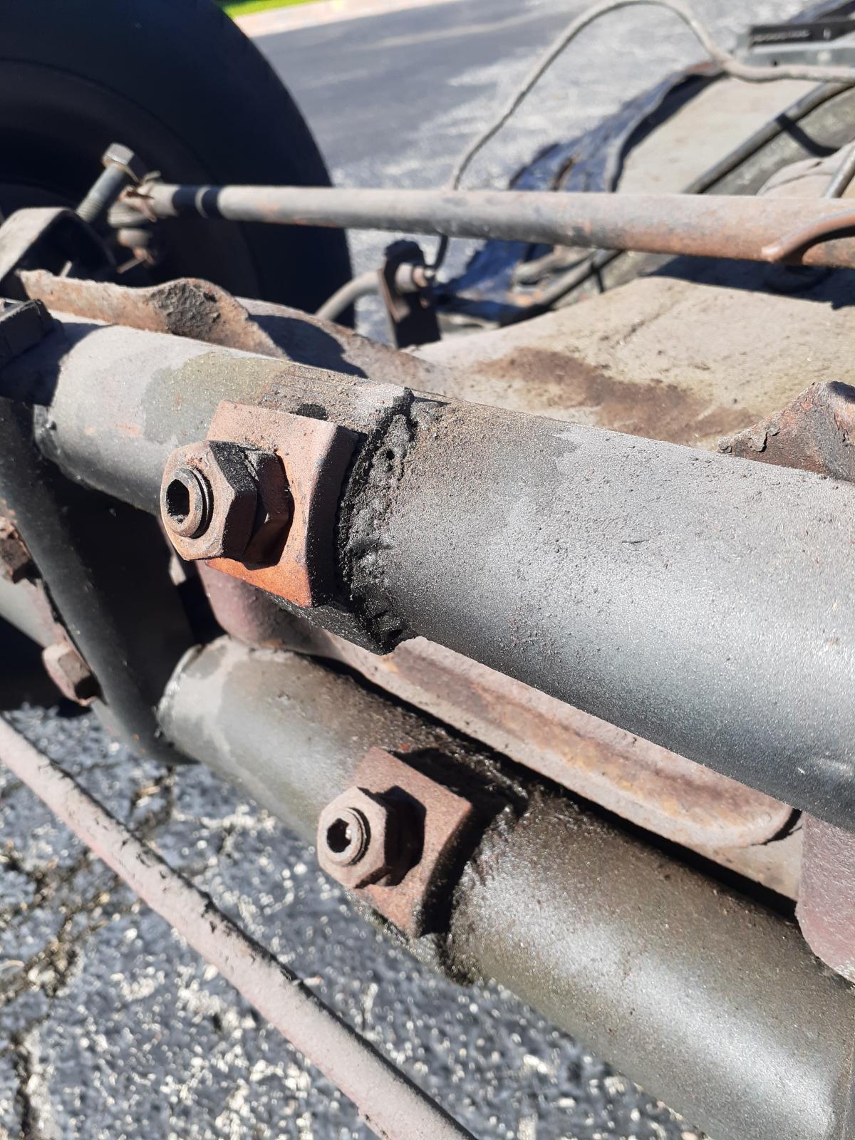

talk about a new world . with body off you have access to everything. cool to look at everything on chassis.

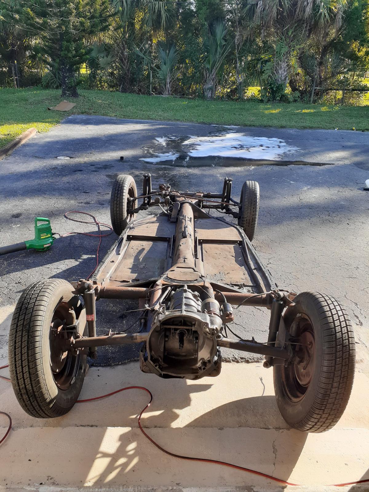

then got the foam cannon out.
bad91teg
Joined: February 13, 2007
Posts: 473
Location: florida
bad91teg is offline
PostPosted: Thu Jan 16, 2020 6:54 pm    Post subject: Re: mic lovin it , early 1964 bug project Reply with quote
then to dry it , I used a leaf blower. I must say , very satisfying to clean the chassis .

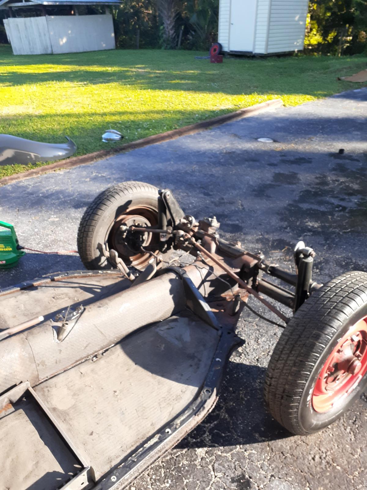

This really does look to be in very good condition. A nice dry bug. Wow I am jealous of the car stock you all have in the south. Again congratulations now that it's cleaned for a closer look.
Adjustable front beam in there. Are you going to drop it? My early bug is left tall but everyone around here in Ohio gets their bug low as a matter of course.

ya gonna lower 1 notch in rear.... then lower front to match.. not slamming it ,but lowered. thanks again buggee

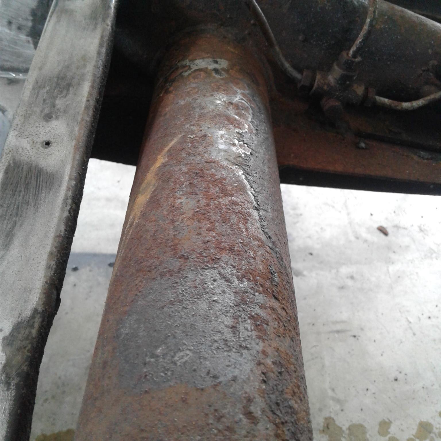

l I don't have money for media blasting or dipping . gonna use a lot of elbow grease . wirewheels,sandpaper,and grinder wheels . decided to work on bulk head.

Get after that bare metal with some Ospho (phosphoric acid) and convert that rust to iron oxide. Then prime and paint it when you have the rest of the chassis cleaned up.
Good Luck.

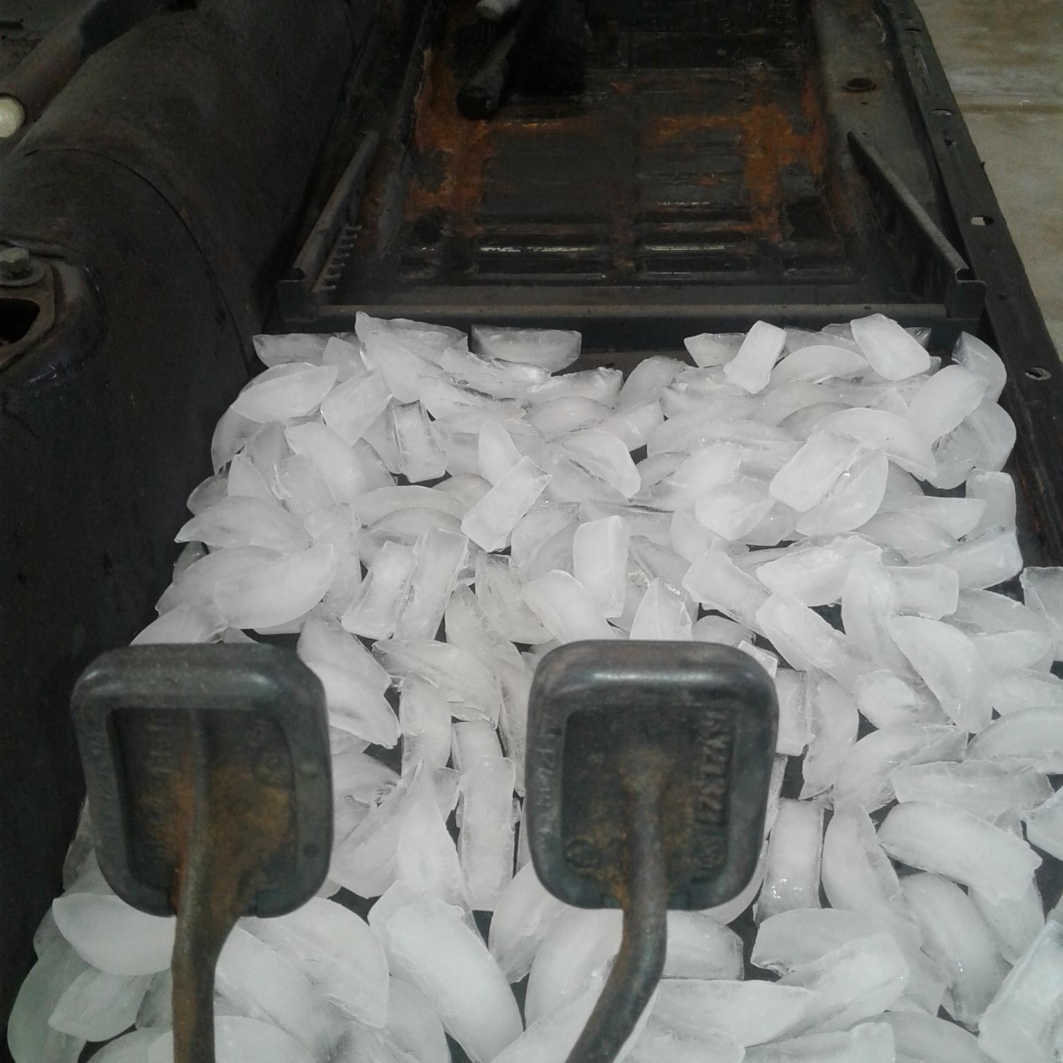

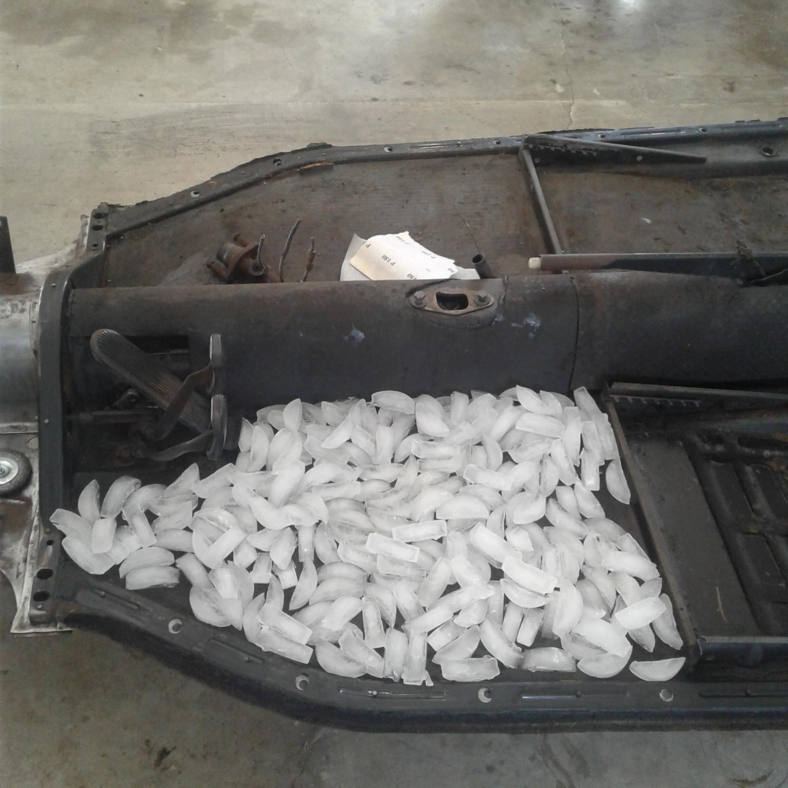

moved to tar boards. no dry ice ,,,, but

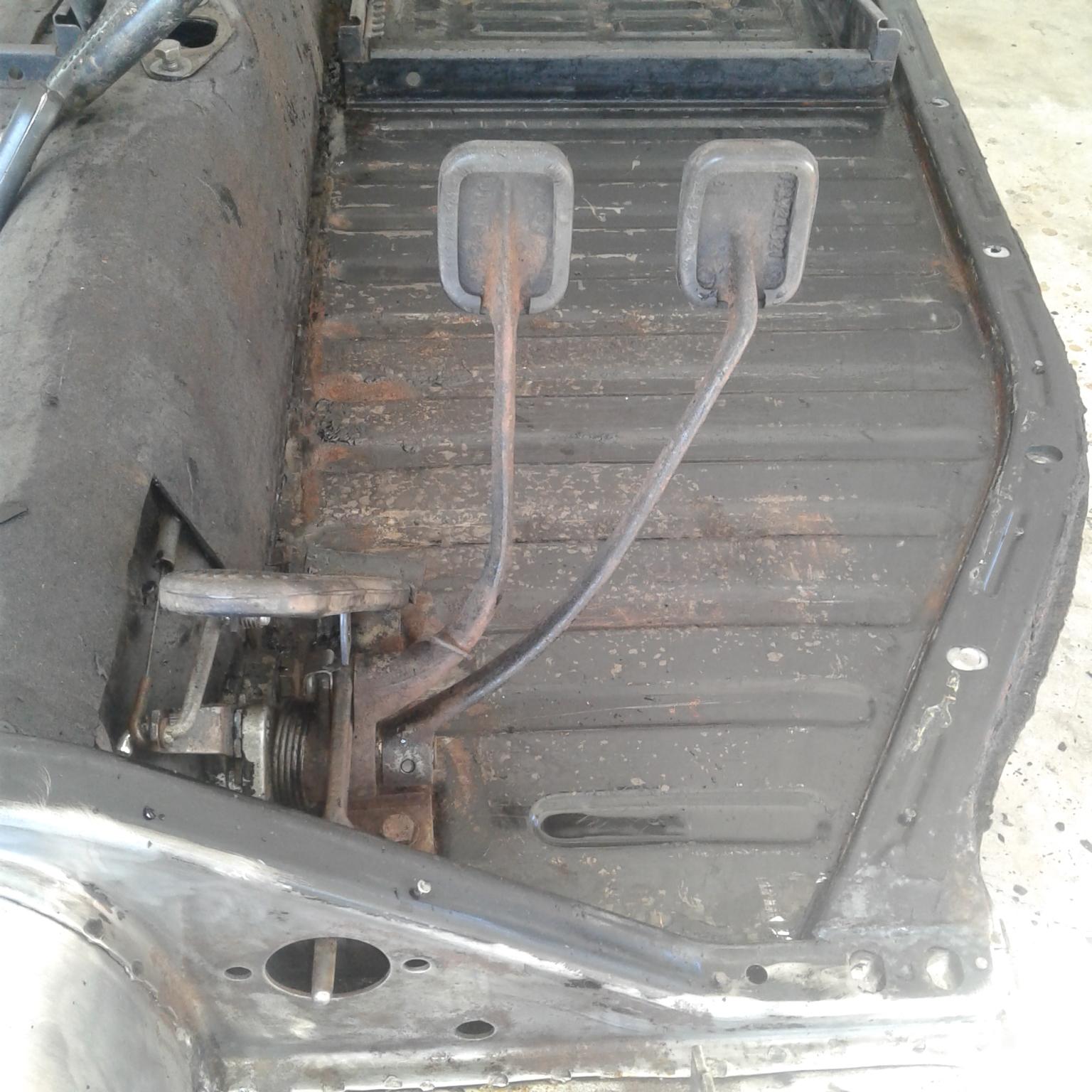

working on the pans.

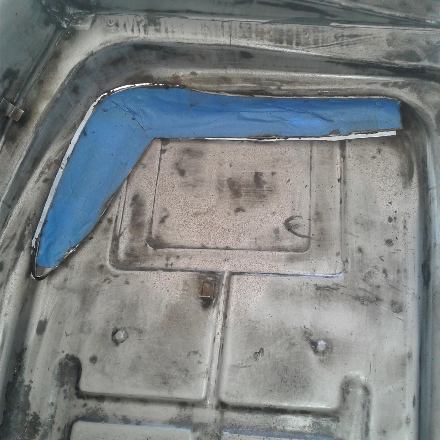

PostPosted: Sat Jan 18, 2020 7:48 pm    Post subject: Re: mic lovin it , early 1964 bug project Reply with quote

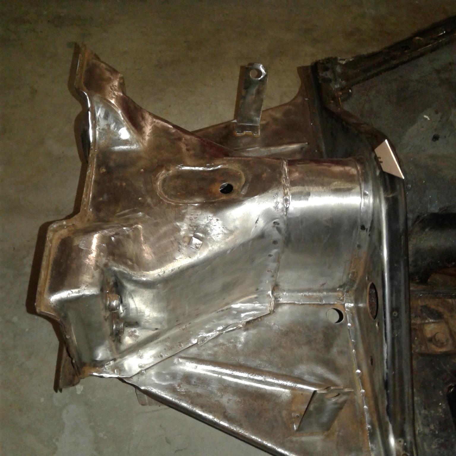

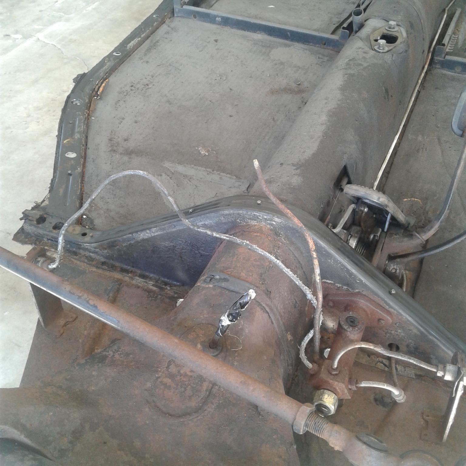

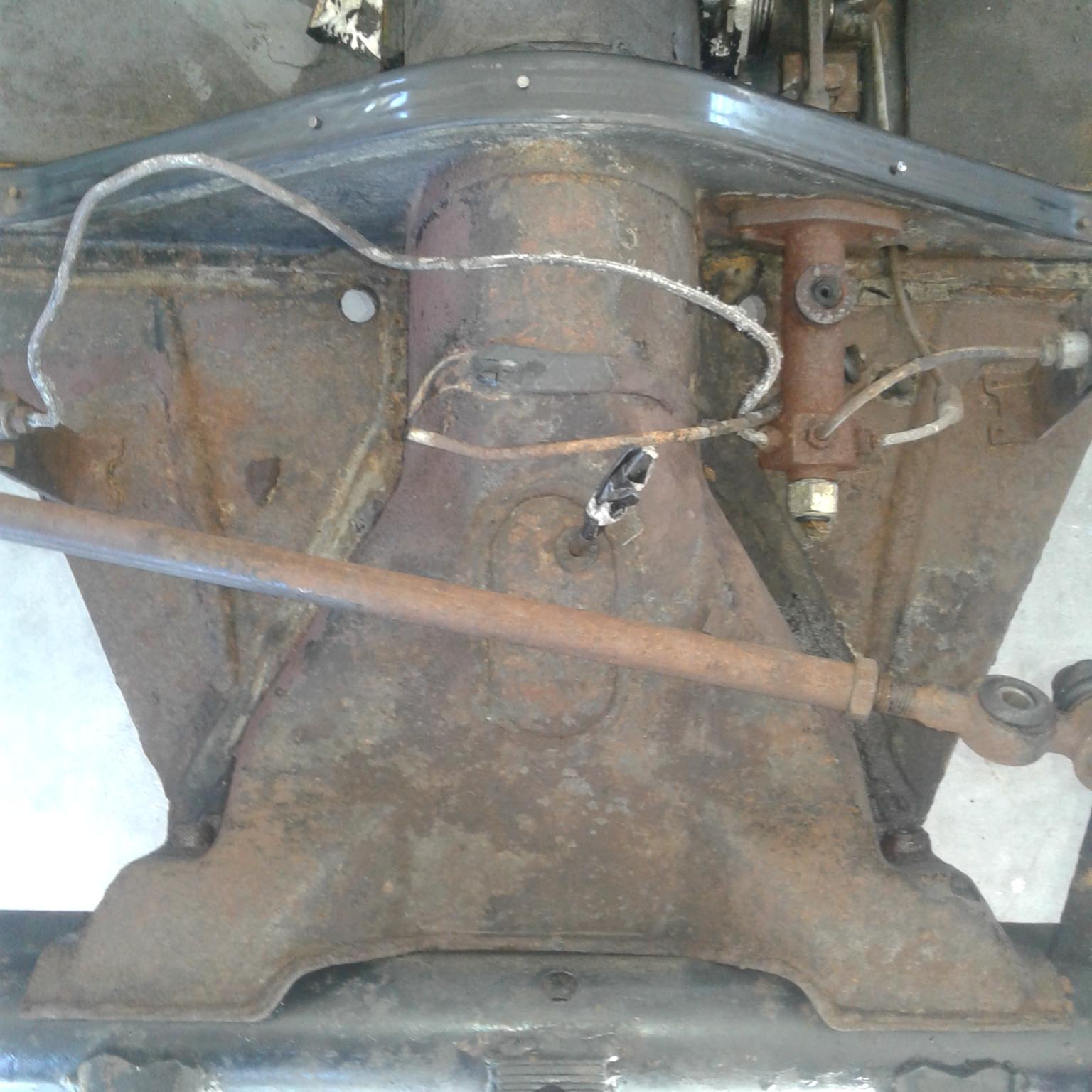

ran into a patch job and , some rust in the rear . Mad theres no way I could leave that lol . so ….blue tape is where I cut . im trying to keep as much og metal as possible

PostPosted: Sat Jan 18, 2020 8:07 pm    Post subject: Re: mic lovin it , early 1964 bug project Reply with quote
moving to the rear
