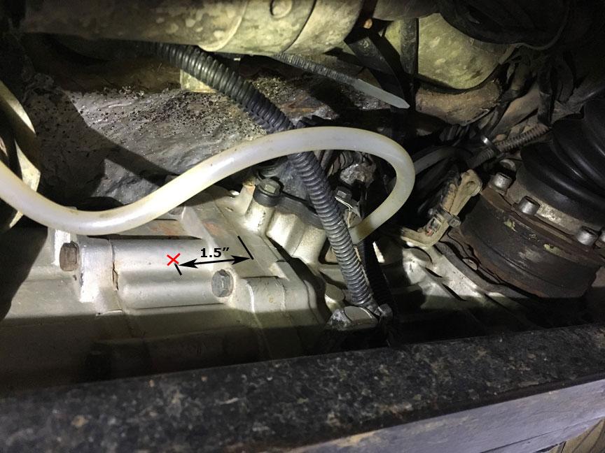

PostPosted: Thu Dec 06, 2018 12:17 am    Post subject: Re: Temperature Control (electric) - Manual Transaxle gearoil cooler Reply with quote
600F is plenty.
We are hoping NOT to see 330*F that can mess with the temper of steel.
By then your gear oil is smoking too yikes!
But the 220*F that 87VanWes saw would get my attention too!
I used 95/5 solder (464*F melting) but the temperature well can be made with JB weld.
21/64 Drill and 1/8-27 NPT tap
male hex nipple (cut, drilled 9/32)
9/32" brass tube
Location is easy and non-critical; 45* angle and 1.5" fwd on the cylindrical boss - on the gear carrier housing.
It can be done all cowboy but I have the drill jig if any Seattle fellas wanna drill. Wink
I have not drilled my trans and tested yet (hopefully soon).

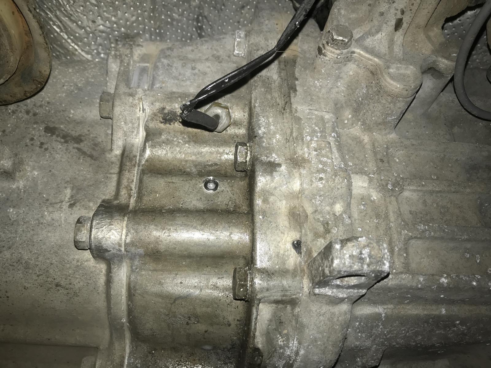

jalan
Joined: December 11, 2009
Posts: 88
Location: Underwood, Washington
jalan is offline
PostPosted: Mon Dec 17, 2018 11:37 pm    Post subject: Re: Temperature Control (electric) - Manual Transaxle gearoil cooler Reply with quote
That location for the temp sensor looks like the ideal spot. I wonder if you could drill a hole just big enough for the Inkwell sensor but not through the case and pot it right into the case with Arctic Alumina. At that 45 deg angle the hole might be just long enough without drilling through. Might not respond quite as fast as in a thin thermo well but if it is constantly blasted with hot oil it seems like it would heat up pretty quickly. Wish I had a spare case to play with.
I bought an Inkwell unit and then found an eBay offering for $7.86 + $1.77 shipping. From China, if your not in a hurry, but it's exactly the same as the Inkwell, just doesn't have Inkwell printed on it. So cheap I bought another one. Do an eBay search for WH7016C DC12V

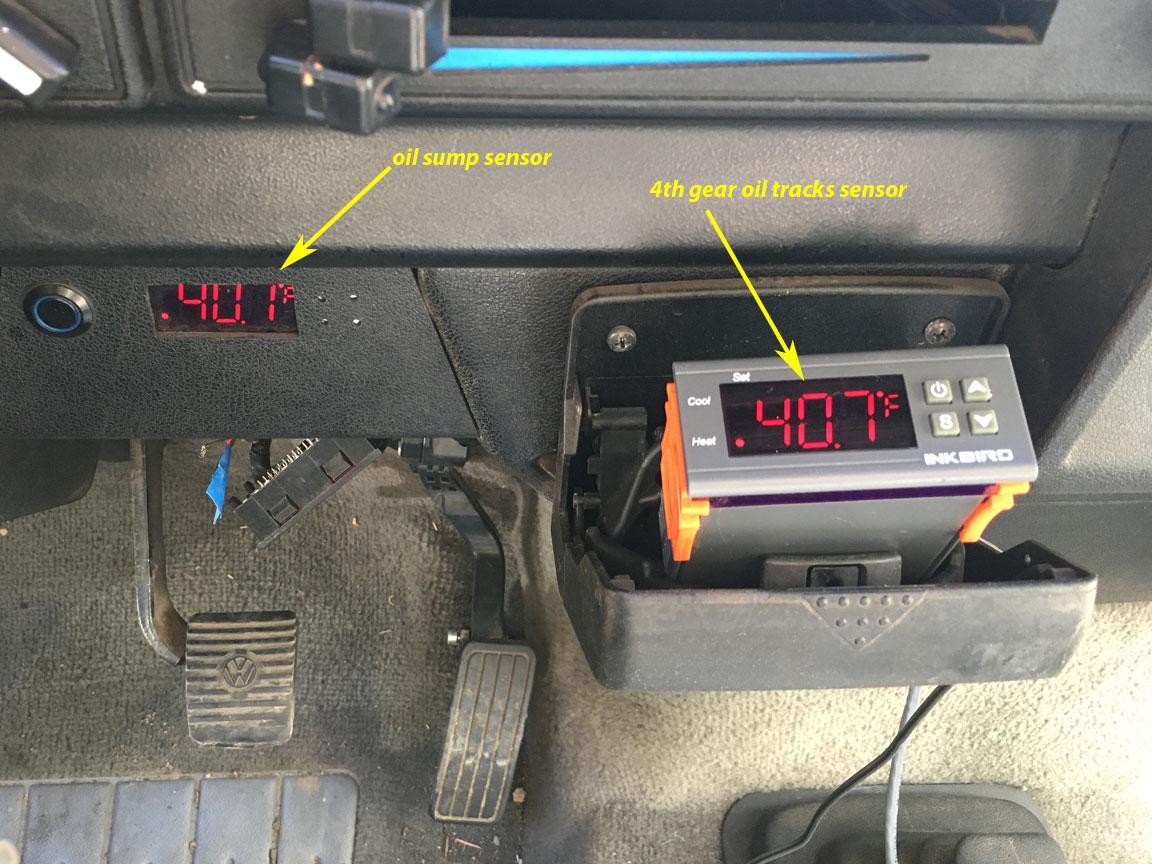

PostPosted: Mon Mar 04, 2019 10:31 pm    Post subject: Re: Temperature Control (electric) - Manual Transaxle gearoil cooler Reply with quote
I drilled yet another hole in my trans yesterday.
I bolted on my drill jig
pressurized the transaxle with air.
then drill-baby-drill,
Spotfaced the hole,
Tapped it to 1/8-27 NPT
Sensor installed, 'temporary wired' to the "4th gear oil tracks" gauge.
Sensor inside looks like THIS .
Added a gauge to compare to temps of the oil sump.
I went for a drive up the mountain. It was cold, about 34F going up the mountain, driving 70-75mph.
There was one time I saw 140°F on the oil tracks sensor .vs. 134°F on the oil sump sensor, six whole degrees hotter. I was expecting the "oil tracks sensor" to show gear oil MUCH hotter than the sump. It's NOT reading the 220°F that Samba member 87VanWes reported, which is a relief. But I was kinda hoping for more validation that this location is the BOSS sensor location to trigger the micro-controller. I still think it's the best spot, just not as "best" as I theorized. Confused The theory that 4th gear is much hotter than the oil, appears to be "on-hold" (until summer). Or maybe it just means that my trans is "very good"?
And when I turned on the pump which blows an oil jet at the 4th gear mesh point, the oil tracks sensor dropped very quickly to 112°F. The oil was 34°F oil sitting outside in the cooler system hoses upon pump startup. So I'm pretty sure the oil blast at the 4th gear mesh does go thru the mesh and hit the sensor target. During this time the sump temp dropped a couple degrees.
Have to wait for summer for some more rigorous hot weather testing. But anyway, this suggests that my 4th gear is running pretty cool, at least in the winter.

what's the verdict on the new sensor location (on the boss)? i am in the process of installing a diff oil cooler/recirc system on my syncro. i like the boss location for many reasons but would like to hear some feedback before i go for it. Also, how critical is the location? will i hit something inside if im 1/4" off in any direction (i will be drilling it with trans in the van)? My sensor is about 1" long from the sealing surface (not NPT) to the tip. is the sensor length OK for clearance? Thank you.

Vmorris wrote:
what's the verdict on the new sensor location (on the boss)? i am in the process of installing a diff oil cooler/recirc system on my syncro. i like the boss location for many reasons but would like to hear some feedback before i go for it. Also, how critical is the location? will i hit something inside if im 1/4" off in any direction (i will be drilling it with trans in the van)? My sensor is about 1" long mi from the sealing surface (not NPT) to the tip. is the sensor length OK for clearance? Thank you.
Here's what has happened WRT this proposed sensor location.
It was a hypothesis.
Placing a sensor in the 4th gear oil track showed that MY 4th gear was NOT overheating.
Consequently I did NOT move my system control to that sensor location.
Heres from a few posts back, ^^^ up there ^^^ from March 2019....
Current concensus between a small cadre of Syncro-oiling-nuts is:
Most of the 4th gear heat problems were on trannies with "an unknown problem"showed burned oil etc on 4th gear.
But now we have actual data showing that (*my*) 4th gear does not get hot.
The last time I drove 80mph on a 100F day, I didn’t have the sensor in place, dangit.
Maybe it DOES get hot in those conditions?
But it's now wintertime again and we don't have the data.
Maybe it requires a 6-cyl, hightop, heavy weight, speed and summertime. Dunno.
It's going to take awhile to gather the data with so few people testing.
If you chose the 4th gear track location to control your oil pump, then shortly after your oil starts to squirt, the sensor will cool quickly, shutting off the pump, while the oil sump remains hot.
Perhaps a worn mainshaft bearing that allows the 4th gear teeth to mesh outside the tooth circle (and tooth-sliding, causing heat). Maybe the heat is from the mainshaft bearing? We don't know because we don't have a "hot 4th" test vehicle.
Currently it seems like the best location for cooler control sensor is at the bottom of the oil sump.
Vmorris plz check in from time to time wrt your project.
This issue wilL benefit from more people testing/reporting.

PostPosted: Sat Jan 25, 2020 12:00 am    Post subject: Re: Temperature Control (electric) - Manual Transaxle gearoil cooler Reply with quote
I did managed to get in a few long road trips this past summer with my new oil cooling/filtering system. Thanks SODO for all your encouragement, help and parts.
I am running an '89 tiptop with a 2.5 Subaru that supposedly has been re-tuned to put out close to 200hp. The tranny was rebuilt with a .75 4th gear and I am running 205 70 R 15's and Amsoil Severe Gear 75-140.
I chose not to use a fan cooled oil cooler but to go with a more efficient flat plate cooler mounted up front. As I don't want to overcool my oil I put a 145 degree High-Flow Engine Oil Cooler Thermostat [Part # FSM] from Improved Racing in the circuit.
A recap; pumping the oil with Mocal heavy duty gear pump through a Canton 8 micron filter and a mini Magnom magnetic filter. Then to the bypass thermostat and back to the filler port with a nozzle hitting 4th gear. Pump controlled by an Inkbird controller with temp probe in boss on left lower side of tranny (4th gear splash zone). 10 row flat plate cooler mounted behind lower radiator grill.
I set the pump temp control at 80 for winter and 90 for summer.
Bottom line;
1- temperature probe picks up changes very rapidly
2- oil temp drops a few degrees when the pump turns on but there isn't enough oil volume in the pumped system to cool it enough to shut down the pump
3- thermostat starts to direct oil to the cooler at 135 degrees. I see a slight temp dip as the cool oil moves through but it evens out quickly.
4- maximum temperature I observed last summer, loaded for camping and on the hwy 65-70+ was 145. Normal hwy oil temps hover between 135 and 140 in the summer.
A couple of other notes;
I didn't drill all the way through the case for the temp probe, rather I epoxied it into an 1/8" pipe fitting and screwed it into a tapped hole in the aforementioned boss (see SODO's posts).
6600 miles on it since I installed it and it seems to be working perfectly.
BATS inc is a great source for pump, fittings, hose etc.
Short trips and winter driving it rarely gets hot enough to direct the oil through the cooler.
The other small plug in the tranny/temp sensor picture is my oil level check hole.
I'll post an update when I change the tranny oil and clean the filters although that's probably a year down the road

Good to see another system up & running. I bought the FSM thermostat too, after your mention of it, but haven't installed it.
At 6600 miles I'd wanna have a look at the filter just to see what's happening in there.
My trans is cool and quiet, yet I'm always surprised at the metal the filter is catching.
It makes me wanna take my trans apart just to look.
Is that an oil level check hole that I see below your sensor?

PostPosted: Sun Jan 26, 2020 10:54 am    Post subject: Re: Temperature Control (electric) - Manual Transaxle gearoil cooler Reply with quote
Yes that small plug is the oil level check hole. It can even be used to top up the tranny if you have a big syringe and patience. So far no leaks=no oil loss=all smiles.
I will check those filters as soon as I get a chance just to see what is in there.
Forgot to mention that I also added a couple of neodymium magnets to the Canton filter as there was room between the filter element and the case. I'll see how effective they are compared to the Magnom mini when I open it up.
