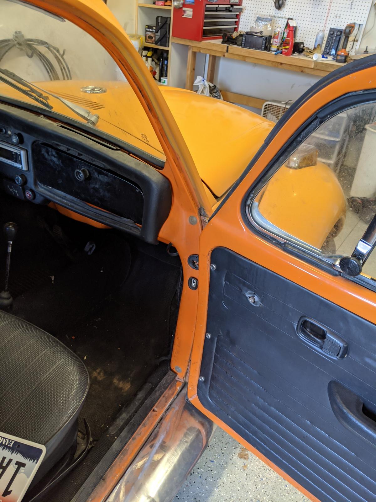

I bought a '72 Super Beetle to work on as a project.
It looks pretty good as long as you don't look at it from the front...
It was originally orange I think, as evidenced by the interior paint
But the exterior has had a respray at some point and is badly faded
