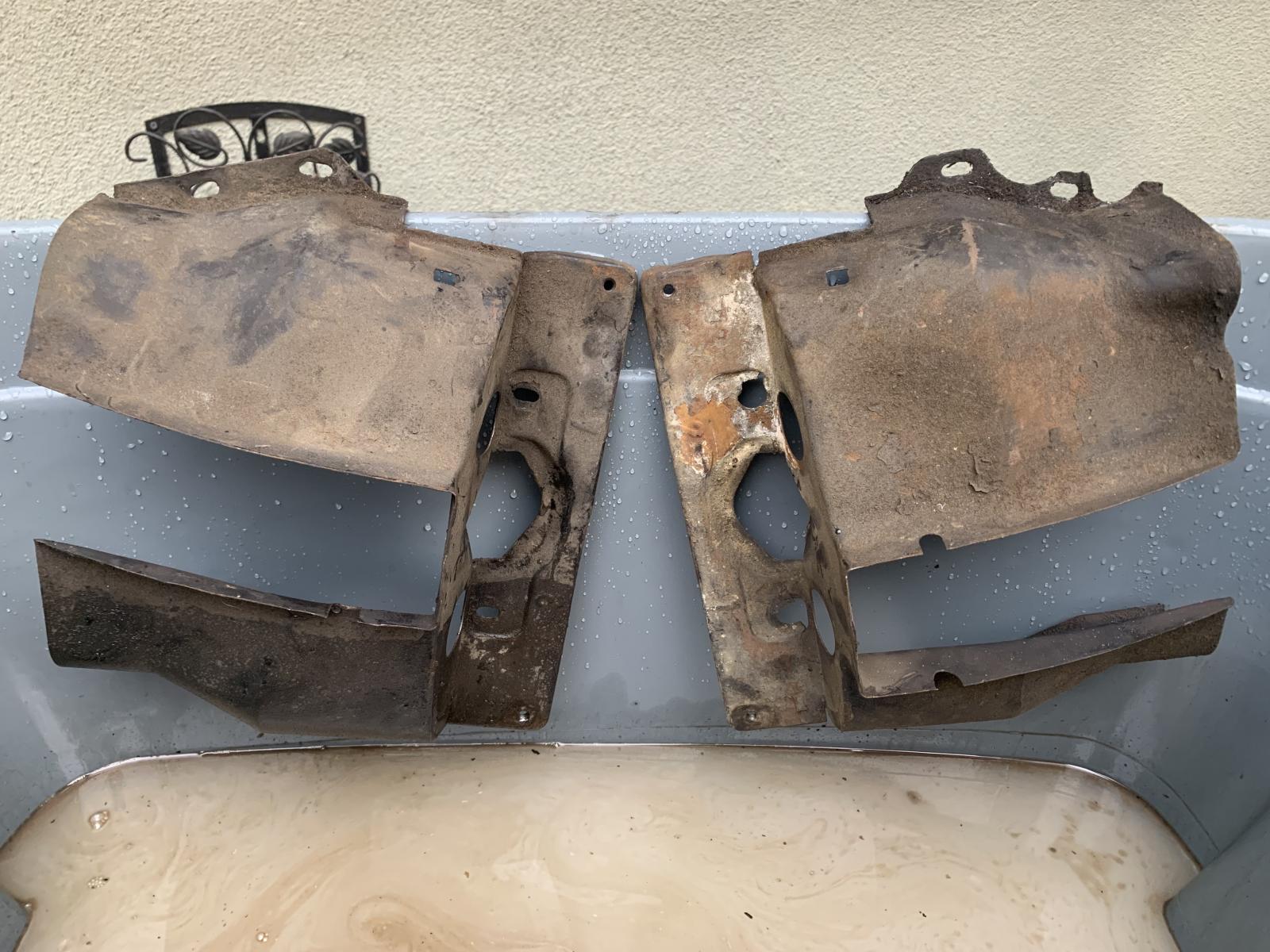

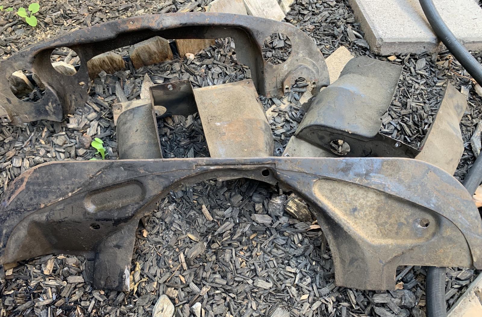

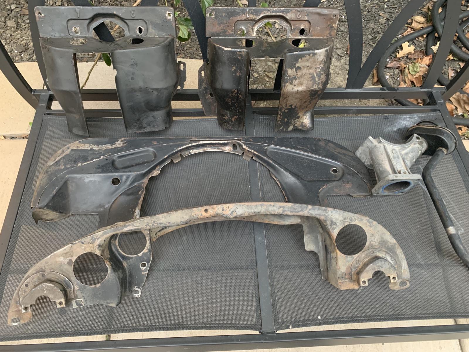

Cleaned some tin.

PostPosted: Tue Mar 03, 2020 9:18 am    Post subject: Re: What did you do for your Bus today? Reply with quote
volkswagen60 wrote:
Cleaned some tin.
Clean!
BTW, that's an early bay front tin.
You might want to get a split bus (same as bug) front tin. It doesn't have the extra piece on it and is actually easier to find. Someone wants that for their bay.
That's a bay/ late bug rear tin.
Do you have the rest of the engine tin?

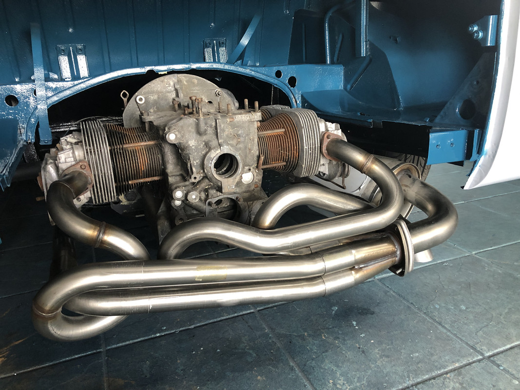

Today. Yesterday. The day before. Feels like every bloody day since forever.
But it's nearly ready.
Just got to work out how to get it off the stand now Rolling Eyes

OMG it's beautiful and I need to do the same I am not an engine expert it's hard for me to tell what it is in style and configuration, is it dual port? The front looks single port then the side looks dual and I'm always learning and love to learn more. What size is it? 1600? Bigger? Keep up the great work Who.Me?. I love the paint it's so beautiful and refreshing it makes me feel so much better under the current circumstances of our planet. Thanks for cheering me and many up.
Thanks. It's a 1600 dual port. Most of the 'paint' is powder coat. The exhaust is Hycote Extreme Heat silver grey rattle can paint. I figured I'd bite the bullet and make it look nice while I was digging in to it.
I'd refubished or replaced pretty well all of the ancillaries in the past few years, while I tried to fix a rough-running issue without tearing it apart completely.
I'd never been able to get the engine to start and idle properly and the oil had a metallic sheen, so I tore it apart last autumn to see what was going on.
It turned out that whoever built it put a performance cam (Engle W110) in it and strangled it with a stock single carb setup. The bearings were also heavily scored and I think that it had been run hot and overheated in the past. I had the case machined and have rebuilt it with a stock-profile cam and new heads, pistons and barrels.
It's taken ages to feel my way through it though because repro parts don't always 'just work'. Lots of measuring and waiting for answers to my stupid questions in the engine forum.
My wife is extremely tolerant and let me build it indoors (everything was spotlessly clean, but it's a big lump to have indoors).
But now it's ready. We've just got to work out how to get it back off the stand on our own* so I can get it out of the house and test run it. *We're having to isolate ('social distancing') because my wife helps care for two of her close relatives with some serious health issues.
It's been good fun and I learned a lot in the process.
Hopefully it'll run and won't just leak oil from the case joint or grenade on start up. Laughing

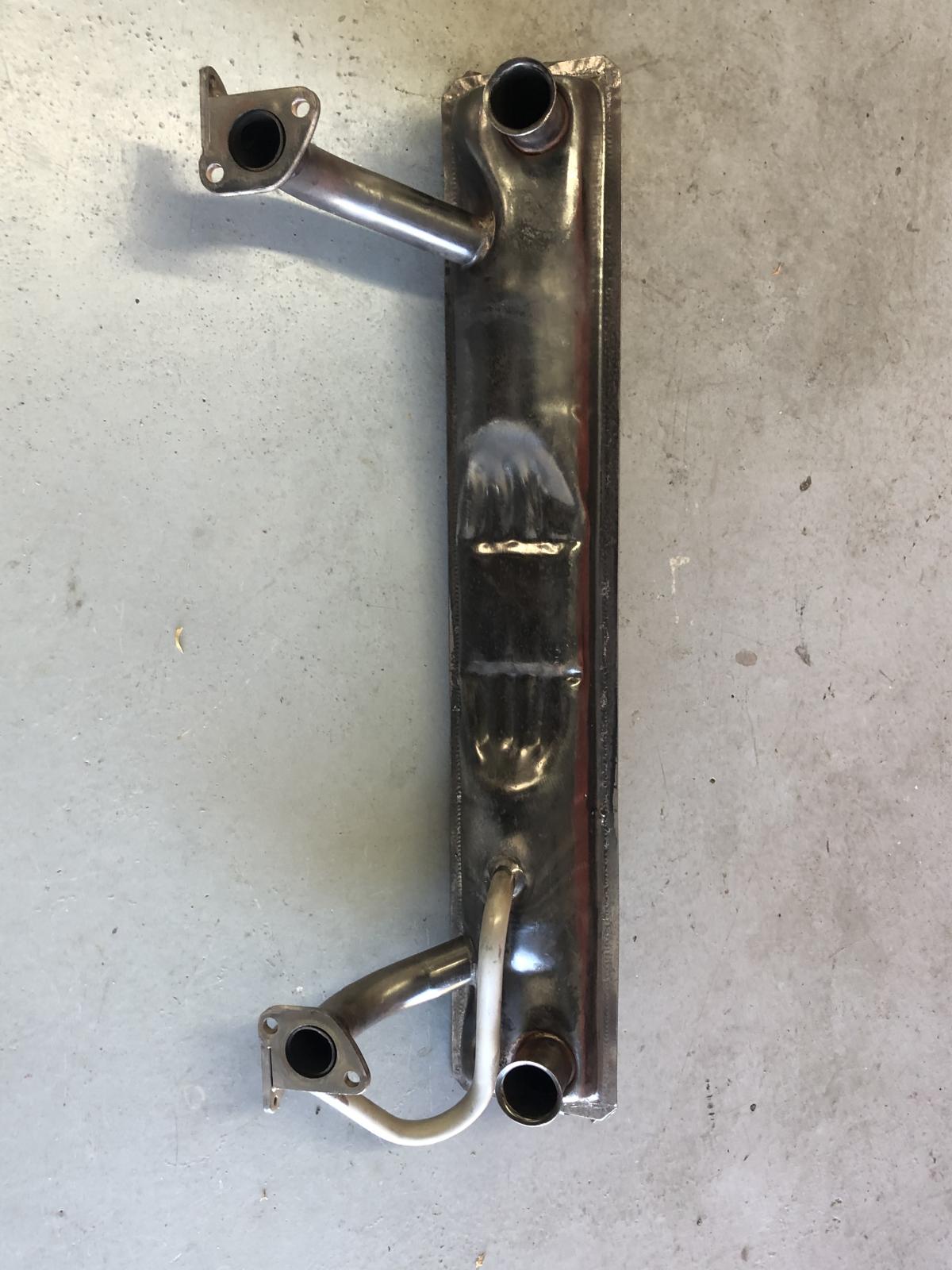

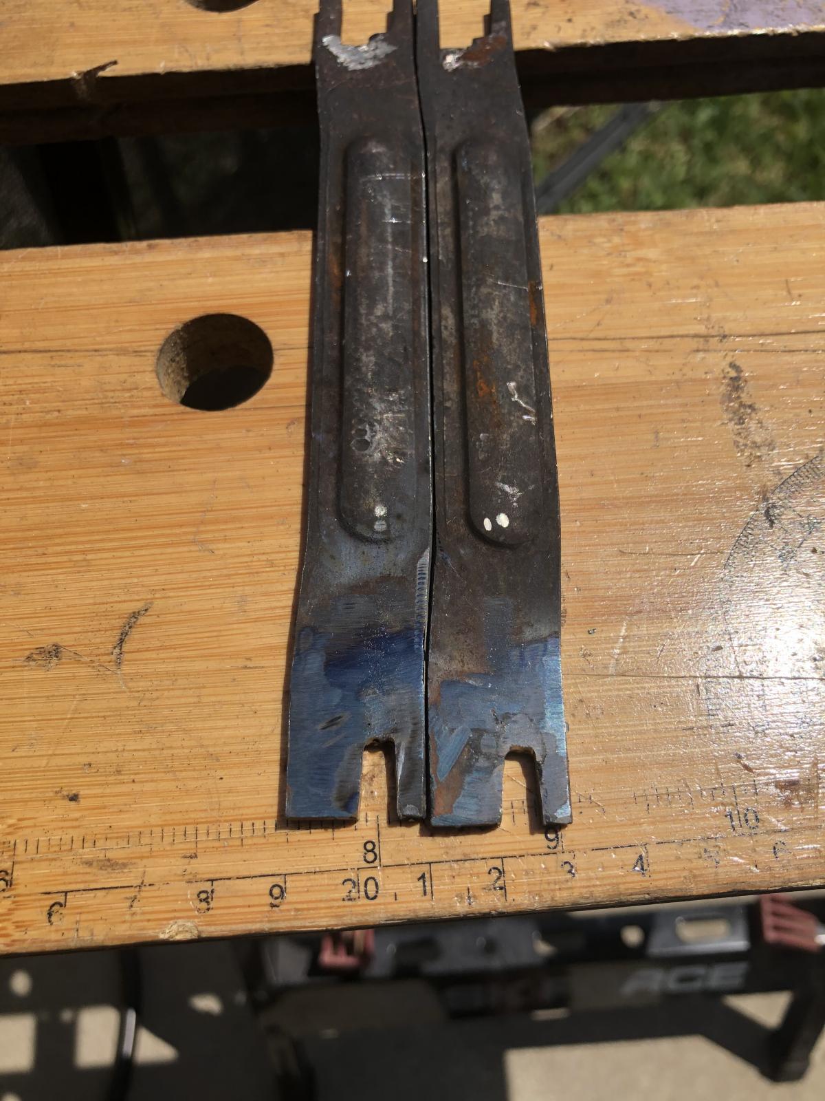

Fixed my emergency brake by welding some metal to make the notch smaller on my brake pad spreader push bar.

Welded up a hole in my muffler and wire wheel cleaned up the finish to be ready for paint.

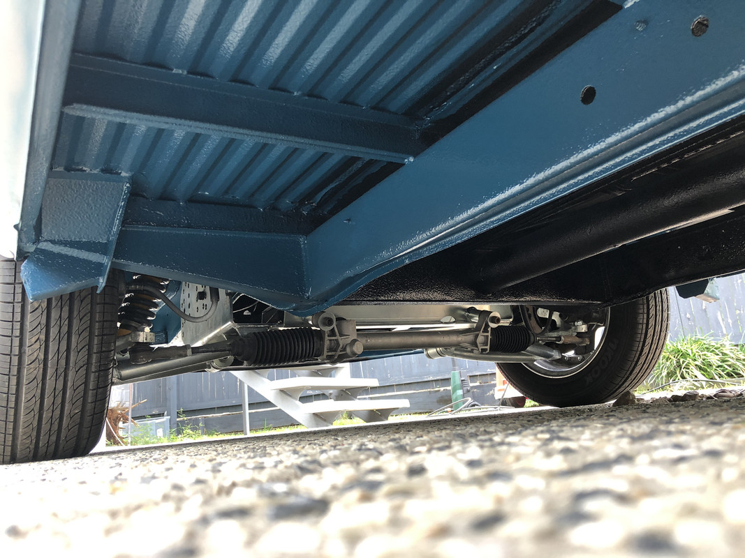

Painted underneath, setting up the front end
OK, well that lasted an entire 15 minutes.

Wow DakDak67, did you do that from under the bus? Beautiful either way.
[url=https://postimg.cc/sQWBWnkH]
getting ready to plumb my oil system and fuel system
[url=https://postimg.cc/2q6LGLfY]
What did you paint it with?
