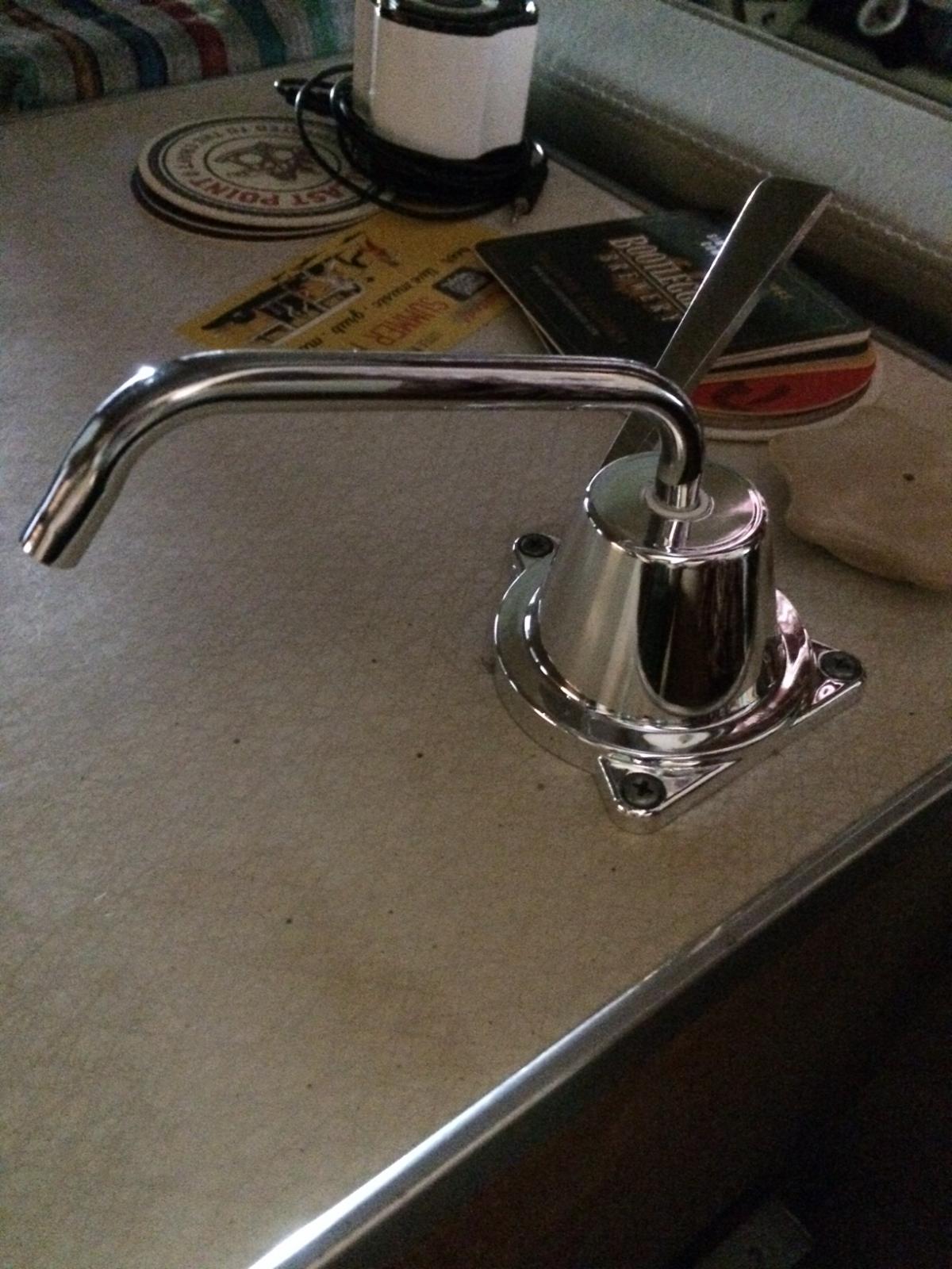

Not of much help... but I have one on my EZ. Haven't used it yet (though have been camping) and can't recall the screw orientation - which may vary.
It came on the bus since the seller had restored the chill box/tank cabinet. He wrote "We have installed a brand new water tank from the original manufacture. We installed a new water pump and water drain valve."
If of any help, I'll send a pic tonight of the mounted pump if the old brain remembers!

The pump with two screws (like the original) is out of production now.
...actually, perhaps it is again!
I dug up my receipt from 2015, and looked it up, and unlike mine (pictured below with yellow background), if you go to the product now, today (March 24th, 2017),
it looks like the CURRENT JC804 looks almost identical to the original SO-42 with only two screws!
LINK:
http://www.rvplus.com/r.v.-accessories-pump-rocker-chrome-jc804.html
Someone buy one and let us know.
Here's mine from 2015 (with the two properly placed holes):
...sure enough, mine has three-holes. It came on the bus and was new in Dec 2014. Not sure if all EZ Camper OG's were three or two holes... but below mine is a pic I took of an OG EZ interior. Thought to show it as it's yet another version and could end up on someone's SO-42 thinking it was OG equipment, etc.

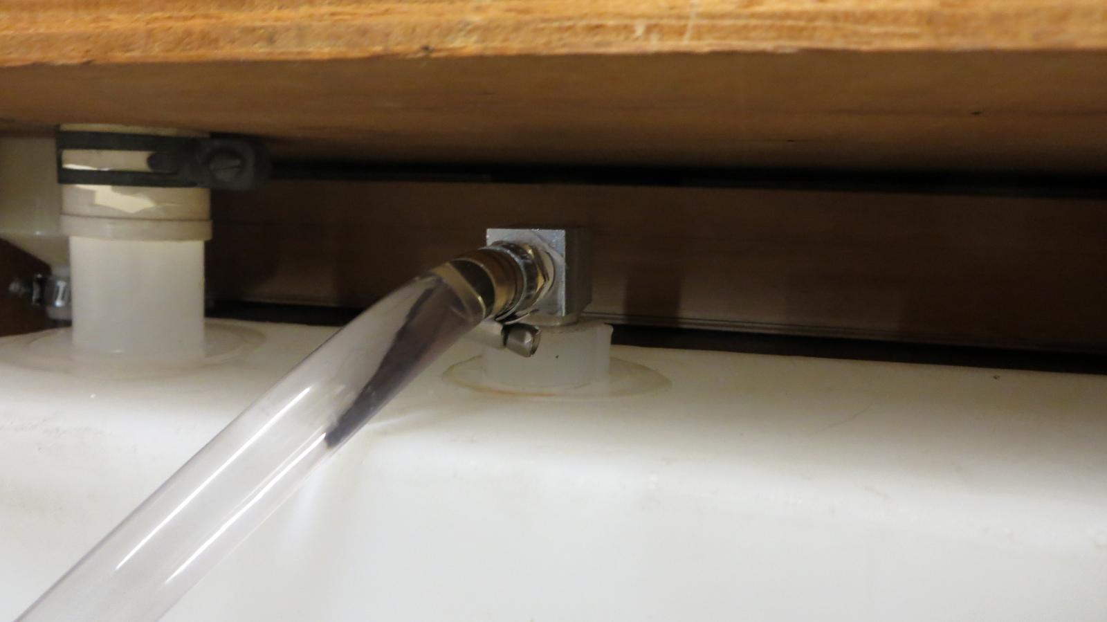

5. A pick-up line (preferably straight) to draw water out of the tank and thread into the tank its self.
...now this is tricky. I forget if it was this thread or others that someone said they made their own. Great for them. I don't have those skills.
It took a LOT of searching, but I found one that is long enough (too long, actually, but I cut it to proper length).
I got it from www.fisheriessupply.com
Item ID: MOE 033500-36
445884: 36IN Fuel Pick Up 3/4X1/4NPT
6. A right-angled piece to connect tubing to, preferably barbed.
Sorry; this is a bit of a misnomer. The pick-up tube (pictured above) already has the right-angle. So the piece I mean is something to conect to that which will connect to the flexible tubing.
I bought the one you see below at a local Home Depot:
Together with the pick-up tube and the tubing that goes to the pump:

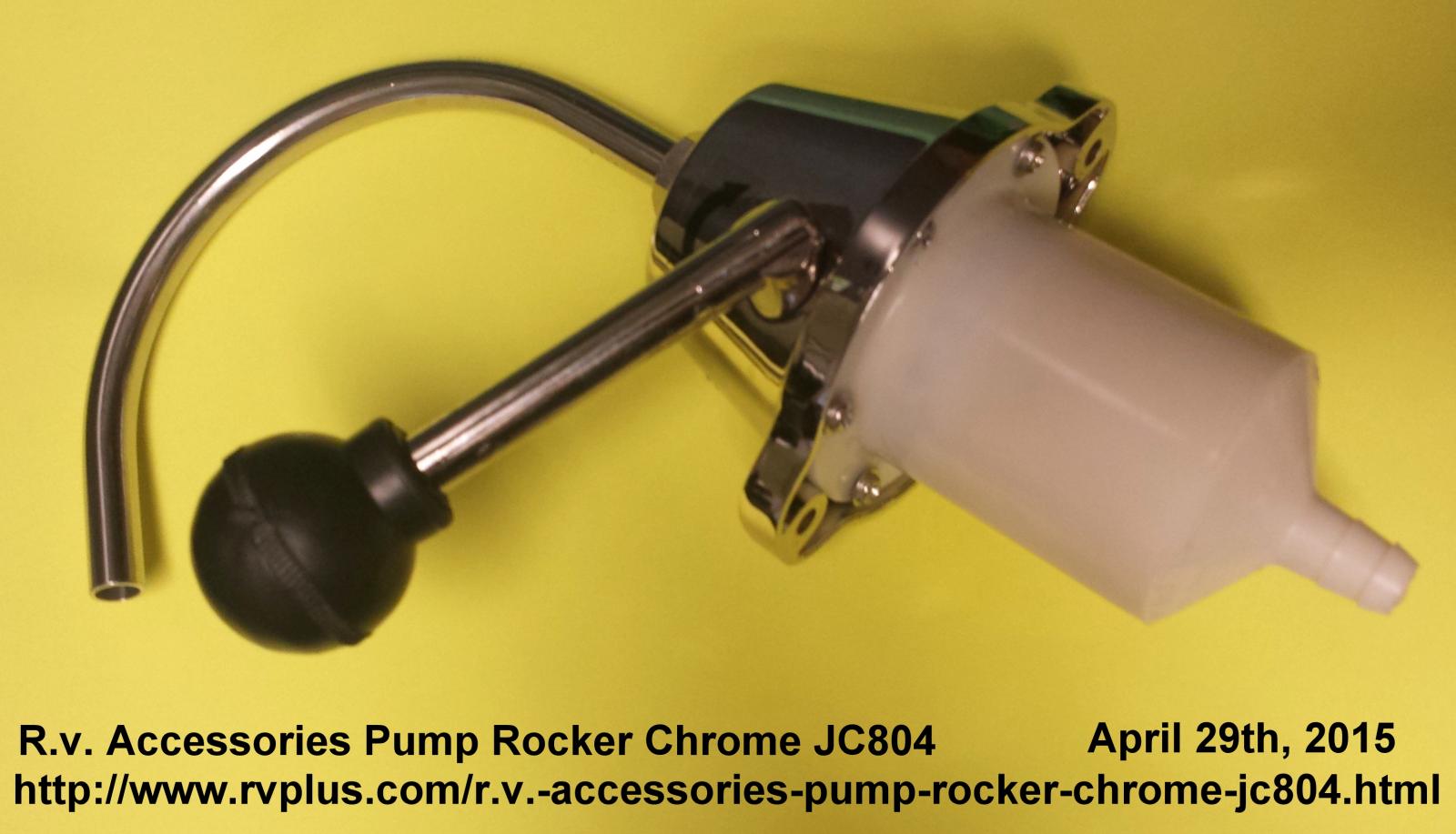

This is another tricky one. If you have read through this thread, you'll learn that currently (May 2017) no one seems to be making identical 2-screw hole Hand Pumps.
I spent more than I am willing to admit to see what works best (for me) and/or was most authentic looking... I was debating drilling a hole and putting in the one that looks original, but has three holes... but then I saw in a picture that I took in 1987 that my dad must have, at one time, replaced it himself:
...I decided to see if THAT type of pump is any good, and did find one.
The model I bought is called a : Valterra RP800 Chrome Rocket Hand Pump
Here it is on Amazon: https://www.amazon.com/gp/product/B000BGM2XG/ref=oh_aui_detailpage_o03_s00?ie=UTF8&psc=1
I attached it and it worked AMAZINGLY WELL (for me, and my purposes).
The bad news is that the screw holes did not line up.
I had to make TWO NEW screw holes. The body of it covers most all of the prior holes that were stock, or that my dad must have made.
For me, this one works the best, and I have tried four different types of pumps.
LINK:

I'm digging up an old thread, but since DadaCheese requested someone to purchase the two screw Zebra water pump and let the Samba community know, I figured I would post my response- It fits and matches my original perfectly.
The one on the right is my original
This is the Zebra water pump installed. The screw holes lined up perfectly.
Unfortunately, Zebra quit making this style with the flat handle and now only carry the one with the black ball on the end of the handle. I hope this helps.
