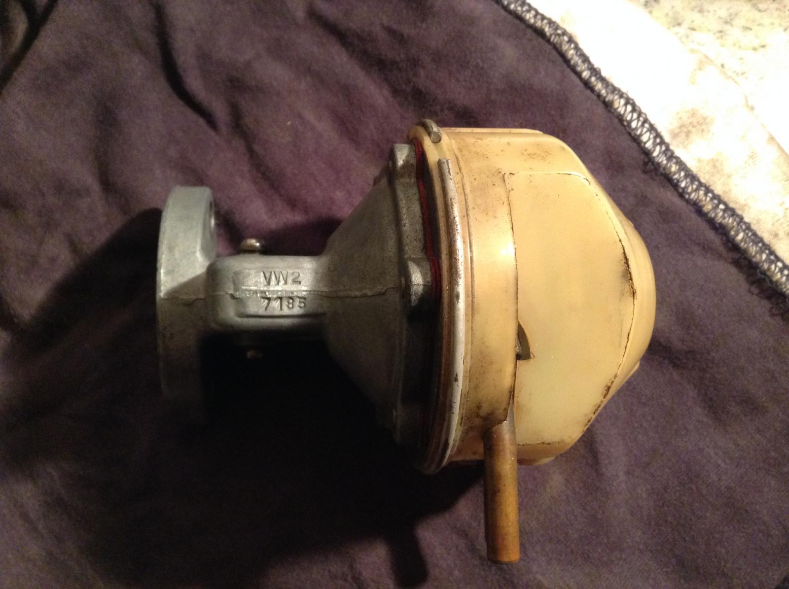

Great article, however it raises a question for me, i removed the pump from my 63's original un rebuilt motor recently as part of the teardown.
in line with the numbering system, VW2 is an early style parallel port pump, but using the numbers quoted it makes my pump build sometime in 1985.
So its obviously been replaced, but i am surprised that Pierburg were still producing pumps for a car that had been out of production for over 12 years.
Maybe they were!
Maybe they were!
You are 100% Wrong Shocked
Raised numbers like yours on the picture are Replacements Smile

Sorry Pedro i dont understand your reply.
I guess it is a replacement, but the numbers are stamped not raised.
There's a built up or should I say a step up we're is stamp
Look on page #1. Is a flat surface

Yeah ok i can see that difference. The raised bit, which must be a new casting. So my car had a replacement pump that was made on 7th January 1985.
7185. I had Not figure it out yet
Early Factory engines Only have Month and Year
There's NO Days on it
