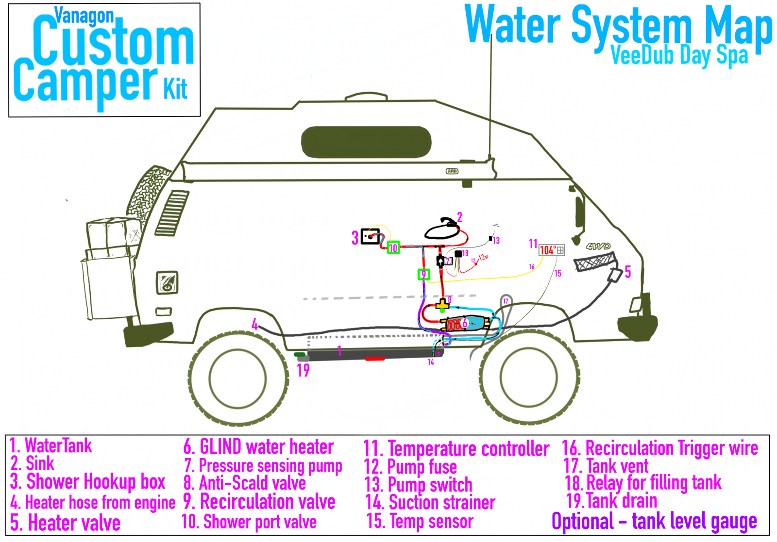

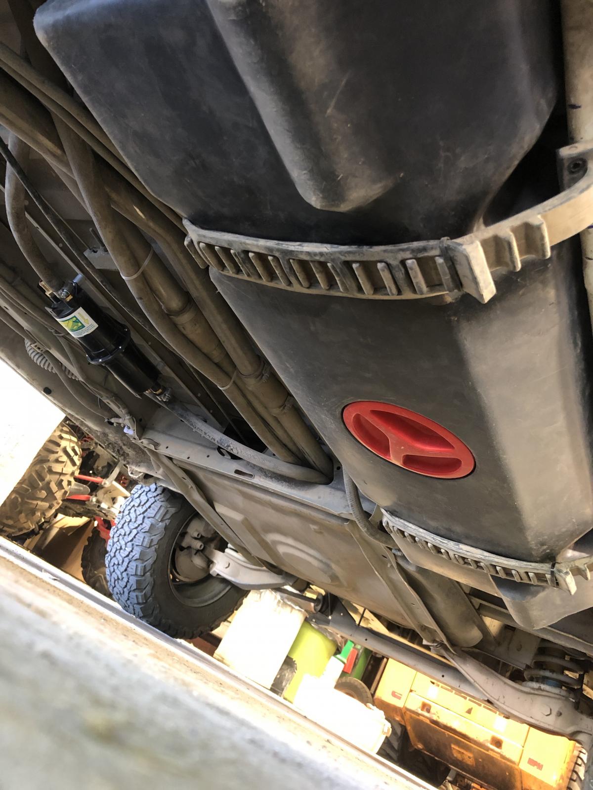

We hear it all the time, “Where do you shower?” Whether it’s from folks considering living in a van full-time, someone’s spouse who is on the fence with camping out of a van, the currently dirty traveler(you know who you are), or the just plain curious — hot showering is a sizzling topic that’s only getting hotter. The attempts out there to deliver a system that meets our goals have all fallen short in one way or another, so we have taken on the task to deliver a system that is safe, reliable, compact, attractive, modern, and robust. Through this process, we have become the North American distributor of the GLIND Hot Water System. While this system can be installed on any water cooled vessel, our main focus has been designing kits for our beloved Vanagons and we are excited to present and offer these to the Vanagon community.
What is the GLIND Hot Water System, you ask?
GLIND is an Australian company that has an impressive history of supplying industries with hot water spanning from the Australian Air Force, to the National Parks, to Whittley Cruisers, to Toyota, and much more. GLIND has a proven record and has passed the greatest test of all — the test of time — 30+ years, in fact.

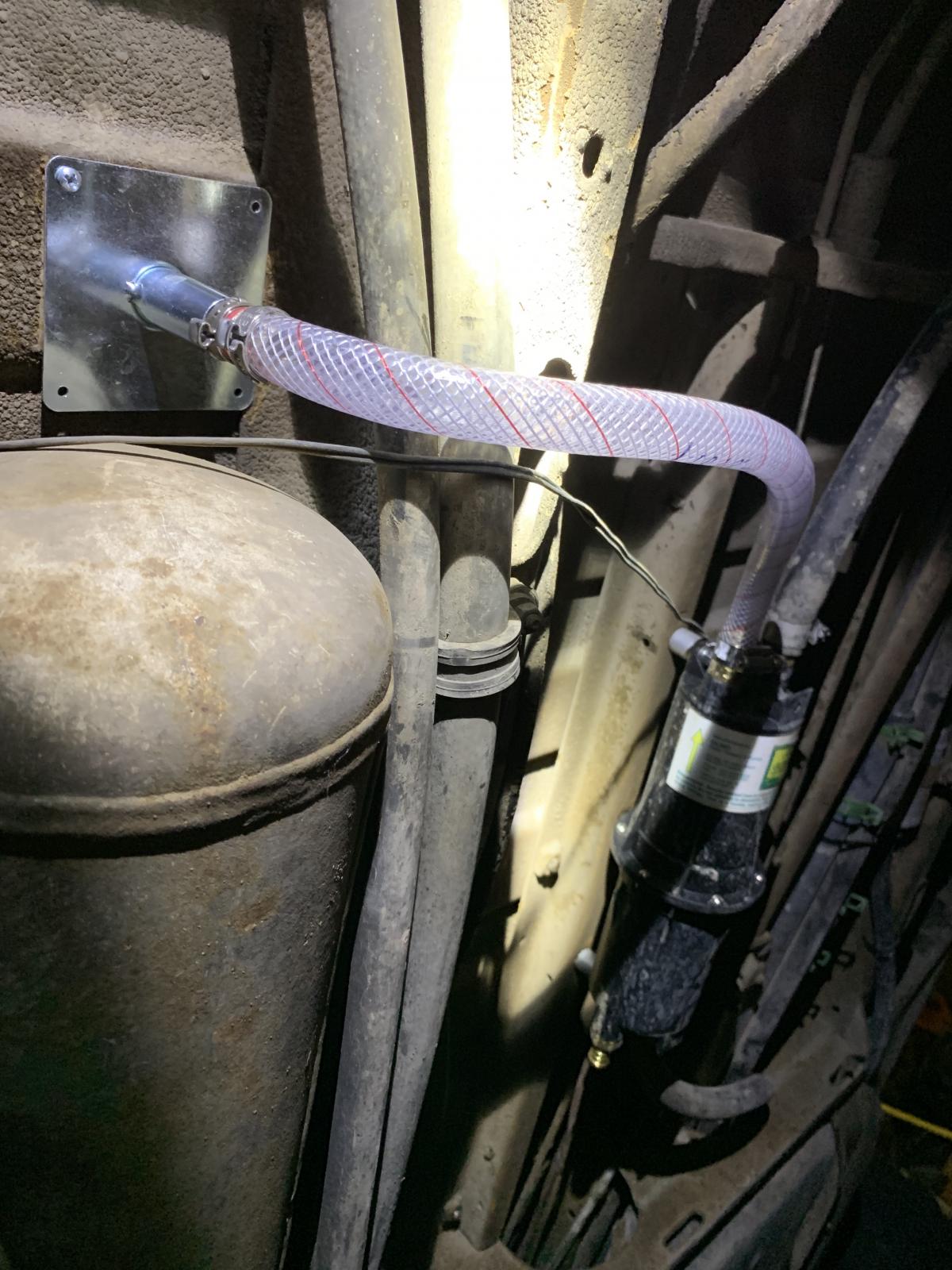

The heart of the system, the GLIND heat exchanger, is plumbed into the van’s heater line. A modern 12V marine pump draws water from the water tank -or outside source- through a separate line in the exchanger, effectively heating it to a comfortable temperature for use (the shower water does not mix with coolant.) No moving parts. No maintenance, other than standard winterizing.

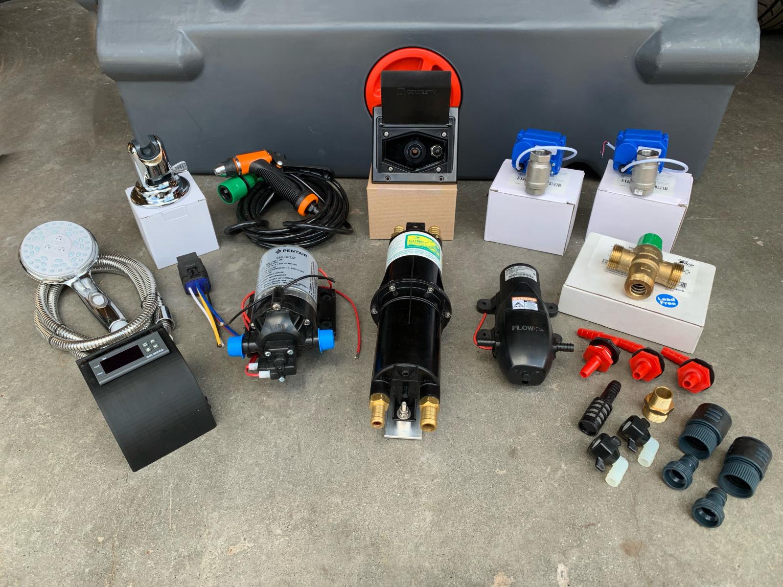

For the vanagon we have designed 3 different kit options (Customizable kits also available)
The Westfalia Kit
The Custom Camper Kit
The Tintop Kit
The Westfalia kit -

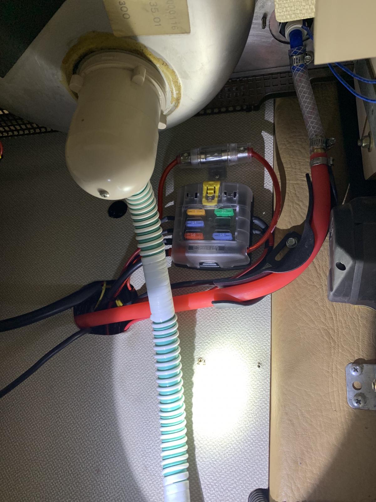

This kit enables westy owners to install a hot water system that will provide hot water to the kitchen sink and to a shower hookup box on the outside of the van. The water in the westy tank can be heated with the flip of a switch while driving, using a digital temperature controller and a motorized valve. Mounted directly into dash…

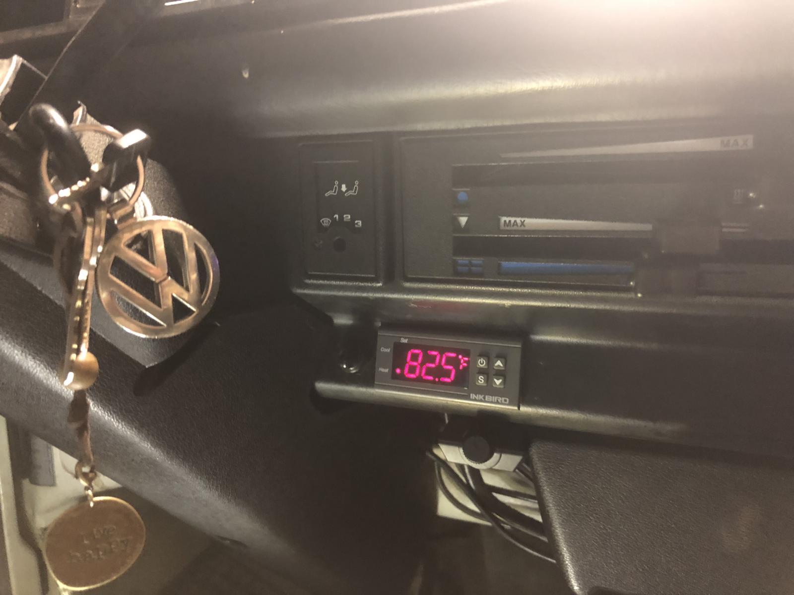

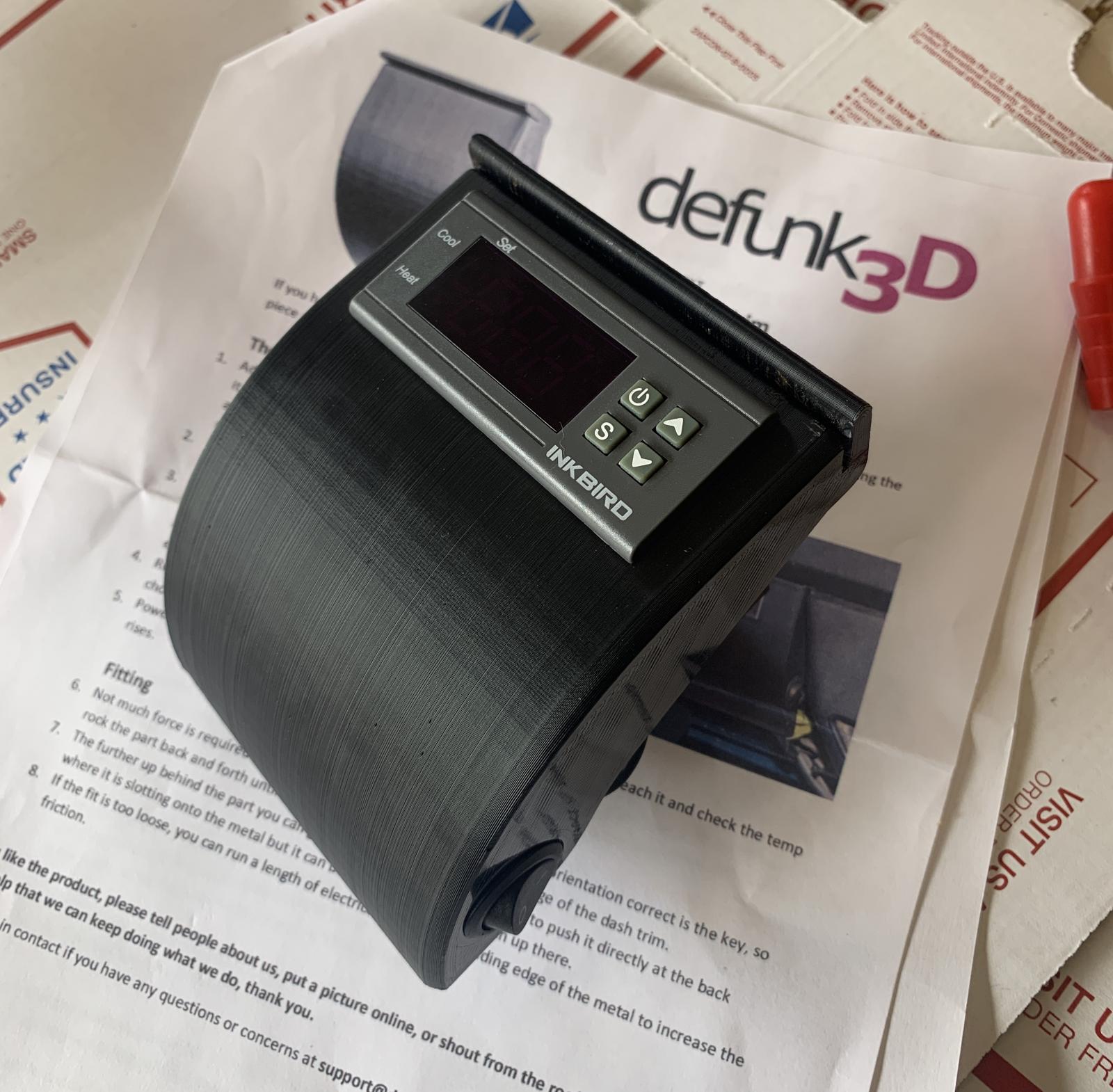

Exciting update! We have teamed up with another Vanagon small business DeFunk3D to bring you this mount system for the temp controller NO DRILLING INTO DASH!
A 1 gallon per minute pressure sensing pump will circulate water through the Glind heat exchanger and heat the tank to a preset temperature, all while you drive to camp/surf/work etc. A thermostatic mixing valve(Anti-Scald valve) is added to the system to prevent the chance of scalding. Outside the van, you can open the hookup box, flip the switch and water will come out for showers, washing hands, filling dog bowls, rinsing off feet, kids, dogs, the van etc.
Turn on the sink faucet and enjoy hot water there as well.
We recommend insulating the water tank for longer lasting hot water. If the tank is cold, you are also able to start the van, idle or drive for a little bit and once the engine is hot, you can turn on the sink or shower port and hot water will flow in an “on demand” style without the need to heat the tank.
Installation instructions included.
Custom Camper kit -
The Custom camper kit is very similar to the Westfalia kit except it is modeled for vans without the westy water tank. This uses a 45L tank made by Riemo that mounts under the van. This kit includes a level sensor and gauge for the water tank. The hookup box can be installed anywhere and acts as a water OUTLET for showers, sprayers etc- and with the flip of a switch now acts as a water INLET for filling the tank. The rest of the system functions in the same way as the westy kit above.
TinTop kit -
This universal kit is for folks without onboard tanks or for those who want the simple and cost effective. Essentially, the Glind, a pump, and the ‘temper’ mixing valve live under the van and there are quick connects for INLET and OUTLET wherever is convenient for your use. Water can then be drawn through the system using a water jug, jerry can, river, stream, etc and heated while the engine is hot. Hot water for showers/ clean up at your fingertips. Perfect for all vehicles.
Customizable kits are available as well.
So now to answer the opening question, "where do I shower????" Anywhere Cool

How do you refill the water tank? The water inlet is now an outlet?
VeeDubDaySpa
Joined: February 29, 2008
Posts: 370
Location: Bend, OR
VeeDubDaySpa is offline
PostPosted: Sat Apr 04, 2020 1:33 pm    Post subject: Re: Westfalia and custom onboard hot water systems Reply with quote
Good question- on a westy, it is the city water port that is used, so the fill port is still there and usable.
On custom non westy builds, I have the outlet and the fill inlet combined into the one hookup. The switch at the box is an ON OFF ON DPDT switch. So when the switch is in the UP position water comes out (for shower, sprayer, washing hands, filling dog bowl etc) MIDDLE is OFF and DOWN is to fill the tank. It’s pretty cool what one switch is capable of doing.
