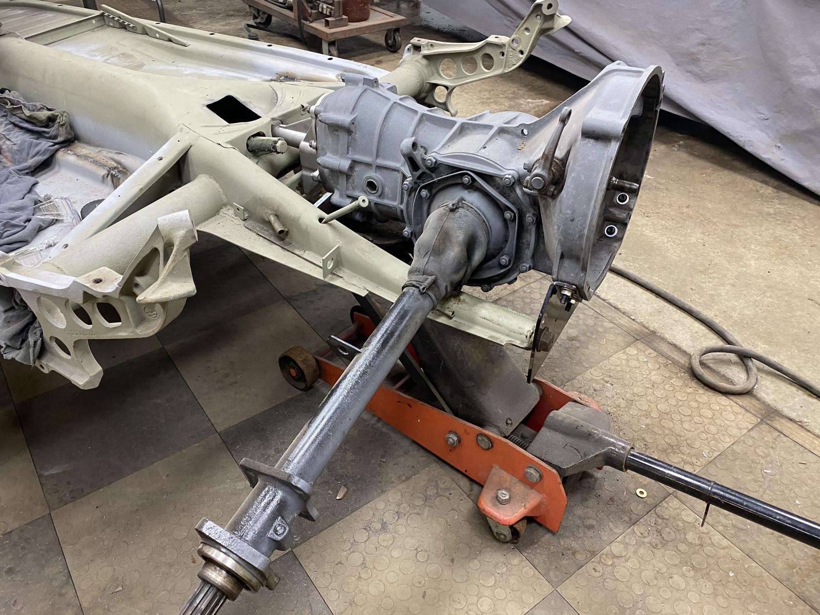

Trans had sixty years of goo on it. Still not all the way there, but getting closer.
Five+ hours in I'm starting to see metal. Wire brush is helping. Will pull axles next.

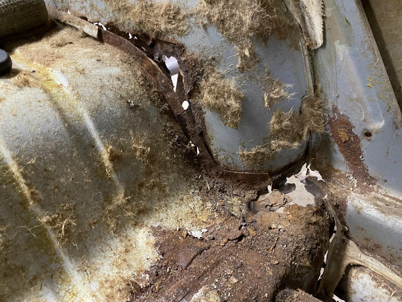

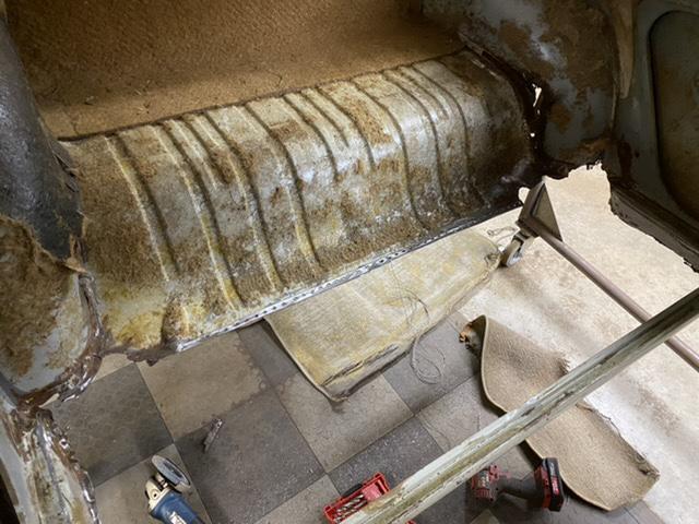

Now on to the body. Bottom 5+ inches of this car are screwed. Very likely bit off more than I can chew here. Channels are bad as well as some of the connecting tissue. Tentative plan is to mount the replacement channels to the pan as well as the rear crossmembers and then lower the body over it, picking up the beam mount and rear shock tower mounts to locate the body.
Body was braced and I left doors on
channels are toast as rear crossmembers and part of the front bulkhead.
Managed to cut all the rotted parts off today and will get back to it next weekend and grind off all the remaining rust. That should give me a pretty good sense of what panels I'll need to order. What could possibly go wrong?

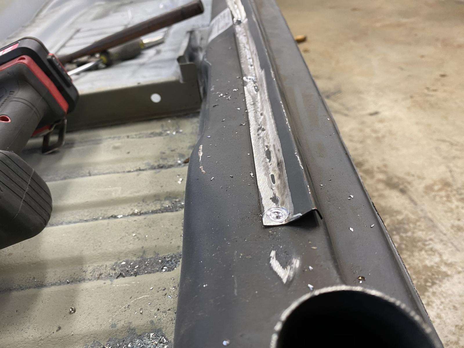

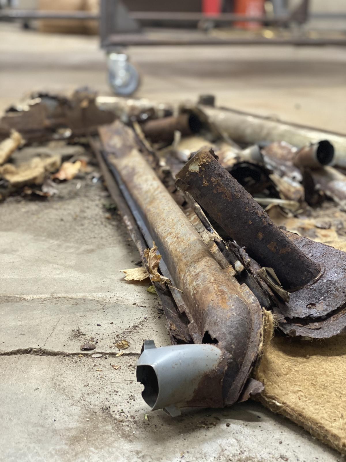

Spent the morning prepping the Dansk heater channels. Typical of these things, fit is sketchy. They hit the seat mount and often have incorrect threshold plates. Mine did both.
Ground back the inside seam to clear the seat mount, drilled out spot welds on the driver side threshold plate and removed it (oddly, passenger was correct) and chased all the threads with a tap.
Correct threshold clip (opens to inside of the car)
Wrong shape and facing wrong way
Channels fought a bit, but finally got them to lined up. Rear cross member and front cross panel are on the way and once I have them sorted, I should be able to drop the body on the car and start welding. Likely going to need bottom of front door pillars as well as complete rear wheel house and front lower wheel house pieces. When all is said and done, I should roll in at about $700 in steel and a number of hours that I'd rather not tally.

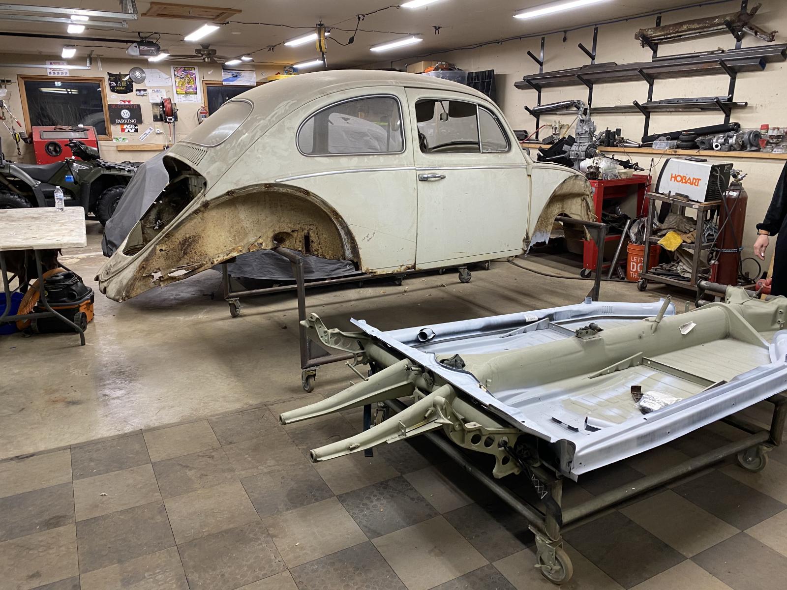

PostPosted: Sat Nov 14, 2020 5:18 pm    Post subject: Re: 1961 Bug Rescue and Patina Build - Pic heavy Reply with quote

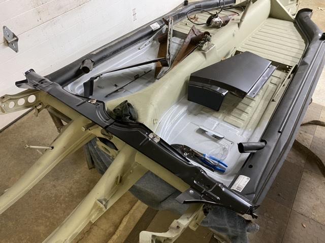

More prep for mating the body to the channels. If everything goes as planned that should happen this month.
Channels and Crossmembers loosely bolted in and mated to eachother.
Cleanup up the package tray and what's left of the quarter panels. New Crossmembers should mate nicely, but there's barely any quarter panel left to mate to.
Once body is laid on channels I'll graft in quarters and tie it all together. The missing material on the inside may be bought panels or just some sheet made to fit. We'll see after they are together.

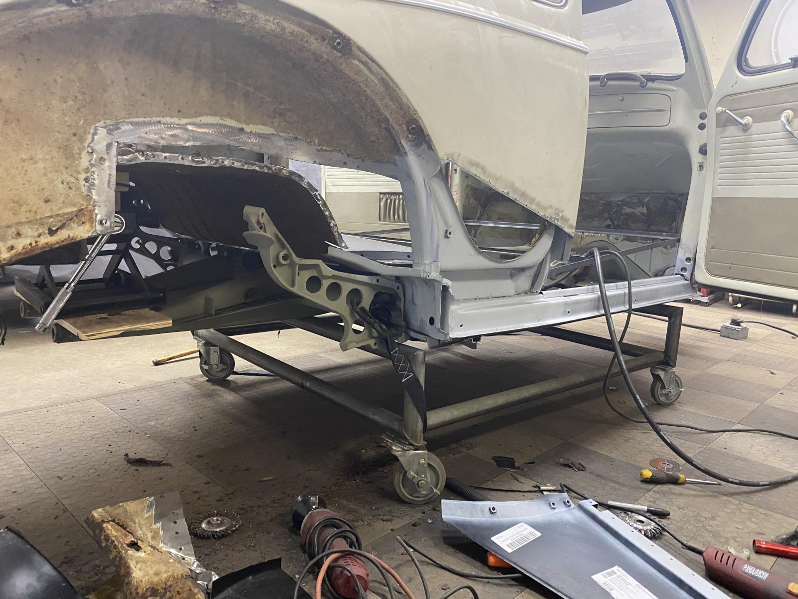

Some more updates on the dirty 61. Ground down and fitted the new heater channels and cross members. As anticipated, this stuff needs a fair amount of prep to fit and be weldable. Bolted beam back on the pan to use it as a guideline for aligning the body (front body mounts are one of the few parts that are stable on this car). Also trimmed out the nose for the single bag.
Body dropped on without much of a fight, but rear mounts are not stable enough to support it. The result is rear slid over channels to far, putting doors on top of channel/jams. Next move is to jack up rear of the car to get it into position and replace the wheelhouses. Front aligned well and clearly shows where metal will need to be added.

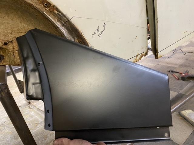

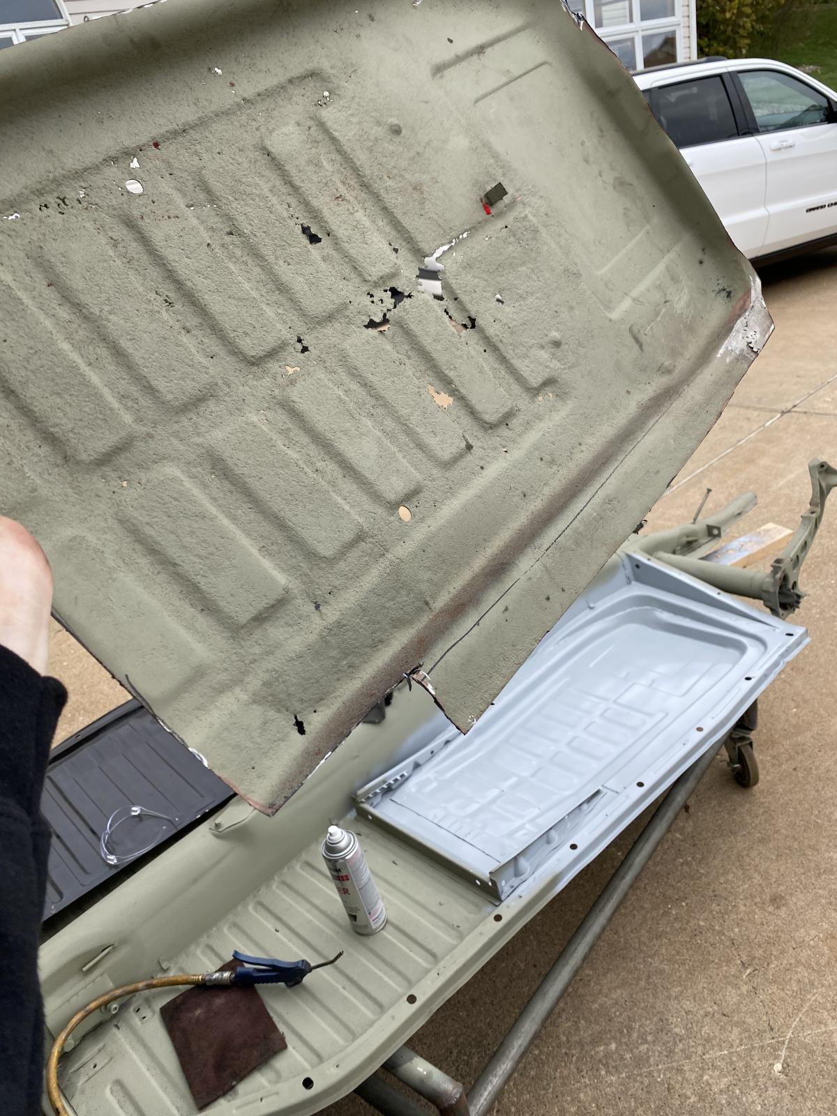

Tackling rust repair this week. As I get deeper into this it often occurs to be not to ever buy a rusty car again!
Rear quarter panel and wheelhouse on both sides were destroyed. Took an entire afternoon to align the body on the new channels and crossmembers without the guidance of the rear body mounts. Less than fun.
Wheelhouse required some tweaking, but went in OK. Not too concerned about aesthetics and more about strength, I layered it on some existing metal and rosette welded as well a bead on the perimeter. The quarter panel was another story. It was lipped across the top seemingly with the intent of allowing the material to overlap the existing metal and remain aligned. It do not.
Way too much filler to make this blend. I feel like I may regret this later. Wheelwells will get a raptor liner which should hide any ugliness.

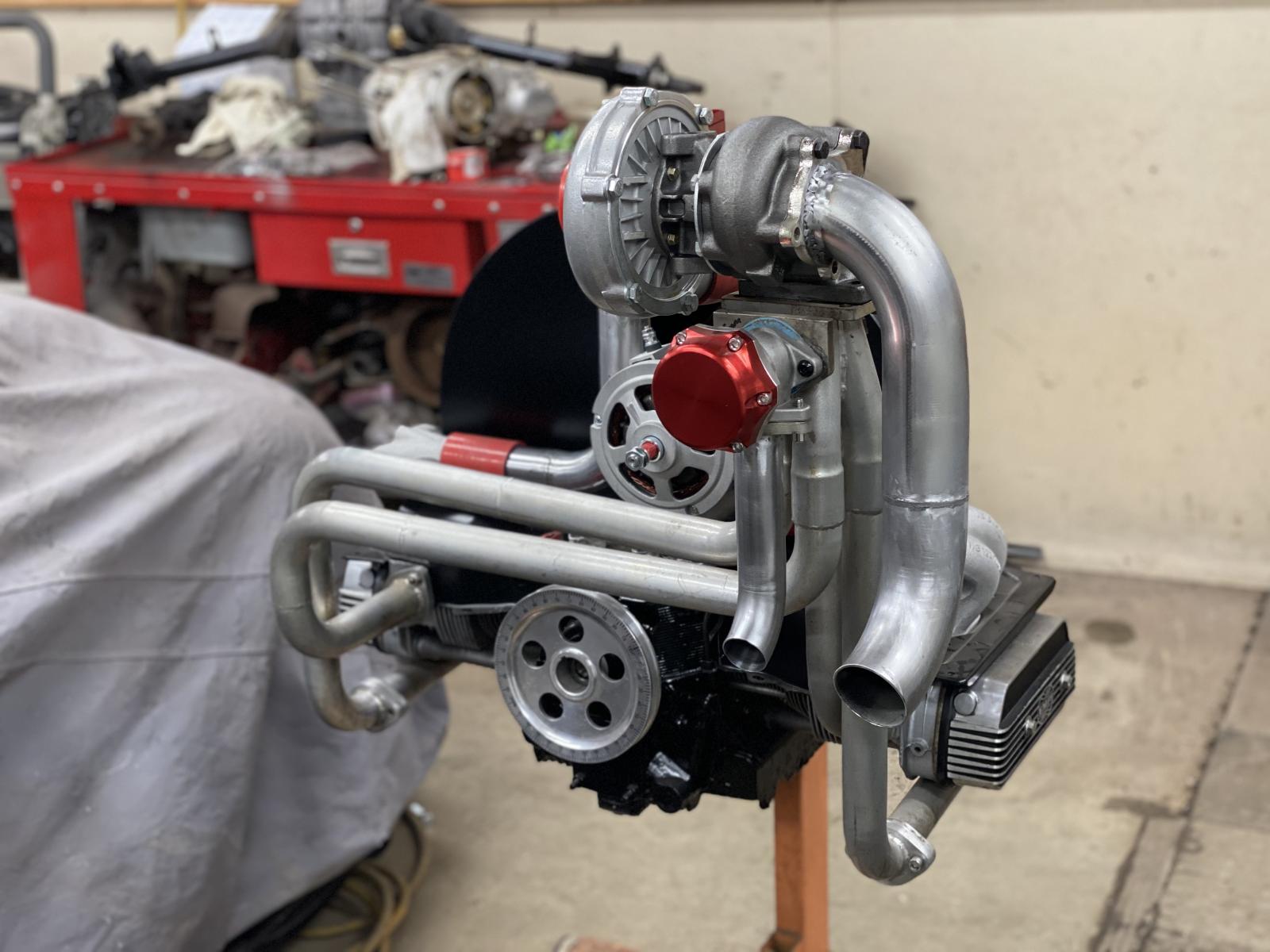

Now onto the turbo build. No idea what I'm doing, but really stoked on the process. Grabbed a crazy header from a buggy guy on Facebook and went to town.
First up was the intake manifold. Original piece was designed for a center mount alternator, so I cut one side off and added 3.5" to the other to re-center it. Couple of bends and it tied in nicely with turbo
Exhaust and wastegate dumps came out good, although it looks like exhaust side is a few degrees off. May have to cut and re-index it.
Now on to vacuum and oil lines!

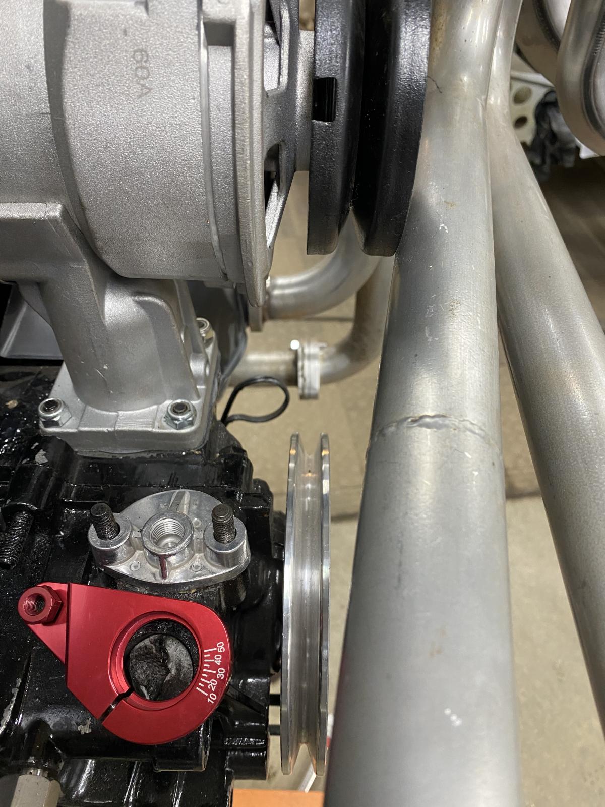

Exhaust and intake coming together. Oil lines will be challenging. Always hated the Rube Goldberg look of oil/fuel/breather lines crisscrossing the engine.
Boost gauge port and feed line guide tabs welded to manifold. That should wrap up that piece and will go to powdercoat after test run.

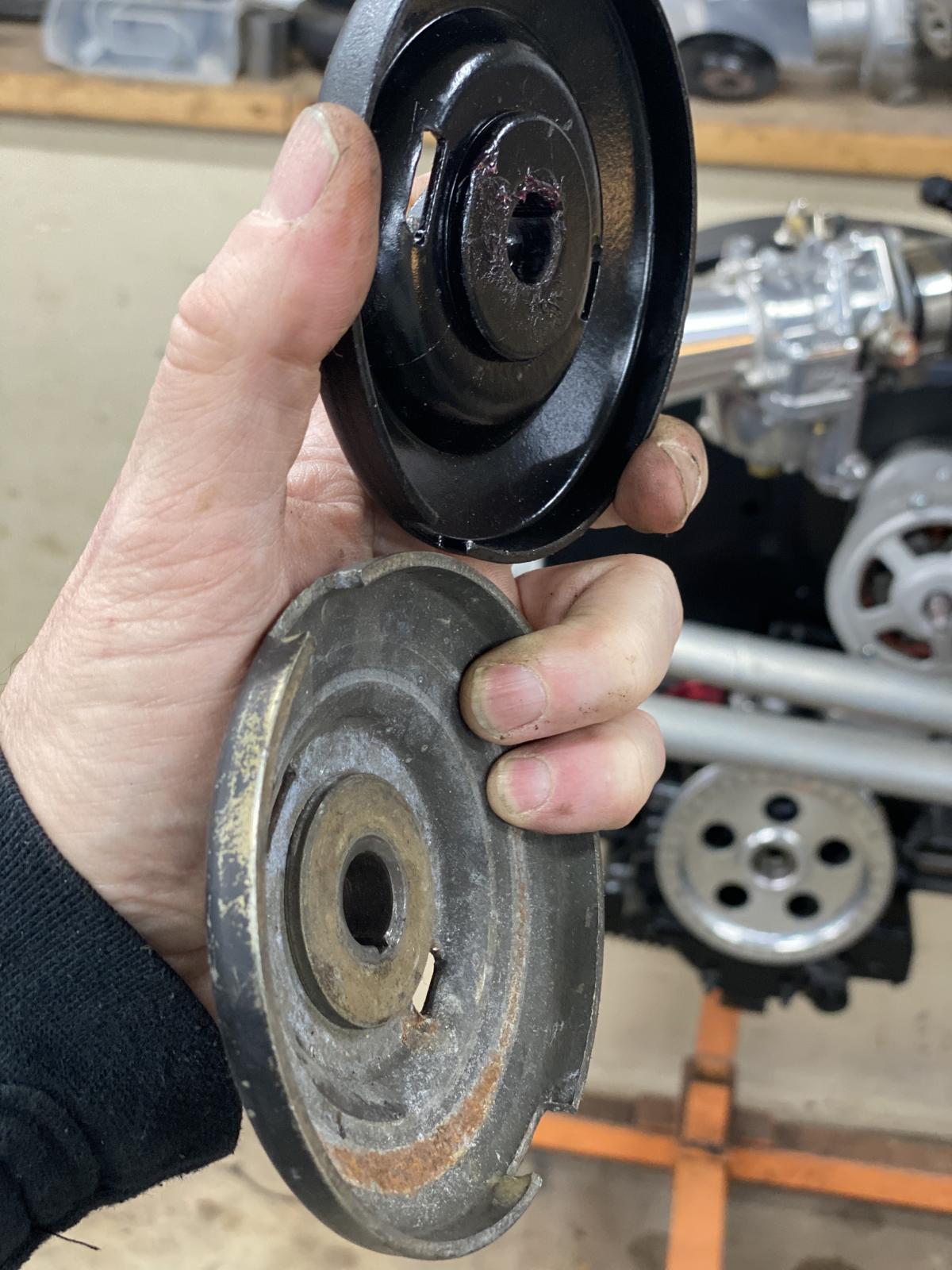

First mockup of tin/alternator revealed a massive misalignment of the pulleys
Only to realize I had used the wrong year pulley. Finally an upside of having a ton of parts laying around.

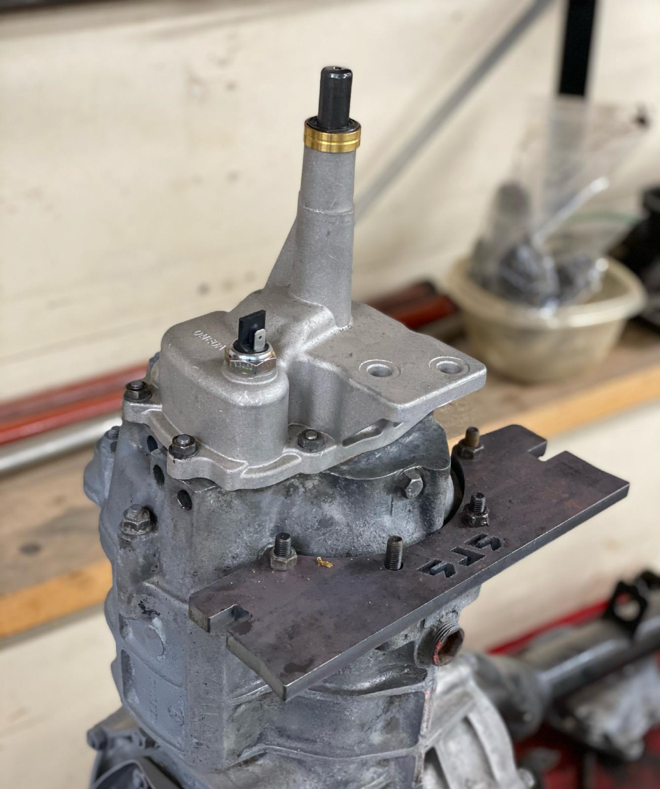

Trans now has bus nose cone and is mocked up with RLR 1" raise. Plate seems a bit gappy, so we reached out to Russ for some guidance.

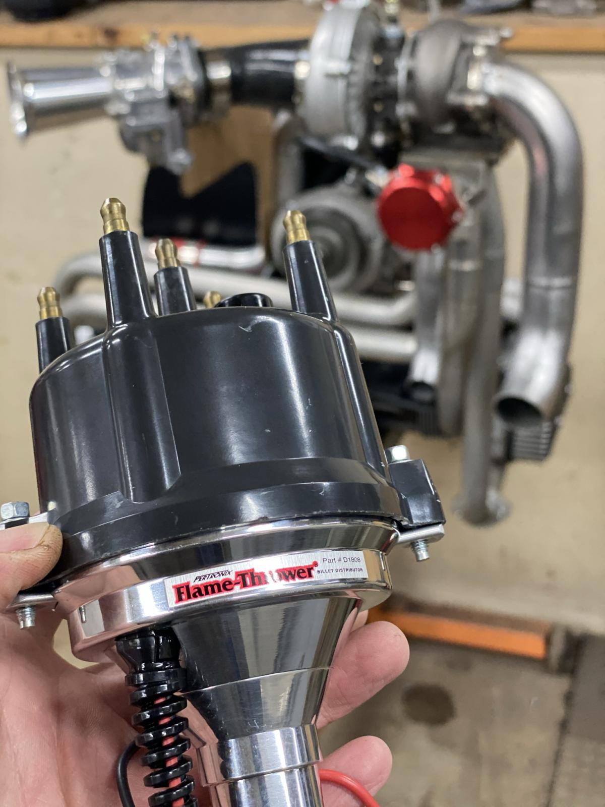

Pertronix dizzy showed up and and is now recurved and advance limited to 20 degrees.

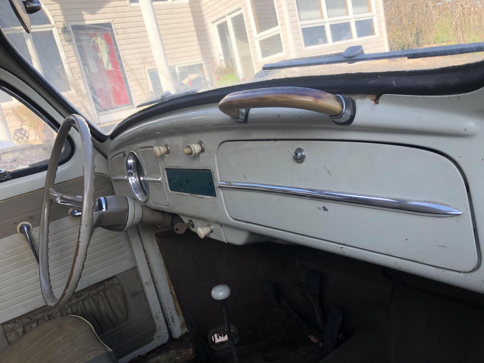

Interior isn't bad. Looks to be original door panels, seats, dash, etc. Didn't notice at first, but no fuel gauge!
looks like the original sand stone column and steering wheel are still in there, possibly the E brake handle and shifter too. you gonna preserve that stuff? 61's are very cool cars with the offset interior colors. that is also more scarce than the hydrate green stuff.

Entire interior will remain intact.

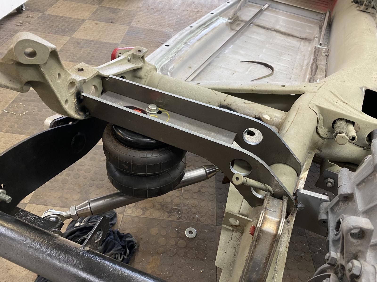

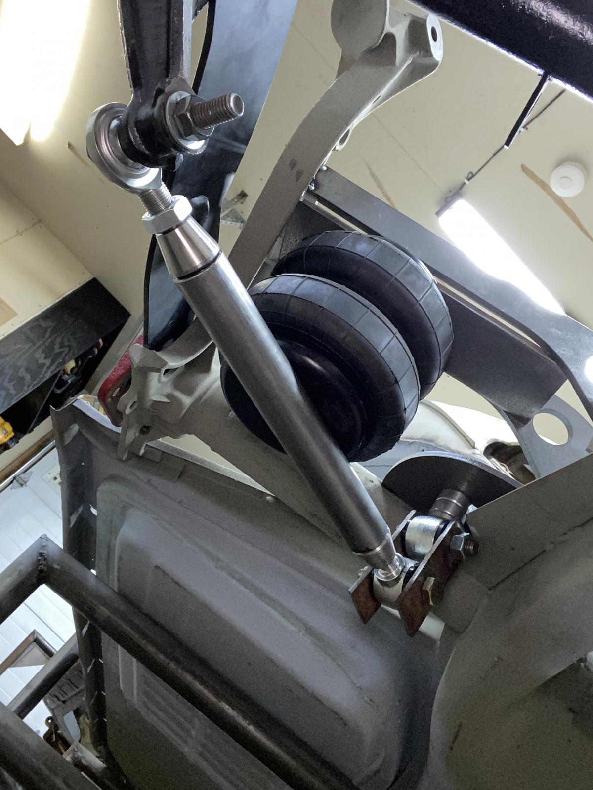

Got a wild butt hair and decided to bag the rear end (I'm never going to finish this car!).
Looked at everyone else's stuff and in a moment of grandiose confidence in my design/build skills went for it. Using paper templates, I mocked up the support plates and then drew them in Corel Draw and sent to laser. Used 1/4" steel for all the pieces. The rod ends are Amazon items.
The shackle is just scrap metal as I have not decided on length. Also need to design a seat for the bag.
Pretty happy with the results so far. Everything is squared to the pan and for the most part allows cables and brake lines to live happily (rear brake split will get a minor relo)
