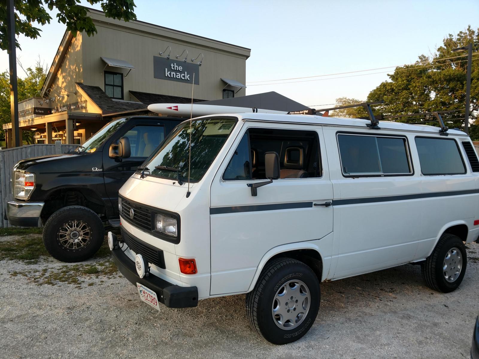

Hello Prerunner Professionals! I have a 2wd Prerunner related question, and thought I post it on this thread.
Here's my current suspension setup on my 1986 Tin Top 2wd Van:
- GW front and rear zero lift springs
- About 1 inch of leveling disks in rear
- Bilstein HD Shocks
- Front Ball joint spacers
- T3 Front Swaybar with HD End Links
- Healthy suspension with mostly polyurethane bushings
- Van sits about 17.75 inches, center wheel to fender arch lip
- 215/75/R15
As much fun as it is riding around at this height, I realistically spend most of my time on pavement and highways. Half the time I am on the highway I experience crosswinds 20mph+, and despite my badass suspension, I still get blown around a bit which is thankfully more annoying than dangerous right now. I've decided to stiffen up the suspension by swapping my GW springs for Schwenk 2wd springs.
Here is my question: I expect the Schwenk springs to lower my van. The description of these springs claim I will not need any ball joint spacers in the front. For people running similar suspension setups, is this the case? Were you able to achieve good suspension alignment without the spacers? If I removed the ball joint spacers when installing the new springs, should I have the van re-aligned?
Thanks!!

I have an Epytec big brake kit on my van so have to go 16”.
I’ve always thought 215/70/16 was the biggest that can be fitted on a lifted van.
Sure I have seen 225/75/16 fitted on thesamba somewhere. 🤔 anyone advise me on what size I can go on a lifted van? Would like 215/75/16 if possible.
Thanks 🙏🏻

PostPosted: Mon Jun 26, 2023 9:50 am    Post subject: Re: Prerunner vans Reply with quote
Hello everyone!
I just bought a 1987 T3 Multivan.
There it is very low and I want to raise it!
I have read almost everything and I take away this:
-Do not exceed 18" from hub to fender edge.
I want to fit 205/80R16 tires (We have them in France Wink )(radar/renegade-a-t-5/205-80-r16-104t)
The question I don't know how to answer is: what ET on 16" rims so that the tire doesn't rub?
Anyone have the answer?
THANKS!

The wheels from campervan culture have the correct ET and weight rating. They sell a 15x6 and 16x6. They are ET30
https://campervanculture.com/?s=VW+T25+T3+Vanagon+...1&fs=1
