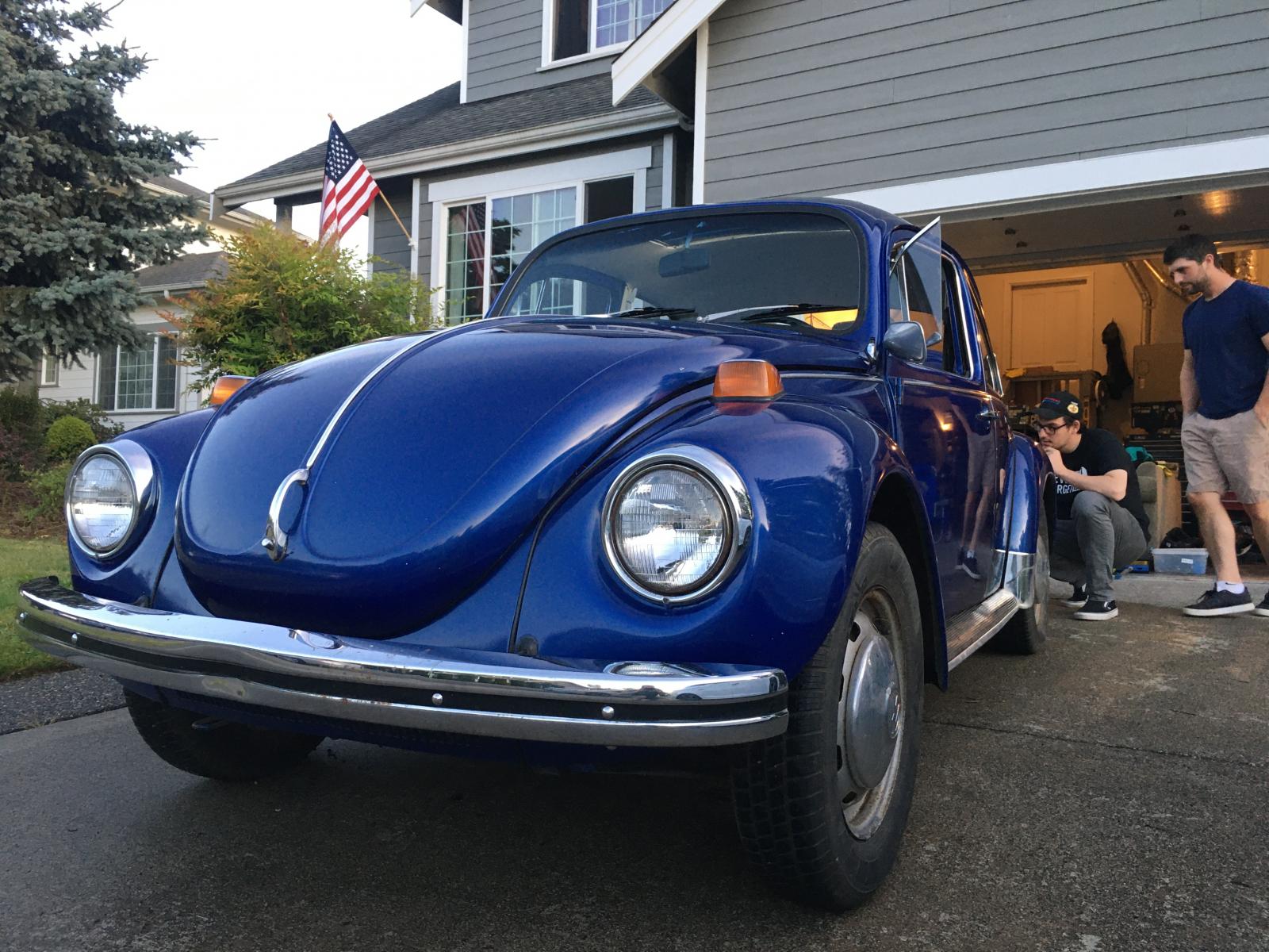

PostPosted: Tue Jun 30, 2020 12:00 pm    Post subject: Our "New" '72 Super Sunroof Reply with quote
My partner and I just bought a 1972 Super Beetle, and wanted to share.
"Leo" was well-loved in the 1990s: painted, engine/trans rebuilt, etc.
After being rebuilt by the seller's mom, she left the car to her son, and didn't leave the garage again for 15 years.
Everything works!
This is my first aircooled vw, while my partner has had 2 71/72 supers and a square.
For both of us, this is the most complete older car we've ever purchased.
Not sure how to upload videos yet, but the first start was pretty exciting!

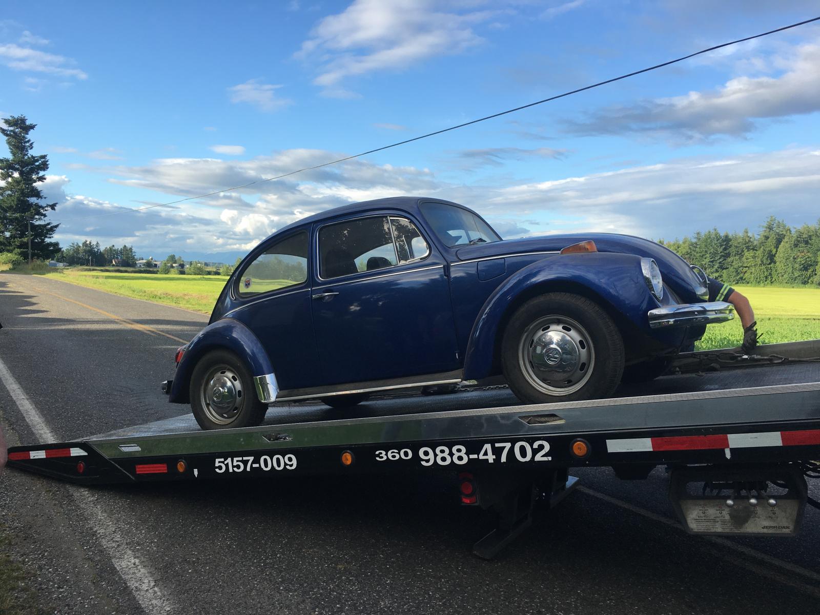

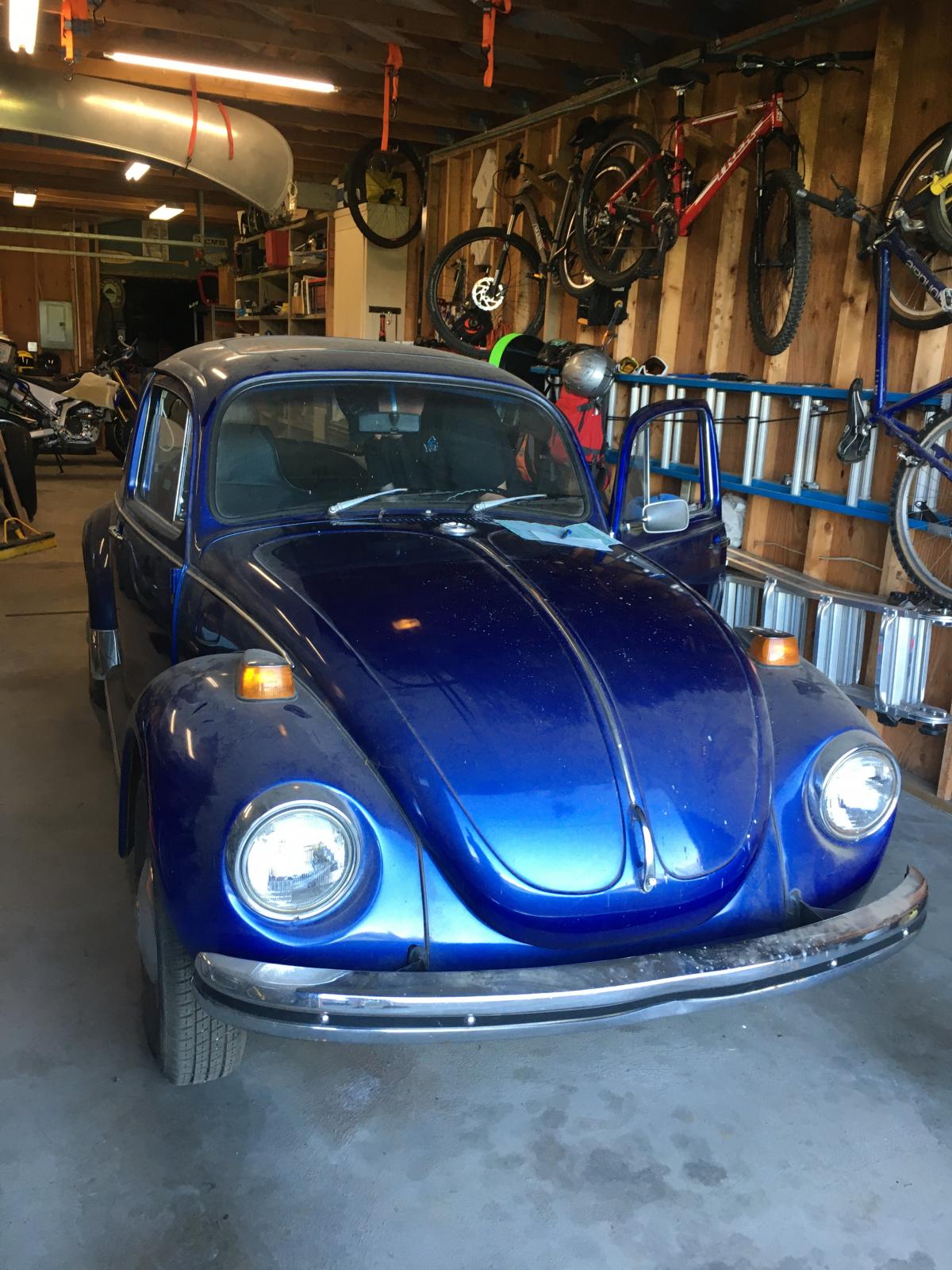

Here are some pics after it was uncovered and going onto a flatbed to a friends house to "shakedown" before driving to Seattle.
Very excited to say, after replacing the 2 soft lines and fuel pump, and adjusting both passenger-side drums, Leo made it 100 miles home!
Keeping the speed limit on the interstate, and holding the corners on our backroads too.
Not bad for 15 years parked -- certainly exceeded our expectations.
In the last 10 minutes of the drive, the passenger side ball joint and tie rod started to give up, but made it home with no incident.
Replaced ball joint and tie rod, and then drove it to Olympia and back with absolutely no issues.
Little gassy, but otherwise no complaints.
Wish I'd had a Beetle sooner!

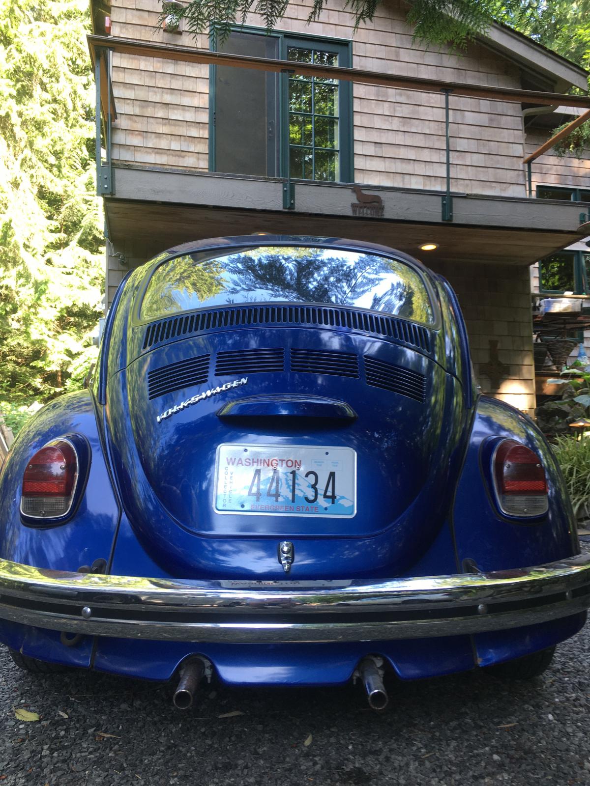

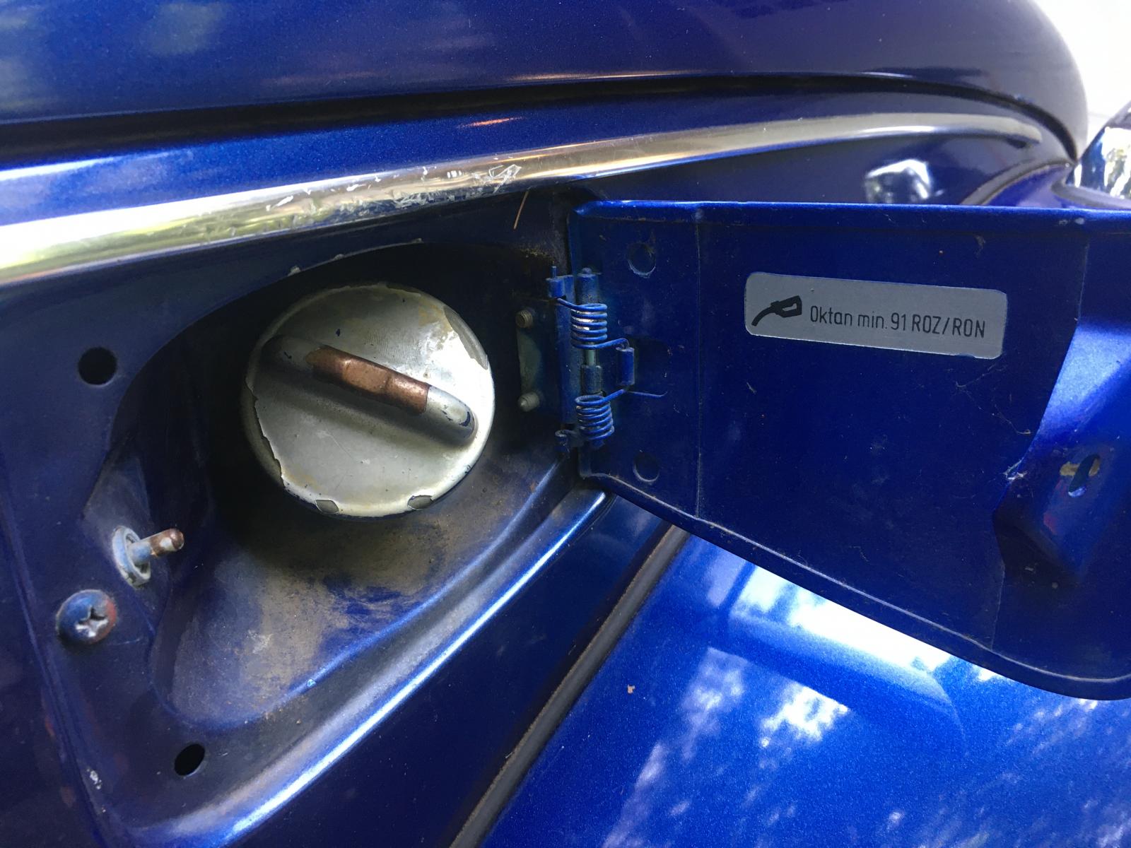

PostPosted: Tue Jun 30, 2020 12:09 pm    Post subject: Re: Our "New" '72 Super Sunroof - More Exterior (Walk Around) Reply with quote

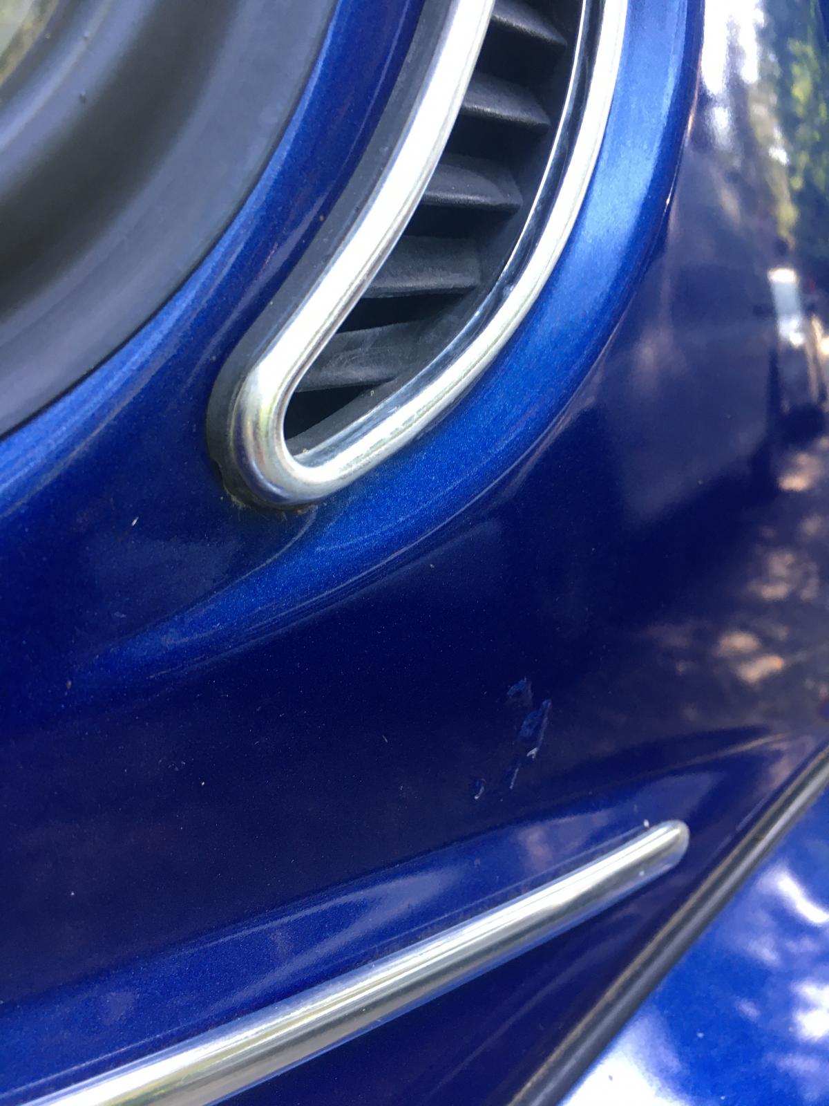

Here are some better photos of the outside.
I've included some trouble areas to document where we are starting out.
Was originally Marina Blue, not sure what color it is now, but it is blue in the light, and almost purple in shade.

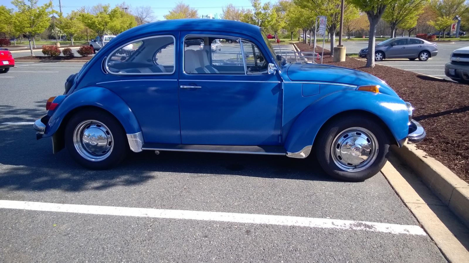

PostPosted: Tue Jun 30, 2020 2:22 pm    Post subject: Re: Our "New" '72 Super Sunroof Reply with quote

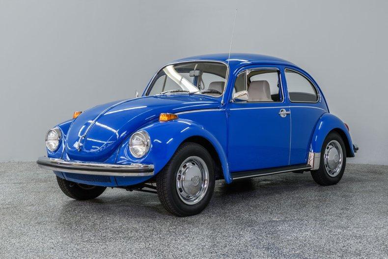

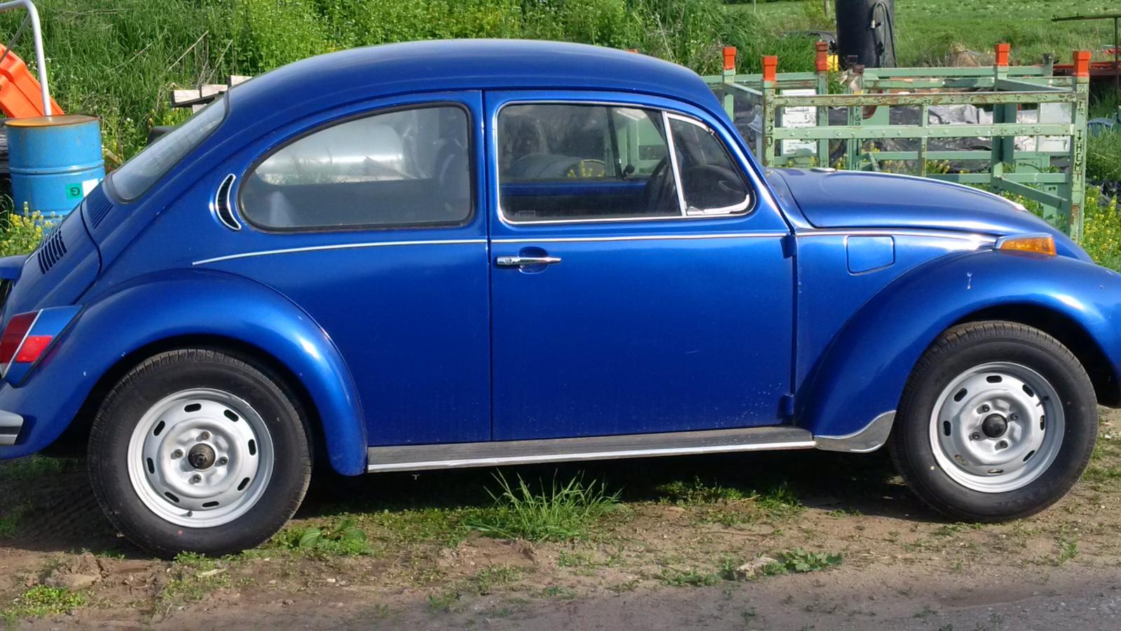

Congrats! Beautiful blue. I don't think it's enzian blue, though, too dark. My '72 Super was enzian blue.

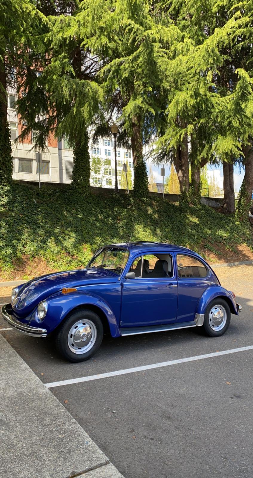

PostPosted: Sun May 23, 2021 1:02 pm    Post subject: Re: Our "New" '72 Super Sunroof Reply with quote

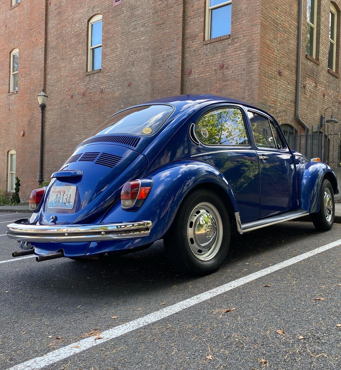

Been about a year since we brought “Leo” home
Since then, we’ve:
-Rebuilt carb & all your favorite tube up goodies like valves, belt, etc
-rebuilt brakes and all new brake hoses
-new fuel hoses
-New bushings
-new tie rods & ball joints
-new steering dampener
-new sunroof seals, serviced drains & relubed
-window cranks
-shifter rod/linkage bushing
-repaired front carpet & new boot
-new fresh air fan switch
-repaired a slew of electrical oddities (25 amp fuses in every slot, lights randomly not working, etc)
-painted wheels
-probably more than is slipping my mind.
Still haven’t bought tires— (tires are 18 and it’s probably time), so that’s likely next.
Anyway, really loving bug life and wanted to come back and share some pics!.

PostPosted: Sun May 23, 2021 2:38 pm    Post subject: Re: Our "New" '72 Super Sunroof Reply with quote
Your dark shade of blue with the amber turn signal lenses, especially illuminated, is such a classy combination, I think.
It is looking great and I'm glad you posted an update.

PostPosted: Sun May 23, 2021 6:42 pm    Post subject: Re: Our "New" '72 Super Sunroof Reply with quote
The seemingly minor work of painting the wheels, and correctly in silver instead of any other color such as white, makes a big visual difference. Good going.

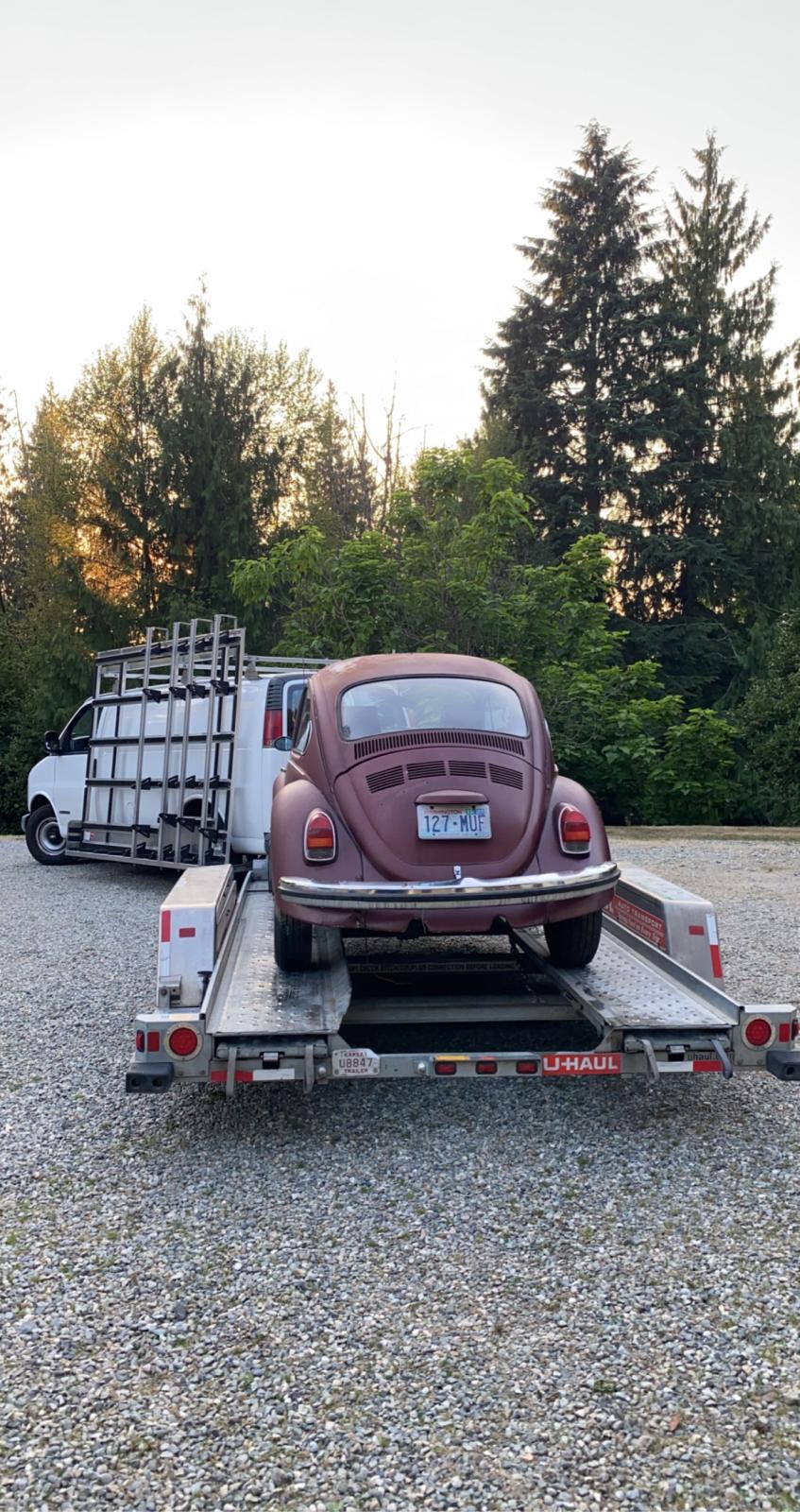

PostPosted: Sat Aug 28, 2021 3:28 am    Post subject: Re: Our "New" '72 Super Sunroof Reply with quote
Time for another update!
Can’t figure out the reply thing from mobile but wanted to say thank you for the kind words!
Re: the wheels, I’m definitely a fan of the “aluminum” Rustoleum professional, it worked great for our work van too.

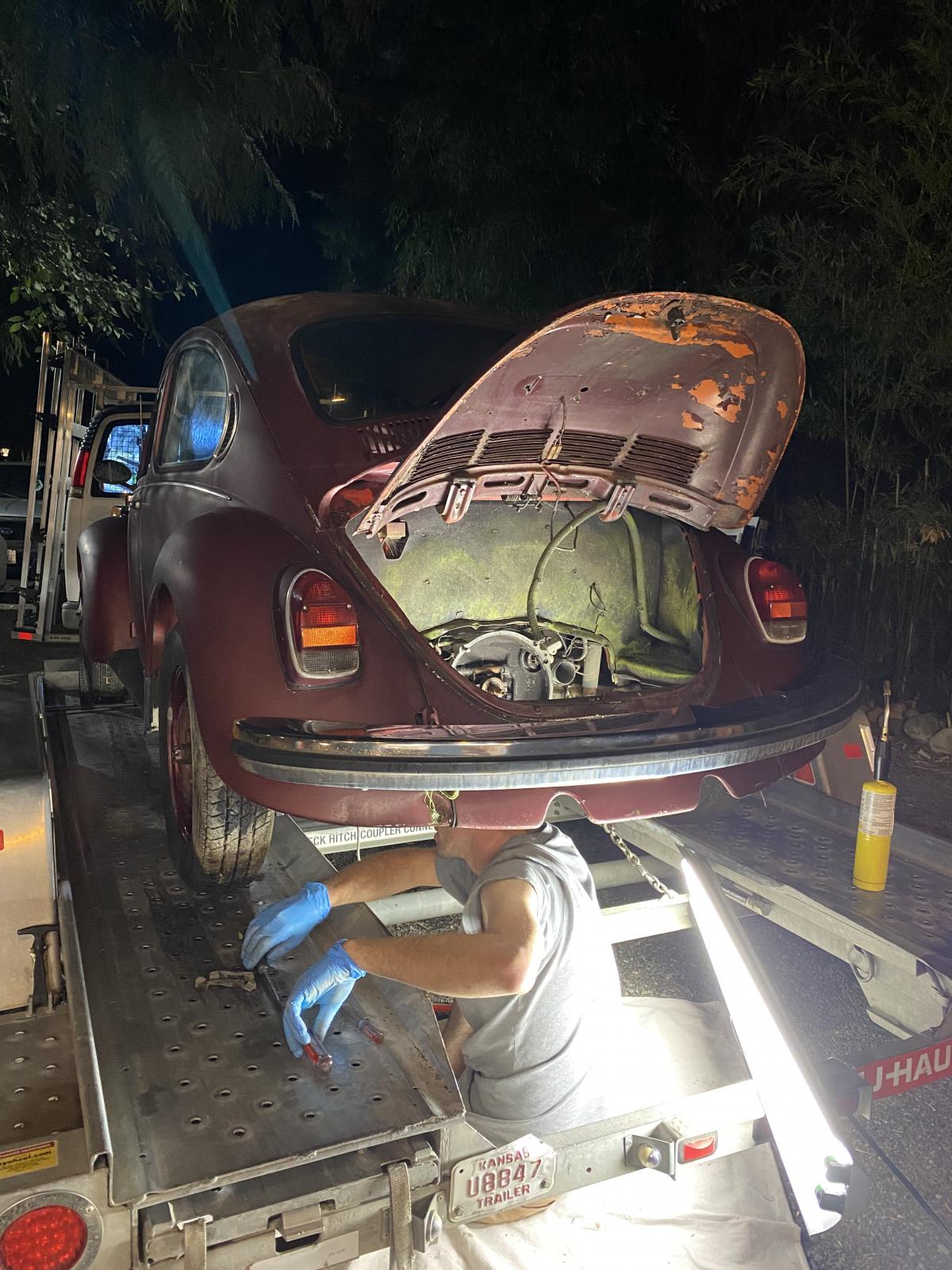

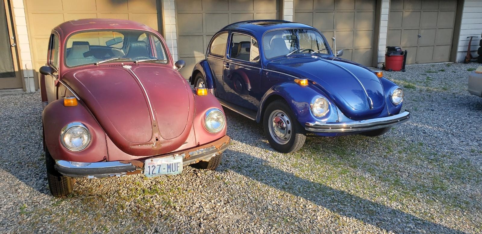

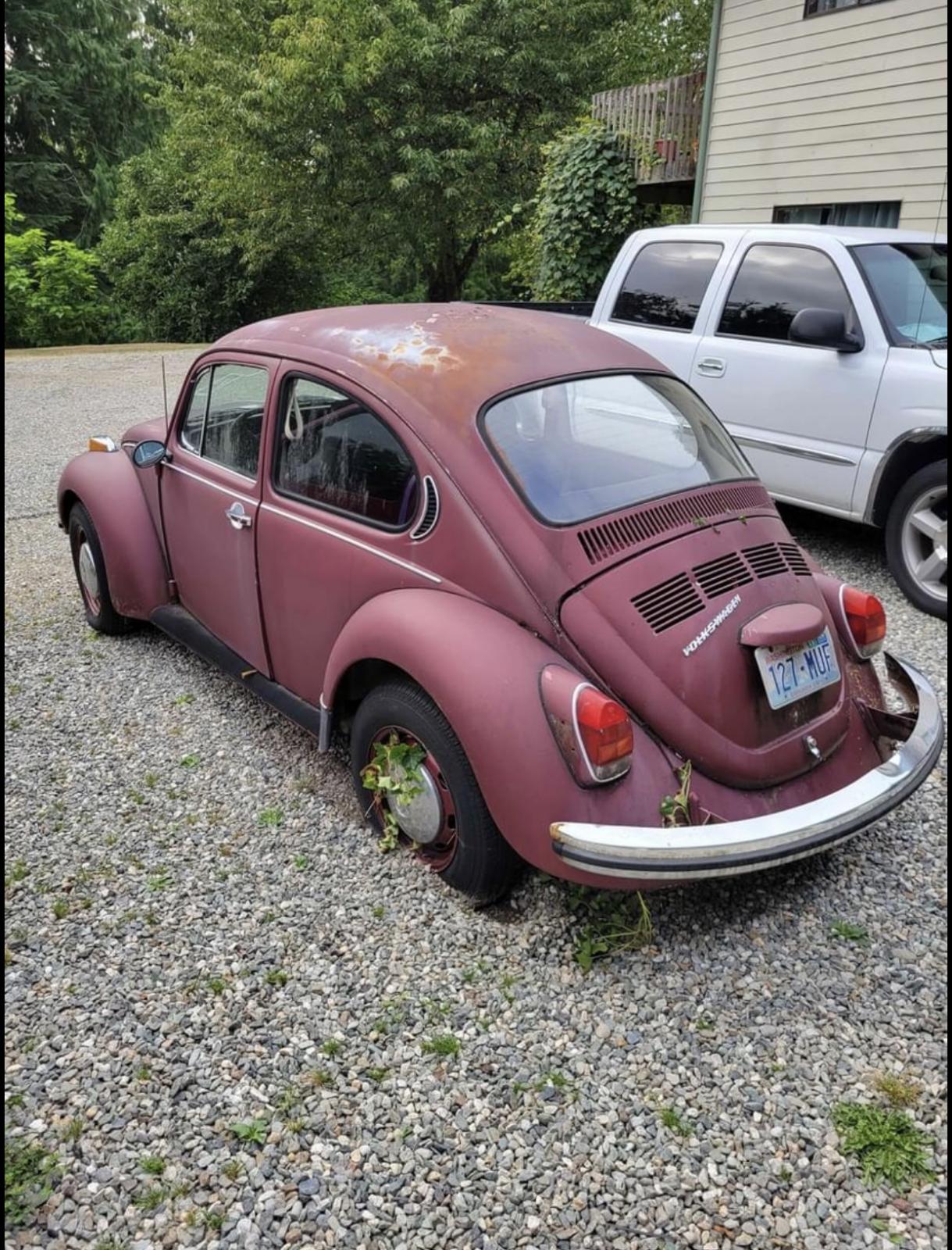

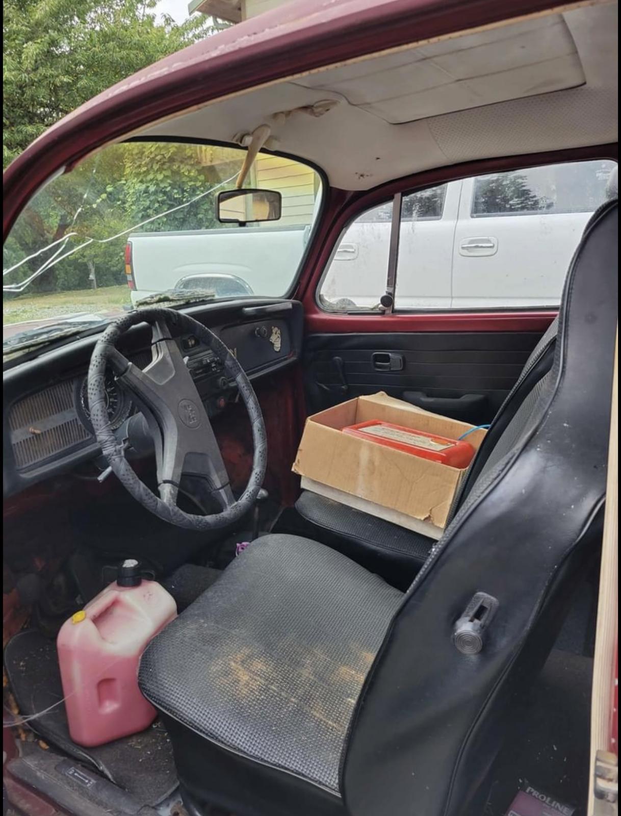

Picked up another 1972 1302S Sunroof— this one Kasian Red and cosmetically and mechanically rougher than Leo but structurally as good if not better. The original repaint seems quality but the most recent respray is… not excellent.
And this time— no engine. Transaxle looks good, no slop, shifter has a clear reverse and 4 gates so I’m optimistic!

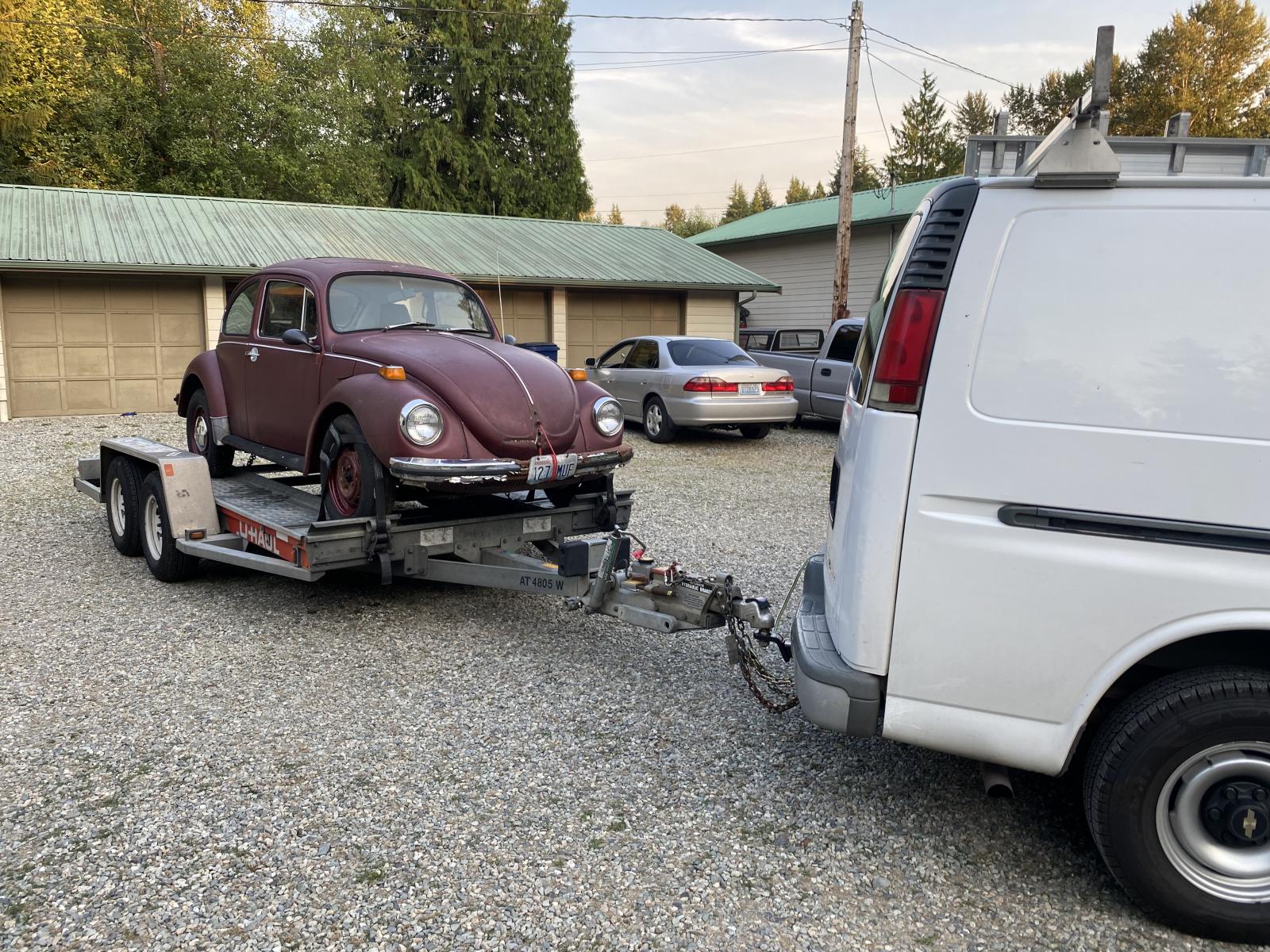

Taking the car home was more challenging with no motor— WD40 and a come along eventually got it onto the deck. The blue beetle rolled after backing off the brakes but THIS car has lived outside and was pretty well seized up. By the final PULL onto the trailer, we had 3 wheels moving but the front driver side was still putting up a fight.
After quick 1 hour tow home and we started troubleshooting the stuck wheels. We introduced penetrant to the brake adjusting screws and eventually were able to back all 4 off. The car came off the trailer EASY! (Note to self: next time 30 minutes with a jack & wd40 in the driveway before loading is A LOT easier than dragging a stubborn Beetle).

PostPosted: Sat Aug 28, 2021 6:46 am    Post subject: Re: Our "New" '72 Super Sunroof Reply with quote
Choosing a solid, unrusted Beetle for the next car will work out very well for you. Note that the red Super's wheels are more deep-dish than on your blue Super Leo. There was a transition midway thru the model year, with the red having the later wheels that are 4.5" wide and 34 mm offset. You can spot this visual difference easily by sighting along and across the outer edge of the rim and noting how deep the hubcap seating surface is in relation. There should also be "ET34" approx. 1/4" high stamped into one of the flat sections of the rim between any 2 of the lug bolt holes. ET stands for the German words for "press-in depth" Einpresstiefe. The wheels on Leo could be 4.5" or even 4.0" with a lesser offset (less "deep dish"), such as ET40.
A find like the red one would be just like what I'd look for "if" I were to consider another project. As it is I have 2 Beetle rolling shells that are solid and rust-repaired; I'm just too lazy to continue with them at the moment.
Glad to see two '72 that have correct, and matched taillamp height. My visual guideline is that the bottom of the taillamps are "hand-width" higher than the top of the bumper. Many times in photos or at VW meets I see '71 or '72 that have their taillamps lower than usual, indicating lower mounting holes in aftermarket fenders. "2-finger" higher than the bumper.
Red's outer mirrors look like Vitaloni Californias or clones, which were popular in the '70's and '80's. They don't look that effective because the mirror area should come up higher for a clear line of sight above the bottom of the window ledge. If you rotate the mirror and arm upwards at the mounting base, then it's a "tilted oval" which looks strange. Hopefully the original factory mirror hole is still in the driver's door so that you can easily fit a factory-style mirror. Or find a different style aftermarket mirror that has the mirror housing raised up on a post so that you don't have to look down as much to view the mirror glass. But such work is very low on your "to-do" list.
