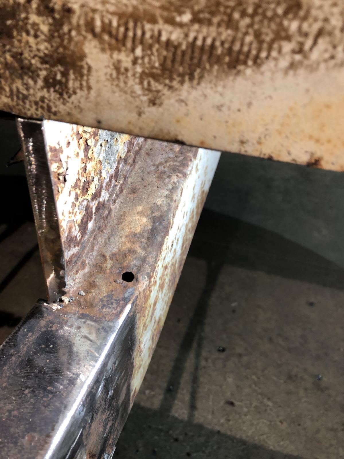

I made a little more progress today. I found a few holes in the frame by the right side forward outrigger, so I cleaned them up and welded them shut. I also cut back the walkthru bases where they connect to the top hat to prep for repair. I also cut back the bottom edge of the floor and replaced it. I welded the easy part. I’ll weld the underside once we put the bus on the rotisserie.

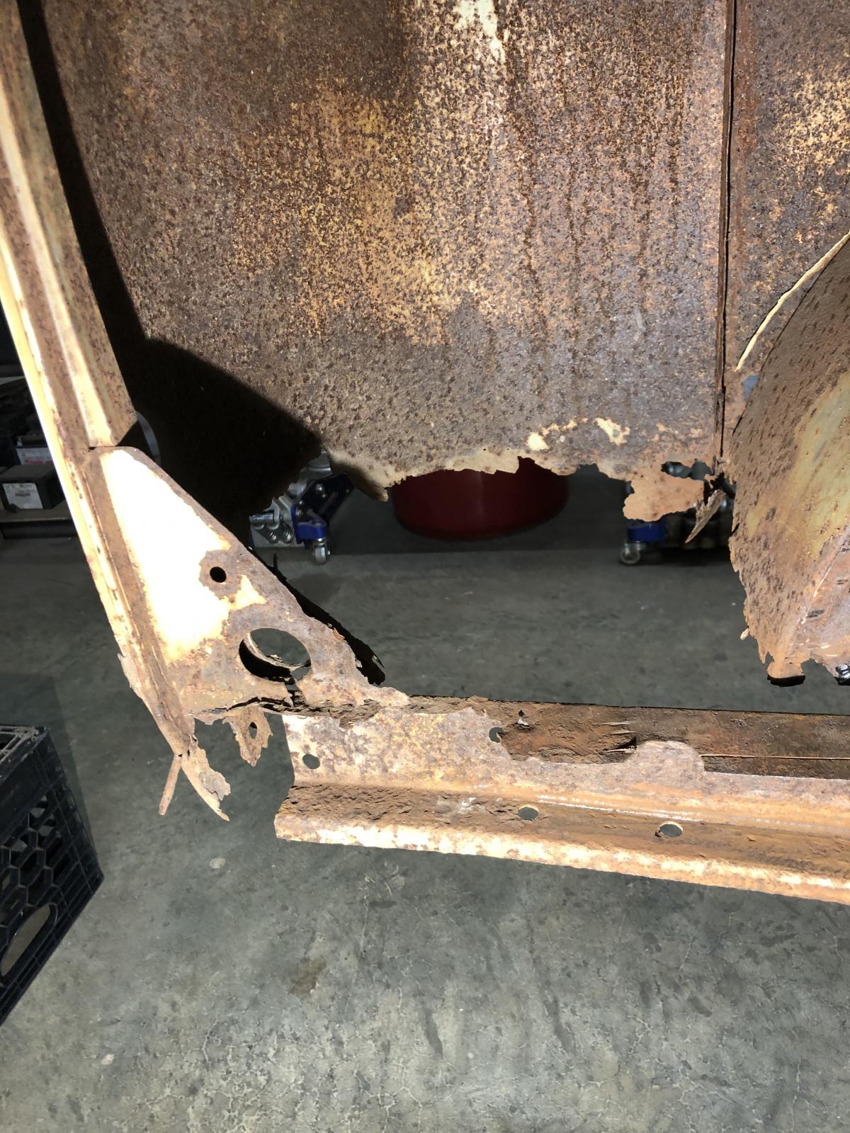

I decided to move to the back end for now. The rotisserie I am using bolts partially to where the rear apron bolts to, and this bus needs them repaired. I started by cleaning and degreasing. I staightened out the back edge of the tranny cradle, and started cutting back the rust:

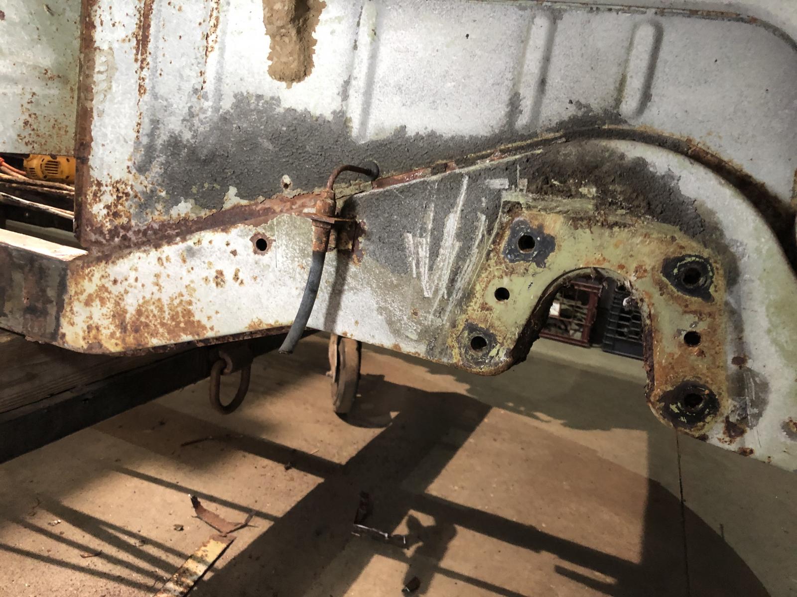

More engine bay prepping yesterday:
We are likely going to cut the frame ends back, and replace the D Pillar triangles. I did not want to cut them out until I had the replacement pieces ready to go back in.

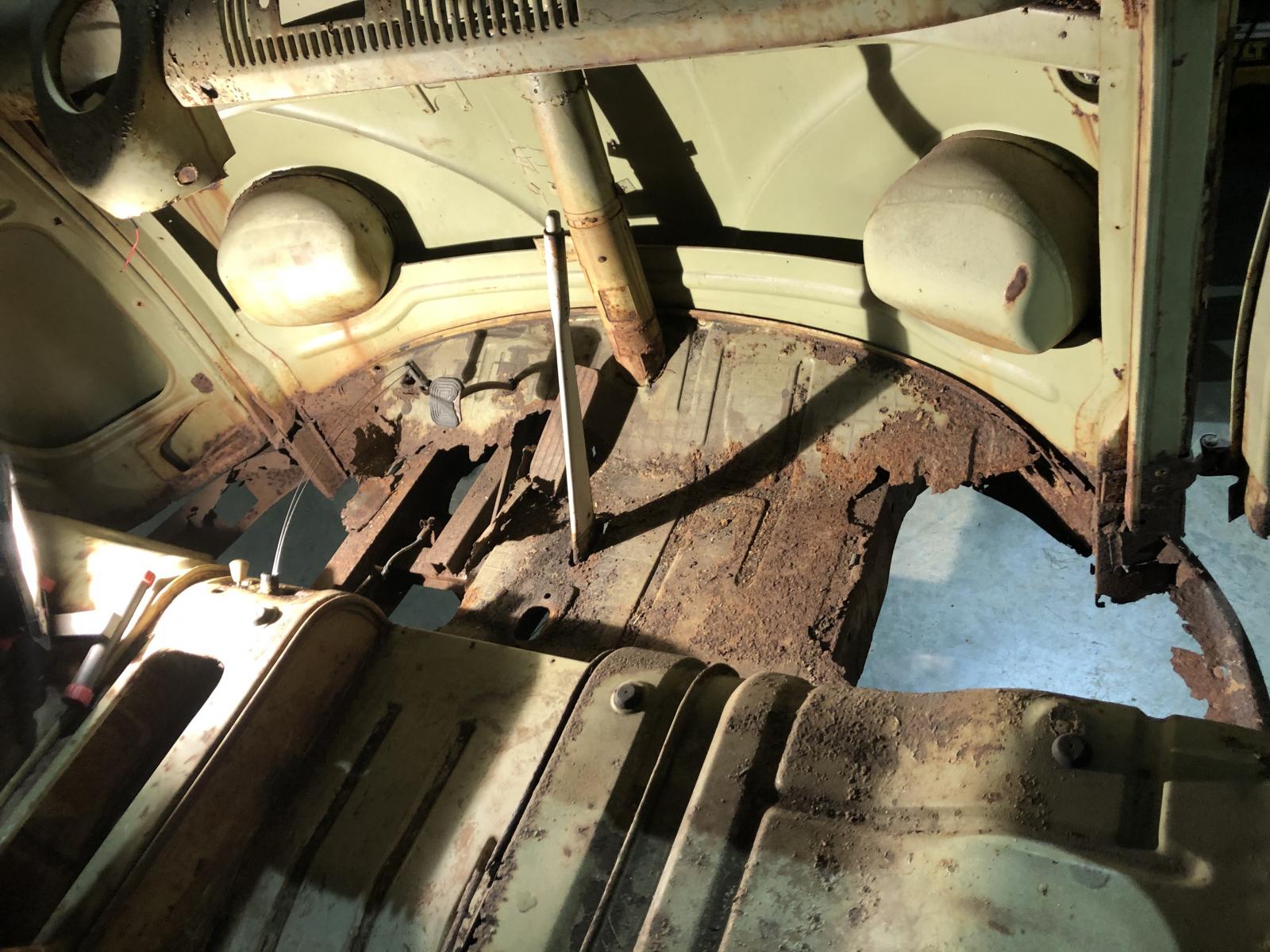

Today's carnage:
I am working on removing the E brake lever pin and E brake lever. Hopefully that will be out tomorrow.

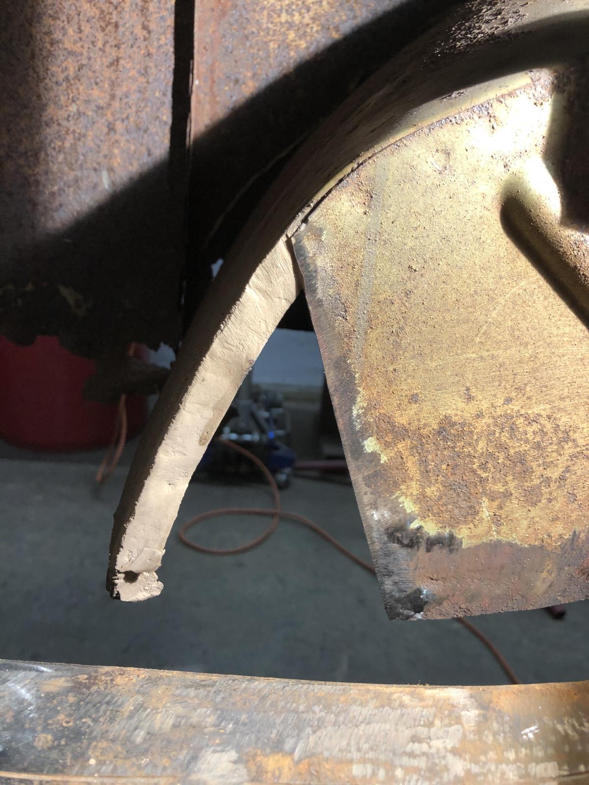

We made some more progress:
These frame ends are from Schofields, and they are nice!

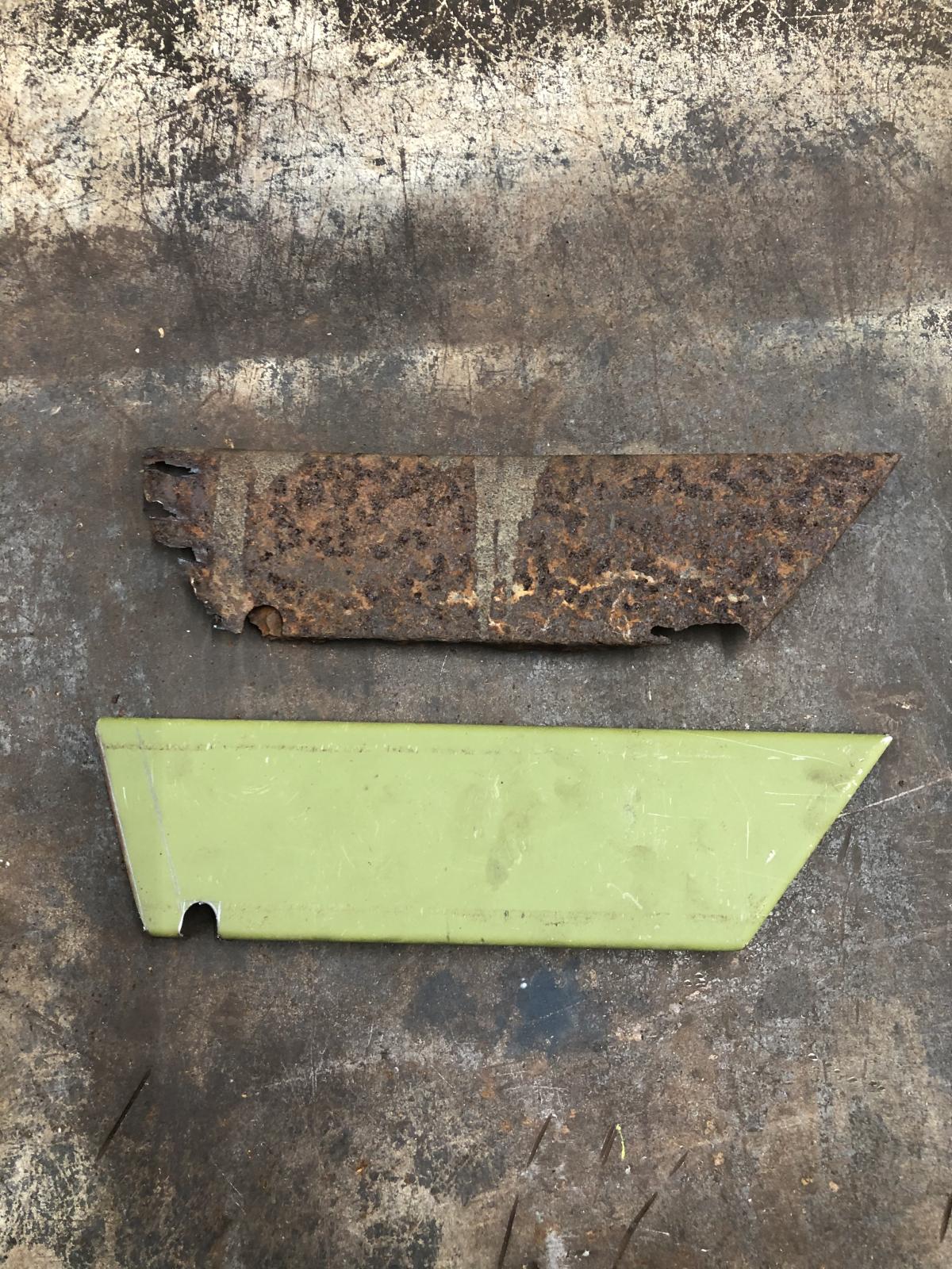

We made some more progress! The owner brought up a bunch of metal that he prepped:
It’s fun to have a big pile of metal to play with, but nothing beats having it arrive ready to install. Thanks Matt!
The left rear frame end is done. We also fixed a few other spots:
The D pillar will be going in shortly, as will the rear apron brackets.
