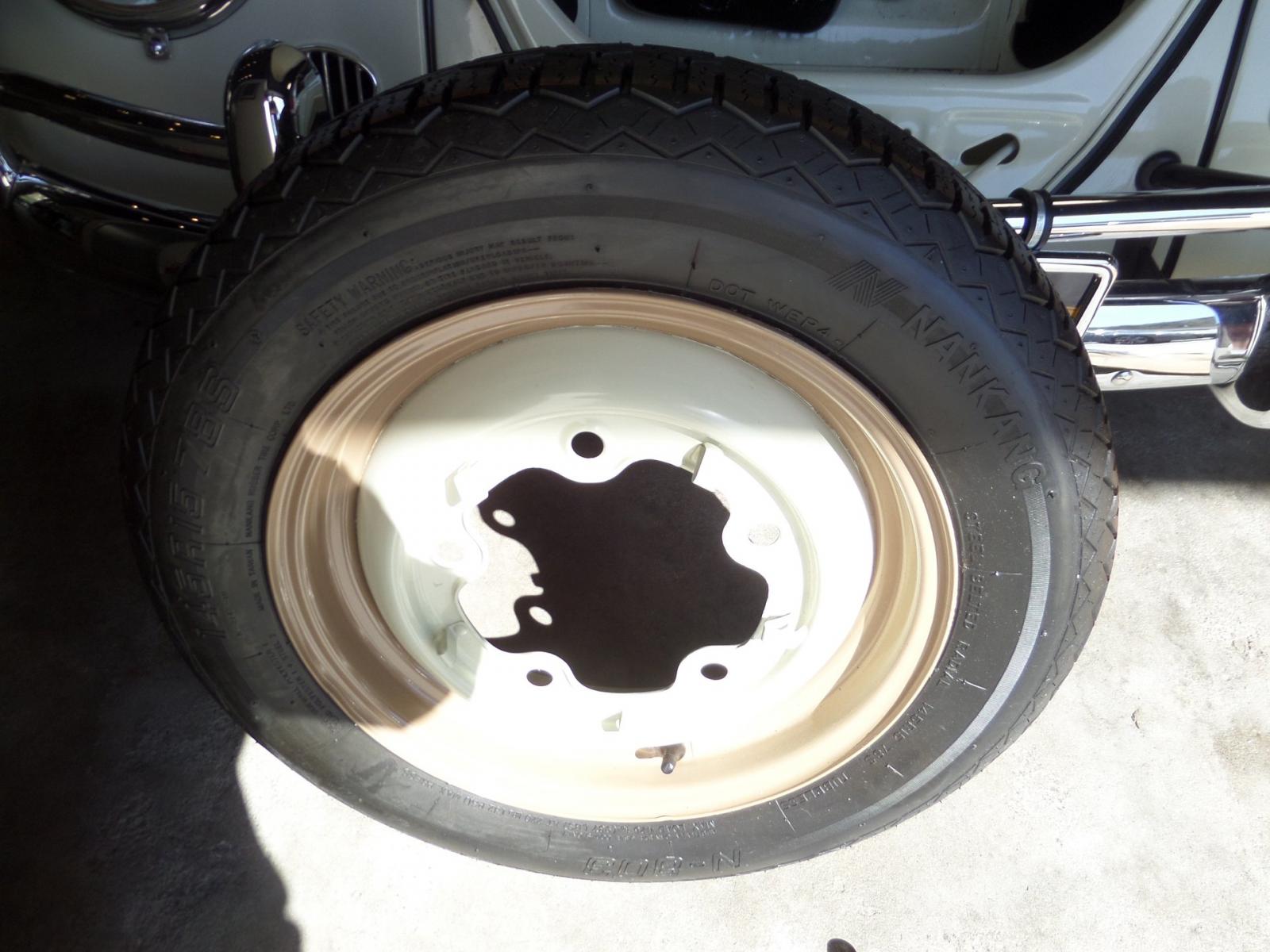

PostPosted: Sun Jul 19, 2020 6:57 pm    Post subject: Re: 61-64 convertible thread and registry Reply with quote
A black outer rim should be correct.
Another difference I recently learned about is that vert wheels were masked differently than sedan wheels. The center color extended out onto the rim, and the mask line was under the trim ring so that the center color shows on the rim inside of the trim ring, and black only shows outside of the trim ring.
As seen on this original paint wheel.
While we're on the subject of Cadmium Red vert wheels, this is a really nice example I came across on Facebook.

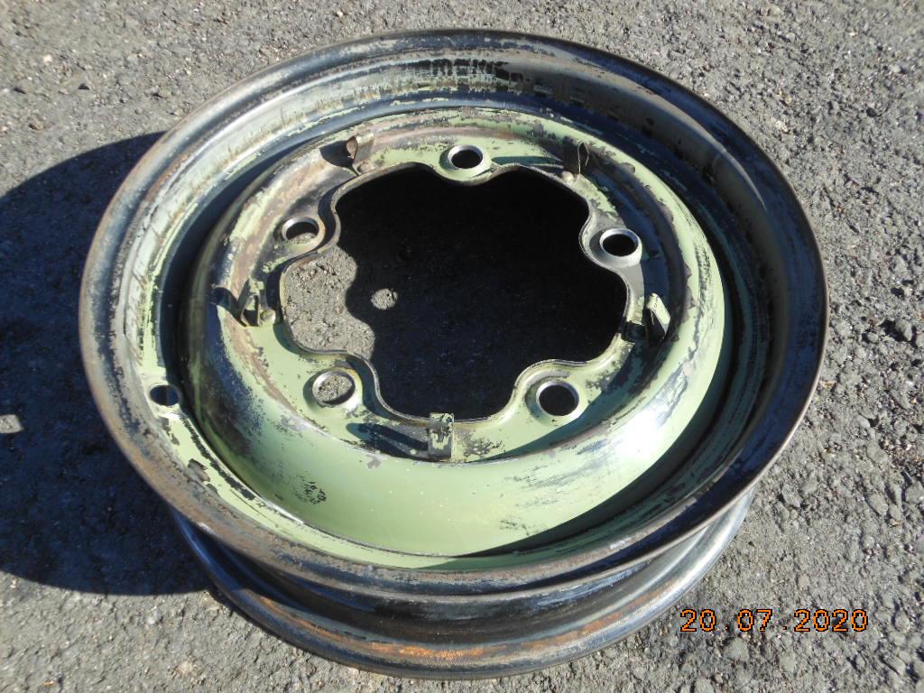

Who has dealership paint color binders, Berater, Parts Lists or best, KARMANN documentaion naming the Rim color?
Pics of the original color found on all four (spare MIA) 10/61 wheels:

1962 L 1009 Yukon Yellow Convertible
VIN 4 250 4xx, built Novermber, 1961
Body No. 911
Interestingly, and in confirmation of earlier Body Match Number posts;
page 4, 9th post, 3rd pic of this thread shows the red 1967 with Body No. 944.
Engine No. 6220897
Sold at Capitol Sales, Boise ID
Original Owner Mary Jane's (really, truly) personal conveyance from 16 January 1962 through April 2020.
She's a plain Jane, radio delete blockoff, no accessory piece of KARMANN.
Light green canvas top and boot
Very light green white seat vinyl
Very light green white and light green door panels
Light green shift lever and E-brake handle
Green floormats
Light green rim discs, black outer lips
Rims sometime later spray-bombed black all over, after the lips were sanded
Carpet has been very incorrectly replaced

hotchkiss_m201 wrote:
Just been following this thread and I'm surprised to find about the colours of the rims, always assumed they were the same as the sedans black/white. I've got a Poppy Red 1964 convertible, so would my rims have been Cadmium Red centers?
Sorry to say, after 63 they stopped with the accent colors and went black/ white on sedans and all black on convertibles. I believe they also used slotted chrome full wheel covers on the convertibles.

Thanks bugmandave, slightly gutted that they changed that on the 64 model year. One thing that's puzzled me about my 64 is the headliner, it's cloth and as far as I'm aware they'd already switched to vinyl?
It may have been optional, my 63 had cloth also but I've read that perforated vinyl was also used in 63.
