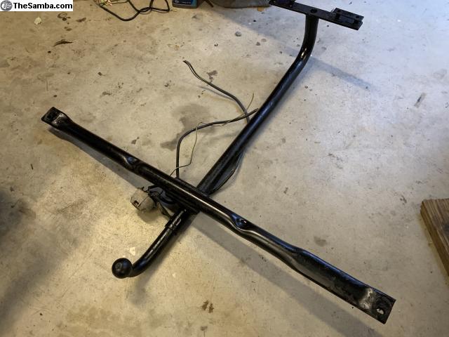

Anyone know anything about this 313-021 westy hitch? Will this fit a 78 bay? Looks like it may not work with the stock exhaust on the 78, but not so sure.
Will not fit to any VW or bay window.
This is made for Mercedes-Benz W108 (1965–1972) cars.
Westfalia hitch for bay windows are only:
08.1967 - 08.1971 --- 321 022 --- max 1200 kg (2650 lbs)
08.1971 - 07.1972 --- 321 067 --- max 1200 kg (2650 lbs)
08.1972 - 07.1976 --- 321 073 B --- max 1200 kg (2650 lbs)
??.1976 - ??.1976 --- 321 073 C --- max 1200 kg (2650 lbs)
08.1976 - 07.1979 --- 321 125 --- max 1800 kg (4000 lbs)
(detailed documents at my website https://www.vw-t2-bulli.de/de-books-documents-hitch.html)

rsbadura wrote:
Will not fit to any VW and bay window.
Regards,
ah-ha. this makes more sense. its in the bay window classifieds but I couldn't find any further documentation.

PostPosted: Tue Oct 13, 2020 9:46 am    Post subject: Re: THE Westfalia Tralier Hitch Thread (MANY pics!) Reply with quote
Hello
here are some pictures of my bus tow hitch
my 69 Clipper-L was equipped with strange rear brackets when I bought it... Think
many years later, I found this PEKA hitch that perfectly matches the brackets (even though it is stamped 71). Dancing

rsbadura wrote:

Now for the tougher question- does anyone know where I may locate a 321-125 to purchase?
I had to scour the German eBay for over a year to get the two I have. Pay someone to get them and ship them to the US. Not an easy task.
Or, you may get lucky and see one for sale here, look at the ad and think Think dayum, thats a lot for a old hitch. Then never see one again. Laughing
When and if you see a fellow VW lover that lives in Europe - befriend them. They are your best bet.
Lastly, pay to have one made. Or buy the one you already saw in the classifieds.

rsbadura wrote:
Here some pics of my original mounted Westfalia hitch Type 321 125 (8.1976-7.1979, up to 1800kg/4000lbs trailing load) before and after restoration (same hitch and same bus after 2 years of garage duty):

It was interesting to note Rolf-Stephan Badura’s observations about his Westfalia Type 321 125 towing hitch. I have one of these dating from 1978 in my garage, which I bought second-hand, more than 20 years ago, in the auto jumble section of the Essex VW Club Show, about 15 miles from my home in Essex, England. The trailer-towing hitch's identification plate reads:
WESTFALIA–WERKE–WIEDENBRÜCK
Bez.: Kupplungskugel mit Halterung
Typ: 321 125
Bauj.: 1978
Prüfz F3189
Zul. Ges. gew. des Kfz. kg 2500
Für kfz. gem. b. Anbauanwg. ; Stützl. Kuppelpkt. 50 kg
Gepr. für 1800 kg Anhängelast
At the time of purchase, my Westfalia Type 321 125 towing hitch had a 1974~79 VW Type 2 rear bumper (just three bumper-to-bracket square fixing holes per side, unlike the four on my 1973 VW Type 2 rear bumper!) attached to it, so I presumed it would be compatible with all 1973~79 model-years of VW Type 2 vehicles, including my British specification, right-hand-drive, 1973 model-year (manufactured during late-August or early-September 1972), VW 1600 Type 2 Westfalia Continental motor-caravan.
However, several months later, when I attempted a trial fitment of the Westfalia Type 321 125 towing hitch to the longitudinal chassis members of my 1973 VW "1600" Type 2, the fixing holes in the towing hitch did NOT properly align with the three pre-threaded holes in the underside of each the longitudinal chassis members, of which two are normally used for each of the rear-bumper attachment brackets. I also noted some other anomalies, regarding the separation distances between the fixing holes.
Having no reason to believe that my vehicle had at any time been involved in a rear-end collision of any kind, which might have displaced or distorted the longitudinal chassis members, I was somewhat puzzled by this!
Is there a significant difference between the forms or locations, of the VW Type 2’s longitudinal chassis members, of model-years 1973~76 (i.e. 1st August 1972 to 31st July 1976) and 1977~79 (i.e. 1st August 1976 to 31st July 1979) which would account for this apparent incompatibility with my vehicle?
Examining the list of available Westfalia towing hitches, it appears that the one appropriate to my vehicle, is of Type 321 073 B, having a maximum towing capacity of 1•2 tonnes = 1200 kg (i.e. 2645 lbs).
One of the things that I shall need to resolve is the fitting of two 7-pin (N & S type) and/or 13-pin towing electrical sockets to cover all eventualities.
At the moment, I am in the process of acquiring a second-hand, French-made, ERDÉ 142, un-braked, general-purpose & camping trailer, of 600 kg maximum all-up weight & circa 505 kg payload, which at some time in the future, I hope to tow with both my 1973 VW “1600” Type 2 and 1974 BLMC Triumph Toledo 1300 “HL Special”.
www.erdetrailer.co.uk
www.erdetrailer.co.uk/erde-leisure-trailers/#142
www.erdetrailer.co.uk/erde-142-overview/
www.erdetrailer.co.uk/erde-142-trailer-specification/
