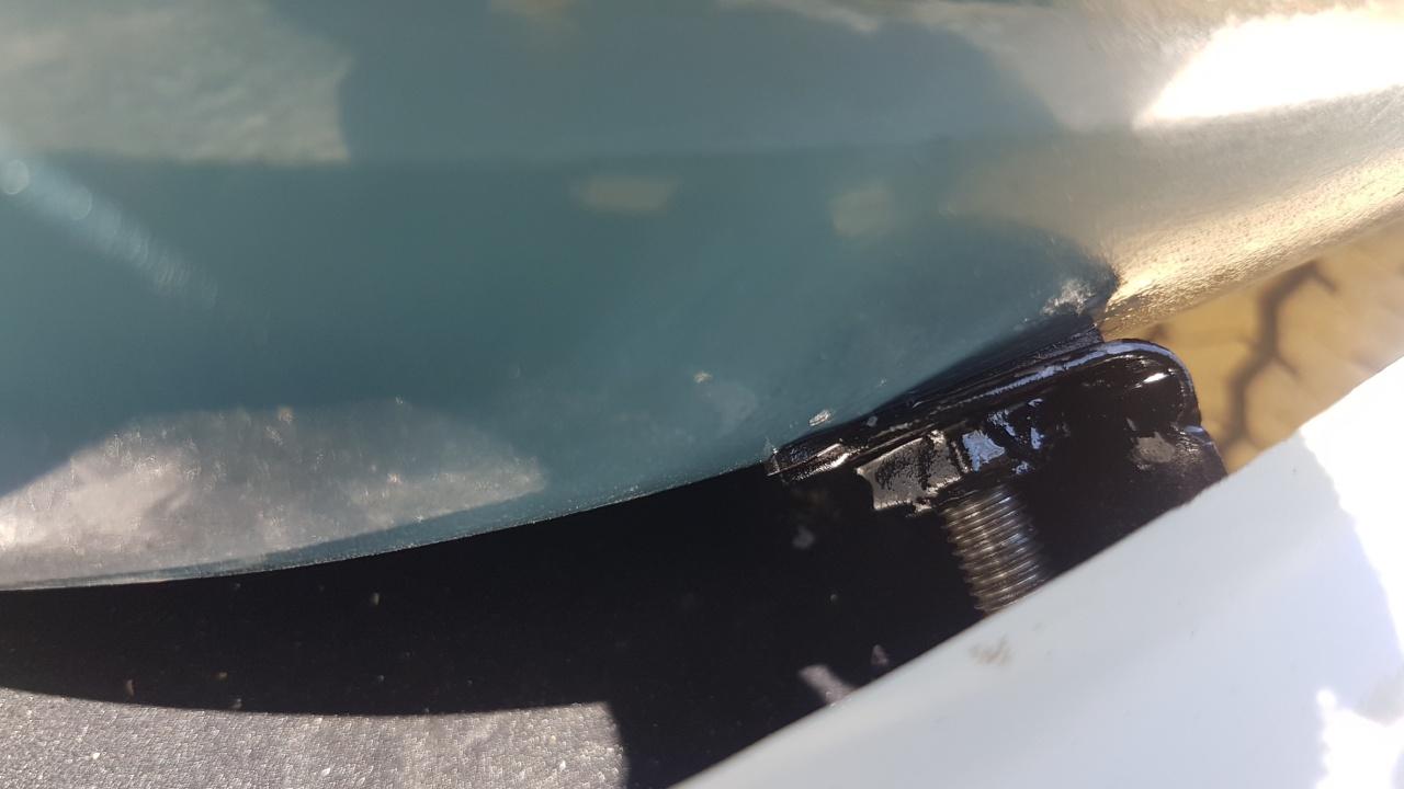

PostPosted: Thu May 13, 2021 6:32 pm    Post subject: Re: 64 Kombi restoration (Formerly know as the "partial restore”) Reply with quote
Bumper assembled
Need to find out where the rubber squares go. They seem a little large to go where i have them.. Also the 2 rubber stoppers that came with the fastener kit. I assume they go in the bottom bus corners but i will try to find a diagram that shows them.

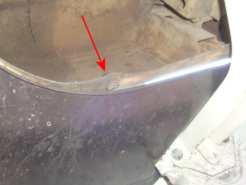

The rubber squares go under that single splash pan fastener between the bumper bracket and the pan.
The rubber buttons go in the holes under your bus' rear corners to prevent chaffing between the pan and the bus.
Posts: 71445
PostPosted: Thu May 13, 2021 10:14 pm    Post subject: Re: 64 Kombi restoration (Formerly know as the "partial restore”) Reply with quote
Plugs
In case this photo is confusing:
This is looking backwards toward the rear bumper/splash pan

PostPosted: Fri May 14, 2021 5:21 am    Post subject: Re: 64 Kombi restoration (Formerly know as the "partial restore”) Reply with quote
Thanks!
I thought that may be the case but seemed more important to protect the paint on sides.
I may make rubber washers to protect the paint also. I can make them small enough to not show when installed.

Posts: 71445
PostPosted: Fri May 14, 2021 11:58 am    Post subject: Re: 64 Kombi restoration (Formerly know as the "partial restore”) Reply with quote
Yes, the sides where the larger bolt passes through is metal on metal.
It's weird there's no protector but some people do put a little rubber washer there.
Go for it

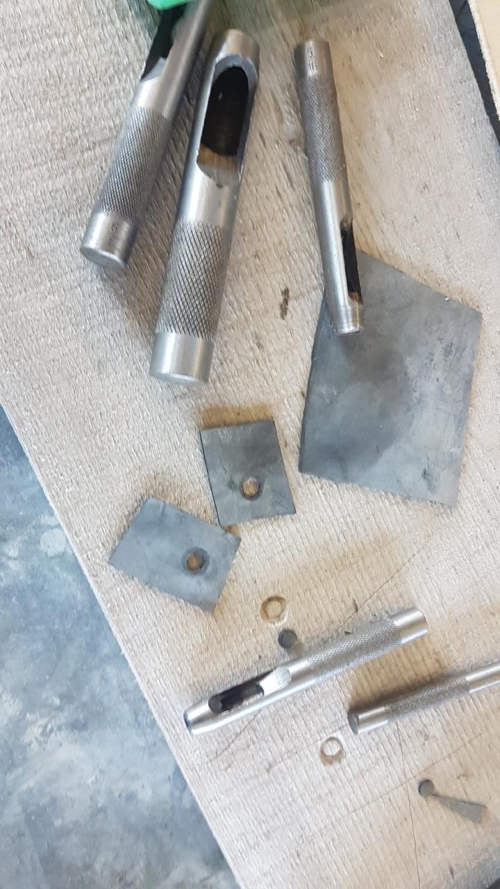

PostPosted: Sat May 15, 2021 9:01 am    Post subject: Re: 64 Kombi restoration (Formerly know as the "partial restore”) Reply with quote
Bumper on. Only 3 years in the making. Haha
Had to add a small shim to get it level. I assume between the bent brackets, frame and bumper that something wasn't fixed perfect.
Made some gaskets for the sides to protect the paint. Was a pain to get the bolts lined up on sides. The splash pans had been quite bent also so took a bit of work to get things fitting.

Posts: 71445
PostPosted: Sat May 15, 2021 1:03 pm    Post subject: Re: 64 Kombi restoration (Formerly know as the "partial restore”) Reply with quote
Yes, the sides are a pain but if you leave the brackets and other mounting bolts a little loose at first, it's easier to get everything aligned.
Maybe harder if you straightened original splash pans - they are often bent in weird ways from little bumper impacts over the years.
Too late now but for others reading.

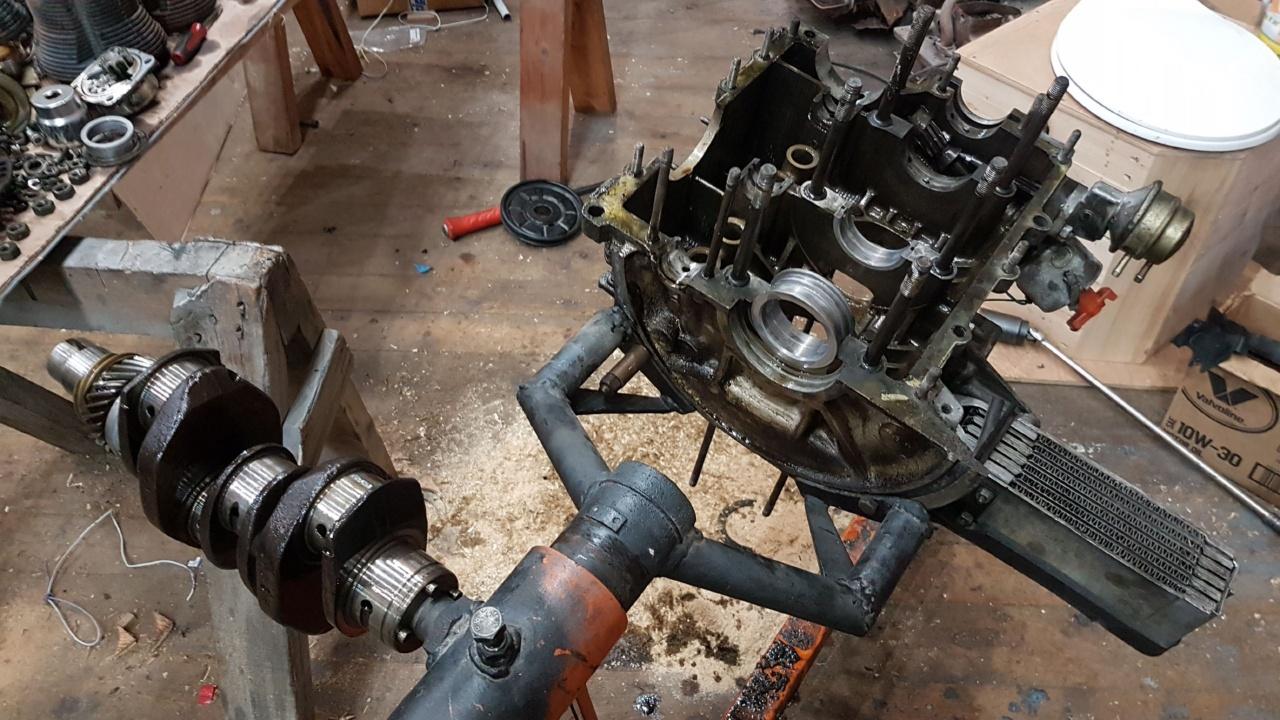

PostPosted: Sun Aug 08, 2021 5:47 pm    Post subject: Re: 64 Kombi restoration (Formerly know as the "partial restore”) Reply with quote
Encountered a slight issue on the last day of a 15 day trip. Smile
Started it to head home and instant knock. One of thous knocks that make you expect a bunch of oil and metal bits will soon be dropped out the bottom.
Called step son to bring the trailer. We were only 3 hours from home.
Got home and pulled the engine apart because we needed to know what happened. Smile everything was perfect... few theories but at least it is nothing that will destroy the engine immediately so we will find it. If it actually does it again...
details at
https://www.thesamba.com/vw/forum/viewtopic.php?p=9692218
I really need to get the spare engine and transmission done so we can do quick swaps if anything happens on trips. Lot nicer to loose a day or so for someone to drive an engine to us than loose the rest of a vacation. Just lucky it was as we were leaving for home.

PostPosted: Sun Aug 08, 2021 6:42 pm    Post subject: Re: 64 Kombi restoration (Formerly know as the "partial restore”) Reply with quote
I broke a ring once and everytime that hole fired it made the piston skirt hit the cylinder wall. Sounded like a rod bearing. Got louder the more loaded up hill or take off.
Another time I had a stuck wrist pin but that knock was all the time cranking or running and you said "no coil no knock" so doubt that.
My 6volt spare engine is called "The Knocker" as it has a tight lifter that snaps back when the valve spring pushes it loose. It too sounds like a rod knock but will go forever like that.
