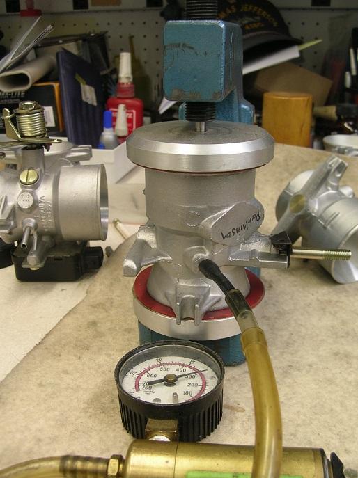

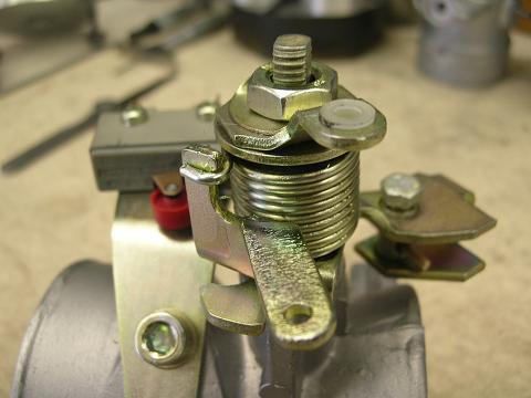

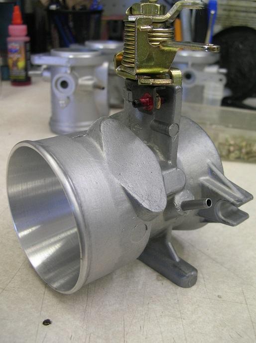

I am still rebuilding throttle bodies if you are interested. All years of aircooled and water cooled up to 1991 including porsche and superbeetle. Price includes a good used factory TPS and gasket until I run out of them.
PM for pricing
