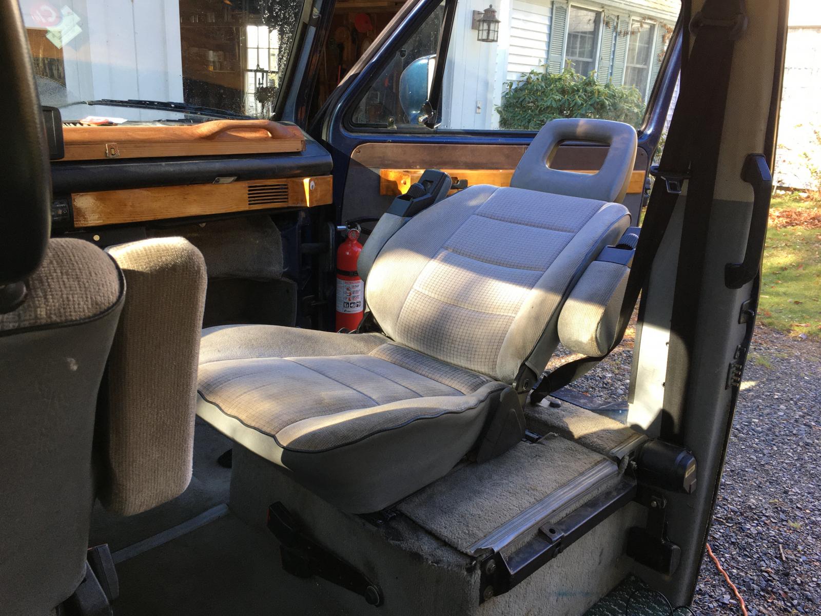

Has anyone installed this swivel converter recently?
A quick call to bus depot informed me that the swivel base will hang over the battery cover by 1-2", and that the easiest solution is to disconnect the battery box hinge, essentially allowing you to slide the cover off rather than "hinge" it off.
Does anybody have any pictures of their install so I can ensure the swivel base won't interfere with my battery terminals as well?
Link to busdepot product: https://www.busdepot.com/59500
Cheers!
Had mine for a number of years. Fine for what it is. Does it's job but has some drawbacks. It's very tight getting jumper cables on the battery terminals. I have an OEM swivel I'm meaning to weld in at some point.
I did mine last week and you will need to modify your lid to work. I removed my hinge years back and would agree, sliding it out is the best method to work with. The terminals are quite close to the edge of the swivel base/covering them halfway; I like the idea of the quick connect terminal as shown in the thread above, especially under the seat (I have children too that it would dangerous to have out). VW Logo

Would it be possible/advisable to simply cut out the portion of the swivel that gets in the way - cutting in-between the rail portion? Crappy drawing below.

Of course. I thought that's what everybody did. I did. Worked fine. The extra carpet can flap in the breeze just fine. It doesn't need supporting. Or cut that too if you like.

You asked about cutting the swivel base plate so the full cover door can open. Cutting the battery cover door is preferable in my book. That is what I do when I install a front seat swivel assembly. The door hinge is held to the van by a few pop rivets. Drill the heads off the rivets, cut the door to fit, pop rivet it back where it was. Cut slightly more than what you think, so the carpet flap has room to flip too.

Thanks - my above post was in reference to the actual swivel seat base rather than the battery box.
My concern is more for battery access, whether the cover is removed so it slides off versus cutting the cover, it seems access to the actual battery will still be impeded if the swivel base is on.
This is why I am looking to see if it is feasible to cut into the actual swivel base itself. Is this possible without destroying the function of the swivel base?

About 6 months ago, a guy sent a bunch of good posts and photos showing how he hinged the swivel base on one side. He had a pull out pin which allowed it to hinge up. This is the only way I would consider putting in a swivel seat. Interior storage is at a super premium and why would you give that up for the few times you want to swivel the seat? Far simpler to just install the seat backwards. If you drill out the pop rivets on the flap, the whole thing will hinge back on the carpet and give clearance for the seat slides so it can go in from the back as well. Remove the tabs which prevent this on the base slides. Also get rid of the spring thingy which keeps the seat from being able to go out the front without releasing it. Why would you ever need that?
IMHO, the swivel isn't worth it. Too expensive, robs stowage, screws up the batter location and raises the seat an uncomfortable inch. And not really needed with the mods I advocate.

syncrodoka wrote:
I shortened the plate and welded reinforcement on it to make battery access and removable possible.
I lopped off the back and reinforced it with 1/8" angle. The battery comes straight up and out if needed. I don't have factory seat tracks on the swivel base any longer so that may be a consideration, I don't remember how far back those went on the platform.

Thanks this is what I was looking for. Do you have any other pictures of your swivel?
The tracks come all the way back per bus depot's picture, but since the tracks are on either side of the battery box (battery box fits in between the tracks) - would just be looking to cut the metal between the tracks.
