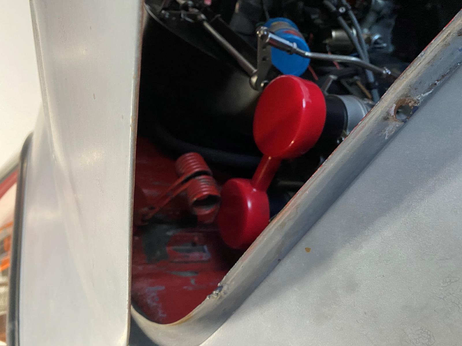

Not the greatest pictures and the carbs are 45 Dells on a 2276 so I don’t know if what I did will work for your HMPX carbs.
The original air cleaners that came with the carbs interfered with the passenger side hinge only. For a while I just took that one spring off and used a painting pole to prop the lid open when I needed to. On my refresh I wanted a more elegant solution so I ordered short stacks and air cleaner elements.
I may have given up a couple of horsepower but the lid opens and closes as it should with no interference.
I thought about struts but I didn’t want to punch holes in my body.
I never even knew about those weird little aftermarket clips spring things. I’m not even sure how those would work do they just kind of turned backwards and that holds the lid open and then we’ve got to do some finagling to get it closed?
I also did the same as jeffery8164. probably 25 years ago. never had a probplem since.
