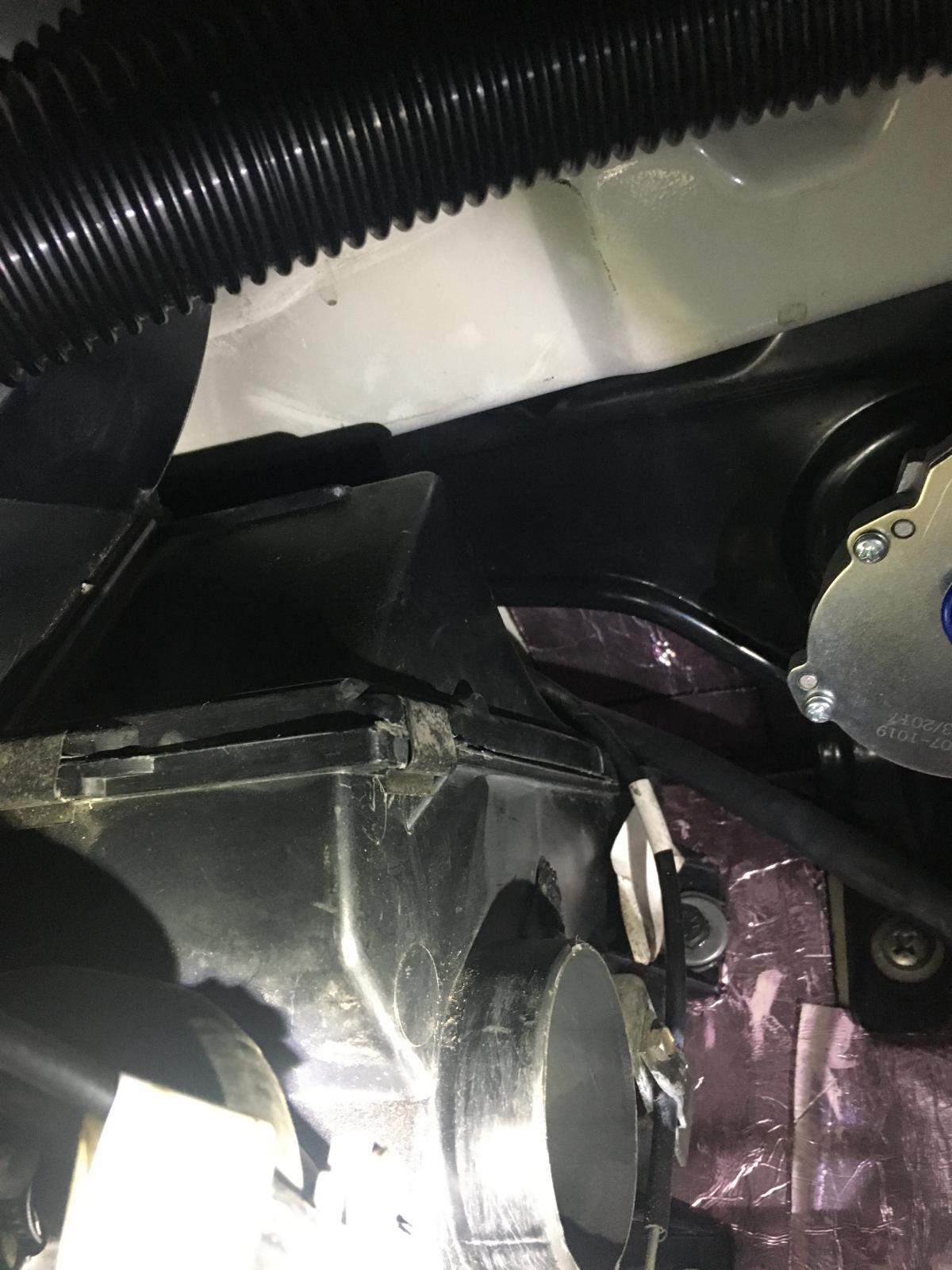

Hi There.
Has anyone done this install on a diesel air box?
I believe that the location in the thread that people have used is irregular on mine.
I’ve installed the Saturn Vue EPS, so access from the drivers side below is blocked.
Looking down with cluster removed.
Was thinking maybe I could install on the flat spot on the top right?
Or maybe the same spot on the passenger side top left here?
I was attempting to install w/o removing the dash as I previously removed the stock resistor when I had the dash apart a few years ago and had installed a PWM that recently went up on smoke.
Any information appreciated and thanks to the OP for sharing this info.

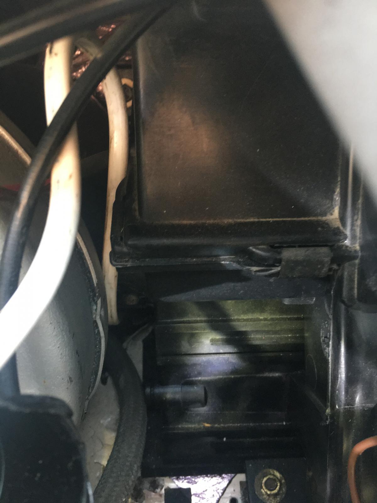

I just got done rebuilding a Vanagon heater box, with foam flaps, a new core and blower plus this mod. I wired up the blower the same as the OP, but when I test with a five pole switch, I get four distinct speeds, but no off...as in, the off position is the lowest speed. Has anyone had a similar situation. I haven't had time to dive into the diagnostics, (it's been a long day), so I'm hoping someone has some experiential insights.
Casey--
'01 Weekender --> full camper
y u rune klassik?
vanis13
Joined: August 15, 2010
Posts: 4352
vanis13 is offline
PostPosted: Wed Jul 21, 2021 8:14 pm    Post subject: Re: Dash blower rebuild with (cheap) Jeep resistor - w/PICS Reply with quote
your van is reacting to a jeep part being implanted in in VW being. the white coolant cells are on their way to eradicate the infection.

PostPosted: Wed Jul 21, 2021 9:20 pm    Post subject: Re: Dash blower rebuild with (cheap) Jeep resistor - w/PICS Reply with quote
[eyeroll]...this isn't my van.
I've done this mod before and had no issues, but this one is a little confusing.
