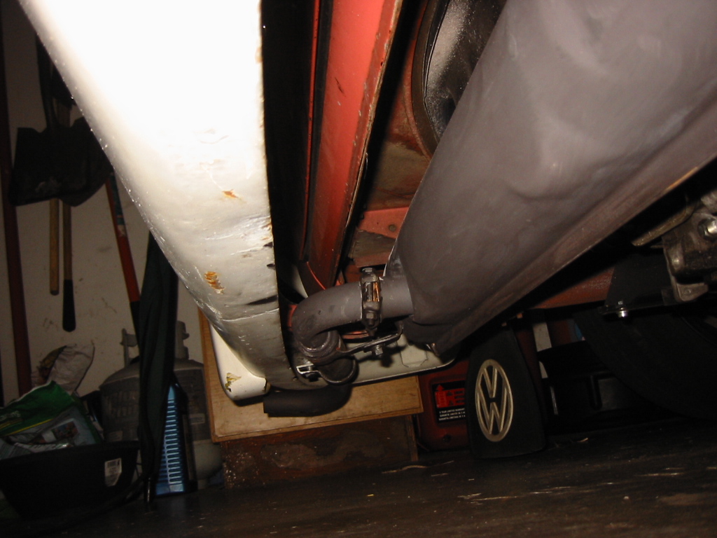

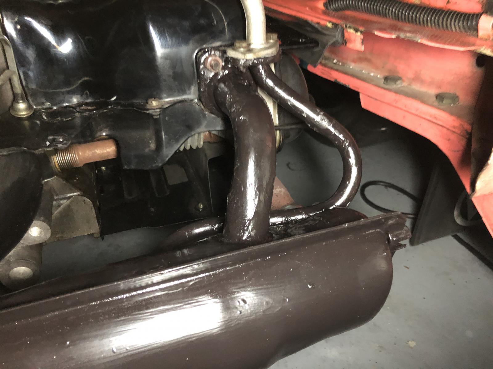

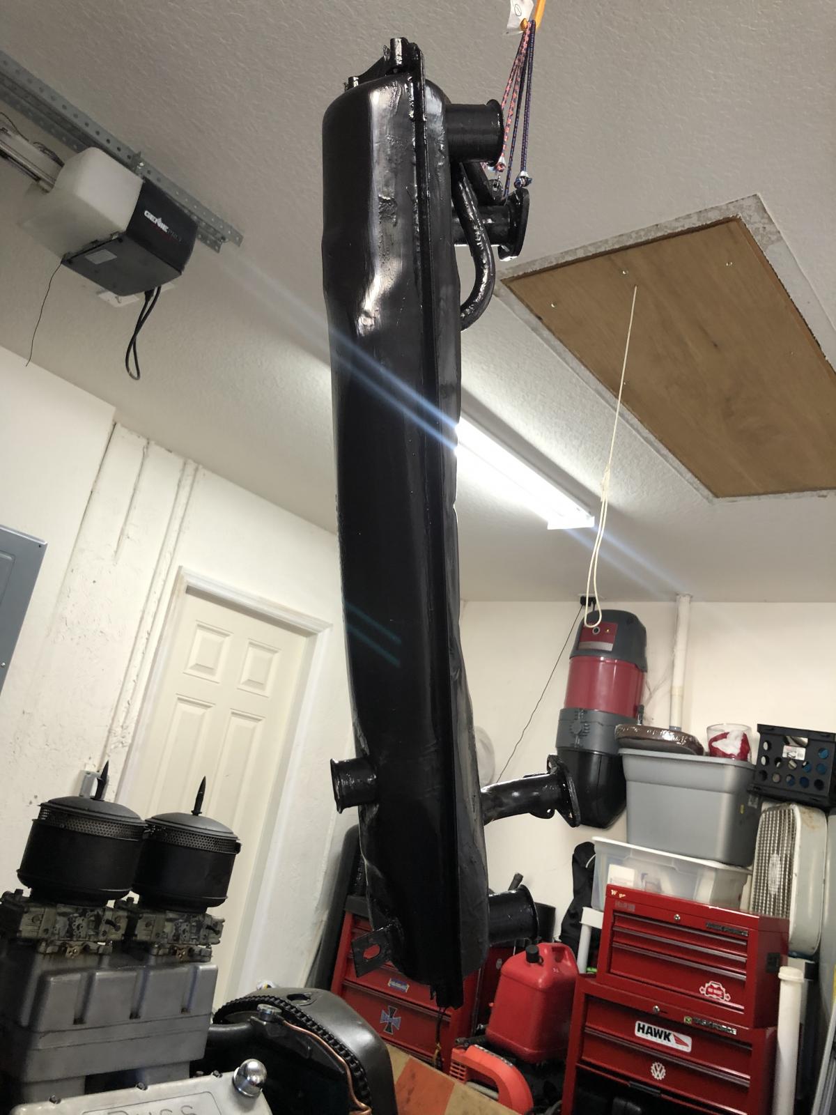

before putting the welder back I decided to weld up the hole in my exhaust.
I did more grinding than I should because I added so much metal with the welder.
The I used a wire brush on a drill and cleaned up the surface for paint.

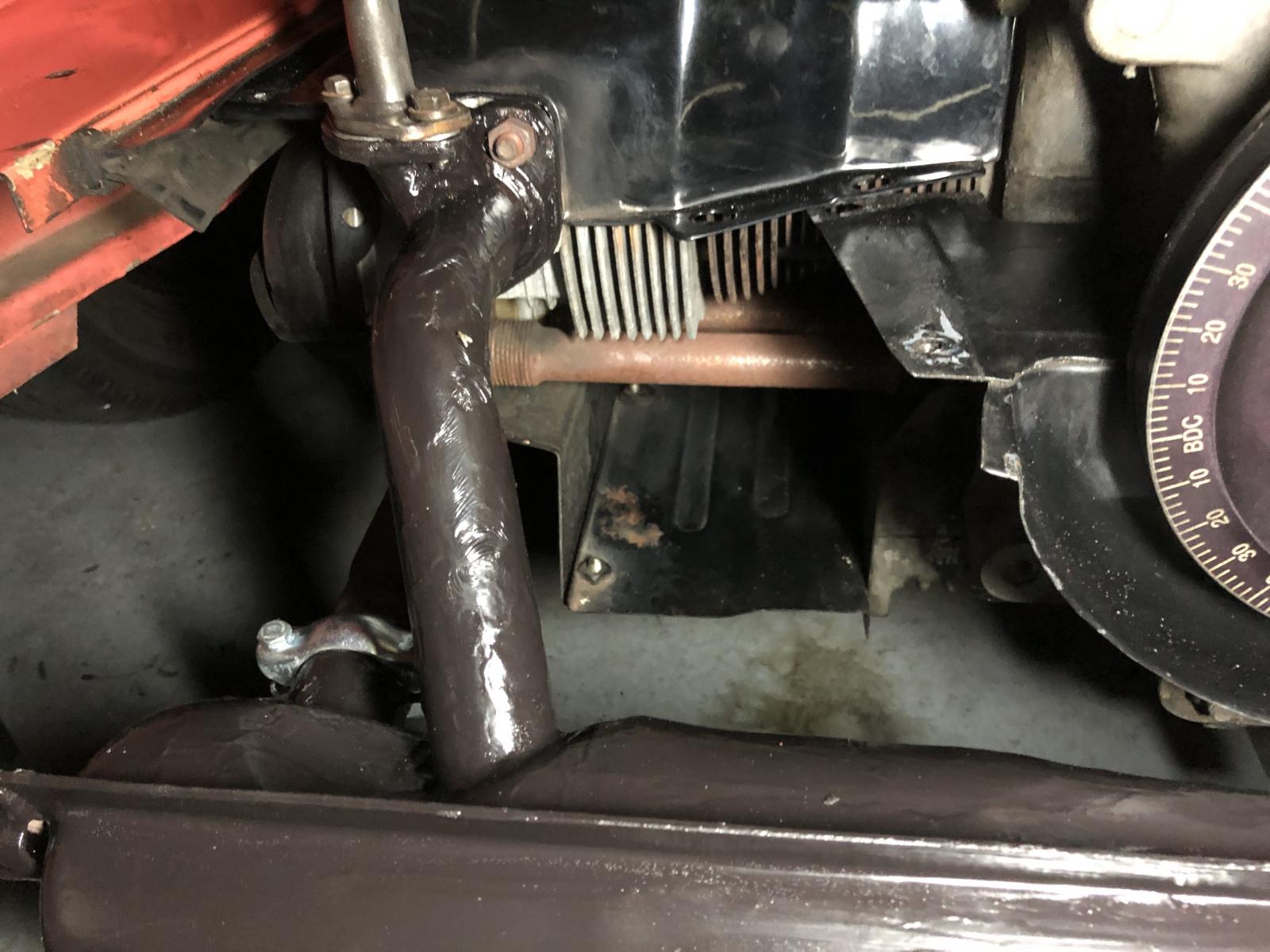

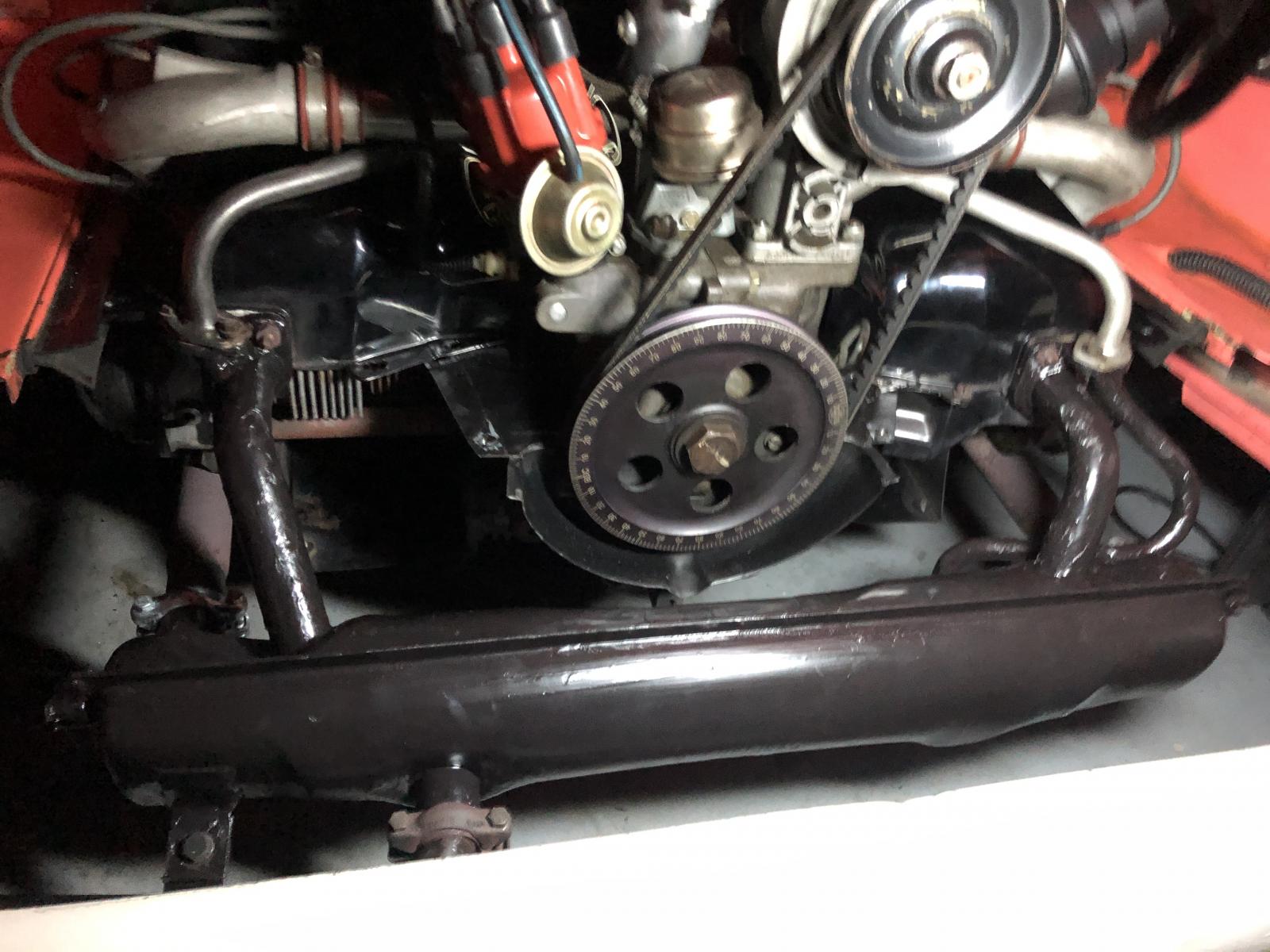

PostPosted: Sun Mar 29, 2020 8:58 pm    Post subject: Re: 67 Standard Peach Kombi, West Palm Beach, FL Reply with quote

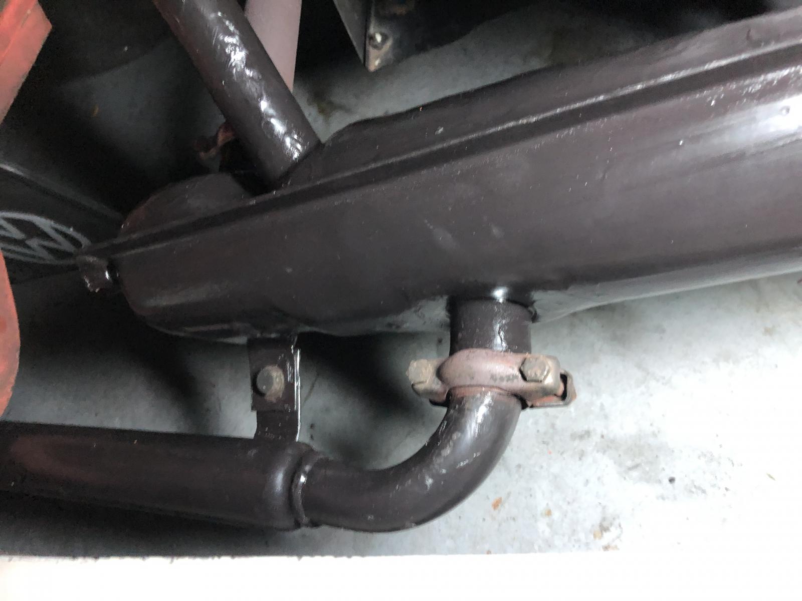

Loaded up the muffler with a thick coat of BBQ paint like I used in 2012. That lasted several years.
New gaskets all around except on tailpipe.
Put primary carb back on. Cleaned up intake manifold.
Need to replace intake manifold end port gaskets.

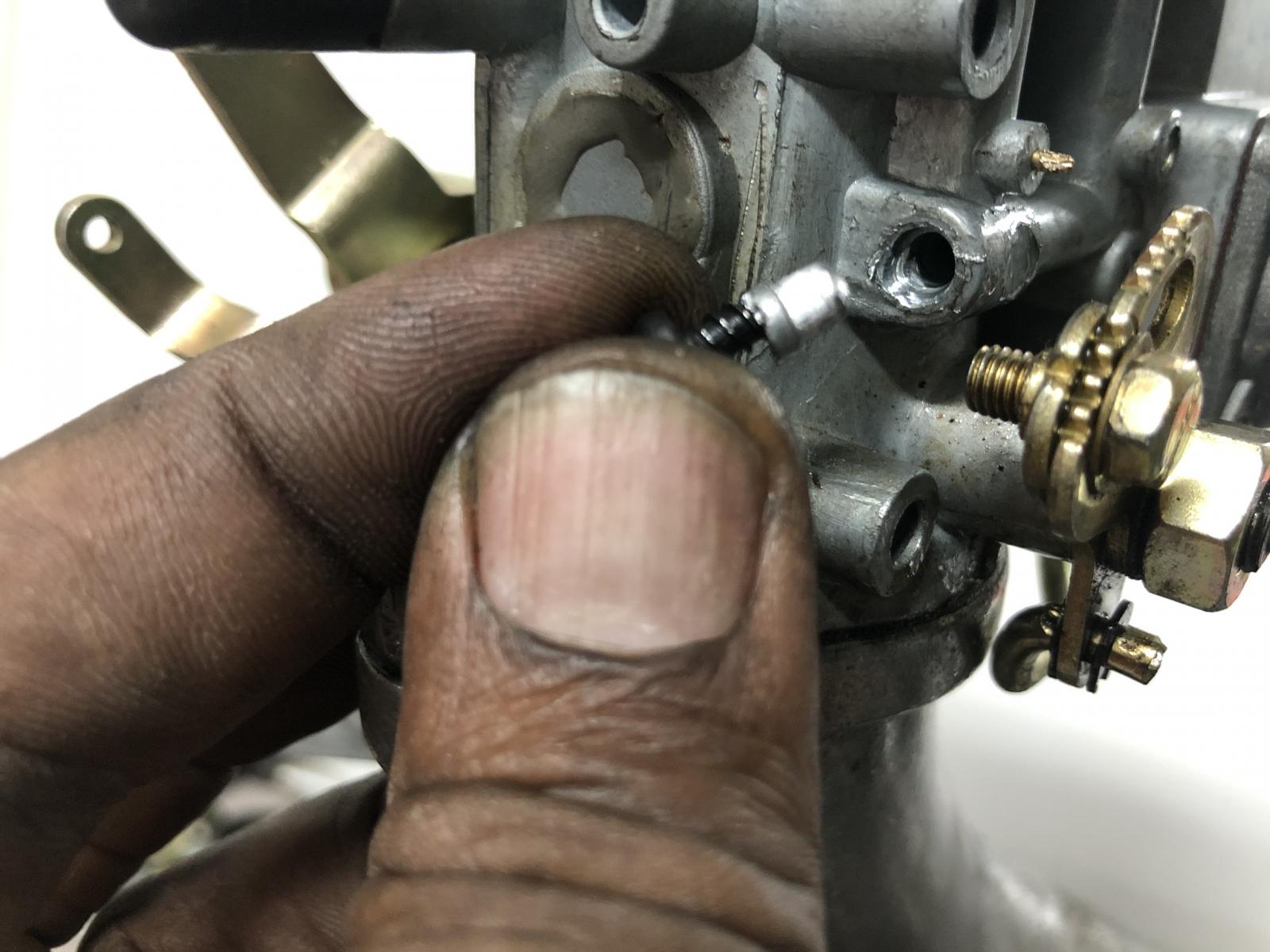

PostPosted: Sun Mar 29, 2020 9:07 pm    Post subject: Re: 67 Standard Peach Kombi, West Palm Beach, FL Reply with quote

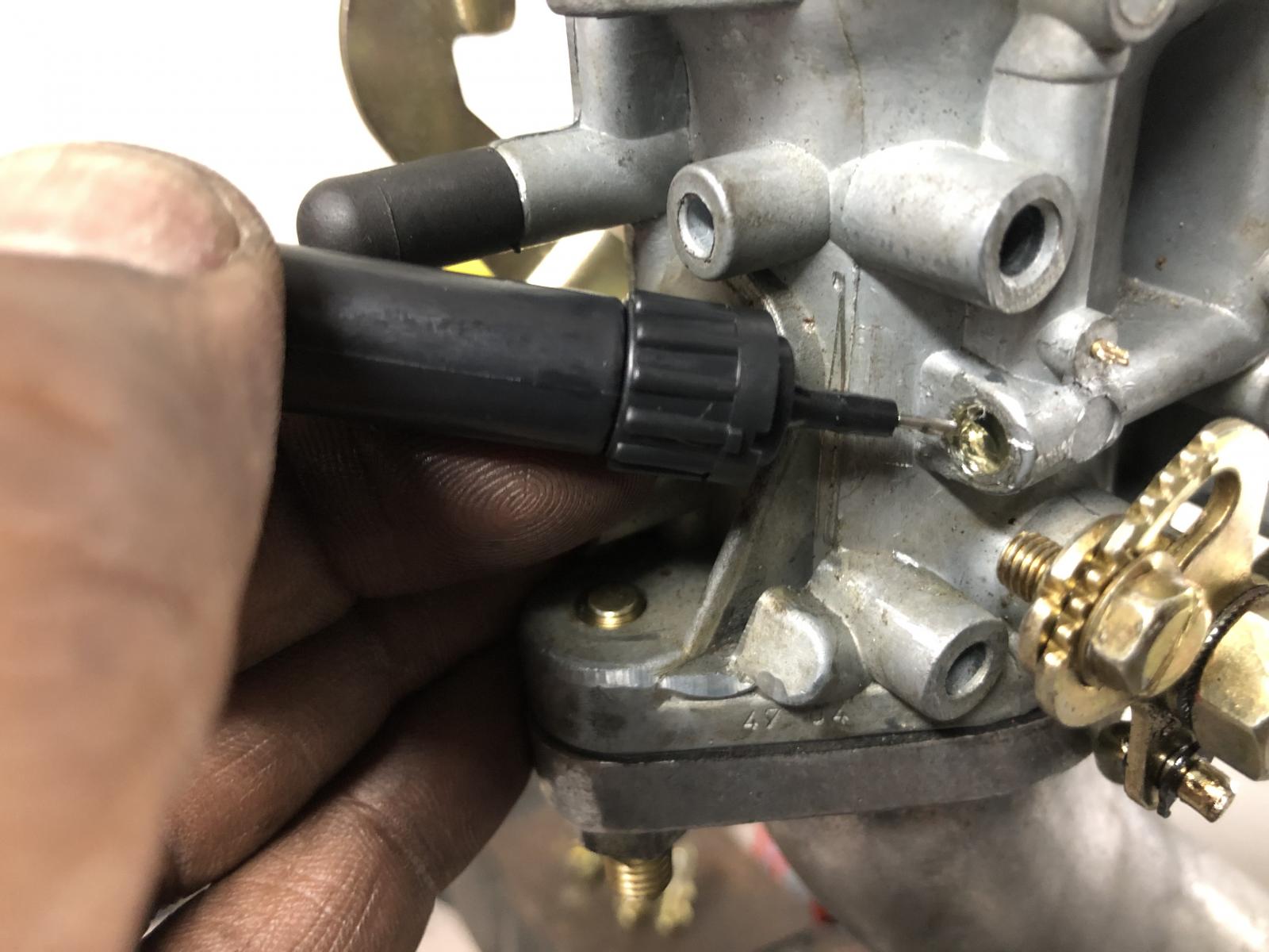

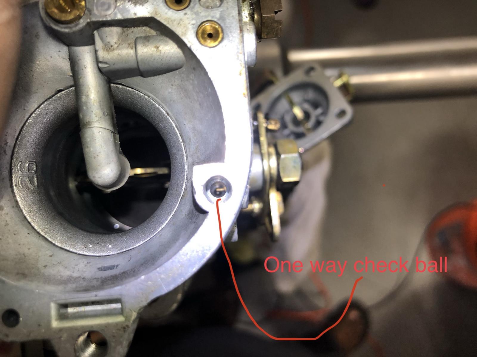

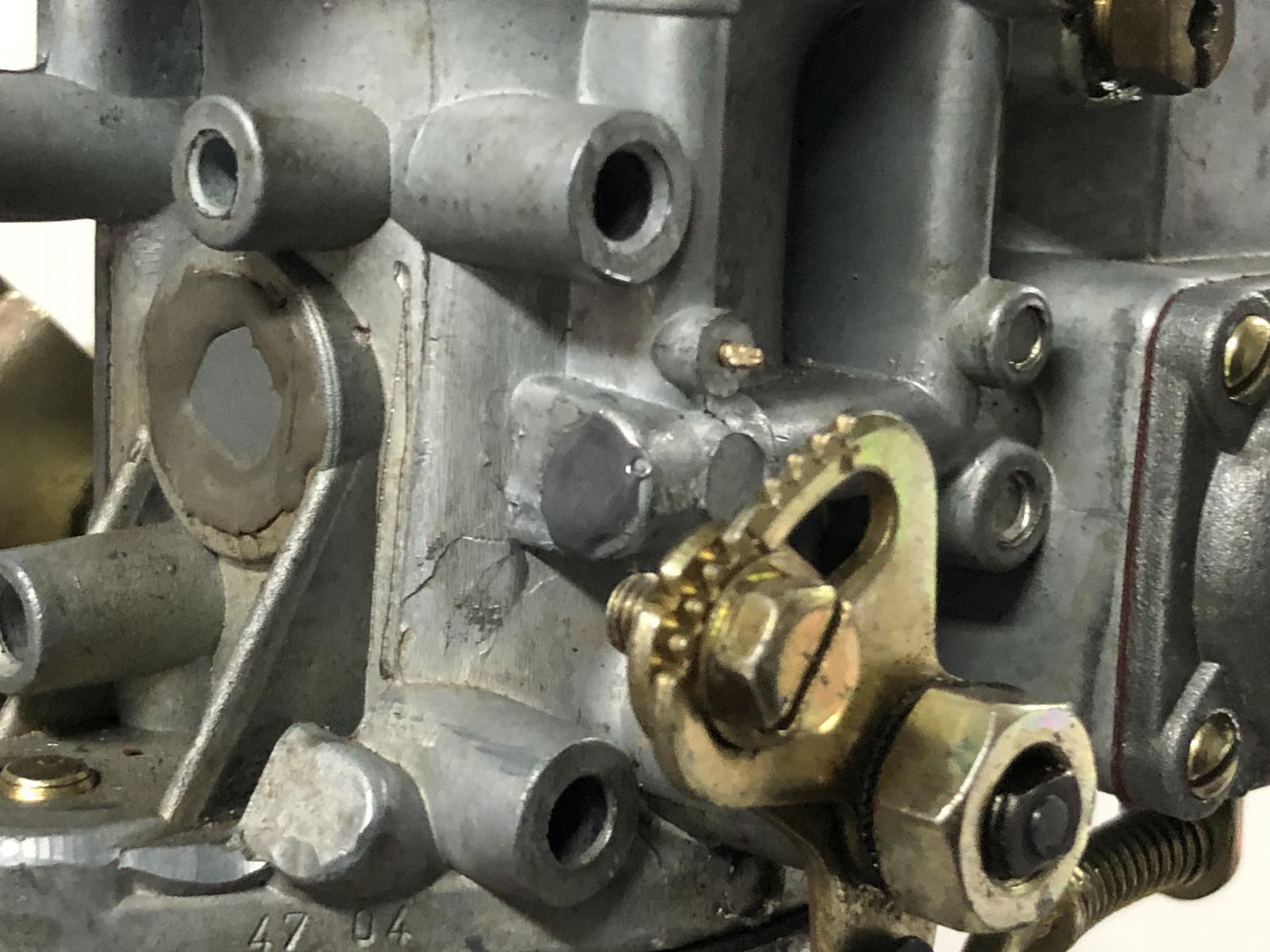

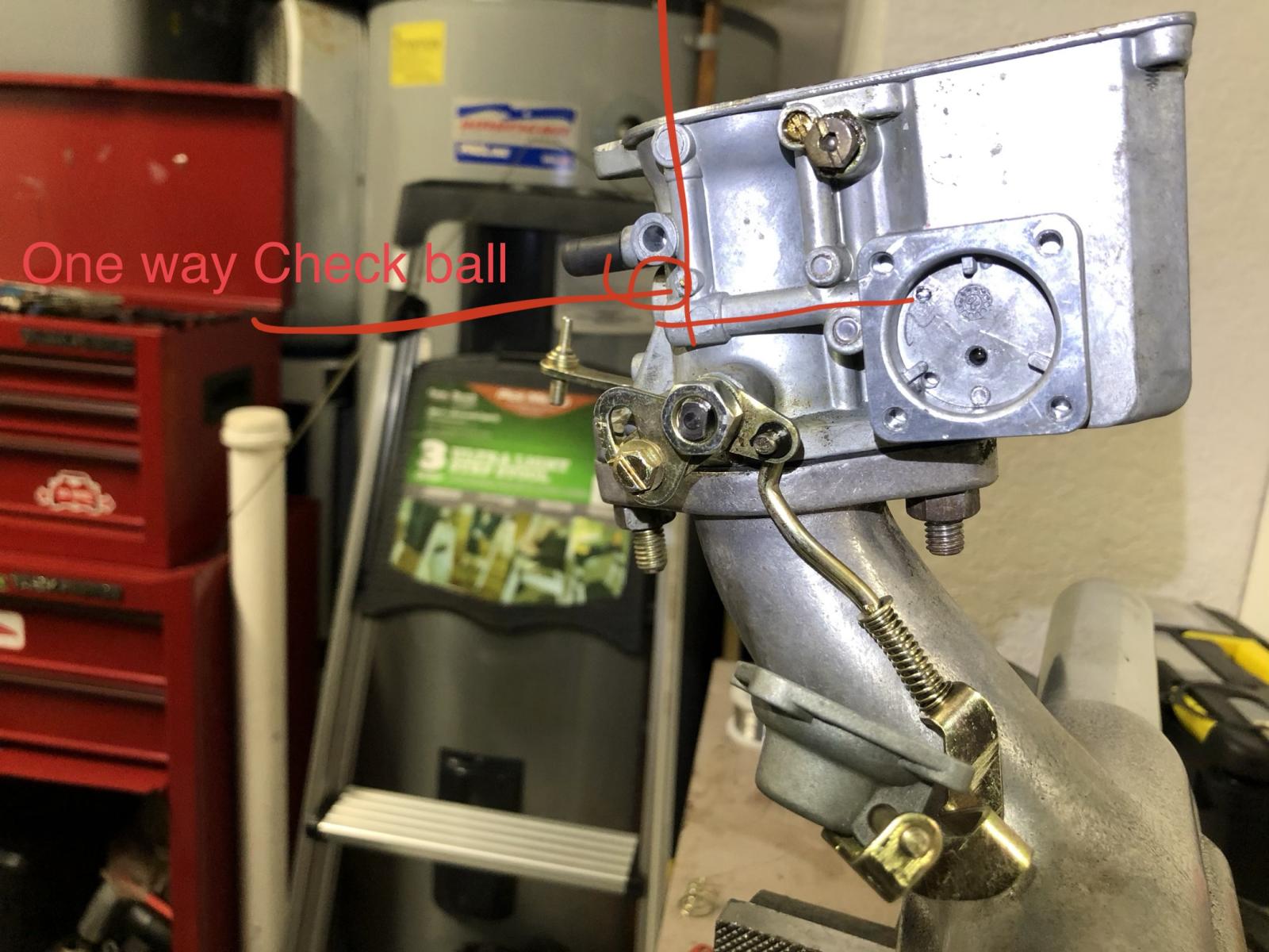

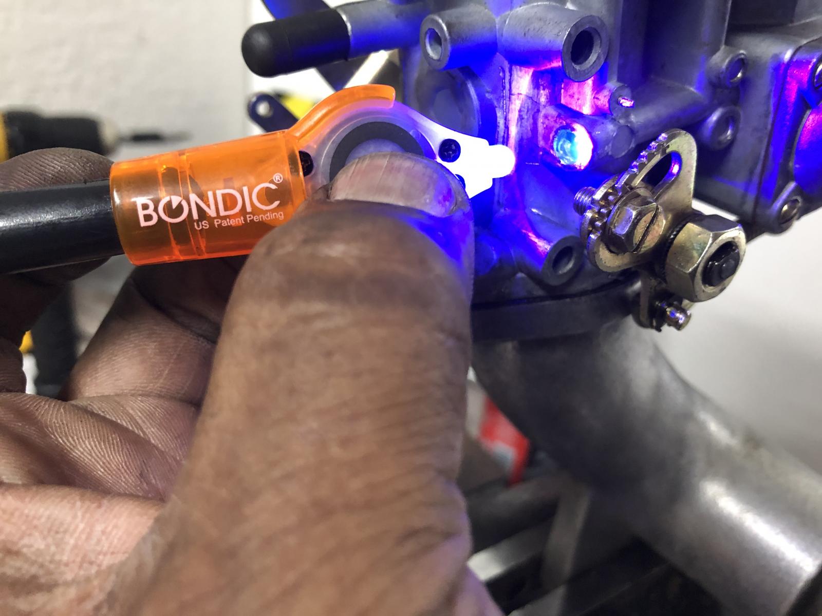

Before fixing the brakes, Empi carb started acting like it would not go when I hit the gas pedal.
Turns out the accelerator pump was not shooting fuel into the carb throat.
Decided to play around with it.
Used wire to clear the holes. Blew air and no flow.
I saw there is a small ball like a check or one way valve in the passage.
Removed the plug, freed up the ball, and tried the Bondic magic bonding agent from Instagram, but once I pumped fuel once it started to leak.
I just popped the bondic plug back out.
I then Soldered the hole I put in the plug (I used a screw to pull it out), reinstalled it, then put JB weld over that.
It goes back in the parts box as a backup carb.

PostPosted: Thu Apr 02, 2020 4:10 pm    Post subject: Reply with quote
Last time I used this paint it lasted several years.
don.ville wrote:
FROM Aug 6, 2011
Update on exhaust paint.
The spray on high temp black flaked off quickly, and the gray finish that it came with wiped off on everything.
So I hit the visible areas with a scrubbing pad and quickly painted it with this (without taking the muffler or bumper off):
using something like this:
After many miles, I am very pleased that it is not flaking off, and still looks good. I could have removed the muffler and done a better job, maybe later.

PostPosted: Thu Apr 02, 2020 4:12 pm    Post subject: Re: 67 Standard Peach Kombi, West Palm Beach, FL Reply with quote
This time I added more paint and it flaked off in 15 minutes !!!

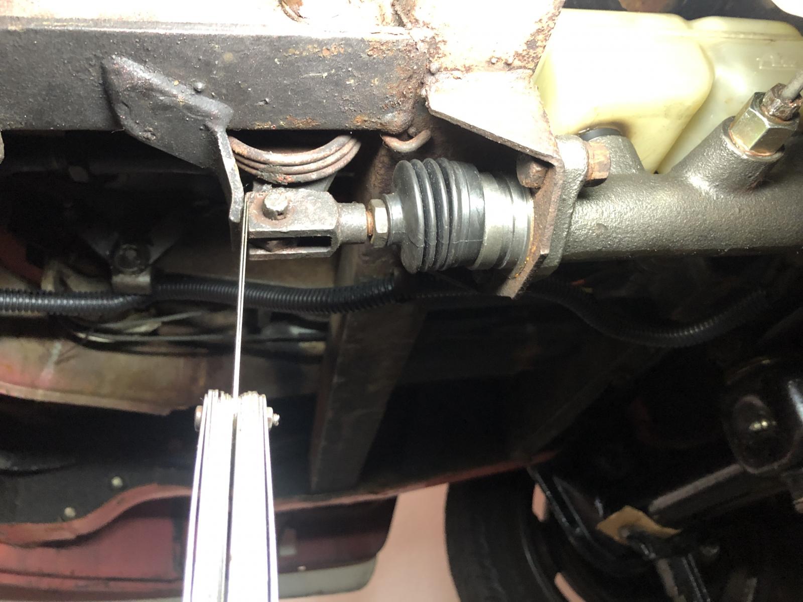

After my brake job I kept checking brake shoe drag on the rear wheels.
I would coast to a stop and feel the brakes pulling the bus to a stop.
Then when I get home the wheels would be hot to the touch.
Read online and checked my Bentley manual and I forgot to set the brake pedal free play or master cylinder pushrod free play.
I checked by pumping the brakes in the garage super hard and the rear wheels locked up. Then I undid the bolts on the master and the brakes released.
(I Didn’t check, but I would suspect and easier test was to turn on the key and see if the brake lights stayed on without me applying pedal, since the line pressure was stuck high)
Used a feeler to measure push rod free play Instead of pedal free play.
Set to 1mm. Bentley says you can even tap the pedal stop with a hammer if it needs adjusting, I did not.

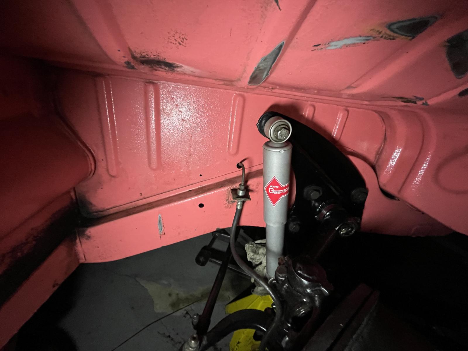

PostPosted: Sun Jan 10, 2021 10:22 pm    Post subject: Re: 67 Standard Peach Kombi, West Palm Beach, FL Reply with quote

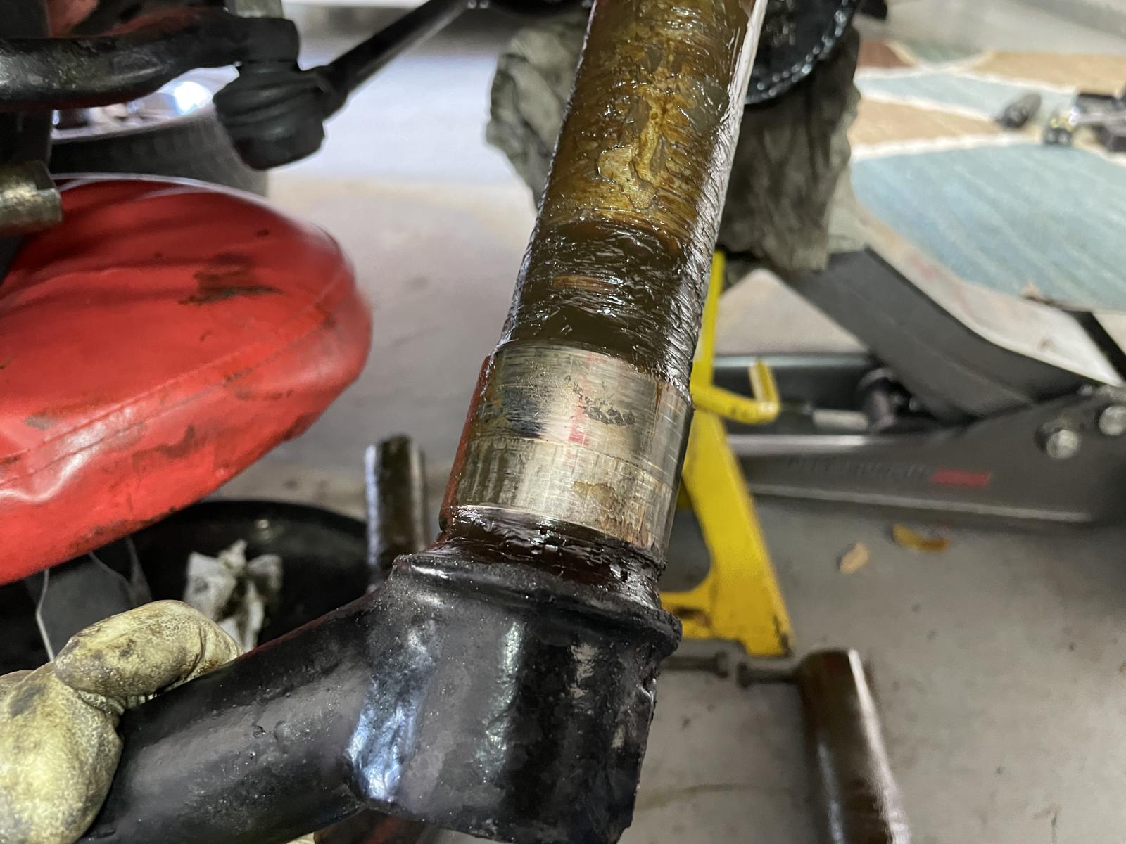

My Wagenswest bushing started to some play so I ordered a new set.
Turns out the first one I had was machined to keep the needle bearing race on the torsion arms.
I decided to cut them off this time, and I also changed shocks.
The air shocks were allowing the bus to bottom out more often and I never used the air bags anyway.
