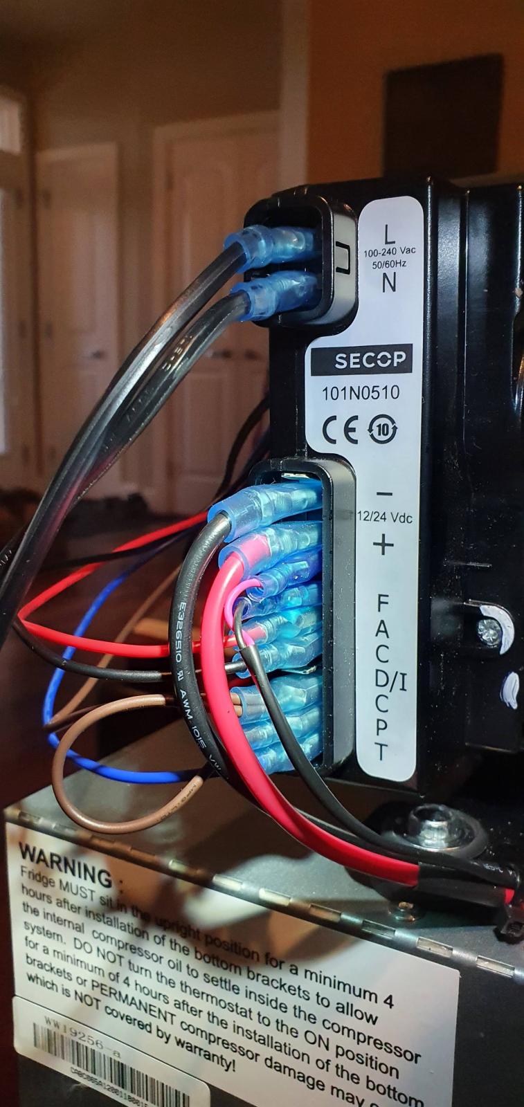

The Isotherm ITC requires Secop version 101N0510 (DC only) or 101N0212 (AC/DC), which is the control board used in the TF49 and others of that size. The version will be printed on the wire termination face on the back of the fridge (see the photo on Page 1 of this thread for an example).
kourt
I think you have those model numbers reversed. The Photo on the first page of this post shows an AC/DC version and it is model 101N0510

PostPosted: Sat Dec 05, 2020 6:26 am    Post subject: Re: Truck Fridge Digital Thermostat Reply with quote
Yep, I think you're right.

The result, expensive as it was, works well. The entire refrigerator circuit is controlled from the control panel now. It displays the sensed temperature in the fridge cabinet and can be adjusted for overcooling (which runs the compressor at a higher RPM) when a surplus of voltage is available--like when the alternator is running, or on shore power, or in sunny solar applications. There's also some temperature compensation settings in case the fridge sensor needs to be offset from a known calibrated temperature.
The Inkbird does almost all these things for a lot less money.
In summary, the Inkbird is a more cost effective way to come near this solution, but it lacks the overcooling/high compressor RPM capacity, and does not have a compressor soft start feature. No surprise.

OK so here's the INKBIRD method by Samba member letsrig
I like that it accommodates 120VAC operation.
I haven't done this yet.
My system is still (crudely) cutting fridge input power, thus my interior light only lights when the fridge is 'warmer' than the INKBIRD setpoint.
I did this because its simple
I don't have the electrical rig skills that member letsrig has.👍🏽
I made a diagram with letsrig's post - to put on my phone so I can take it out to the van.👍🏽
letsrig can you LMK if I got this correct?
If any mistakes I'll try to delete the error pic and re-post a corrected pic.
If anyone 'repeats' my (preliminary?) pic in their "quote", it prevents me from deleting the wrong pic on TheSamba (please don't quote this preliminary schematic !! ).
So I hope you can validate it ASAP before someone makes it permanent.
