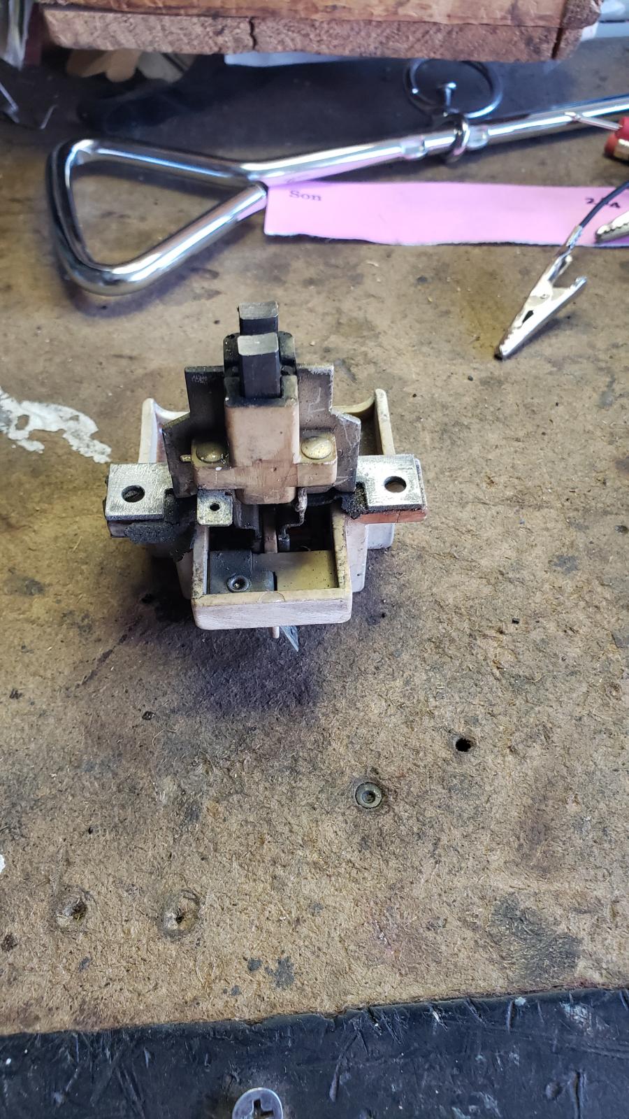

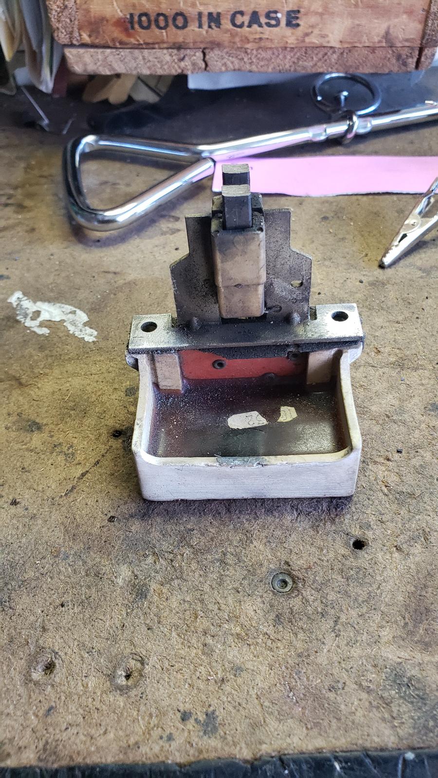

Where can I find one of these or even a part number. It was on my 1970 transporter 1600 alternator. This style is removable and I think it has gone bad. It would be an easier fix than replacing the alternator which will be a pain to remove. It looks like the regulator and brush holder are all in one.

no real way to know unless you post the model of your alternator

No expert on Type 1 alternators, but this should probably cover you, though they seem quite expensive, more than I paid for a new generator and regulator combined.

I think that is a replacement unit for an externally regulated Motorola alternator (73-74 style Beetle/Ghia). Dealer upgrade kit to internal regulator. Put a WTB ad up, I'm sure there are plenty gathering dust. Those are good alternators BTW

That Motorola part lacks the brushes. Maybe there are two parts there IF, and it is a big if, it is a Motorola alternator and not a repop copy.

That looks like the the Motorola regulator/brush assembly I had on my 71 Westy. Some scumbag stole mine off the bus while parked at the Westminster Mall where my wife worked at the time. Couldn’t find another one and ended up swapping it out for a Bosch alternator.

That looks like the right part, the brushes clip into the regulator unit. The externally regulated Bosch units don't have an easy access and are square plastic, the Motorola have a "T" shaped area.
Price seems fair for a NOS "Autobahn" unit ( damn it, now I'll have to watch the Big Lebowski). The brushes still looked good.

Thanks for the reply's I found out it is a pn 043903803e motorola 5-762. There is a replacement # m5762 for $50 at quick start it might by Chinese . Autohaus has one for $150
