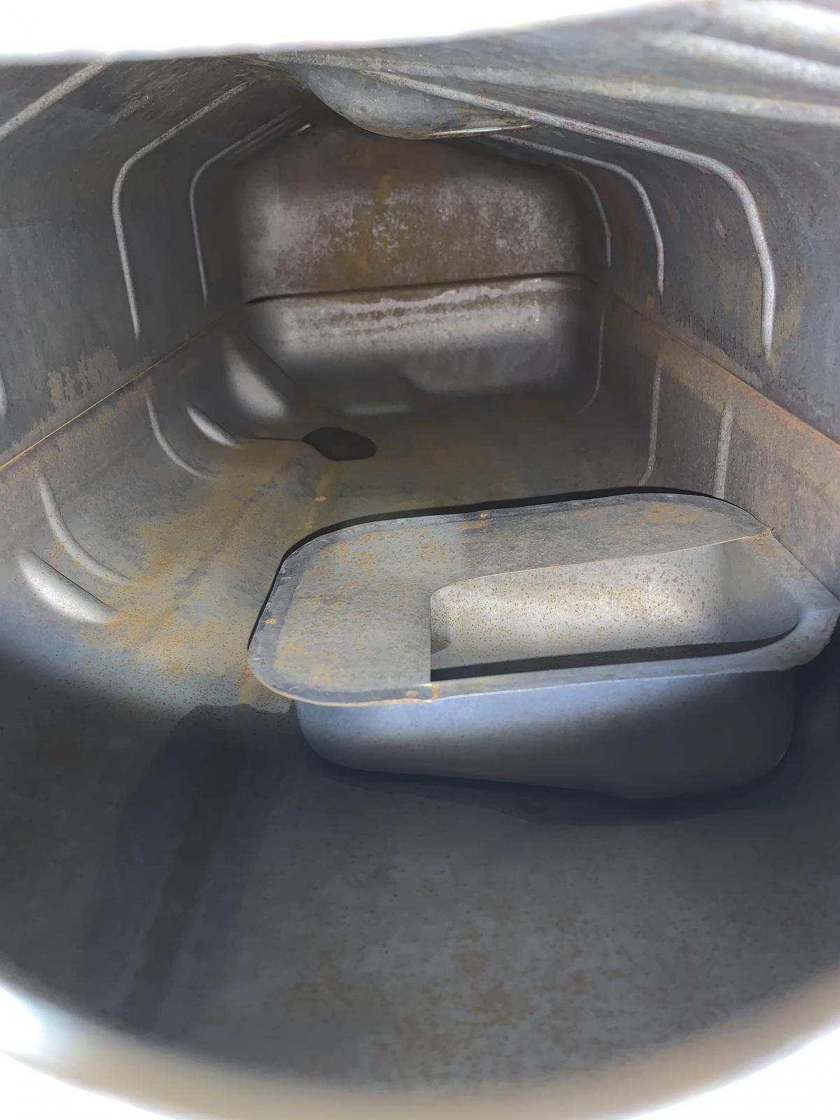

I just thought I am gonna update the situation with my tank.
I proceeded with another wash with muriatic acid. I did get rid of my brown~golden~pink that was left behind that wierd rust convertor.
I kept it in there for only about 20-25 min.
Now its almost dry (on its own) and this is what it looks like. What caught my attention are those little brown spots as there are all over. I have a good rust convertor that will go in my tank to tomorrow. Hopefully it will work ok this time

PostPosted: Sun Feb 07, 2021 8:56 am    Post subject: Re: Gas tank resealing gone bad! Reply with quote
Ok......DO NOT use phosphoric acid yet.
A couple of issues here:
1. Those brown spots are surface flash rust. They are exactly whar you are looking for.....but there is not enough of it.
2. This is showing that your muriatic acid cleaning solution is too weak. I think I noted from your posts that you are using 50/50 water to acid?
That would normally be borderline workable. However.....i am betting that where you are.....just like here ......you are suffering from "Nanny culture" Laughing
About 5-6 years ago.....sellers of muriatic acid....mostly home stores.....started carrying "reduced strength" muriatic acid. Its pretty much all you can get in most places unless you are buying it at a pool and spa shop.
Regular muriatic acid is about 31.5%. Its common that shitty pool shops are selling 20% muriatic acid. And so do many home stores. It will likely require at least one extra changeout of acid/water if diluted.....and also require a day or two of soaking. So twice as much time and twice as much acid.
And this product is pure crap
https://www.lowes.com/pd/Crown-1-Gallon-Muriatic-Acid/4146121
It is 10% solution strength. Its designed to prevent lung injuries from the fumes....for idiot home owners who are too lame to read directions and buy a respirator. It will not do what you need to do to your gas tank ....probably even undiluted.
3. So put your muriatic acid into the gas tank.....undiluted if its low strength. If the label reads 31.5%.....use it at a 70/30 acid to water dilution.
Slosh it around to coat all surfaces. Wait an hour or two. Then add some more. Slosh it around. Wait an hour or two.
Drain it out.
DO NOT rinse for about an hour or so. Then rinse once. DO NOT neutralize it.
Let it dry by itself.
You should see about 75% more flash rust than you have in your pictures. At that stage.....then you can use phoaphoric acid. Ray

Bit off topic, but does the tub get filled just by slosh?
How much fuel remains in the tank when the tub empties?
Im not sure what you mean by tub. I full the tank working over a tub to catch any spillage. I do not fill a tub with acid mixture and then soak the tank in it. To do that....in lime a 25 gallon tub......you would need several gallons of acid to make the solution strong enough to get the job done.....and then you would have a massive amount of solution to neutralize and dispose of.
But its an important question. I clean and rinse the tank several times before I put the acid in....and it,still has potentially dangerous fuel fumes.
Typically when I do a gas tank......I put a gallon or so of acid water mix......IN THE TANK. All holes duct taped except for a small bore/3mm vent tube....if yours has one.....with a clamped off hose on it so I can let of any pressure (it produces hydrogen gas). Slosh well. Let it sit and soak....slosh again....change positions....repeat. Add more acid if necessary for strength.....repeat.
Ray

Thank you Ray. I appreciate you knowledge and input.
I looked it up and my muriatic is 31.74%. Yes i mixed it 50/50 with water.
I am trying to understand the process here...so you want to remove the existing layer of rust (that I had there) basically to create a new layer of rust that youโ€™ll convert using convertor. What is to goal? To have it covered completely by flash rust? What would happen of I used phosphoric now?

raygreenwood wrote:
Ray
By tub ,I awash referring to internal, liter size baffle around the tank drain
raygreenwood
Joined: November 24, 2008
Posts: 23401
Location: Oklahoma City
raygreenwood is offline
PostPosted: Sun Feb 07, 2021 2:49 pm    Post subject: Re: Gas tank resealing gone bad! Reply with quote
Ok two important things that the muriatic acid does:
1. The muriatic acid......removes ALL rust. Because of its solution strength and its an oxidizing acid.... its the only acid that can remove deep crusty rust. This is because as the surface of thick rust is being dissolved.....it neutralizes the acid that comes in contact with it. So if you have thick crusty rust.....sloshing the acid around to keep it replenished....and/or refreshing the acid is KEY to getting ALL removed down to bare metal.
2. The second function of muriatic acid.....is that it is an OXIDIZING acid. Once you get all of the rust removed to bare metal.....having high strength muriatic acid in contact with steel or iron surfaces....breaks down some of the chloride ions only at the surface.....and creates excessive hydrogen (Im explaining that poorly).....which creates hydrogen embrittlement......which is what causes the flash rust.
This "flash rust".... is different than the crusty rust you are trying to remove with the muriatic acid.
Thicker Crusty rust more than about 0.003" thick....cannot be converted all the way through by phosphoric acid....because the phosphoric acid you SHOULD be using for surface conversion is not strong enough to reach more than about .003" into tbe rust layer before it gets neutralized by the reaction and the rusted surface gets sealed up..........which leaves a layer of rust underneath.....that can continue to rust.
But flash rust.....ranges from just a few microns thick.....to about 0.001" thick. And....this flash rust.....like all rust.....is molecularly bonded to your steel. The phosphoric acid can comvert this to iron phosphate all the way through the rust to the surface of the steel....and will now be a protective coating bonded molecularly....to the metal.
So.....first use muriatic acid to remove all rust ro bare metal.....AND....qllow soke contact pd fresh acid with the metal.....tocause flash rust. Then convert that flash rust with phosphoric acid. Then oil it for storage or install it and keep fuel in it......and it will likely never rust again.
Ray

busdaddy wrote:
Thanks for the in depth explanation of the science Ray Cool
But I think you are making it sound much more complicated than it needs to be, sure in a perfect world we'd end up with X microns of inert coating in the tank, but having done close to 100 tanks using the wrong strength materials and rushing the finish I have yet to have one get rusty again or cause problems, some have been in service for 25 years or more. The important thing is to buy good fuel and keep it fresh, most of the tanks we see in these threads have been neglected for a long long time, drive the bus, tractor, mower, whatever regularly and it won't be a problem.
YMMV. Wink
Please don't take this the wrong way Ray, I respect your answers more than most of the posters here, I'm just saying there's more than one way to do it.
All true.....but no....I am not over complicating it at all. Most are just over simplifying it...and thay can eventually have adverse effects.
Bear in mind.....that across just these forums here on the Samba...I end up explaining this....again and again....at least every 6 weeks.
If it were simple....dead simple and always succesful.....people would not have to keep asking! Laughing
More people have adverse issues than not.....either because of not knowing what order it needs to be done in....what they are looking for....or when the chemicals are right or wrong
At best....many end up stripping the tank and getting it clean and it works just fine as a clean bare tank......but many times it has no extra protection. The risk to that is mainly to those who drive little and live in humid areas. Water settles to the bottom and can rust.
Bear in mind as well.....if you have no rust to convert.....many of the phosphoric acid chemicals like Ospho....SHOULD NOT be used at all.
If you have no rust....and you are applying Ospho to bare metal....you get a bluish tint.....and no phosphate coating.... instead you get a thin polymer coating that will slough off in the fuel and clog filters.
Likewise....if you use muriatic acid.....you WILL always get some surface rust after the fact because it causes hydrogen embrittlement....always. It may be patchy like those in the latest pictures here.....and sure....you can use it just fine. But...it WILL keep rusting without conversion in those patchy surface rust areas.
So if you want simple......then DO NOT use muriatic acid. Use a high strength phosphoric acid undiluted....which strips the tank.....but does not convert rust (because there will be no rust).....and just rinse it out before it dries.
Nice clean tank.....but no protection of any kind. Keep it full and water free or it CAN eventually rust.
Lastly....this used to be much simpler. Phosphoric acid solutions were made for one thing....rust conversion....NOT rust removal. Many of the common products available have changed chemistry RADICALLY in the past five years or so. Some are much weaker...some are much stronger. Some have moved to chelating chemistry and have to be used in a totally different way.....and few seem to bother to download SDS or TDS's to find out,what they have. Wink
Ray
