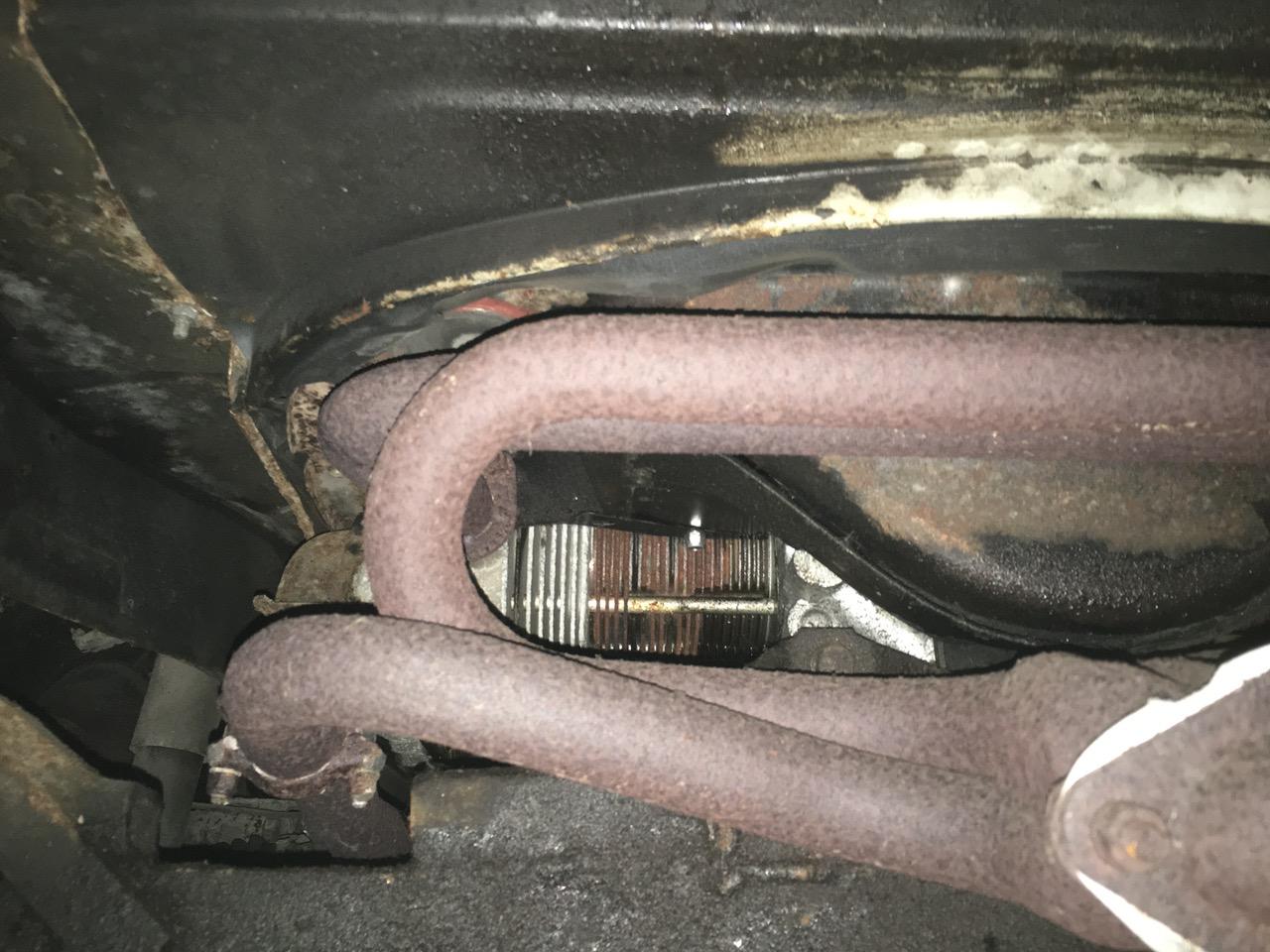

Thanks everyone. Something not helping is being 10,000 miles away from the vehicle. I've had family have a look at her and it looks like she doesn't have any heat exchangers (has an Eberspacher heater). Still plenty of viable gaskets though I guess (including the dodgy white one in the pic).
The exhaust is ok but not great so might think about replacing in the UK if the parts are more accessible/cheaper. I will probably get an asbestos inspection so that can double check the brakes and gaskets. The engine was installed in 2012 so you'd expect non-asbestos gaskets were used then. I think I might have come across the Ben/Leah post in the past so will find it again.
