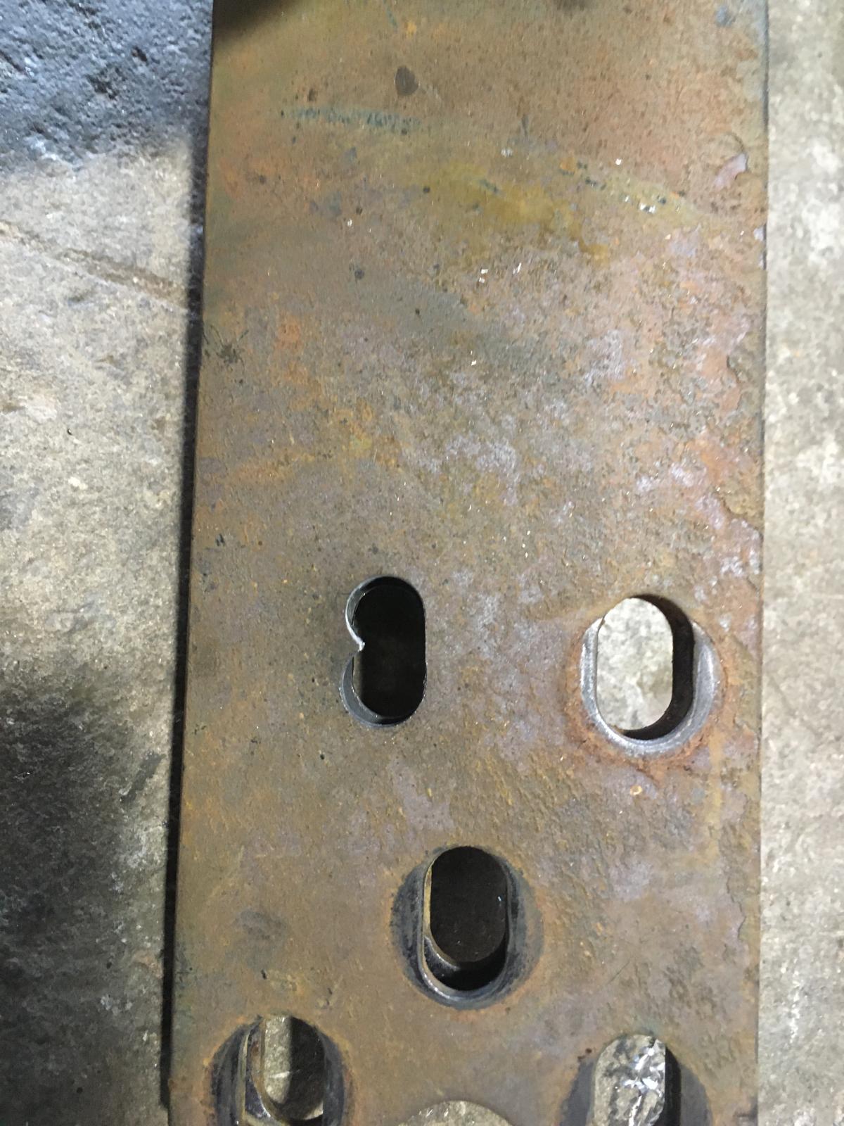

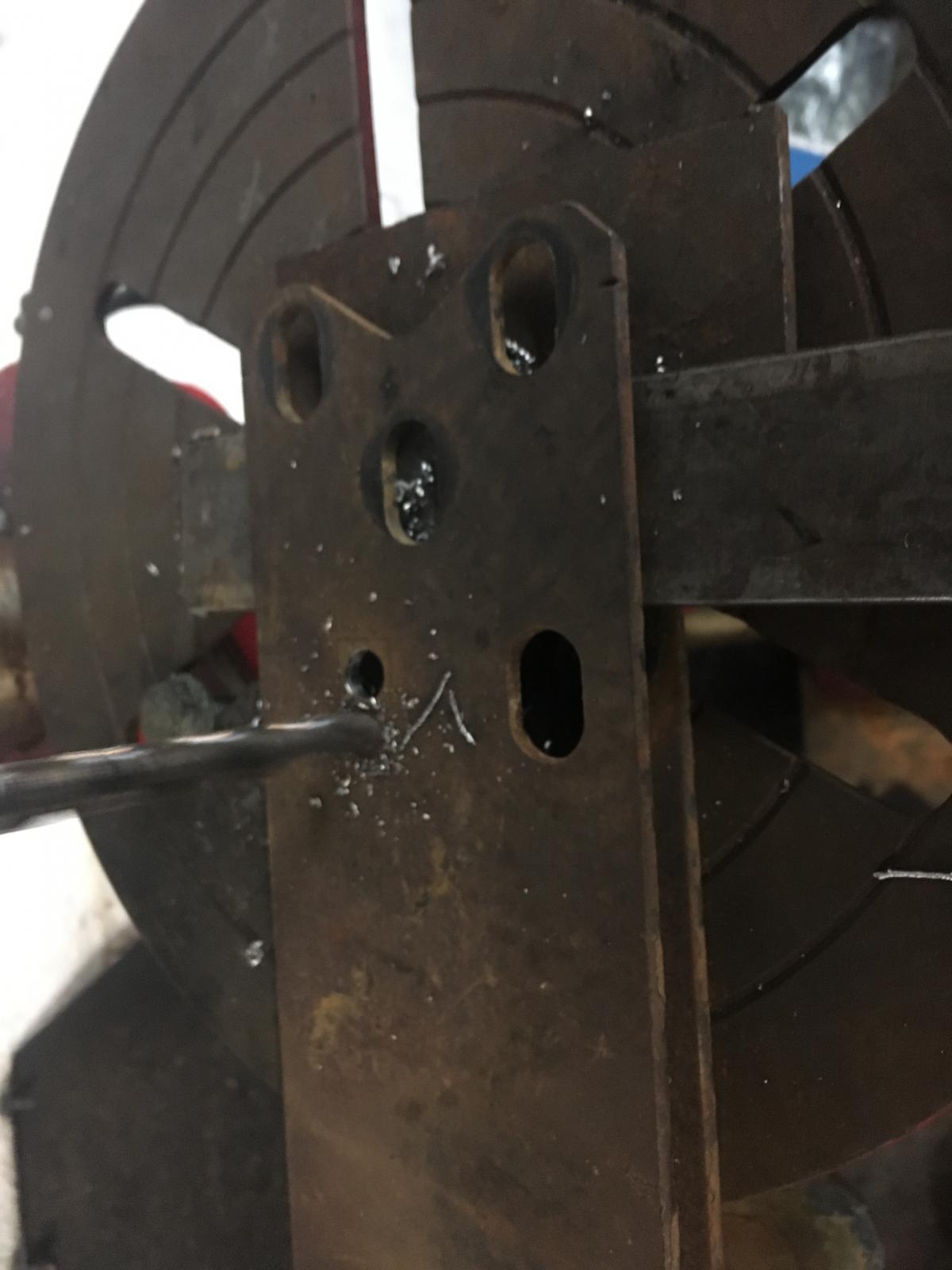

With only a few minutes to rub together, I decided to prep the other spring plate. I began by measuring out the original & then transferring it to the new spring plate.
I then wedged a couple pieces of scrap between the plates to reduce deflection & drilled a couple holes through both sides of the plate.
Once the holes were drilled, I used this hateful little bastard to remove the excess between the holes & clean up the slot.
And I now have a double spring plate for the Thing.

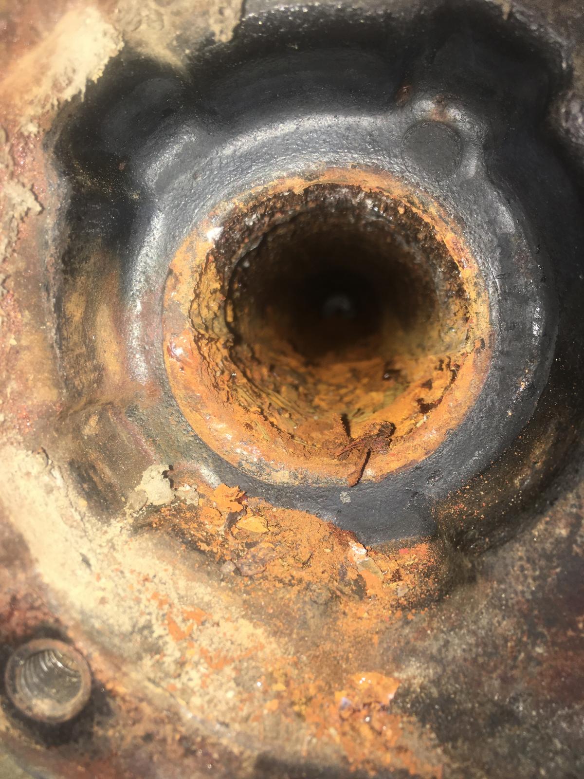

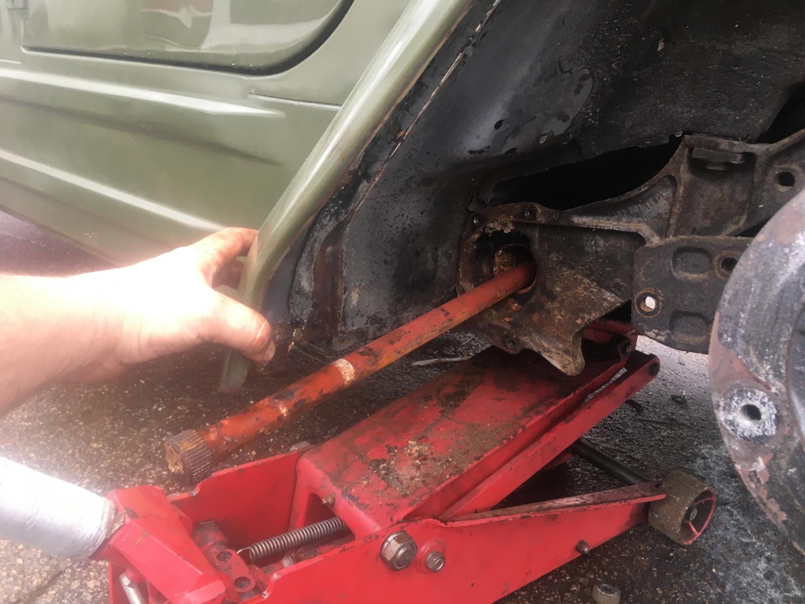

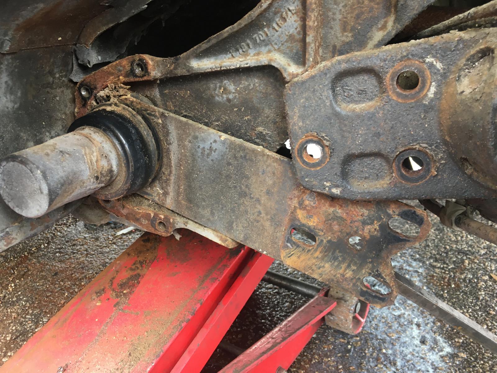

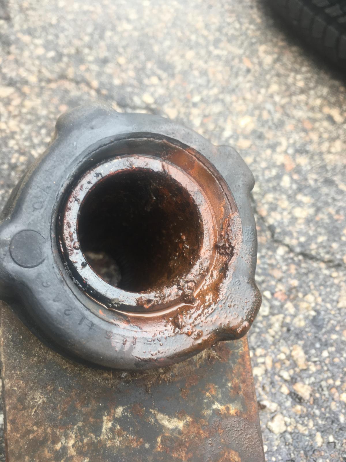

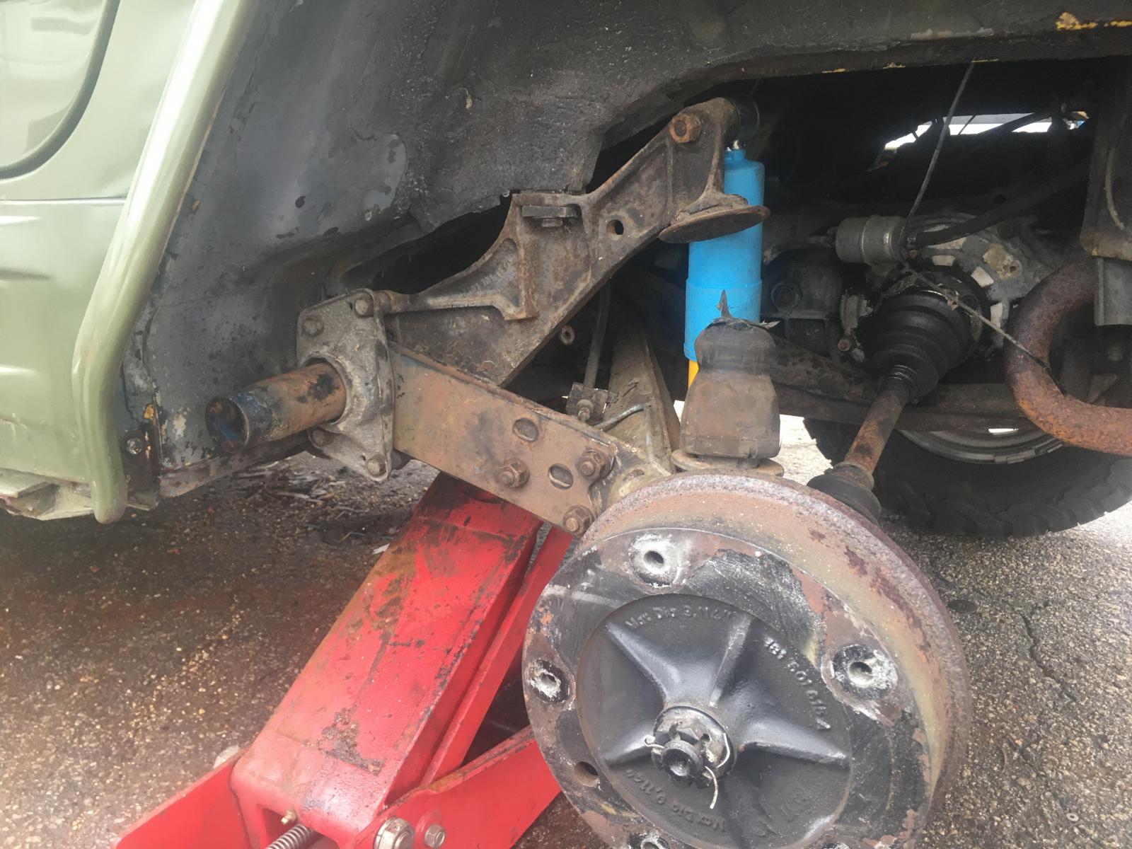

Today I tackled the driver side torsion bar & spring plate. I began disassembling & removing the old parts...
The spring plate on this side was seized to the torsion bar also so I wrapped the torsion bar with a shop rag, locked a set of vice grips onto that & then, using a c-clamp, secured the bar to the torsion housing.
I was then able to wiggle the plate back & forth to free it from the torsion bar an after unbolting the leading edge of the fender, I removed them both.

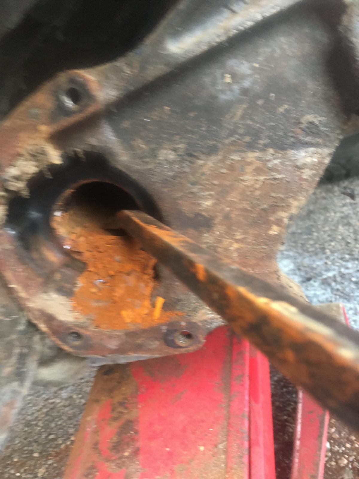

This one appears to have been submerged also, unfortunately, due to it’s being within sight of the coast, this was likely salt water. Evil or Very Mad (It was dry before I pumped it full of penetrating oil to help free up the seized splines.)
So I scraped & vacuumed out the torsion housing on this side too.

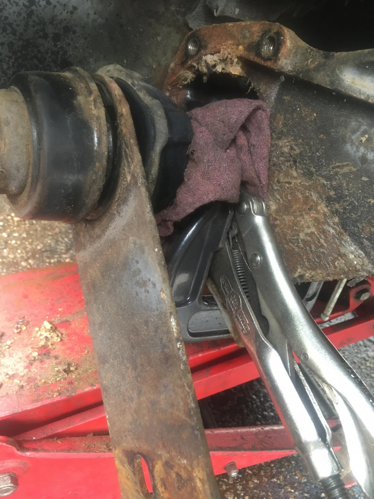

After Hoovering the crust out with the PVC pipe again, I zip tied a shop rag to the end.
And then, after inserting it all the way into the housing, I poured some Ospho into the pipe & douched out the housing.
With that done, & after letting it cure a bit with a fan aimed at the housing, I notched the spring plate on this side too & reassembled everything.
This is quite possibly the first Thing in the history of the world to be raised by parts scavenged from a Karmann Ghia. Laughing
Dammit, that tire not centered in the fender well is gonna force me to buy some extended trailing arms. Evil or Very Mad

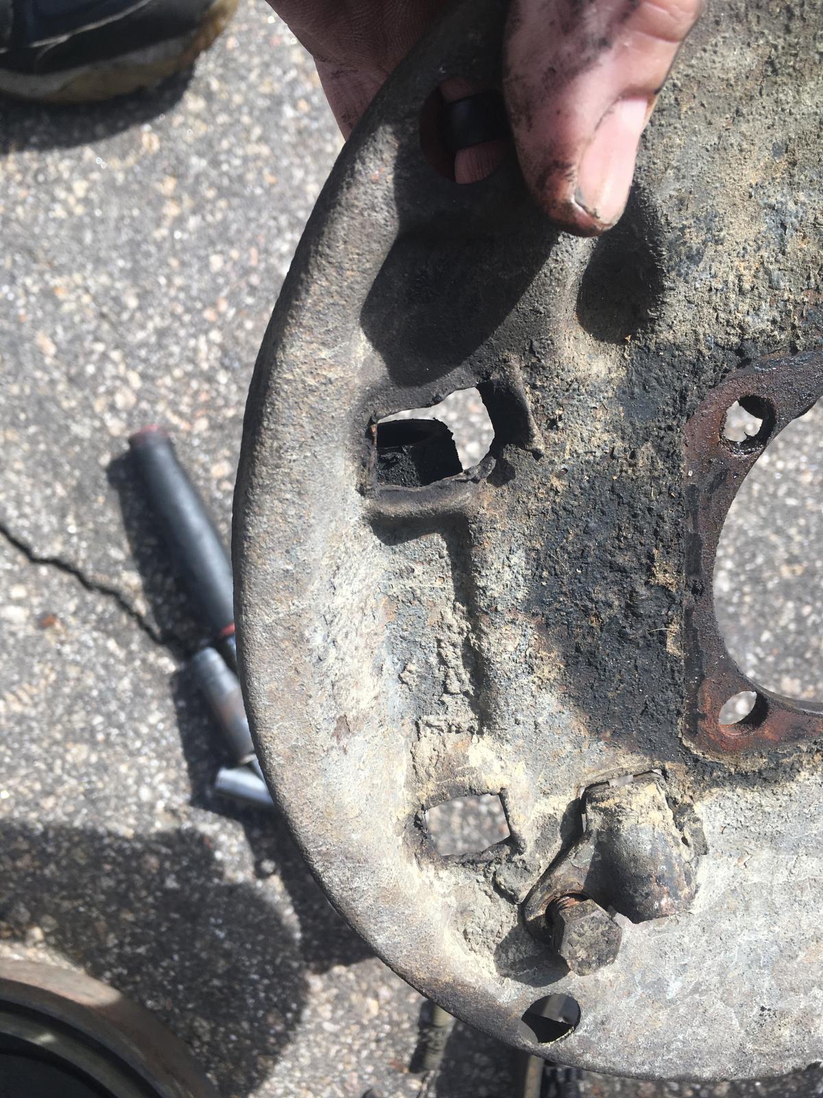

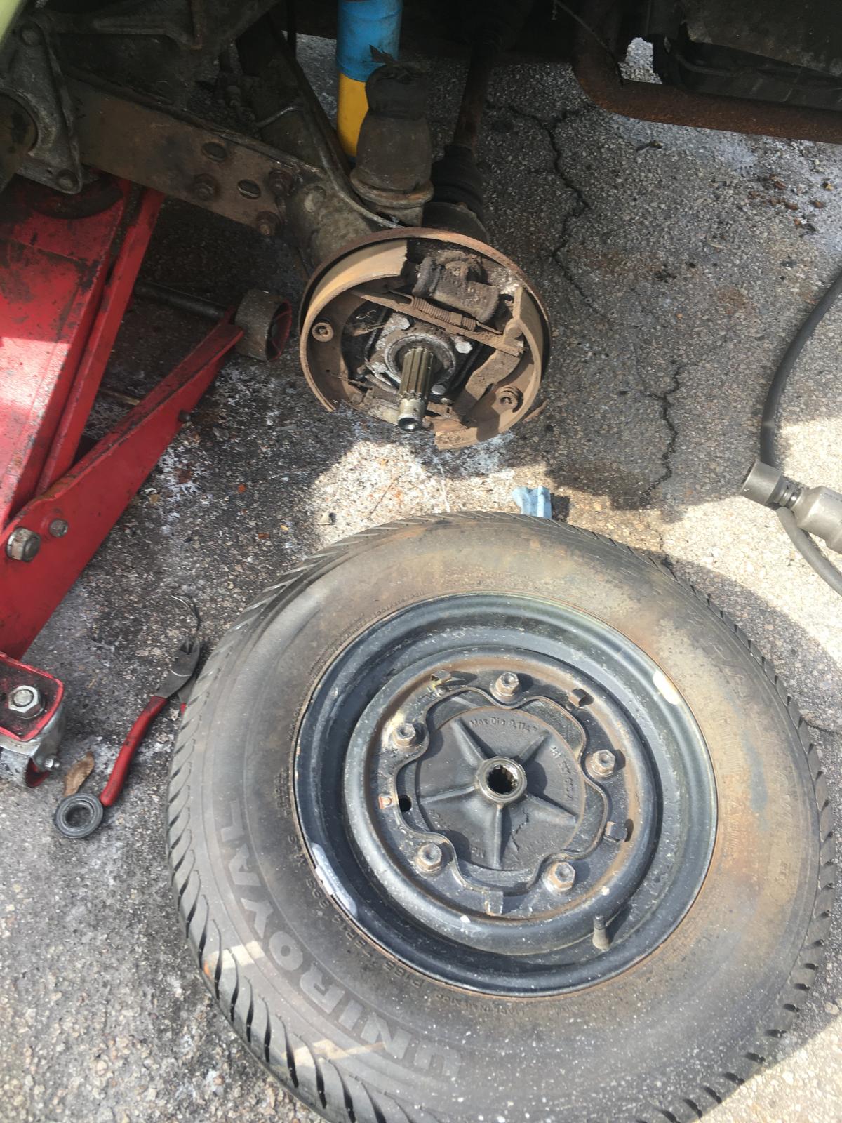

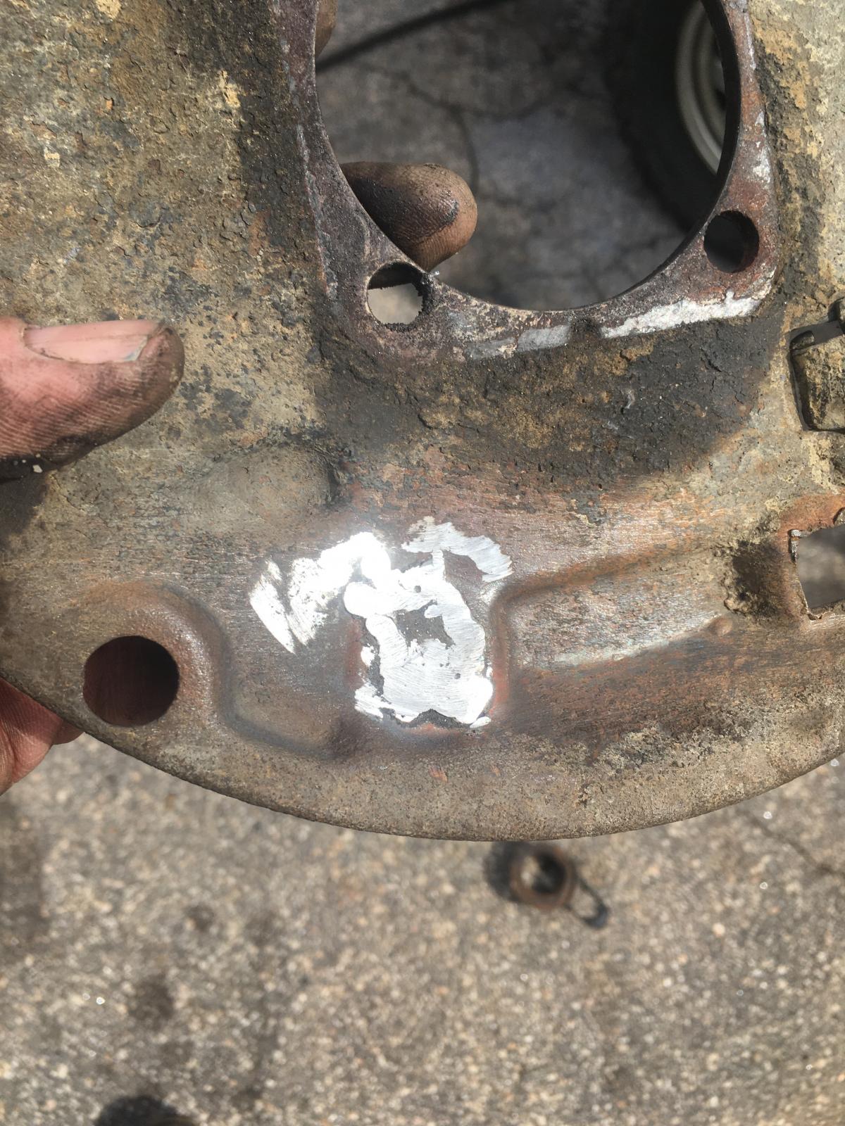

Today’s task was to make the last corner match the rest so I zipped the castle nut off & removed the drum.
After removing the old backing plate, I started to install the TypeIII plate, I decided to address the mangled adjustment holes. These had been irritating me the whole time they were on the Ghiapet, & knowing that I wasn’t likely to do something about it once the car was a driver, I grabbed a piece of scrap & started to make it fit & then fused it in place.
The second hole was just wallowed out so I closed up the diameter wit a bead, ground off the excess, & bored some new holes.
Once done, I bolted it up, reassembled the brakes, & slipped the drum on.
And here’s the beast on all four Marathons.

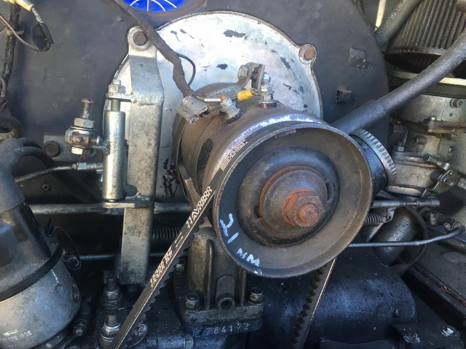

Today I opted to try to awaken the beast... Since it had been left dormant for a (considerable) amount of time, I removed the plugs, squirted to penetrating oil into the holes, walked the engine through by hand a dozen or so times & then cranked it to build up oil pressure, then I reinstalled the plugs & tried to light it off with some carb cleaner shot down the throats of the carbs.
After a few cranks, it stopped turning over. Evil or Very Mad Apparently the float on the driver side Kadron stuck wide open & flooded the left bank. So I yanked the plugs on that side, disconnected the electric pump, disabled the electronic ignition & spin the engine over to pump out the fuel. Once done, I pulled the dipstick & confirmed my suspicions.
Screw it, I stuffed the plugs back in, gave the carbs another shot of carb cleaner & fired it up. Well, it runs... but it made a shitload of noise. Confused Fortunately, this was “only” caused by a generator pulley that was incorrectly installed/tightened
& now useless.

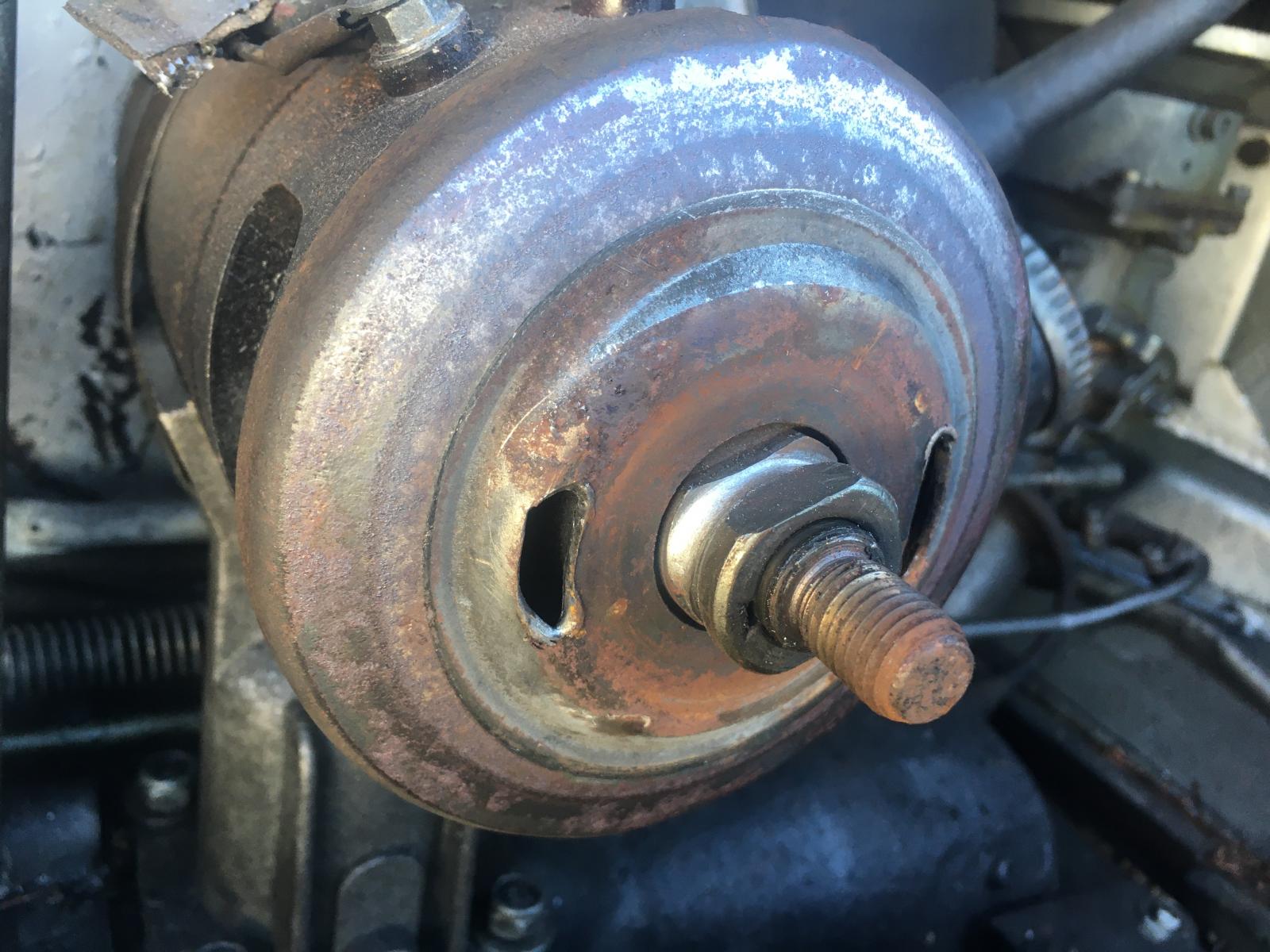

In addition to this, we have an incorrectly clocked generator on what appears to be an alternator stand. Knowing the shop that put this together, I’m sure to find all sorts of fuckery & shitty parts.
No matter, I planned on shit canning most of it anyway.

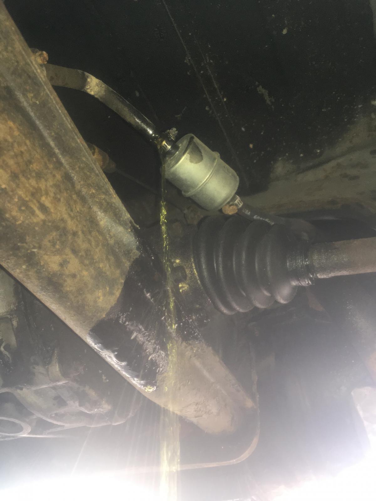

Today I began the process of removing the engine & began the Kadron exorcism.
Definitely a good place to start as all of the fuel hose was crunchy at best.
And since I couldn’t really plug it, I took the easy way out to drain the tank.

You could have at least press the hose tight (before the cut), so you don't have to take....a golden shower Twisted Evil Very Happy
