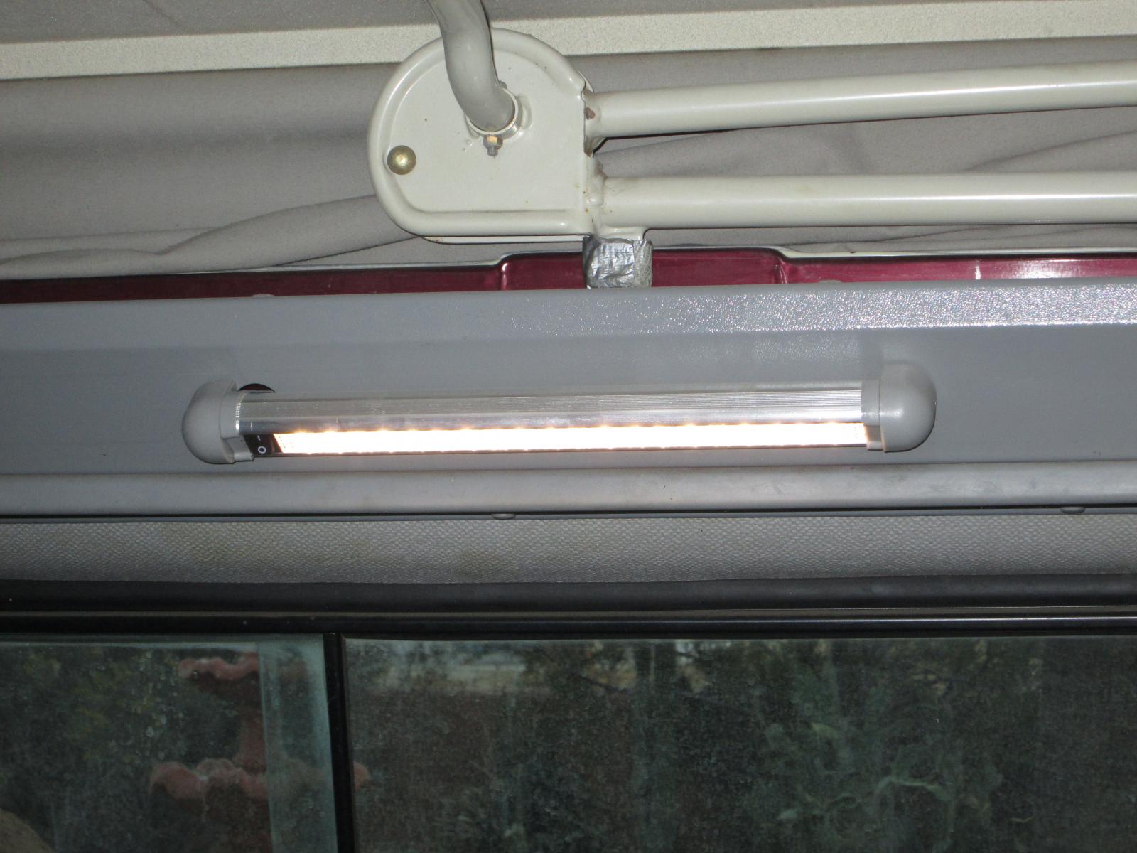

I have an LED tube light in my '91 Vanagon Multivan that looks very much like a florescent tube.

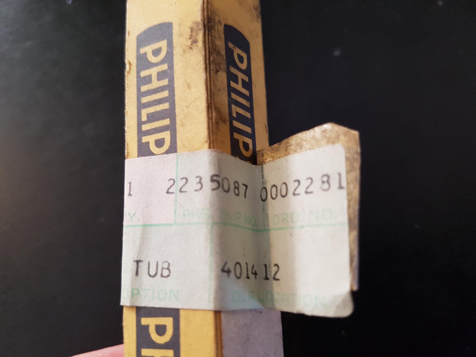

This may or may not help, but I have this in my stash:

PostPosted: Tue Mar 02, 2021 6:02 pm    Post subject: Re: Camper fluorescent tube over sink Reply with quote
mr matt wrote:
Wow, amazing you have that! is quite old.
What does it say on the tube end?
How long is it.... 12 inches?
Looked up the numbers, not expecting to find anything on the web, which I did not.
but there are 12volt tubes out there... did not research extensively...
https://www.amazon.com/Camco-54880-F8T5-Fluorescen...amp;sr=8-4
It's 11 7/8 inches tip-to-tip
The marking on the bulb itself just say 'Phillips' and 'Made in Holland' and 'TL', then something I can't really make out.

PostPosted: Tue Mar 02, 2021 8:49 pm    Post subject: Re: Camper fluorescent tube over sink Reply with quote
It's probably a standard T5 fluorescent lamp - F8T5CW, 12 inch, 8 watt, by Philips and others.

Wildthings
Joined: March 13, 2005
Posts: 52239
Wildthings is offline
PostPosted: Tue Mar 02, 2021 9:12 pm    Post subject: Re: Camper fluorescent tube over sink Reply with quote
Here is the LED striplight I have in my '91 Vanagon:

Telford, thanks for the further details, I've seen some like that but not running off of 12 volts. Mostly likely will be in a RV website store.
Led strip looks good! did you have to remove the ballast from your light?

Wildthings
Posts: 52239
PostPosted: Wed Mar 03, 2021 6:57 am    Post subject: Re: Camper fluorescent tube over sink Reply with quote
None run off of 12v, the ballast in the fluorescent fixture boost the voltage up to the several hundred volts the bulb requires. With an LED the voltage has to be dropped either in the bulb or in the fixture to the low voltage the LED diodes need.
The LED strip light I show above totally replaces the original fluorescent fixture and bulb.
