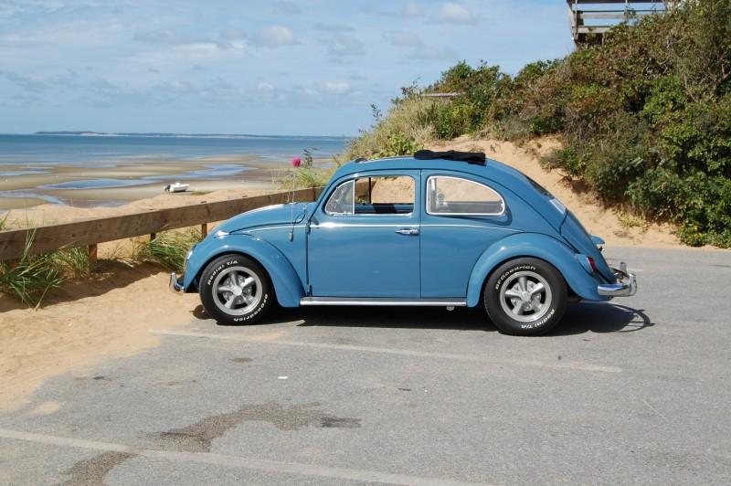

I run 155/80s on my 63. I'm running a lowered beam, but stock width. I'm sorry I can't really help you with your first question, but I only run BF Goodrich tires on everything I drive. Mine rub the fender if I hit a good sized bump at "speed". I just put up with it.
63 T1 Ragtop Gulf Blue
