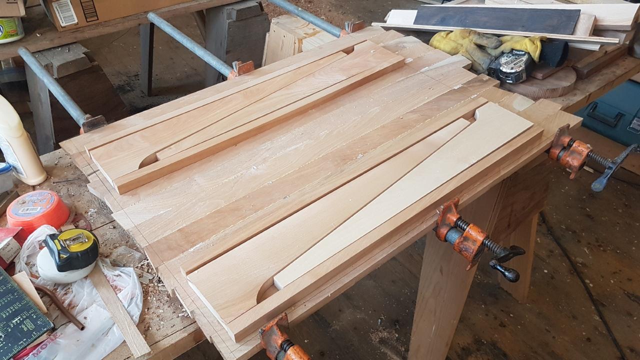

PostPosted: Mon Feb 22, 2021 10:52 am    Post subject: Re: Camper interior build on a 64 Kombi Reply with quote

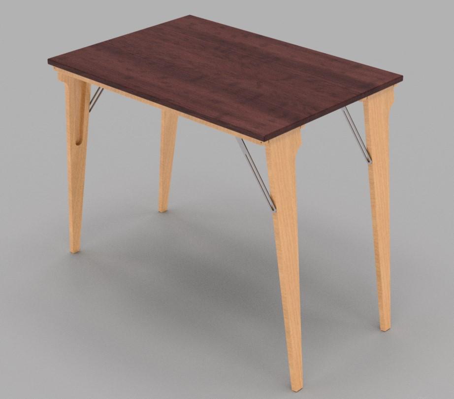

We need an outside table when traveling. Very nice to have a low table to cook or make coffee on. Also it will fit under the awning nicely when raining.
Need it to store easily and only spot was under the bench. I will add two runners at top so it slides in just below the bench so we only loose about 1.5" of storage height.
The top will be heart nut like the cabinet tops and birch legs. Legs will fold flat and I will likely add ball catches to hold them in. Top and legs will have some material removed for weight reduction.

sgellis wrote:
We need an outside table when traveling. ....
yep, looks like the drawing. nice

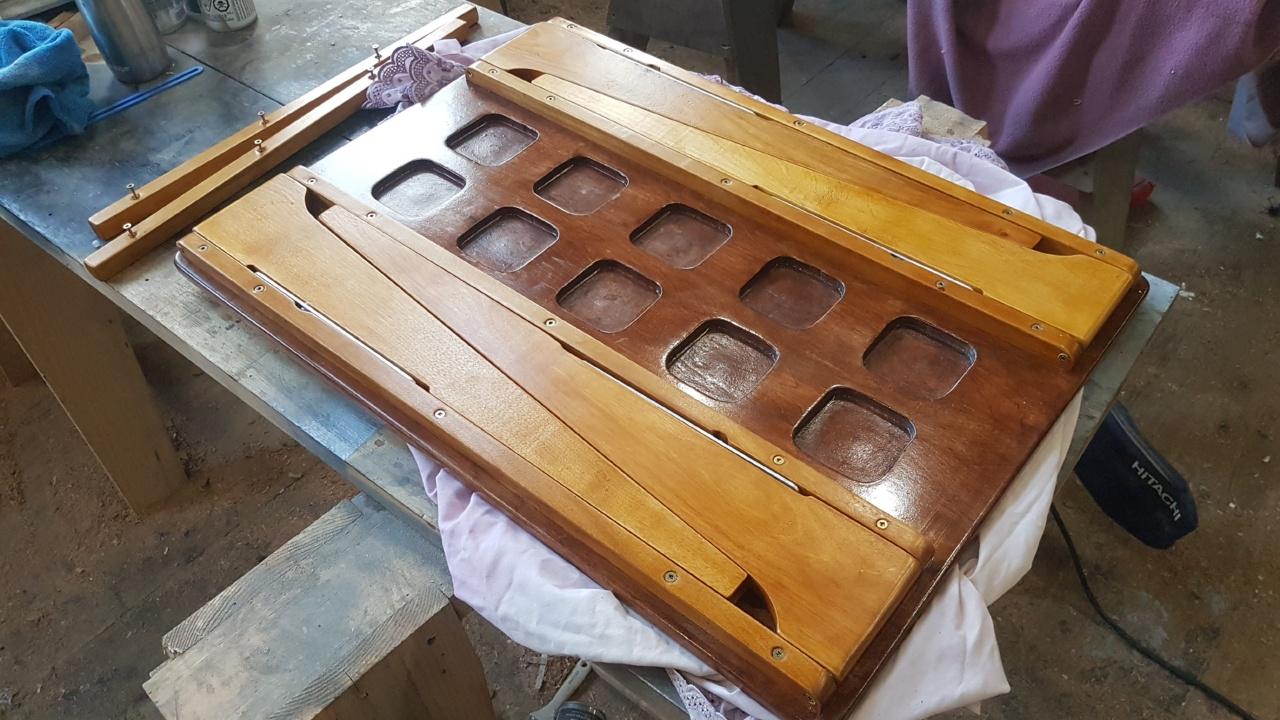

PostPosted: Fri Mar 12, 2021 6:07 am    Post subject: Re: Camper interior build on a 64 Kombi Reply with quote
Legs assembled but need to test fit a stay before notching them into the legs.
Routed out the bottom for weight savings. Will likely remove some material form the legs also.

mandraks
Joined: November 28, 2004
Posts: 7111
Location: Lawrenceville, Ga
mandraks is offline
PostPosted: Fri Mar 12, 2021 7:52 pm    Post subject: Re: Camper interior build on a 64 Kombi Reply with quote
speed hole are great for racing Wink

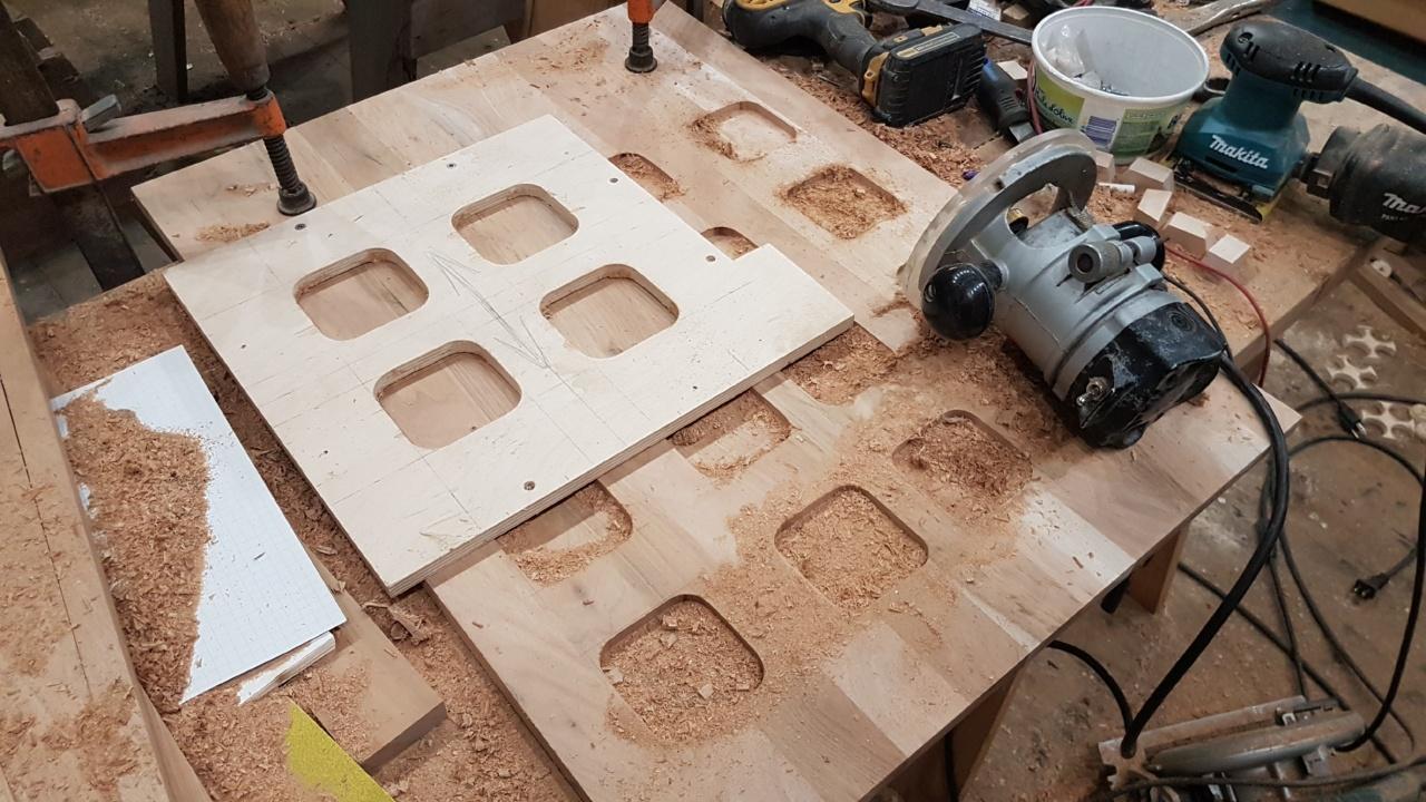

PostPosted: Tue Mar 23, 2021 4:47 pm    Post subject: Re: Camper interior build on a 64 Kombi Reply with quote
Getting closer. Took a little material out of the legs. Makes quite a difference.
Parts all sanded. Just need to check fit with the braces before adding the finish.

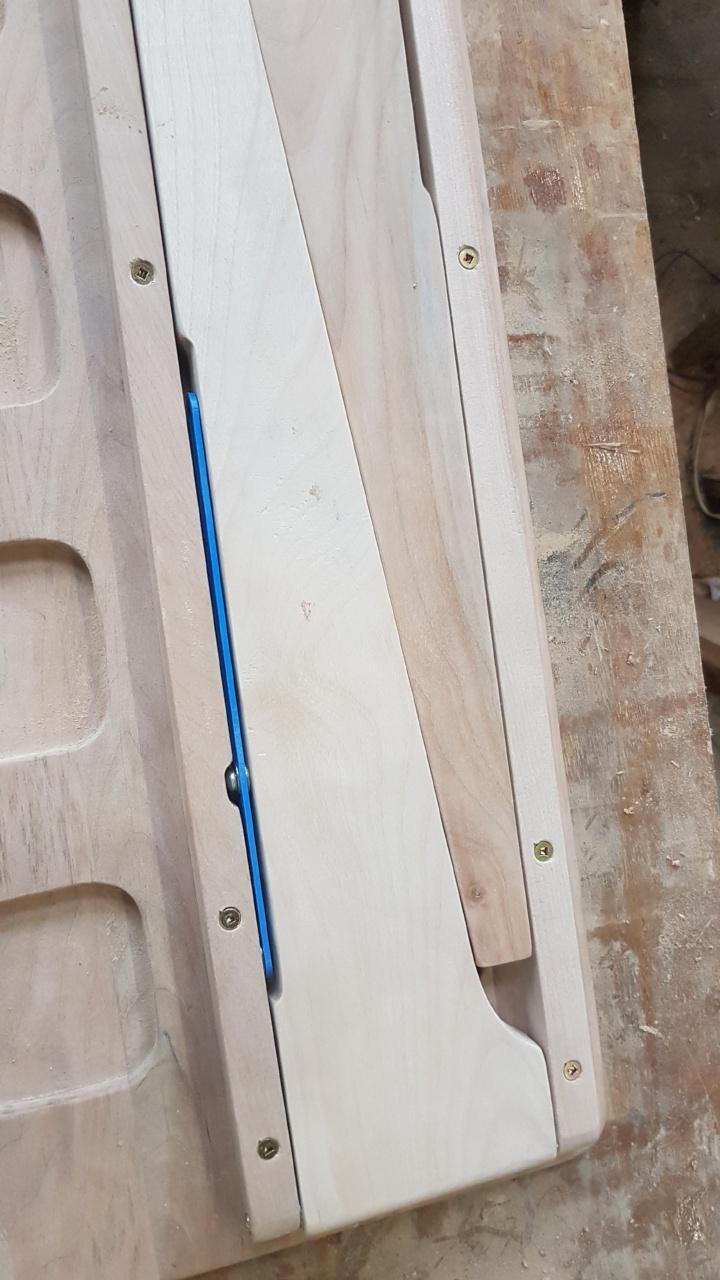

PostPosted: Sat Mar 27, 2021 9:07 am    Post subject: Re: Camper interior build on a 64 Kombi Reply with quote
3D printed a brace for fitting. Will get some aluminum ones made but haven't got to it yet.
Set up the table and like the height. Perfect for cooking on while sitting in a chair.
One layer of shellac on the birch and stain on the heart nut.

PostPosted: Sat Mar 27, 2021 10:25 am    Post subject: Re: Camper interior build on a 64 Kombi Reply with quote
Looks good. I thought you might have "sprung" the brackets to lock the legs into their upright position. How are you keeping the brackets in place?

PostPosted: Sat Mar 27, 2021 12:26 pm    Post subject: Re: Camper interior build on a 64 Kombi Reply with quote
That is a bit of an experiment. The legs go past 90 so will try to stay up. The screw will have plastic tubing around and the brace will have a narrow spot at end so screw should sort of snap past and hold.
If that doesn't work well then I plan to inset a spring behind the brace and bore into the brace enough for a cap screw to catch in. That will allow the brace to snap into place and require it to be pressed in to unlatch.

PostPosted: Sat Mar 27, 2021 12:58 pm    Post subject: Re: Camper interior build on a 64 Kombi Reply with quote
sgellis wrote:
Sounds like that will work. Stunning build on just the table. Having the right tools helps a ton!

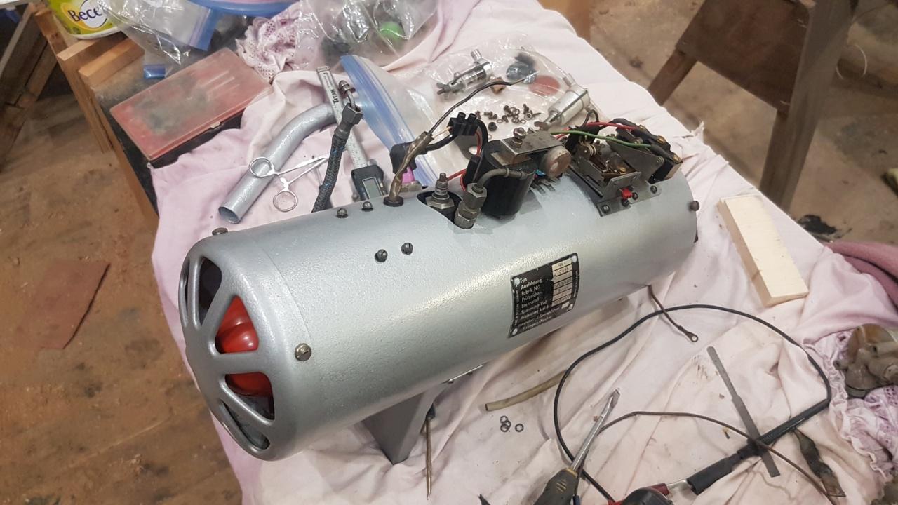

PostPosted: Mon Apr 05, 2021 5:10 pm    Post subject: Re: Camper interior build on a 64 Kombi Reply with quote
Time to get the BN4 running. Soon going to be camping weather though we did get snow yesterday.
First up is getting the metal cleaned up. Sand blasted and zink paint on inside of case. I found some paint locally for the case but not a great match. Will look for something else but need it before I can start assembly.
Exhaust is quite pitted but solid. Not sure there is anything I can do about the pits that will take the heat. Actually not sure how hot the exhaust runs on these.
Air intake needed a new flange. Made one out of 22 gauge steel. I will clean up the tube and fill the rust pitting.

PostPosted: Sat Apr 10, 2021 8:42 am    Post subject: Re: Camper interior build on a 64 Kombi Reply with quote
Found correct paint.
Primer over metal and then a very thin layer of paint. Basically misted it on. Soon as that was tacky I put on a thick coat. Very happy with it.
Now I can start assembly.

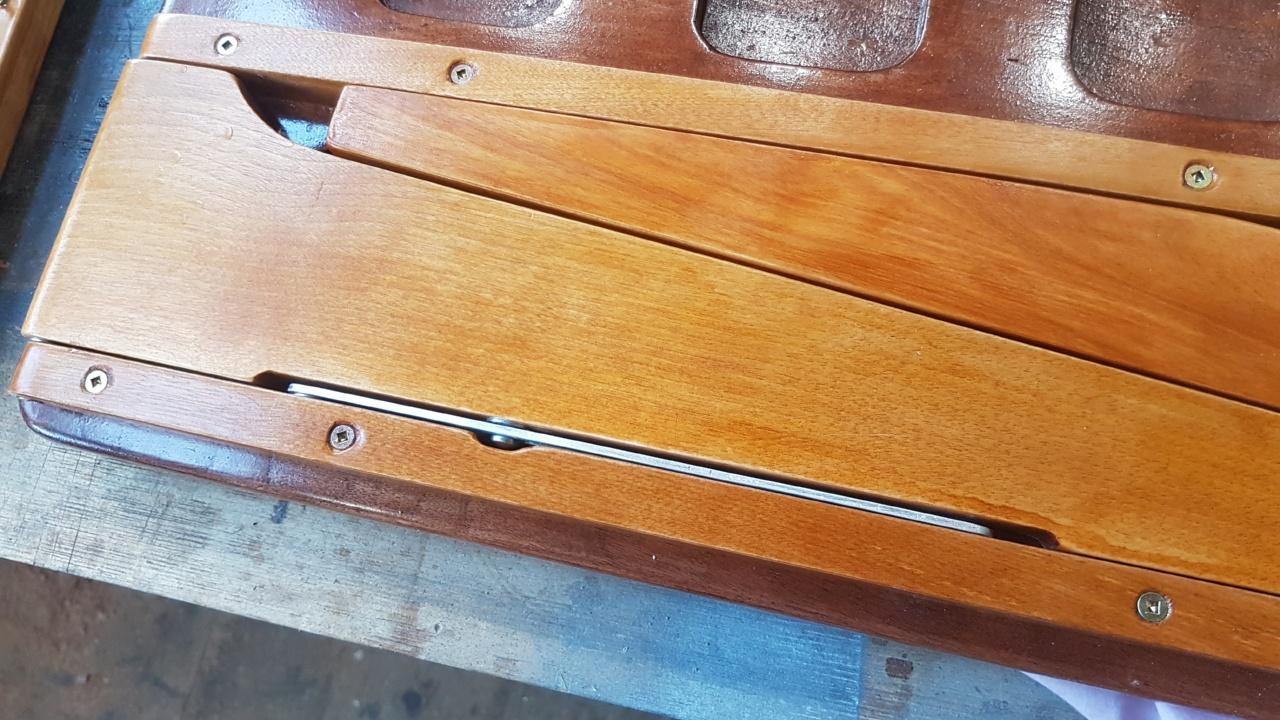

PostPosted: Tue Apr 13, 2021 5:47 am    Post subject: Re: Camper interior build on a 64 Kombi Reply with quote
Finally got the outside table top finished. Ended up getting almost done twice and had to sand it all down to clear wood and start over. Never had a problem with any of the other parts I finished.
Came out good in the end. Should get it assembled tonight.

PostPosted: Wed Apr 14, 2021 2:41 pm    Post subject: Re: Camper interior build on a 64 Kombi Reply with quote
Table done. That was more work than I expected. Very happy with it though.
Came in at 12 Lbs. I probably could have made it lighter but would have lost strength.
Legs snap in place quite well. I put a section of plastic tubing on the screw so it would snap past the narrow part in the arm.

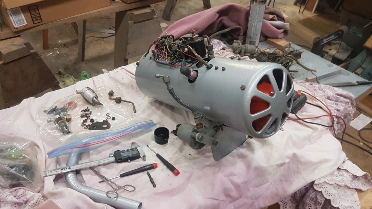

PostPosted: Wed Apr 21, 2021 6:03 pm    Post subject: Re: Camper interior build on a 64 Kombi Reply with quote
Started assembling the heater. Mostly just placing stuff and seeing what I need. Going to 3D print a rubber boot for the spark plug and for around glow plug/jet.
I will cut the braded fuel line out and replace with new fuel line. Hate to do it. It looks great but no way to tell how long the old rubber inside will last. Also not sure what clamps to use on the new tubing. One old heater had twisted wire for clamps. Maybe I can find crimp rings in the correct side. They would look much nicer than worm gear clamps. Not sure spring clamps would hold.
