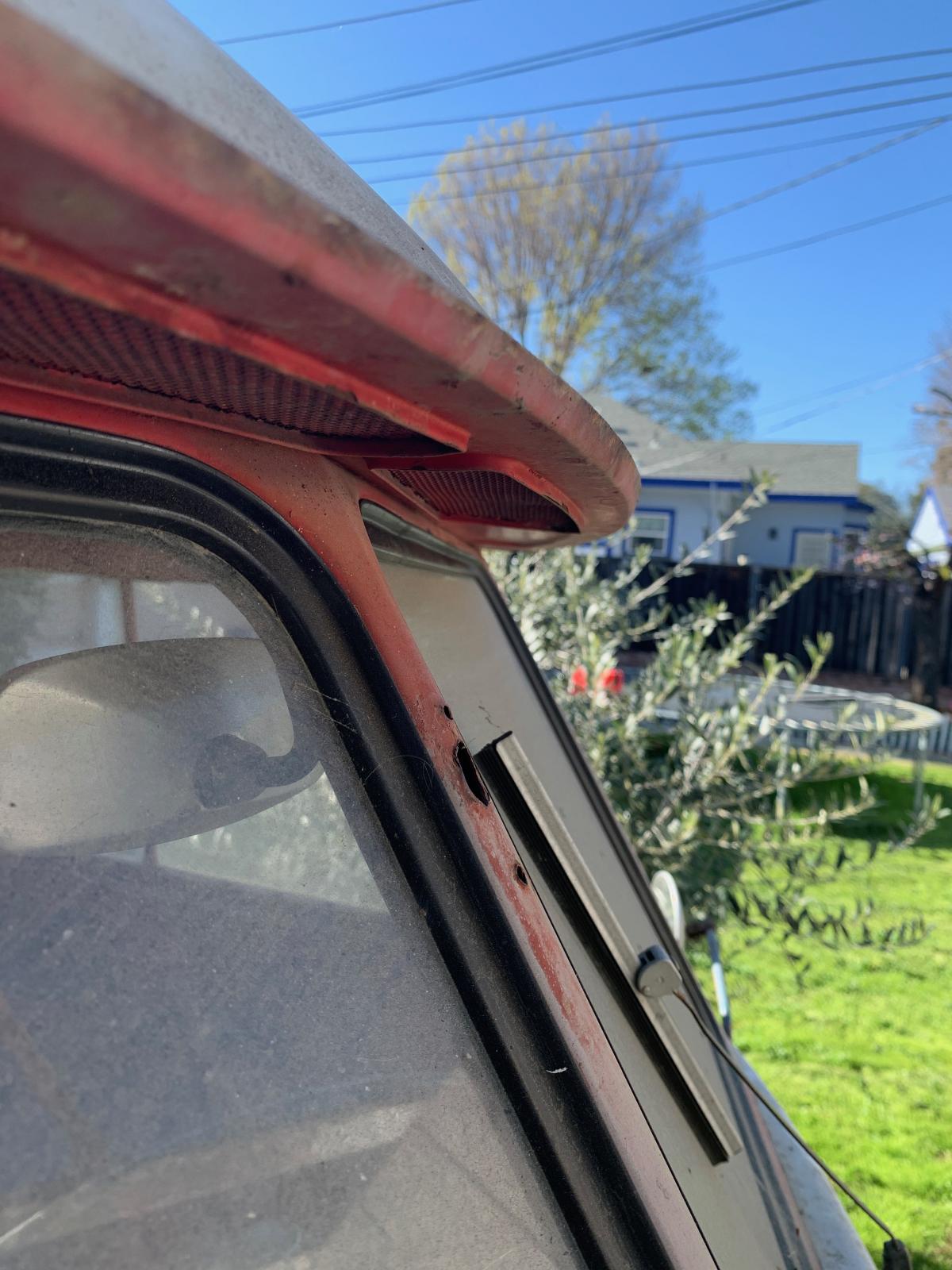

I bet it was the location for a spotlight.

PostPosted: Sun Mar 14, 2021 10:30 am    Post subject: Re: Bob's 1959 Single Cab Pickup — "Otto" Reply with quote
easy e wrote:
I bet it was the location for a Unity spotlight.
https://www.unityusa.com/thumbnail.asp?file=assets...amp;maxy=0
bobrk wrote:
Another mystery on my truck is this antenna mount. It looks like they had it mounted between the windshields. Seems like it had a very weird angle to clear the top. Maybe it was a CB radio with one of those swiveling mounts?
Actually, that was always an option in my mind as well! Thanks for the pic, it looks exact.

PostPosted: Sun Mar 14, 2021 12:06 pm    Post subject: Re: Bob's 1959 Single Cab Pickup — "Otto" Reply with quote
I'm going to keep an eye out for one, that would look badass.

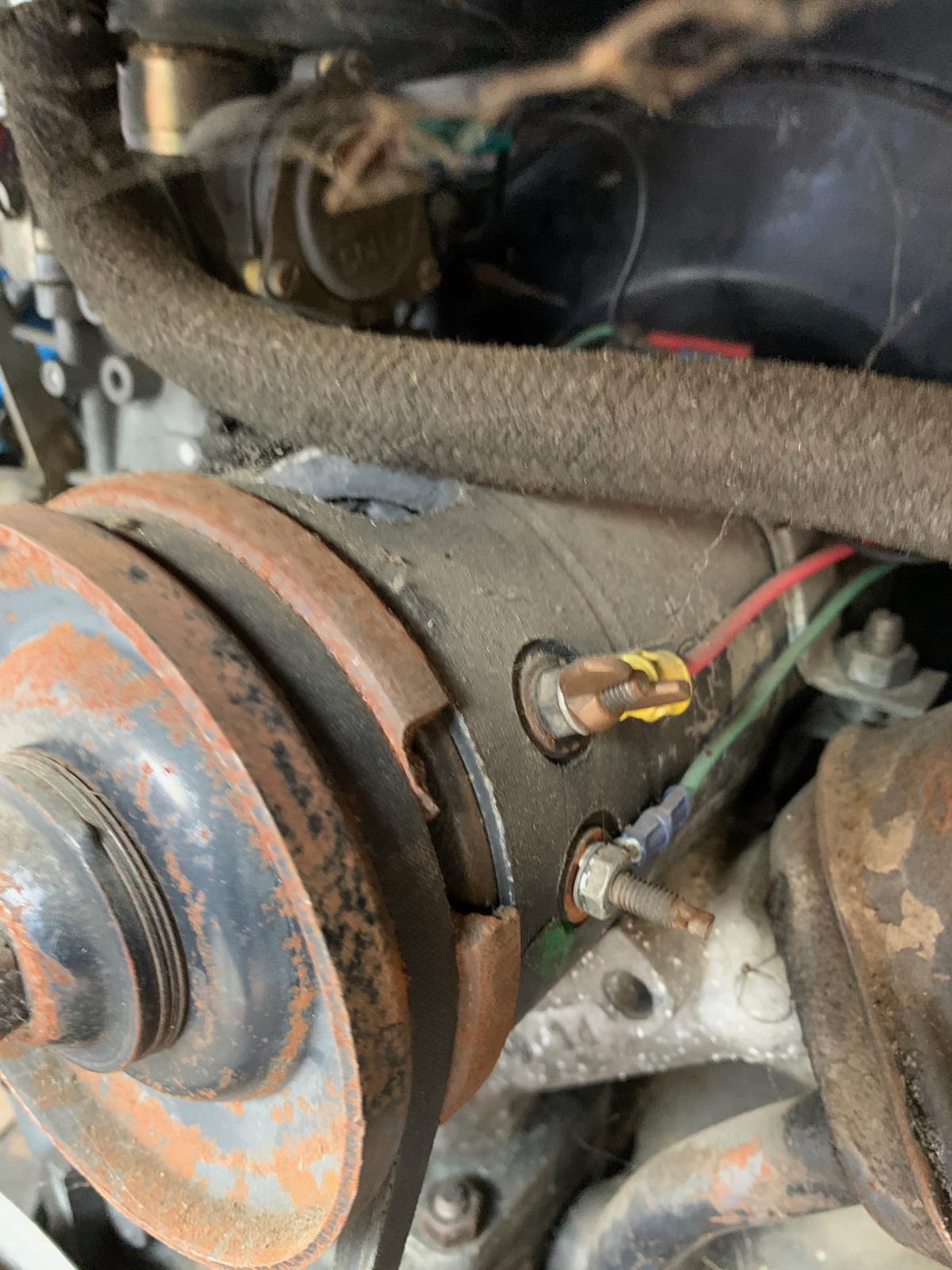

Some days, you want to work on your truck but you're not sure what you want to do, so you just poke around and do stupid things like uncover it so you can look at it and just wash the windows.
Here are some pics from my spelunking...
I think all the glass is OG, a combination of Delog windshields and Sekurit side and back windows. And I just looked up "ver bund" and it means composite, which makes sense for a laminated windshield.
Thought I'd go look at the engine and was gratified to see that not only did it still have oil in it, it even turned, so I'm optimistic that it will start after 20 years with some careful preparation.
Brazilian carb?
Voltage regulator? And some solenoid...
12 Volt generator...
Also, it's an "H" engine, will have to look that up.
Thanks to this site, I know it's a Sep 65 1500 block.

PostPosted: Thu Mar 25, 2021 6:12 pm    Post subject: Re: Bob's 1959 Single Cab Pickup — "Otto" Reply with quote
There's a black widow in your brushes. Can't say I've ever seen a pulley broken like that before. It looks like it's cast iron.

PostPosted: Thu Mar 25, 2021 7:29 pm    Post subject: Re: Bob's 1959 Single Cab Pickup — "Otto" Reply with quote
Good eye. I didn’t even notice.

PostPosted: Mon Mar 29, 2021 6:17 pm    Post subject: Re: Bob's 1959 Single Cab Pickup — "Otto" Reply with quote
That is a 38 amp gen from your Kazbus.
The 38 amp is more powerful than the 30 amp found on Bugs.
Also the backing plates are different because the 38 amp Gen is longer.
There is some damage to that pulley, but completely useable.
It's OG german cast, and BETTER than anything you can get now.
Good Luck
Al

PostPosted: Mon Mar 29, 2021 6:30 pm    Post subject: Re: Bob's 1959 Single Cab Pickup — "Otto" Reply with quote
Always make sure when working on the gen or alt pulley, that the screwdriver used to lock the pulley from turning is kept pointed at the pulley nut you are loosening or tightening. Allowing the screwdriver to tilt at all will result in cracking out chunks from those cast pulleys or bending up the pressed pulleys.
It might be a 38 AMP gen, but have seen those from the FLAPS rewound into a 30 AMP gen instead.

PostPosted: Mon Mar 29, 2021 6:49 pm    Post subject: Re: Bob's 1959 Single Cab Pickup — "Otto" Reply with quote
Naw, that gen was out of an untouched one owner 1969 camper that I had for a while. I’m assuming the pulley was from the truck. I’m gonna change that belt, though and will inspect that pulley at the time.
