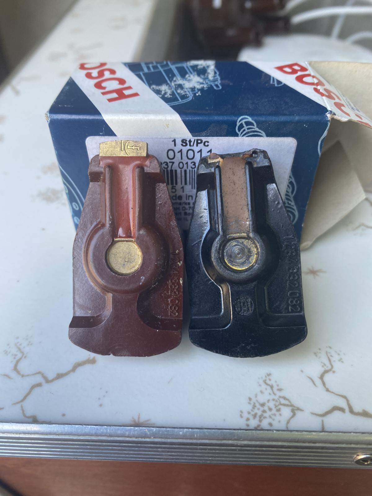

We’ve been out adventuring for a while now that we’ve upgraded the charging system and cleaned up the auxiliary fuse panel and wiring along with the fresh water tank and intake/drainage lines with a minimum of holes in the new floor. Whereas before every wire had its own hole, we’ve gotten it down to four holes total for everything. The largest is only 1 1/4”. Before, there was only one grommet and that was a piece of fuel line. Now, every hole is grommeted. No pics yet but overall it feels really good driving around with all the weird systems fixed and the floor not threatening to rot out from under us. Infinite credit goes to Capt. Skills for his masterful metal work.
We’ve only had one silly misadventure on our trip so far. Well, two if you count the fact that we put on what we didn’t know were aftermarket valve covers that didn’t fit for shit and leaked oil all over the street. Or three if you also count that after replacing one of the taillight housings we got the wires mixed up and didn’t have a right turn signal with the headlights on. The bigger one was an irritating miss at high RPM and cruise that emerged about an hour into our first drive. For some reason I looked in the distributor first and found that the tip had disappeared from the end of the rotor! Check out that one on the right. I found the tip in the bottom of the distributor. Fun times.

Holy smokes! It's a bit hard to read but are they the same part number?

Yeah, they’re both Bosch and the same part # but I don’t have the original boxes for either of them to know where/when they were manufactured. The broken rotor has probably 20k miles on it.
