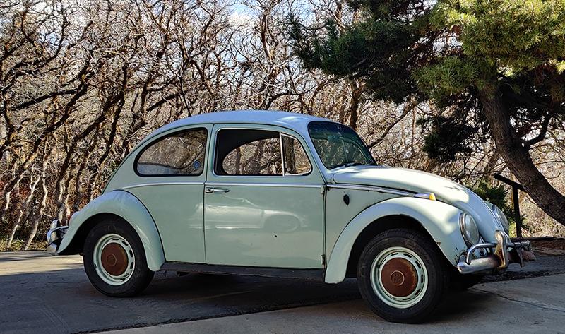

My son and I picked up a 73 Super last year and had so much fun we decided to take on a bigger project and do a '66. I had a Bahama Blue '66 when I was in my 20s. So, we kept a eye out for one. Ended up buying one off the here in the classifieds that sounded like it was in ok shape, other than the engine. I had a buddy at work that had a engine we could have. Not sure how the engine will run. We have not removed or installed a engine yet, but it looks like it will be pretty fun.
Got started with ... Steering wheel horn bar, new glovebox, rekeyed locks - we took off all the locks (doors, engine deck lid, and ignition) and sent them all to SteelersBus here on the Samba to be rekeyed to all be on one key, and added some LED tail lights.

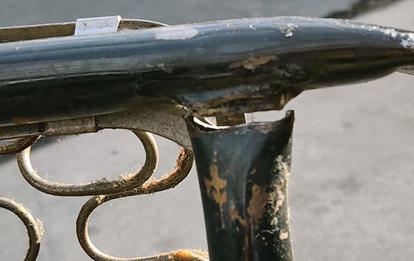

Got the seats out and stripped. I think we should be able to weld these. Pretty sneaky of me to tell the kid to sign up for a welding class at school this year, eh?

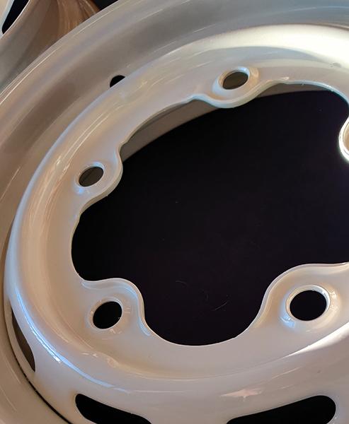

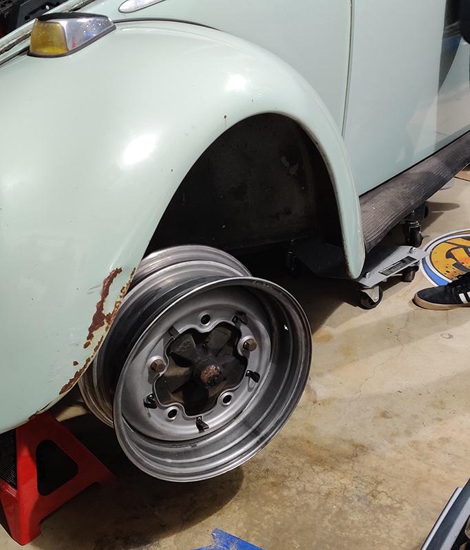

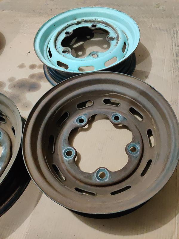

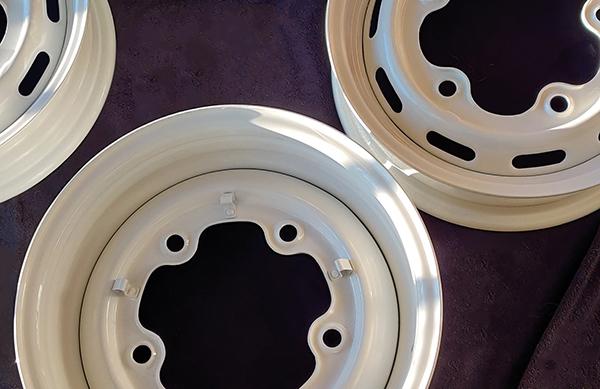

We picked up some 15x6" wheels from Joe (vwdeepwheels). We took our wheels in and got them sand blasted. Went with a older vw "arcona white" color. Keeping the old wheels for snow tires.
New Wheels
Painted
Original Wheels
Painted
Going to switch it over to disk brakes+ a narrowed adjustable beam up front.

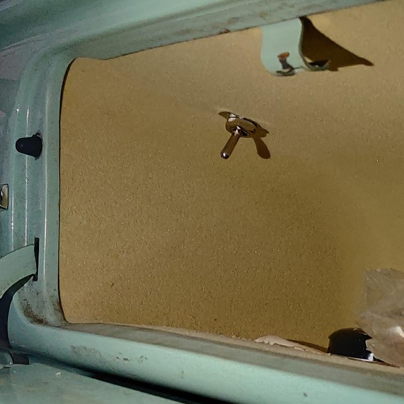

My son really wanted a kill switch. So ... we added a kill switch to the glovebox.

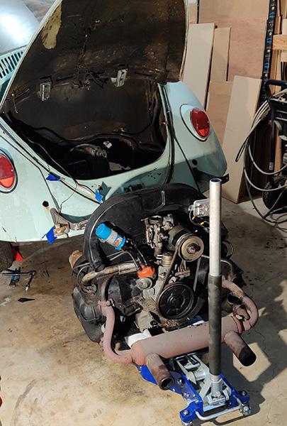

Did our first engine pull this engine this weekend and started to clean up all the tins, heater boxes, and muffler to put on the new engine. Had a leakdown test done on the new engine. One cylinder was at 55. The recommendation was to drive it for a while and see what happens. Rolling Eyes
Solex carb. Smile

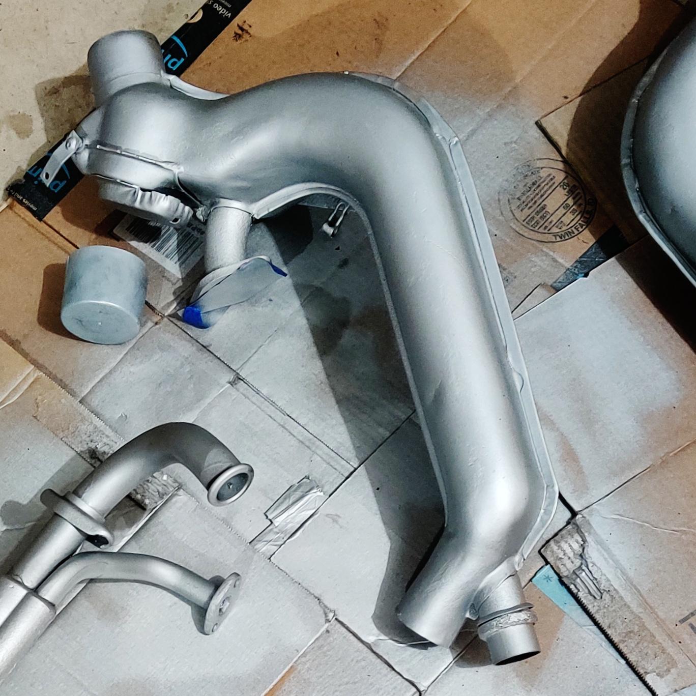

The muffler seems crusty, but ok. Is it possible / worth it to have this blasted and repaint it?
Does anyone have any tips for removing a extra stuborn distributor? Question

Got the seats fixed up. I knew that welding class would pay off! Laughing

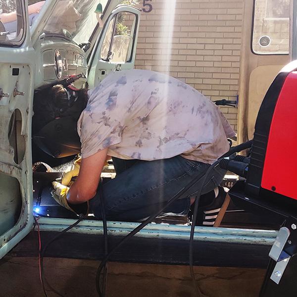

- Got the floor pans cleaned up and patched all the holes. Its a weird feeling to cut a big hole in the floor of your car! Lol

Loosen the clamp so that it can be rotated out of the way and spray PB Blaster on the housing shaft. Tap upwards gently with a hammer more for creating vibration than forcing it up. Grab the distributor with both hands and pull up and twist back and forth at the same time.

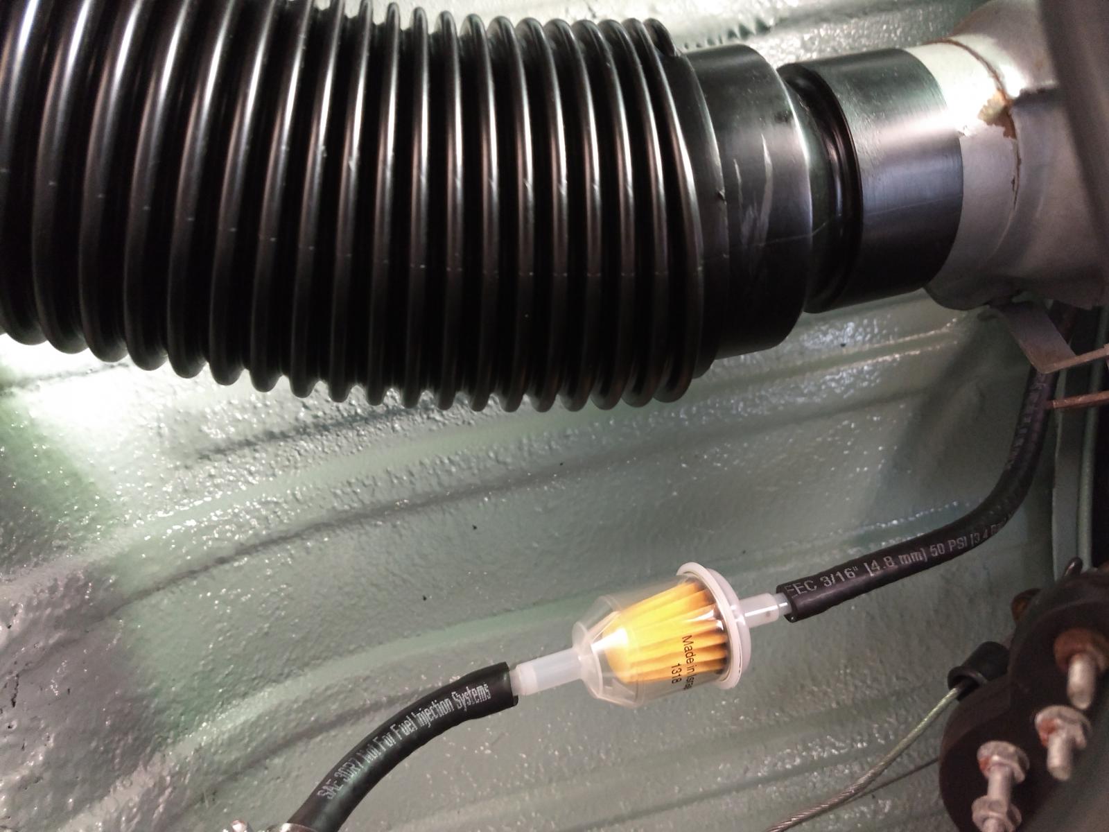

You're going to hear, if you haven't already, about moving the fuel filter b/o risk of fire. I moved mine to underneath.

This was one of the first things I bought when I went about with my restoration.
https://www.pandraggers.com/product-page/pandraggers-fuel-filter

tasb - Thanks! I will give the hammer tap a try. I have been hitting it with PB Blaster for about 3 weeks now. It will turn, but not pop out. Smile
bigdog1962 and car_cursed - Thanks! Yeah, I planned on moving that fuel filter. I just want sure where to move it to. On our 73 we have it up front, but that wasnt a option on this car. So, thanks for the suggestions! Going to order that bracket right now!
EDIT: Fuel Filter Bracket - Out of Stock! Its on the list. TY Smile

@car_cursed: Was able to get a Fuel Filter Bracket. Thanks again for the tip.

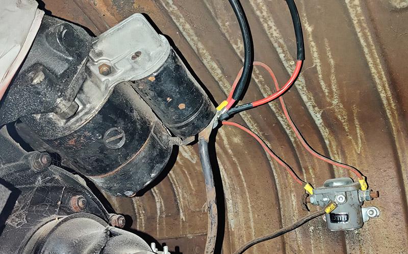

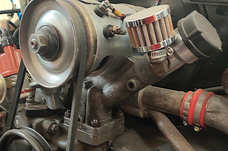

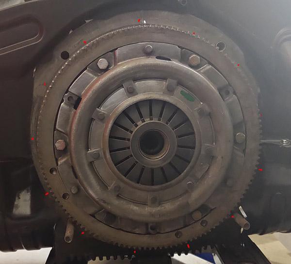

We are going through and rewiring the car right now and I ran into a couple questions. The PO had the car had converted over to 12v. From my searches it looks like it has a hard start relay.
Does this mean the starter is a 12v starter?
Should we ditch the relay?
The old engine had a generator stand, but it looks like the new engine has a alternator stand. We will be running a new stereo/amp/speakers setup. Would switching to a alternator make sense?
We have a 12 Volt flywheel.

The PO had the car had converted over to 12v. From my searches it looks like it has a hard start relay. Should we ditch the relay? From my reading it sounds like they tend to be a band-aid and really shouldnt be needed with all new wiring. We will be removing the relay. If we need to add one back in we can do that. Rolling Eyes
Does this mean the starter is a 12v starter? Cleaned the gunk off this to make it readable, its a 12v starter. Smile
Going to get up and running, then switch out to a alternator. For anyone reading this thread --> Ended up finding this good thread.
Generator vs Alternator with small sub and speakers
Bonus ... I think the PBblaster finally worked its magic and I was able to pop the old distributor out of the original engine. Exclamation
EDIT: Can anyone tell me if the steering box coupler should be splined? I have looked at quite a few pictures and it looks like a new chrome empi is splined to fit the steering box, but I found a pic here in the gallery that looks the same as mine and does not appear to be splined, just a pinch clamp. Question

I have a hot start relay in my bus. It’s not a bandaid, it shortens the amount of travel the power has to go.
