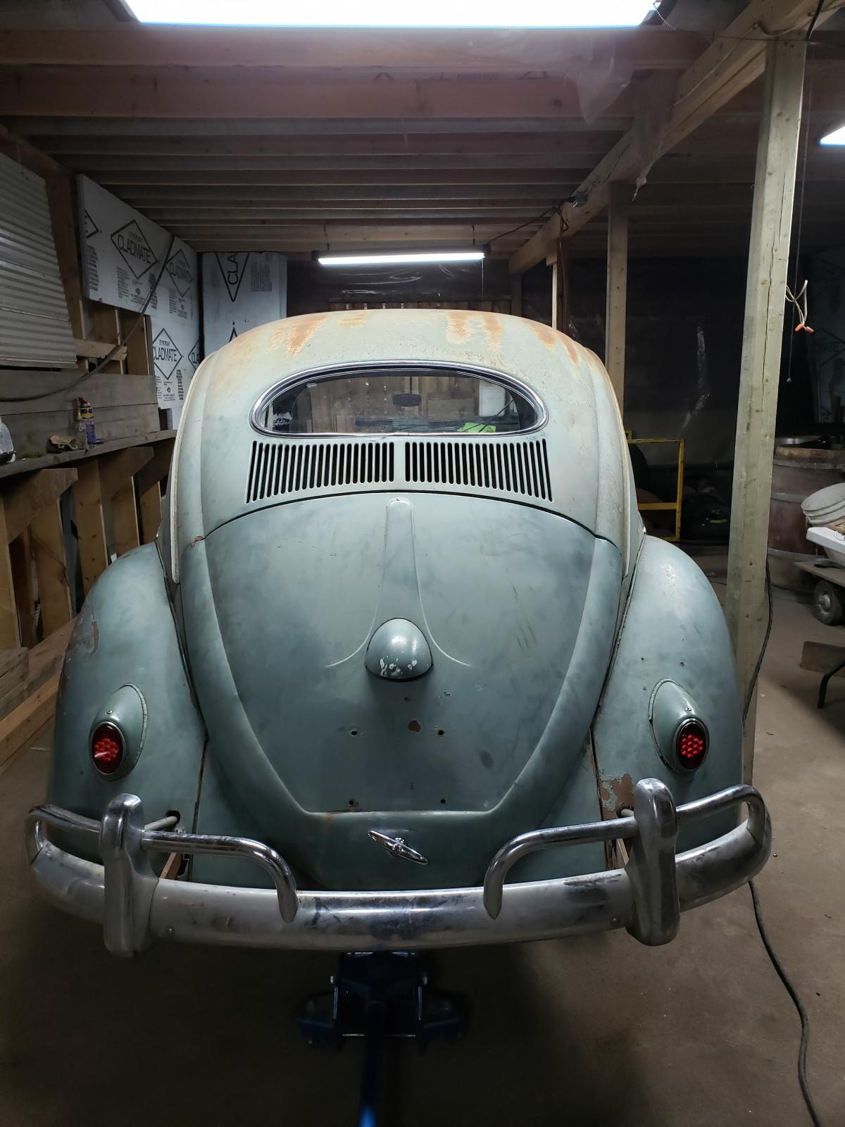

Getting somewhere
Rebuilt Brakes, steering, link pins, King pins, axle boots....
Needs:
Keys to match ignition (how?)
Turn signal lever
Bullet turn signal assemblies
Engine rebuild haha
Wiper arms and blades
And some new tires. Should be ready soon, just need to t. Sort out the engine... Rebuild or replace

Ok so tires coming tomorrow, then it just needs inspection, insurance, registration, and a clear path to get it out of the back end of the shop.
We got lucky and a local was selling 1956 36hp engines that had been in service as fire pump power plants in Germany. He's had a few shipped over. While kinda expensive, this thing fired right up and runs like a sewing machine. It's a beautiful engine really.
Hope to be on the road in a week

Oh yeah the hood color is funny, it was hail damaged and bondo'd over in the past so we cleaned it up and the color you see is actually just the self etching primer I had sitting around, not a bad color match hey hahaha

PostPosted: Sun Apr 25, 2021 11:08 pm    Post subject: Re: rebuilding a barn beetle - '57 Reply with quote
I do have a W deck lid for it, but it needs work and isn't the right color
But we'll set it aside, in the event this car ever goes in for a repaint.
It's obvious some 70% of this car has been repainted in the past, and probably was rear ended as well resulting in the rear apron being welded on a little askew and the incorrect deck lid.
We're just going to enjoy it for what it is, probably will never get a full restoration.

PostPosted: Mon Aug 02, 2021 2:40 pm    Post subject: Re: rebuilding a barn beetle - '57 Reply with quote
Registration and insurance done, passed the "out of province" with no issues
