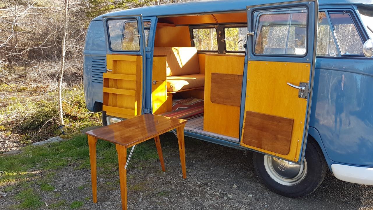

Got the bus out of storage today.
Mounted the table under bench. Fits perfect and doesn't rattle. Very happy.

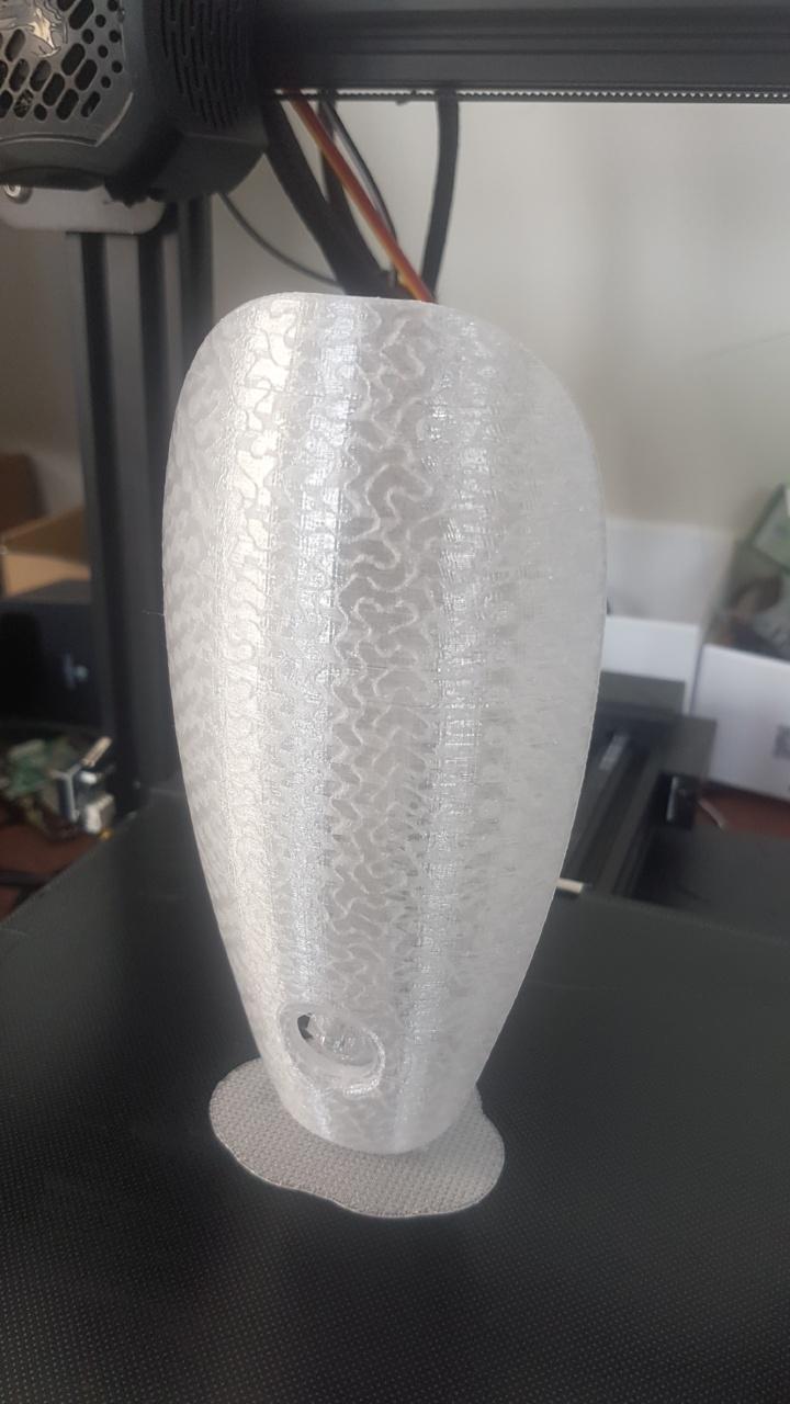

New side light lens printed. Very happy with this one.
Used a new filament. A clear PETG from Polymaker. looks great and prints nice. Light lens is clear but LED is warm so gives it a nice yellow look when on. Walls are one layer thick. The pattern is from the 15% gyroid infill and I quite like the effect. Didn't think it would look that good.
The lights have 4 levels of brightness. Each tap goes up a level and holding switch shuts it off so at night we can give it one press for dim light and press and hold to turn off.
Now printing second and eagerly waiting for dark to see how they look. Smile

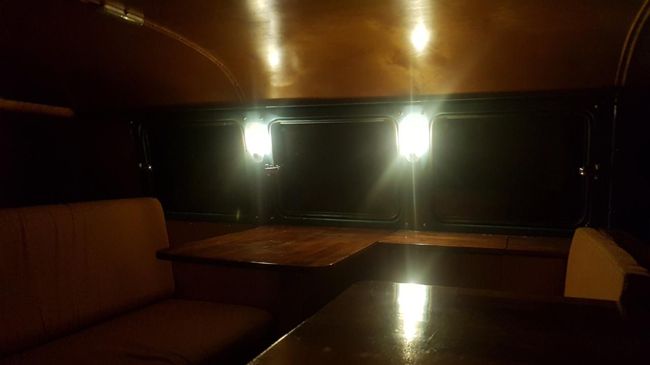

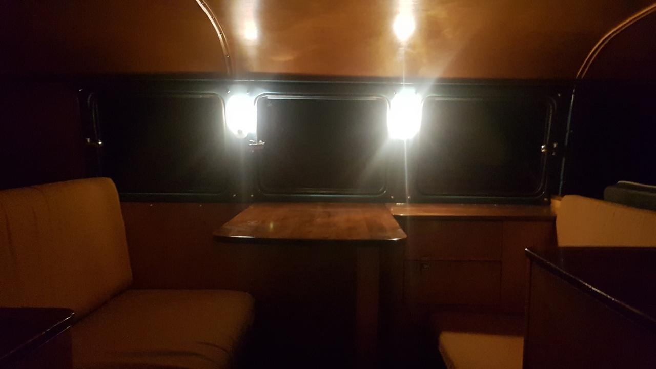

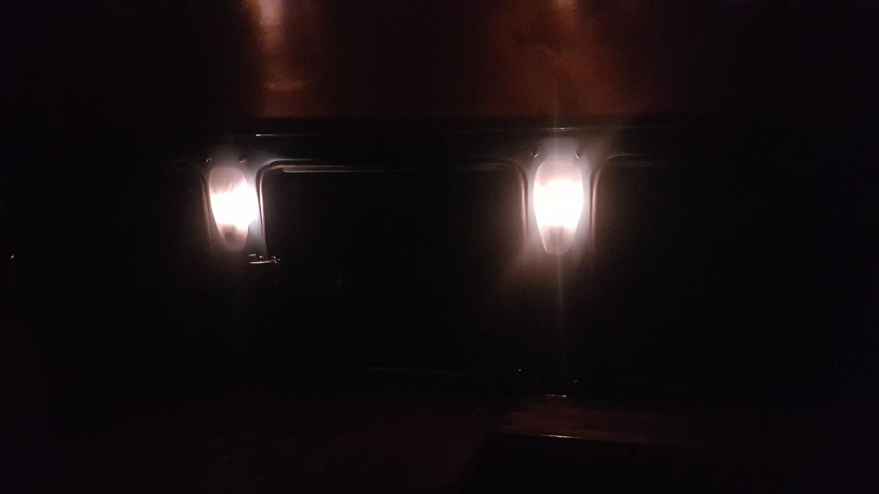

Second one in and got to see how they are at night. Love them. They do a good job of defusing the light but doesn't show well in the photos. On lowest they just have enough light to see.

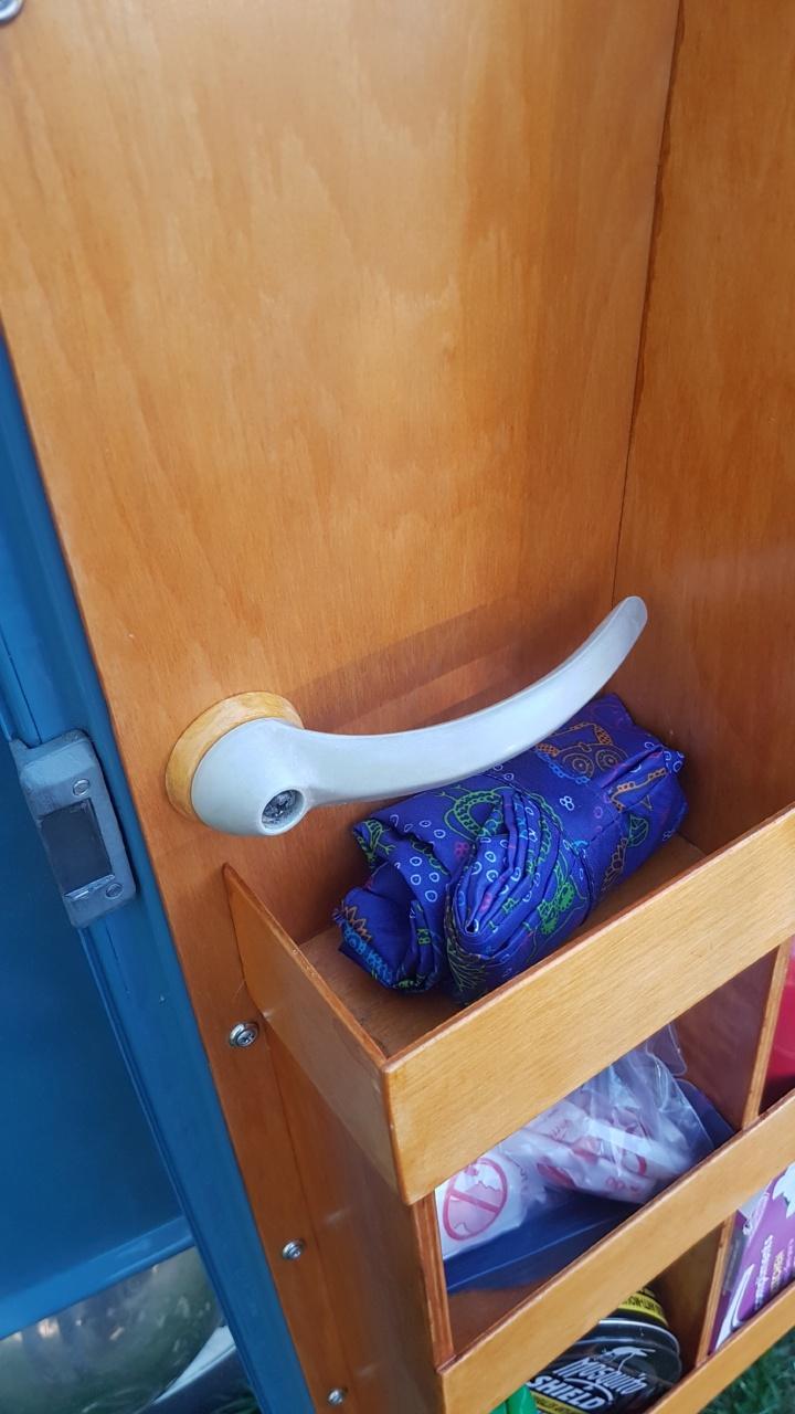

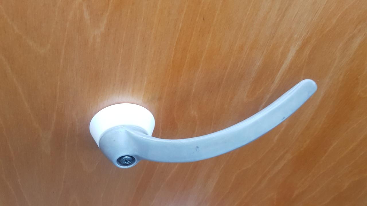

Printed some custom escutcheons. The wood door panels did not like to be spaced out at handle so made some thicker escutcheons. I didn't have good originals anyway. Also printed a thinner one for the rear door
Cream color is too light. I may try amber shellac on one to see what happens.

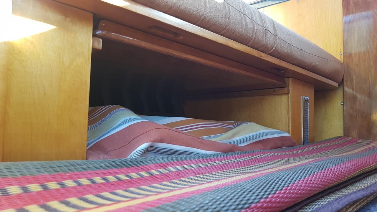

Cleaned the inside today so got a few photos

SplitBusVanatic
Joined: August 16, 2005
Posts: 351
Location: Co. Mayo. Ireland
SplitBusVanatic is offline
PostPosted: Sun May 16, 2021 1:08 am    Post subject: Re: Camper interior build on a 64 Kombi Reply with quote
Gosh. That’s beautiful. It’s a credit to you. Well done.

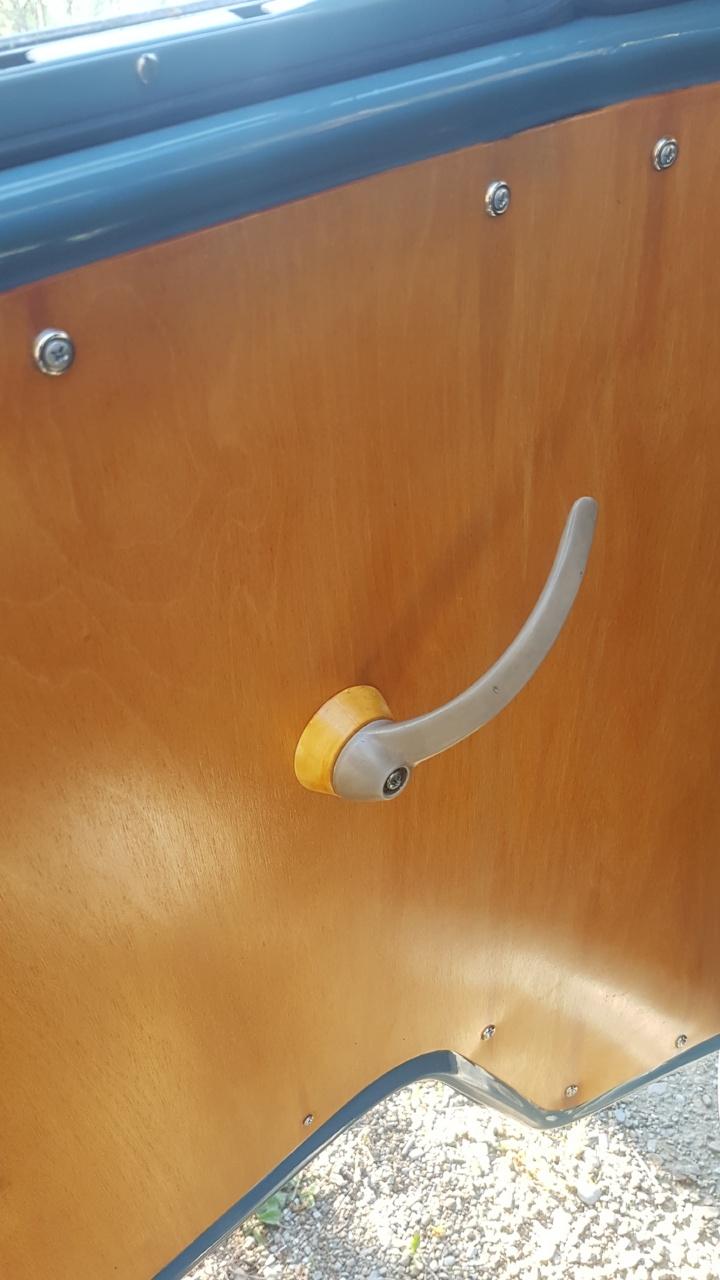

I put two coats of amber shellac on the escutcheons. Improved them but think another coat may be better. I am planning to get some "wood" filament and will print some new ones and see if they are better

peecee69
Joined: January 27, 2005
Posts: 1592
Location: Annapolis, MD/Bloomfield Hills, MI
peecee69 is offline
PostPosted: Wed May 19, 2021 4:03 pm    Post subject: Re: Camper interior build on a 64 Kombi Reply with quote
They look really nice! Did you carve them, or are they available from some seller?

sgellis
Joined: July 06, 2016
Posts: 2180
Location: SW Nova Scotia, Canada
sgellis is offline
PostPosted: Wed May 19, 2021 4:27 pm    Post subject: Re: Camper interior build on a 64 Kombi Reply with quote
Made them with a 3D printer. Front ones are a little thicker than original.
